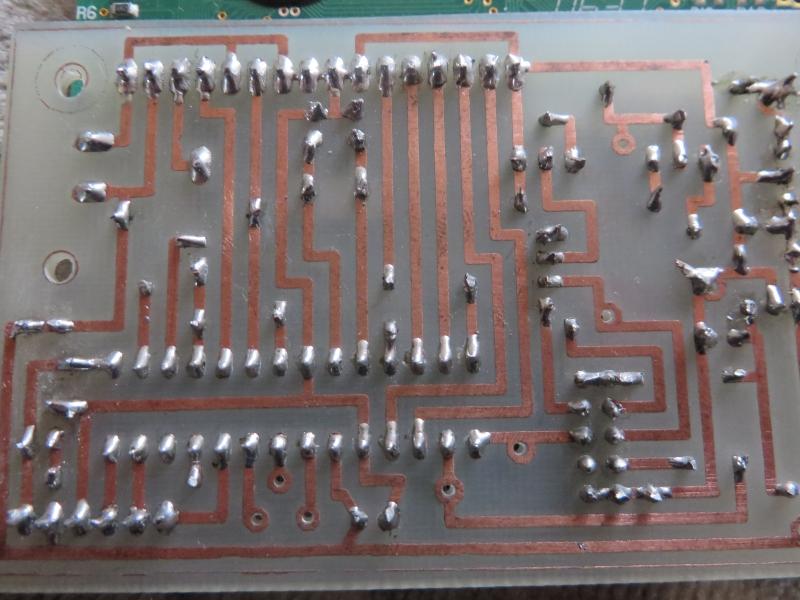

I have this process for 1- or 2-sided PCBs with SMDs:
1. Make board in Eagle
2. Print on overhead projector transparent sheets with a cheap laser printer
3. Expose PCB with some old (huge) sunlamp
4. Develop with NaOH
5. Etch with FeCl3
6. Drill holes
7. Rub high spots from drilling with scotch brite
8. Tin it by smearing with plumbers tin "stuff" and shooting it with a hot air gun
9. Try hard to ignore the (visual) mess this last step leaves behind with half burned PCBs and swear never to do it again :)
10. Spray it with some transparent stuff which is supposed to make it even easier to solder, and protect the copper from oxidizing
11. Solder
There you go! Looks like it's a big effort, but all steps are actually quite easy and clean. I regularly find myself doing it even though I only have a few connections to make, I just dig the look of even very small PCBs compared to individual cables on an experimental board.

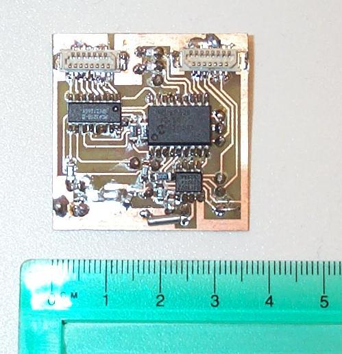

Re: How do you do your PCBs?
« Reply #4 on: January 19, 2016, 06:19:18 AM »
I've done toner transfer with toner transfer paper.  It works OK but I always find the ironing on step fiddly.  It is difficult to keep the film still while you're getting it fixed to the copper and difficult to be sure it's all stuck down properly - especially if the tracks are narrow.
I've tried some of the suggestions on the internet for using glossy paper - they don't work nearly as well as the proper stuff.
I've never tried a double sided board but I think that it would be  difficult to register the second side.  If I had to do a double sided one I might do two boards and put them back to back.
I also try and keep my tracks and pads as fat as possible - easier to drill and solder.
Here's a picture of one I did last month - which gives some idea of how clear the edges are.

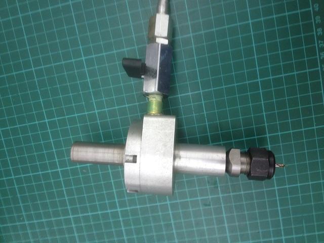

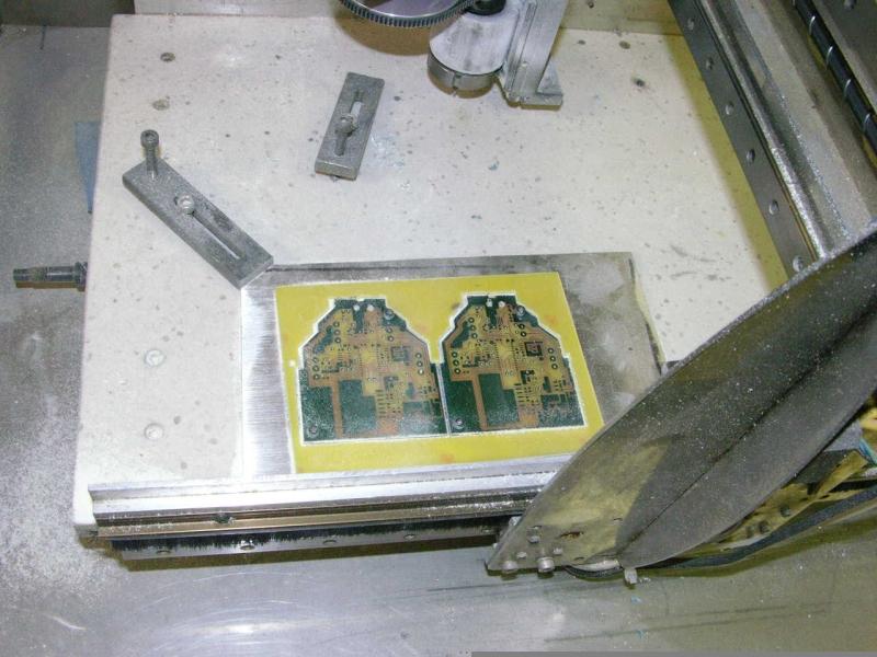

Or, if you have a CNC router or mill, try machining them. No messy chemicals, no UV lamp, cheap copper clad board.
« Last Edit: July 13, 2017, 01:12:12 PM by philf »

I have really been thinking of building a small CNC router just to do euro card size PCBs max. Just so hard to get started. I have seen some professional ones and hobby models or DIY types just feel so hopeless.

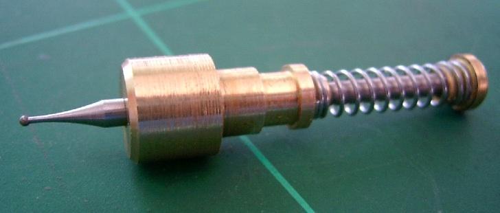

With a small cnc like my old Roland MDX3, you have the option of coating you PCB, then scratch the resist for normal etching.  It means even a small cnc machine can produce boards.  I made this tool to go in the 6mm collet of my little MDX3.

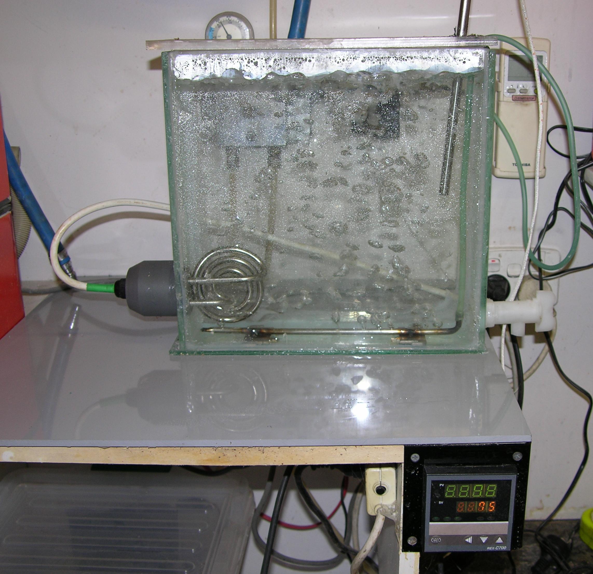

In order to speed up the etching process, I warm my ferric chloride in the microwave oven....depending on the wattage of yours( 'er indoors I should say)...for 10 secs a time...and agitate the board in your etching bath....
It does make a difference.....
John.....pcb etching dept.

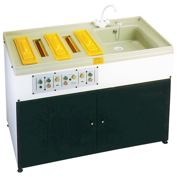

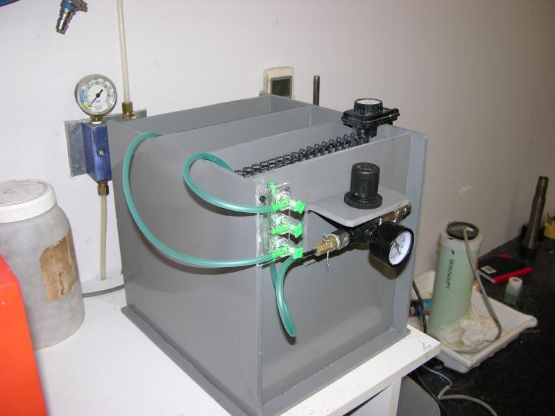

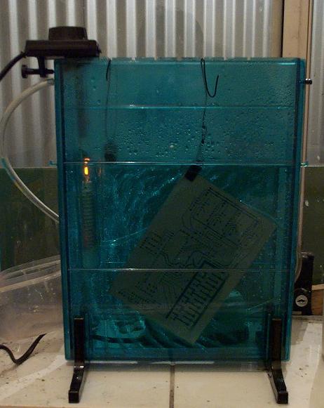

Mine not only warms the Ferric Chloride, but agitates it by pumping air bubbles from below'
Made by Mega, it has a developer tank, etch tank and tin plating tank, with water rinsing slots in between making it all very convenient - has a handy sink built in as well.
Amazing what you can pick up on eBay.  :lol:
 This is the second one I've owned. The first one got sold when I moved to reduce volume of the move itself, but this is an improvement as the last one didn't have the sink.  :thumbup:

Yes, if I am in a hurry (and the wife is not around), I simply put my etching container into a hot water bath in the kitchen. Careful not to over-etch, then.
I've made myself a bubbling device as well, but *that* was messy indeed and I just don't need that step to go fast.
But as the OP is hesistant about the method, I'd just like to point out that both of these things are completely optional and just speed things up.

I ought to point out that overheating the ferric chloride is not good....
It will turn to ferrous chloride....

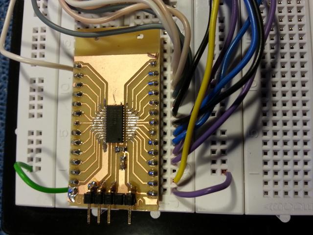

I'm in the process of designing my first PCB.  This is the process I'll probably use to create the board:
http://quinndunki.com/blondihacks/?p=835
The board itself will be about 2"x2" with 150 odd holes.

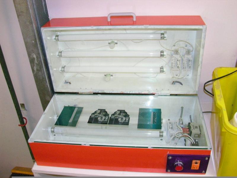

We had one of those units for many years. We used Ferric Chloride etchant and ours didn't look much like that picture when we finally sold it. Before that we had one we made from glass. Before that we used one we built from PVC Sheet. Before that we had a little hobby one.....You get the idea..buy decent tanks ..
Our process was:
Inkjet print onto transparency (inkjets have better resolution)
Lay the top and bottom transparencies on piece of paper and align them, hold in place with tape.
Put double sided Kinsten board in and expose both sides in our DIY exposure box.
Etch,
CNC drill.
A word of caution. Making a double sided exposure box is a good idea. Making one with short wavelength tubes is VERY DUMB!  The lighting supplier sold me UV tubes used to sterilise water. Hand on my heart those lights were on for less than 5 seconds and I spent the nigh in emergency with sunburned corneas. I never knew my eyeballs could hurt that much!

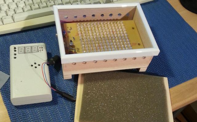

LEDs emitting UV light with wavelength between 340nm 420nm work great with POSITIV-20 photoresist. I built a small (free version of Eagle sized :) ) lightbox using 168 of them and cheapest picture frame i could find (expensive ones have UV filter to preserve picture colors from fading). Laser-print on tracing paper (transparency foil tends to shrink during printing), then the print goes for a few minutes in jar filled with lacquer thinner vapours (cottonball with a drop of thinner) - this causes laser toner particles to expand a bit - the print has more "opacity" afterwards.

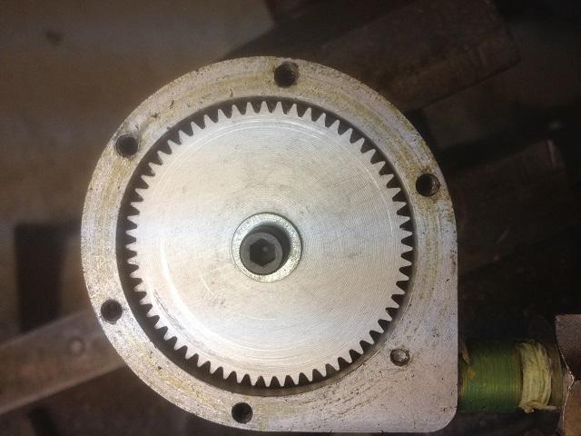

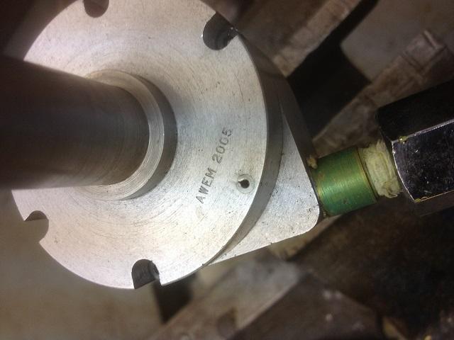

This thread has encouraged me to plan to complete the 'air plumbing' to my CNC mill so not only can I then use my high speed air spindle to route PCBS, but also power the lock on my 4th Axis as well  :ddb:
Spindle is a simple jet of air impinging on a gear wheel and it spins at an enormous speed with the lubricated air emerging though the bearings to cool them, as they spin far faster than their upper design speed  :clap:
Involves a bit of swinging in the rafters so one for when I'm off light duties  :lol:

Yeah, looks like you used that tank commercially?
I've mentioned it in other threads, its true we do commercial work. As such some of what I put up may not be relevant to the hobby user. We did however start out as, and continue to be, hobbyists. All those pictures were from my shed at home. At work we still apply the 'DIY or die' approach to building new machines and capability. We're very much of the same mind set.
In any case, feel free to ignore everything I say, just tell my wife you're doing it, she'll appreciate the company..
Specifically here, all of those tanks are appropriate for one off boards at home...
The methods outlined up there are certainly primarily for hobby purposes. If I find a timeslot somewhere between family and work, usually on late Saturday or Sunday, I want to make a smallish PCB right now and not wait for a delivery, no matter how fast or cheap it is. Also, often I notice something wrong with the layout only after the fact, and then it's no biggy to just go ahead and fix it right there and then, and do another run. ;)
Yes, I need it now! comes up every now and then. The problem with the etching is that the photo emulsions and chemicals have a limited shelf life (especially in the heat). If you are doing two boards a year then it can be difficult to get a good result.
When I get the 60KRPM spindle running at home I'm going to have a go at isolation routing.
Mostly though, because SMD is pretty much unavoidable now, the fact that commercial boards come with solder masks makes them pretty much the only choice..

The last board I etched was done in glass tray over a gas hob using ammonium persulphate.  I basically boil the solution with the board in it. I've used microwave ovens and her tupperware too.

One more distraction: How does the vacuum system works on two sided UV PCB exposure unit?
I only have used method were PCB is slipped in a artwork and put between two glass plates.
I'm wondering how much stress vacuum creates on glass plates and is cheap 2 mm or 3 mm glass plaet enough for euro card size?
I have small quiet compressor that has vacuum inlet. Might consider vacuum. There must be some stuff I'm not aware of.
Would it be possibe to use exact same thickness (probably easiest to use even same PCB material) as a "frame" that has eurocard (100*160 mm) or such cutout for the PCB under construction. Maybe neoprene seal on perimeter to seal the artwork - or glass plate?
Offline PK
  • Posts: 369
« Reply #36 on: January 24, 2016, 05:33:58 PM »
 :doh:
Vacuum is easily substituted with mass for the DIY case. You just need to hold the transparency onto the PCB. Holding it stupid hard doesn't (in my experience) make any difference.
The lid on my exposure box weighed maybe 6-7Kg. I used 5mm toughened glass, about 450mmx250mm. I recall supporting it at the ends with two bits of round bar and standing in the middle. Unbelievably strong stuff!
PK

Jep. I just wonder:
* Previously I had trouble finding material that will not absorb UV (surpricingly many glass and PMMA sheets does..) and like to keep it thin. Found 2 mm picture frame glass, this does not take much load.
* Taking care to put "ink" side next to photoresis, hmmm. not extremely flat if loaded only on edges...
* Would like to expose it two sided - one go - putting books or weight lifters on top of it is not viable
* Plastic C-profile seems to clamp it good enough, might go for that.
Usually KISS is best, sometimes it just takes few tries to get there and boil it down to minimum. :lol:
Offline PK
  • Posts: 369
« Reply #38 on: January 25, 2016, 05:15:51 AM »
Honestly?
You're overthinking it.
I ran 5mm glass and my exposure times were bang on for the wavelength (ie around 90 seconds) .
The plastic film and the copper layer crushes more than good glass bends.
That box that I showed a picture of (which had slotted mounts for the hinges BTW so the top plate of glass could always be parallel with the bottom) made hundreds and hundreds of boards with 10 mil tracks.
By all means, go buy special glass, vacuum pumps and dilthium crystals, it's fun to make these things as flash as you can (I'm serious, I really get it..).... but getting your dev/rinse/etch chemistry under control, or a temperature controlled storage box for chemicals and emulsion coated boards will have orders of magnitude more effect on the finished board than a few microns of gap between a film and a board.
« Reply #39 on: January 25, 2016, 06:03:02 AM »
Ok. Thank you. My suspicion has a reason: Few years ago I bough 1 metre long 5 mm thick PMMA (acrylic) that was supposed to transparent to UV. It Blocked most of it. When I asked them to double check it with BIG LETTERS, I got the type an sure enough it had a filter added....they refused to deliver small amount "stadard" PMMA that would not filter UV, noobody-wants-it!. Then I bough some "good glass" and you may guess it. IT HAD UV FILTER TOO. Fool me once - well - fool me six times?
I put presensitized PCB and different "transparent" material on both sides and nothing in 10 mm space between the glass and PMMA. That way I figured that while 30 s exposure showed up almost good eneough without any "filter" 120 s was marginal on that first UV-transparent acrylic sheet I got and the "glass" need nearly same. I had cut the acrylic to size and I was in process of finishing the light box.
I'll build slap together 2 sided unit that assumes sandwich of max. 2-classes (2-3 mm), two transparencies and PCB of 0,6 - 1,5 mm + plastic C-profile to keep them clamped. If that doesn't work I'll take up on knitting.
