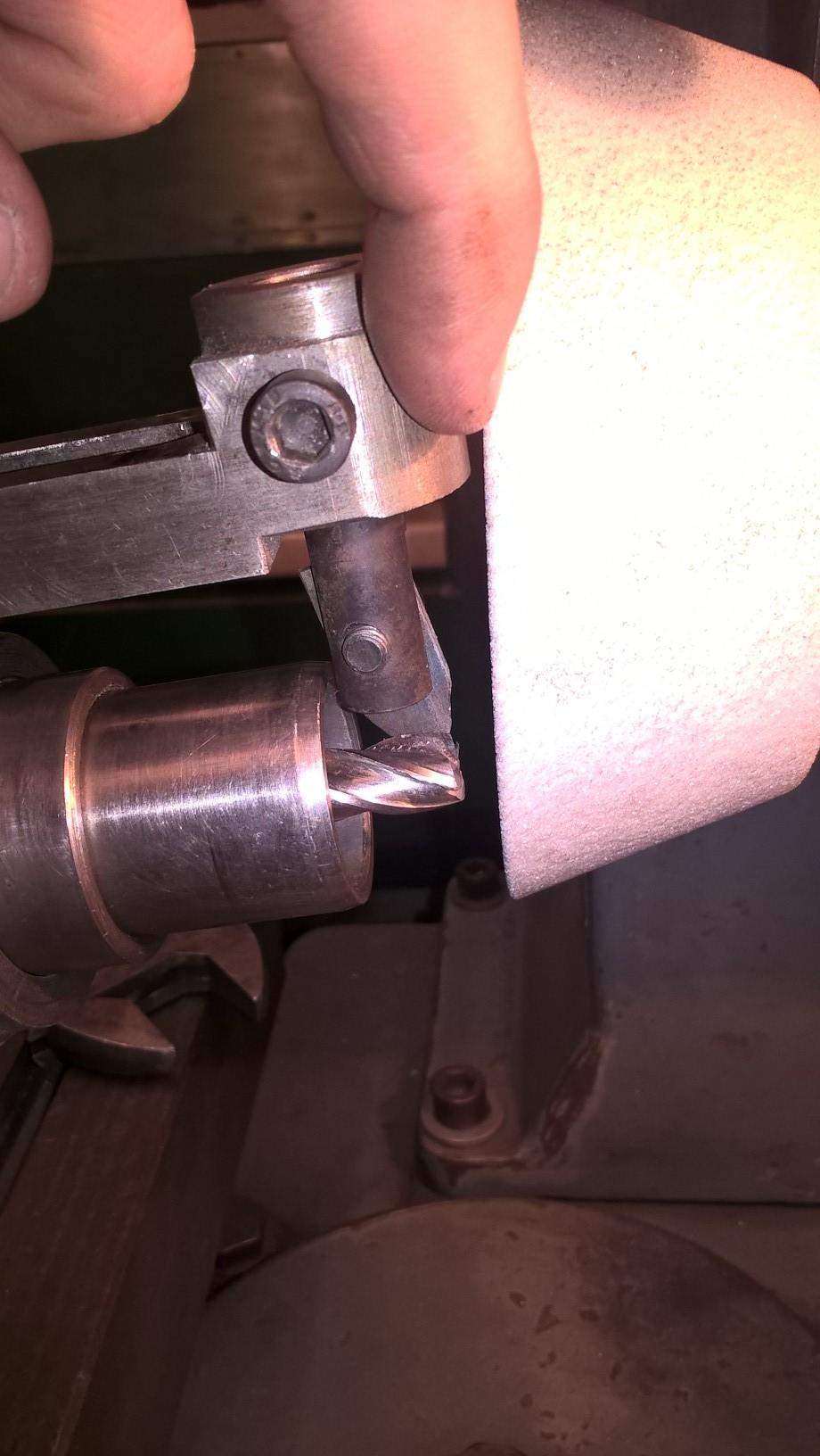

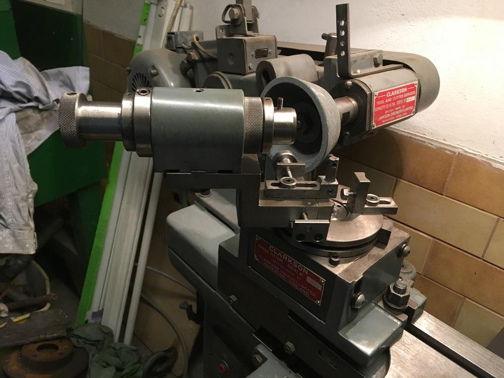

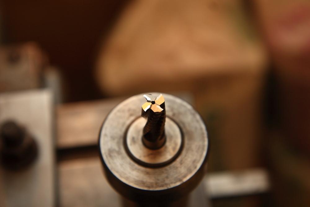

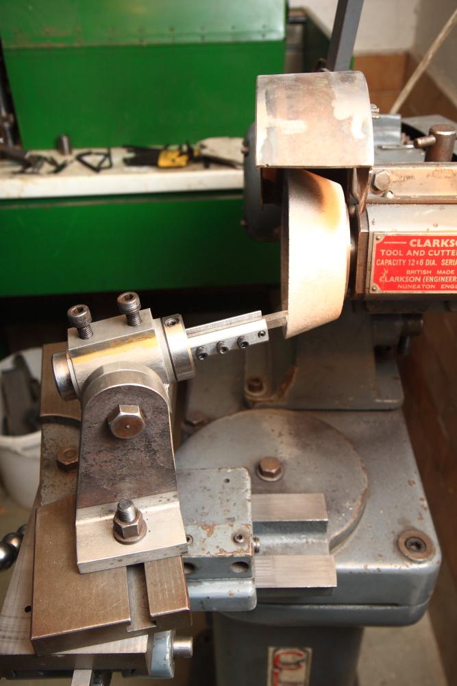

I know tool grinding is one of those 5 minute jobs, to get another job done, but it would be greatly appreciated if the experienced guys could take a photo or two of their set ups and post them here.
I got a Clarkson MK1 T&C Grinder last week, and just got the 3PH power where it stands, so after grinding a few drills with a cheap and nasty drill jig, I thought I'd better try and sharpen up my extensive collection of blunt end mills.
I have the Clarkson guides from Steven:
http://www.bedroom-workshop.com/grinder-clarksonbooks/0grinder-clarksonbooks.html
Page 10 of the 1971 pdf.
but for a rank novice like me, the instructions are obviously not basic enough.
Searching the web, there really isn't that much information about the nitty gritty of using a T&C grinder. Overview yes, but details are thin.

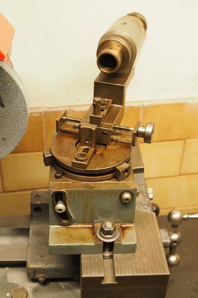

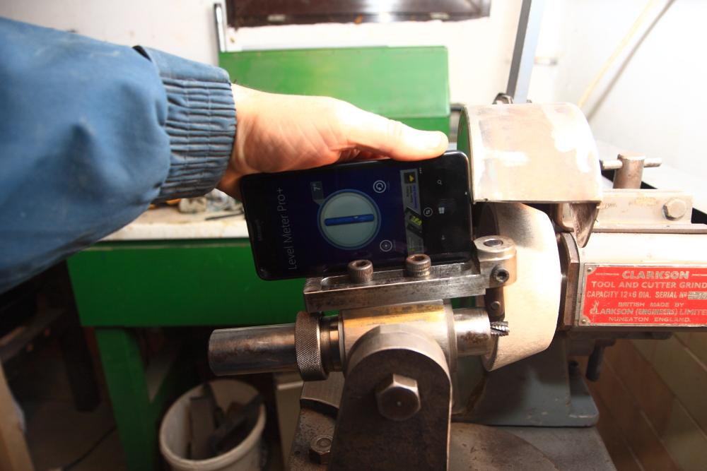

For this case I have the Universal head mounted. Clarkson says turn the table 90° to the wheel. Easy enough, but the swing table has no stops. Do you guys just eyeball it, or do you use a clock to set that?
Since my universal head has no scale, I use the digital level in the phone to set the 7° primary angle. Clarkson then recommends using the "swan necked tool rest bracket". They show a pretty small diameter cup wheel. Mine is bigger. Size does matter.  The swan neck hits the cup wheel.

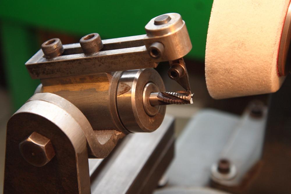

I have metric bushes. They have 25mm OD's. Of the six straight shank cutter holders I have, only one has a 25mm bore (the rest 25.4 /1"  ), but it is at the back. I tried stacking a bush into an longer stright shank holder, and then that into the short one which fits in the head. Had no way of locking the mill in length, so just pushed it in till it hit something. Was all a bit fiddly.
Setting the mill horizontal is another one of those simple concepts. Maybe the way I have my Clarkson close to a wall is the problem, but looking in from an angle I find it hard to judge the angle to get the support finger set right.
I think I need to make up a type F tool rest/finger from a thinner hacksaw blade. The one I have is too thick to allow it to spring out when turning from tooth to tooth. I have to back out o the spiral and then reinsert, which goes against Clarksons instructions.
Did the same for the 22° relief angle.

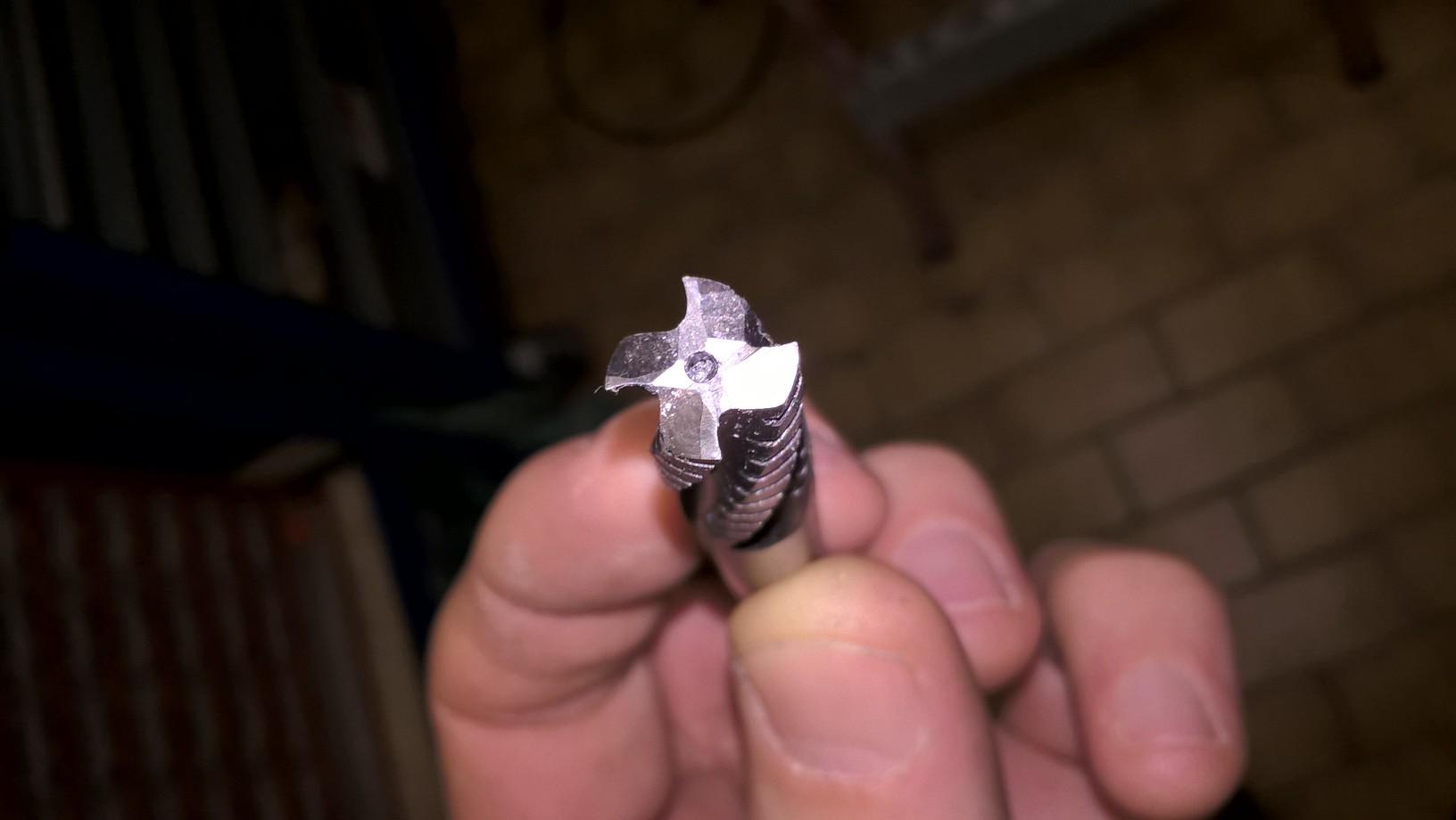

Result was ginding about 1mm off the end mill. The four flutes aren't very even. The center relief no longer existed, and it rubbed when I tried it, so I then relieved the center freehand on the end of the cup wheel. If I understand Clarkson correctly, the proper way to do this is to simply gash a cross with a cut off disk (Page 11 of the 1971 guide)
After grinding the rougher a bit, I had a go at butchering another beat up 10mm endmill. This time a center cutter.
Weird bit is, despite a pretty crap first attempt, both cutters cut much better than blunt.

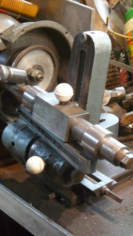

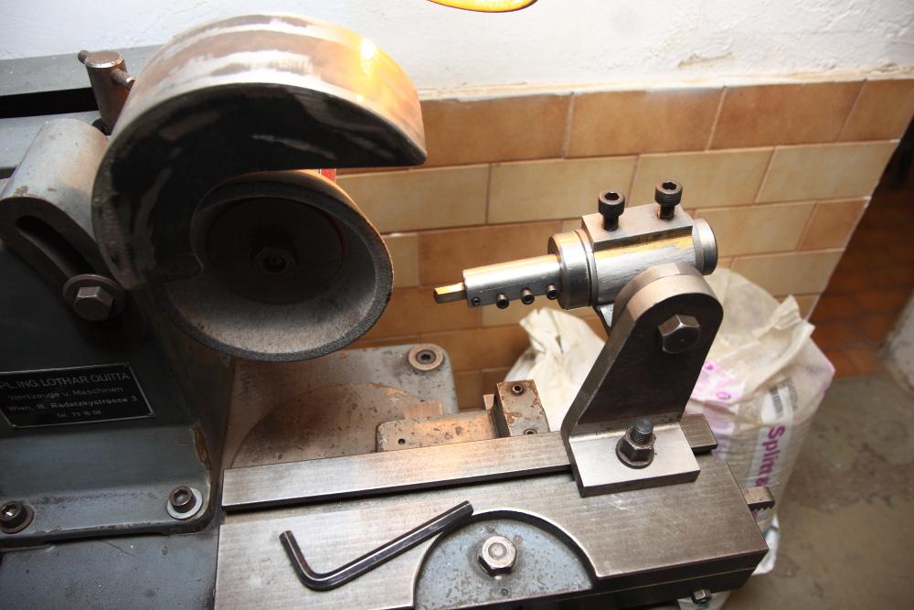

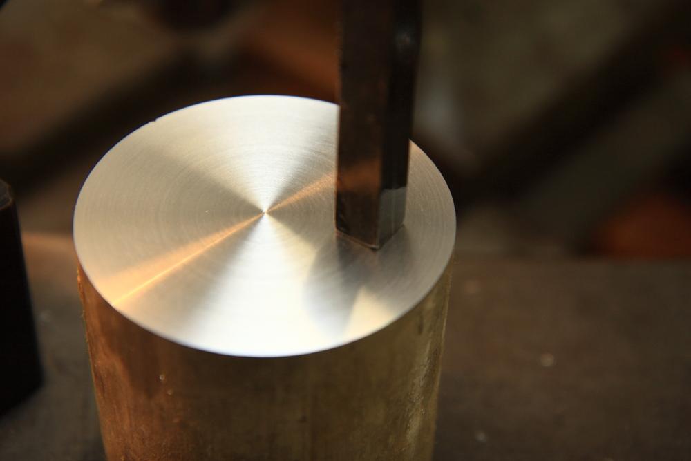

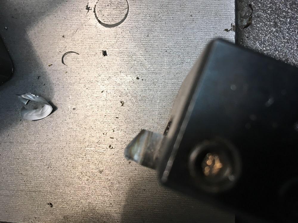

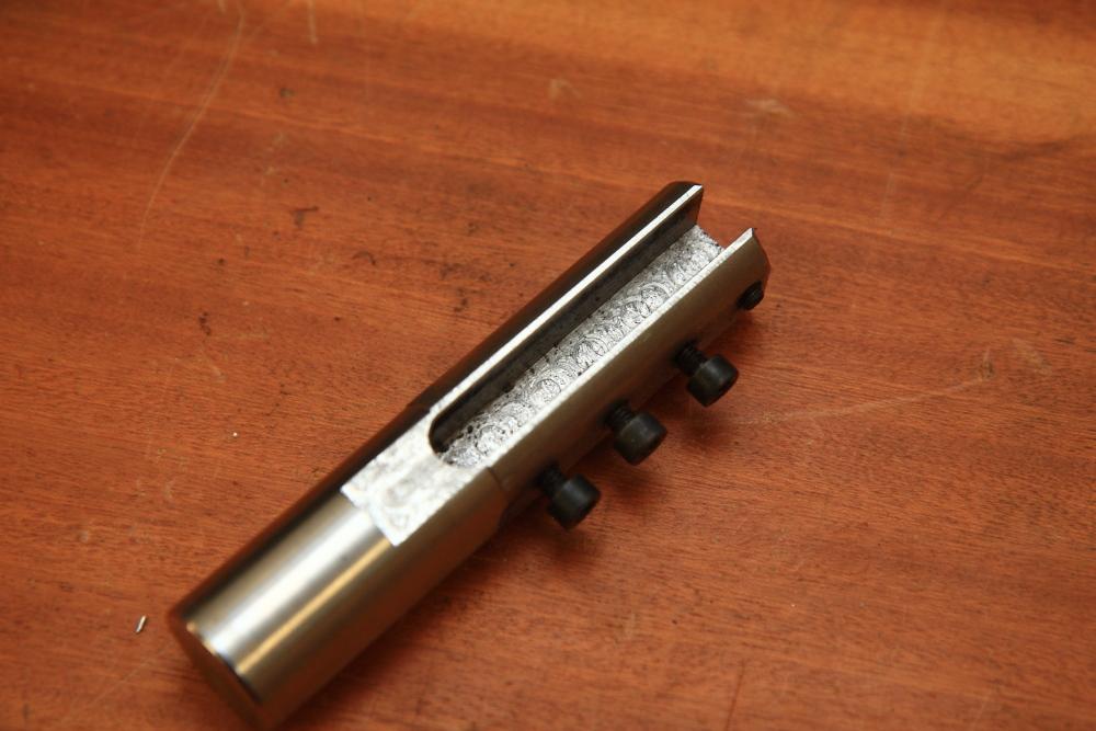

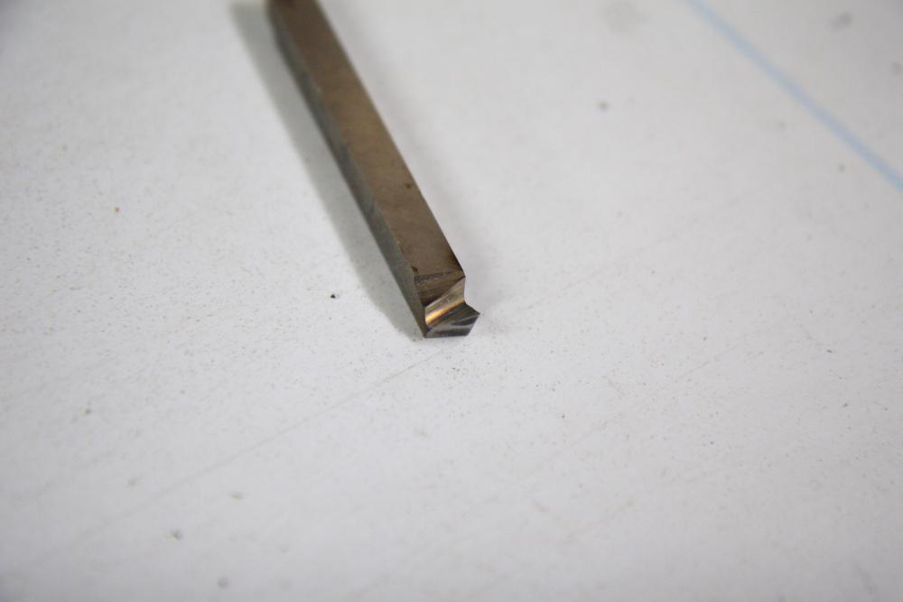

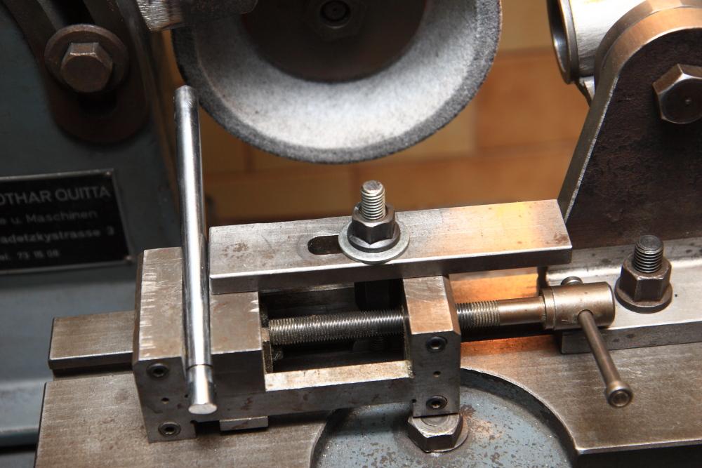

I made a lathe tool holder. I know that lathe tools aren't that critical, being single piont, and it is easy enough to off hand grind them. Still, this makes them look nice. I ground up two aluminium cutting bits, using 12° side rack and 35° top rack. If I'd offhand ground them, I would never have made such an extreme top rack, but they cut beautifully.
Mark

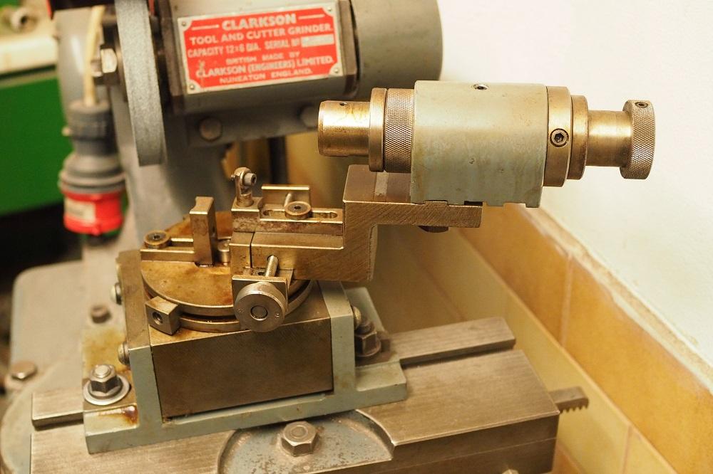

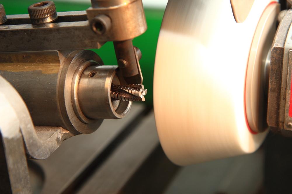

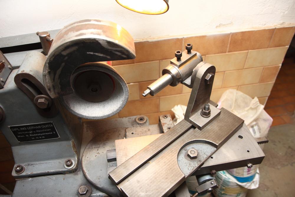

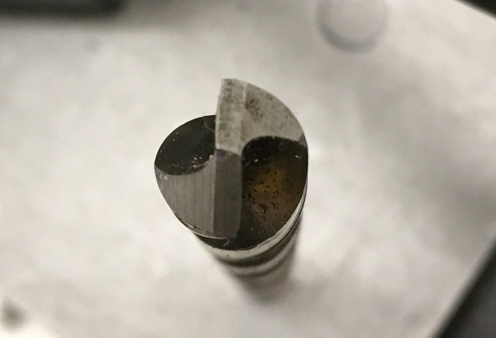

Since the first attempt at end mills was pretty crappy, I got a bit more serious.
My wheel dressing diamond is mounted on an 11mm shaft, for which I have no Clarkson bush, so I just clamped a vise to the table for dressing.
Then I made a new F style finger from a broken, thin hacksaw blade. For the set up this time I used just a straight shank holder and bush, and locked the end mill in with a set screw. The set up was much more repeatable, and I got a pretty nice even grind this time. In the end I used a handheld proxon grinder to hollow out the center.
T&C grinders are a lot of fun to play with. I can see the big advantage being the convenience. Since it only takes a minute to set up, you are more likely to touch up a tool, and use a sharp cutter, drill, etc rather than just getting by with a one which is a bit blunt.

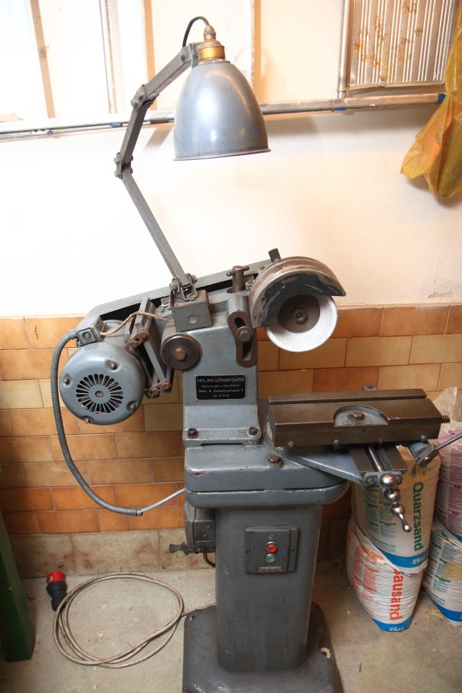

Does the table leadscrew on your Clarkson Mk1 also turn the wrong way? On mine, you rotate the handle clockwise to retract the slide. Both my Lathes advance the slide with clockwise motion.
Otherwise I really like the Clarkson. Today I needed to use a little 6mm HSS wood router bit which I'd ruined the cutting edges on last time it was used. Couple of minutes on the T&C and it is no longer 6mm, but cuts like a champ again.

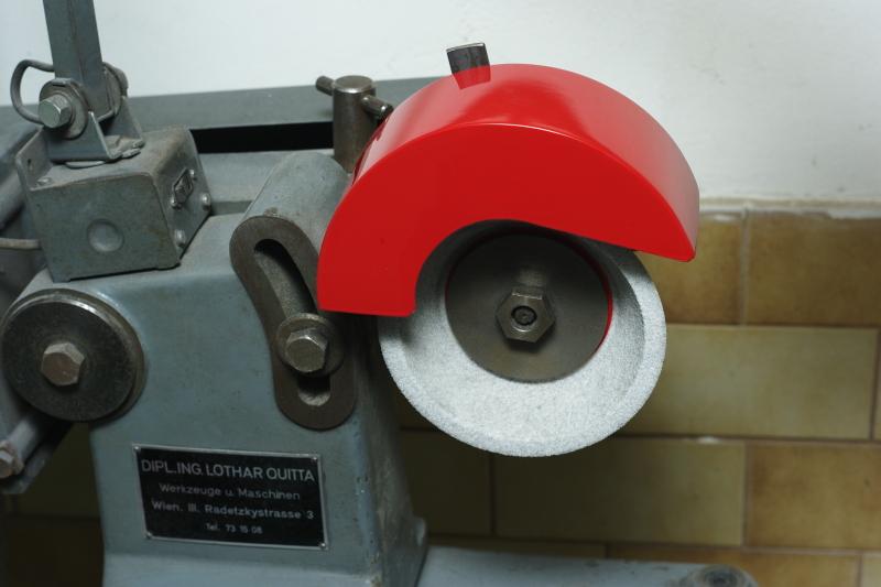

Franz, the friend who sold me the Clarkson, made a really nice welding job on the wheel cover, so I figured I'd finish it to match the machine. Bit of bog and sanding, and I undercoated it yesterday.

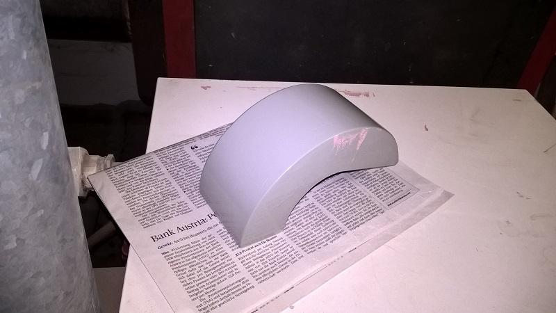

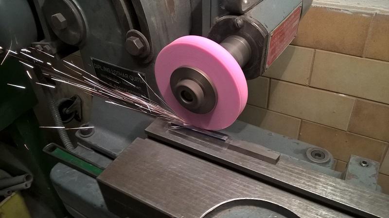

I tried to use my Clarkson as a surface grinder to thin down a shim for the lathe. Didn't work, as the head adjustment does not provide sensitive, repeatable, fine, down-feed control. The way the motor counterbalances the head, there is more control of upfeed than down.
Mark

Finished dollying up the wheel cover...
Mark
Re: Show us your T&C grinder set ups
« Reply #9 on: April 01, 2016, 04:48:27 PM »
Functional and smart :clap:  :clap:  :clap:  :clap:

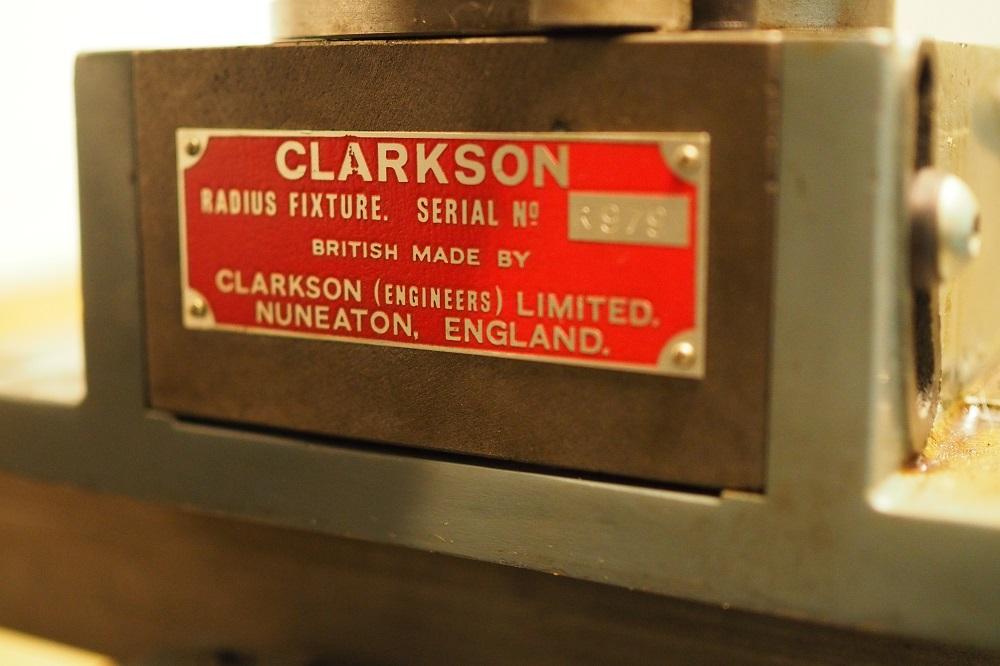

Today I bought the radius grinding fixture for my Clarkson. It is only a Mark 1, without the tilting head bracket, but am pretty sure it has never been used. It isn't rusty, it's been sprayed with a waxy preservative oil. It came with a 25mm tool holder shaft, for which I already have the metric mills size bushes, two finger hoders, and I bar I am not sure is for. It is missing the setting bar slide, so I'll have to mill one up.
I bought it from the mate who sold me the Clarkson. He is a tool nut, very skilled machinist, and replaced the Clarkson with a huge TOS T&C grinder, with every accessory you can possibly imagine, and a bunch you wouldn't have thought of.
I had a quick bit of a play with the radius fixture this evening, but since looking in the Clarkson manual, see it needs to be mounted the other way around.

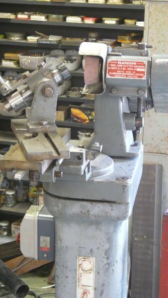

The club I belong to got a Clarkson two weeks ago , only a few tools with it made a er32 spindle and tooth rests , John Stevenson made a how to cd for Clarkson , Norton do a free download of there tool room grinding booklet search for tool room grinding , still learning how to set up done 4 facet drill sharpening , have you found bedroom workshop.com loads of info there ,

Yep. The bedroom workshop collection of info has been really helpfull. I sent him some photos of my clarkson, but I think he has gone inactive on that front. Tool grinding is a pretty cool way of turning loads of time into grinding dust and maybe a few sharper cutters. Good luck with the four facet drill grinding. So far I have just been using one of those cheap chinese swing jigs for drill sharpening. A bit hit or miss, but still more repeatable than hand grinding for me as I don't practice enough.
What other accessories does you club have for your Clarkson?

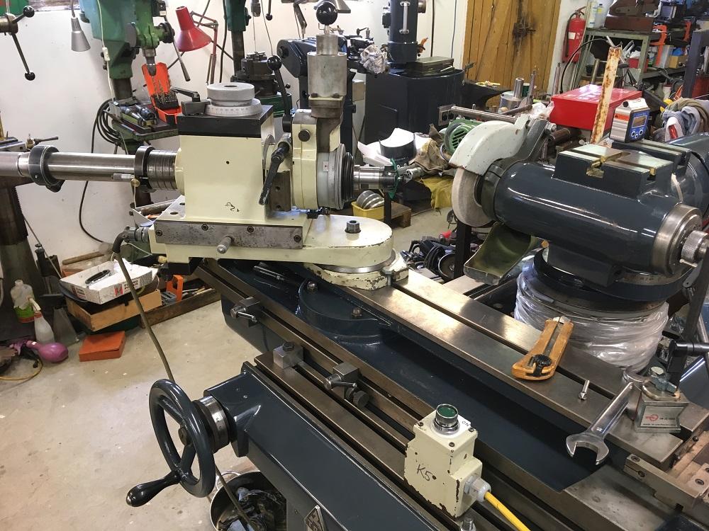

Funny to think of the Clarkson as big. I find it rather small and cramped for some operations. I don't have the space or inclination to have multiple specialised tools set up for lathe tools or drills, and am happy with using the Clarkson for these tasks as well.

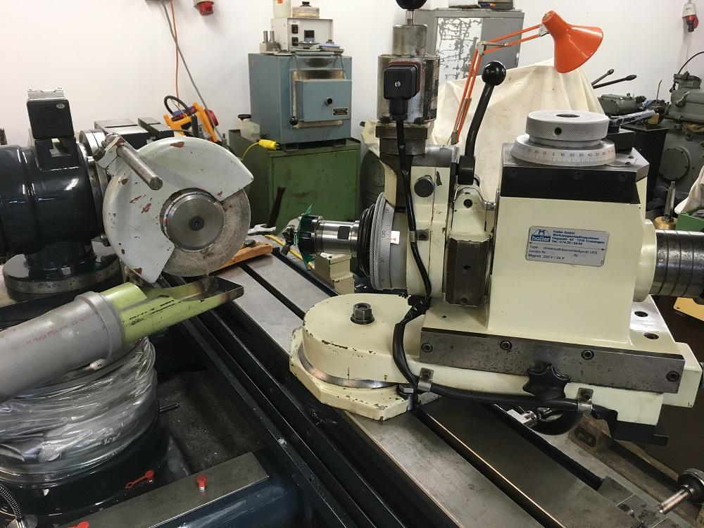

The mate I bought it from replaced it with the Tos BN-102, which must weight at least a ton (his is in much better condition than this one...
https://espmach.com.au/images/Grinders/2012%20Grinders/Tos-T&C-Grinder.jpg
Then he puts the 80 kg Haller spiral grinding attachment on it, like this one:
https://www.cottandco.com/en/lots/haller-type-ufs155-universal-spiral-cutter-grinder
What a dream to use. You can dial in any lead angle from -90° through to 90°, has no backlash, feels near frictionless (although still not quite like the TOS air bearing attachment. His regrinds are not perfect.

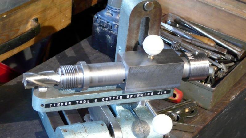

I actually bought the original castings etc from Norman Tinker in Nottingham, England-- a million years ago.
I was curious about how Tinker reground things like taps which are not on my copies.
As mentioned, I'm doing up the old rusty Quorn and have just designed and made a jig to weld the  polyethylene drive belts.
Where I got to( mentally) was to change the single speeds on my various grinders to three step ones.  Again, there is a series of articles by the late Philip Amos on his Quorn variant.

Thanks Jeff.  I'm merely curious to know what a Tinker is really capable of.
I'm into this maths formula thing for determining variations on Pi etc which seems to be the basis of the Tinker-or was.
One wonders how these 'newer' slot drills are re-sharpened.

Yesterday I case hardened the replacement setting bar slide (sorry no photo), using the method and recipe in the excellent Clickspring video...
I heated the clay package in the furnace till it started glowing, and then another half hour, so I hope there is a deep enough skin of Martensite to still have a hard surface after surface grinding from the current 6.18mm down to the final 5.78mm dimension.
Ground another lathe bit. This is so easy, I can see all my lathe bits haveing defined radius's soon.

Drill sharpening is a doddle set the universal head to 31 degrees set the base at 90 and the slide to 8 or 10 for the cutting edge then 25 for the relief , for the next drill do the relief first and so on ,
Well you sure are right about that being a doddle. Won't bother using the wobbly chinese drill grinding jig anymore, except for drills too big to fit into my ER 16 and ER32 collets.
I was out lending a pair of hand while my mate was straightening a motorbike frame, and then he sharpened my countersinks on his TOS BN-102 with the Haller spiral grinding attachment. Grabbed a couple of frames of that amazing device. We believe it has conical friction wheels for setting any lead angle from -90-0-90°. Amazing device. The whole set up makes the Clarkson seem like a cheap chinese tool :)
