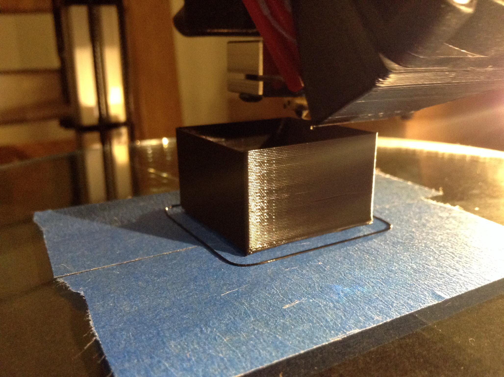

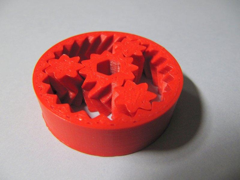

Mini Kossel not easy to setup and calibrate.  However once you get over that, the print quality is astounding using the Duet board.  More info to follow, below example a "rough test print"

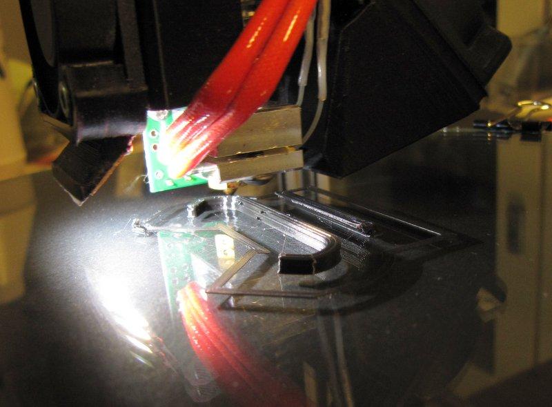

After my initial success with the printer I am now having problems.  I have just tried doing the Dremel gear I designed and seeing the head loose position during the the first two attempts at printing.  It looks like the head is snagging on the lower layer and getting offset.  I have now altered my layer height to 0.15mm and trying another print, the quality is not what I had to begin with and my suspicion is falling on the hot end having worked loose.  Once I finish the print I can investigate further.   During the build I was concerned by the fact they rely on bolts into plastic to trap the hotend.  I am going to look at this and see if I can make a proper alloy part thats tapped to take the bolts.   Shame, but I just seem to be having a run of bad luck as lots of things going wrong at the moment   :(
A couple of layers got displaced, so ruining the print, this was third attempt with more relaxed settings.  I need to figure out if it's a mechanical fault, firmware or software, but above this the print quality is OK.  However its messy below, especially in the area the head starts the next layer, this is what makes me think the hotend may have some play and allow it to dig and stall the steppers.  This could mean I need to increase the stepper current as the motors are still pretty cool at the end of the print.   Lots of possibles to look at and try.

Sorry guys, it's not the black pigment causing the issue, as this PLA works fine on my cartesian printer.  I now only buy good quality, in this case UK blended filament, as it's not been baked or soaked travelling half way round the planet.

Offline Jorkki
  • Posts: 7
Re: Another 3D Printer
« Reply #25 on: February 09, 2016, 08:51:12 PM »
Joules,
Just waiting for the same Kossel Mini  kit myself (my first), so can't really give any expert advise.
I have used the waiting time to do some reading though and from what I have read, probably  the most common reasons are the retraction settings.
Just thinking about it, if it was a mechanical issue, the printer probably would not recover to properly print the upper layers.
If the Bowden tube would be loose at either end, you would probably also have the issue everywhere.
So it may have something to do either with a too large retraction or a positive value on the 'Extra length on restart'.
Alternatively it might be that the printer is doing short moves and retracts before arriving on the perimeter to continue.
It might make sense to test with the 'Avoid crossing perimeters' and 'Only retract when crossing perimeters' settings.
Also putting 'Random' in 'Seam position' might make a difference.
For delta printers I have also seen a recommendation to put a small value (e.g. 0.1mm) to 'Lift Z' if the nozzle keeps catching the already laid filaments.
Hope you get everything sorted soon!

  • Posts: 1319
« Reply #26 on: February 10, 2016, 05:12:31 AM »
Hi Jorma and welcome to MadModders, I finally found the problem and it was the hotend being loose.  It has caught on the prints and loosened.  I wasn't keen on the method of bolting into plastic to clamp the hotend, so I will either make an alloy part or some little threaded bushes to reclamp everything, and increase the Z lift   :thumbup:

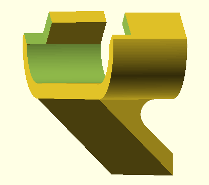

And here is my problem, screwing M3 bolts into ABS was never going to be a good idea, but you can't say I didn't give it a try.
The advice to tighten gently  :lol:  into plastic.  It failed in use, I tried over tightening the bolts once I had it out and the difference between snug and pulled out is very small, too small to feel if the delta plate your fixing too is a little tight on the bolts.  So, this part is getting a redesign to take an alloy insert that is tapped to take the bolts properly and clamp things firmly.

The thread is far too fine, something like self tapping screws or wood screws work much better in plastic!
Regards Matthew.
« Reply #30 on: February 11, 2016, 04:47:25 PM »
Could you not drill through and use some of the threaded inserts used in woodworking that are capped?
  • Posts: 1319
« Reply #31 on: February 11, 2016, 05:27:11 PM »
I looked at those inserts, but decided on a horseshoe shaped alloy fitting with the five threaded bosses machined in, so none of them can spin and I get good clamping force.  The whole  part above is having a redesign as its a pretty course print, I can route the wiring better and improve the filament cooling fan supports and reduce its footprint with better clamping.   Just juggling time and jobs as a rather nice robot arm got delivered a few days back and could be a major distraction if I'm not careful.  8-)    But that's another story.

I just printed Emmett's Gear Bearing from Thingiverse to test. It's a quite nice example of things that you can't build or take apart, you have to print it.

You got really good print quality there Jorma.  That's what's making the niggles worth solving.  This little printer is capable of very high quality work.   My fear about the extruder was justified when a filament jam popped the large gear and pinch roller out  :bugeye:

Setting the printer up for another test print.
  • Posts: 1319
« Reply #44 on: February 17, 2016, 06:18:09 AM »
First test print with everything dialled in.  These are shell prints, in effect a spiral movement to print a single layer.  The objects you see are nose cones for a small model glider.
The print on the left when I produced it about a year ago was thought to be pretty damned good.  The print on the right is from the Kossel, you see a grain effect where the 8 bit controller interpreted steps on the left.  The right print barely shows the steps, you really have to see these to get a full understanding of the increase in resolution in printing.
My other concern was going to be tolerance from machine to machine as I have a few printers now and will be printing multiple parts and in different colours, so things like snap shut lids could be a problem.
Not a worry...  The translucent white print was from another machine over a year ago, and the black section below is a failed print from last night on the Kossel, they are mating parts printed on different machines and the grain in each print is alined, so you can see the difference.  The failed part has the snap lock printed on it, so it makes a good test part.  They clicked together just fine, I am so pleased with the tolerance I am seeing so far.   Yeah other issues with the printer are getting resolved and worked around, but the print quality is just outstanding and it's still early days.

I found myself using a head torch constantly to see how a print is coming along.
I decided this is a good opportunity to start learning a little bit of the openSCAD software and decided to design a small clip to put on the hot end fan where a short strip of LEDs could be mounted to shine some light on the work in progress.
This is what I came up with.
I have also changed the hot end heater cartridge to enter from the front side as the leads were pressing against the cooling fan hood and that tended to unscrew the hot end loose.
At the same time I replaced the original 3mm machine screws that hold the hot end carriage to the effector plate with 3.5mm deep threaded universal screws (as I could not easily find the special screws made for thermoplastics). Not as good as Joules's threaded inserts, but a huge improvement anyway.
Might be a good idea to try and get some of these http://www.tappex.co.uk/trisert-inserts or something similar for future projects.
