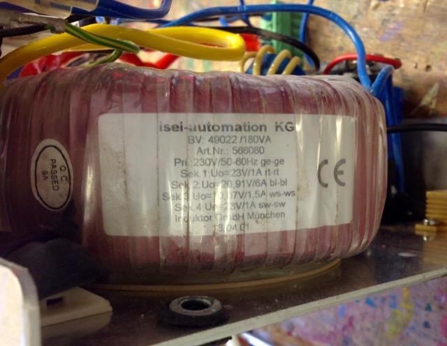

A little confused with this PSU.
I've taken a picture of the label and attached it. (One with light shining and glare is 10v )
I'm reading 29.8v across the capacitor which doesn't match any of the stated voltages?

Why should it ?????  :scratch:  They are full-load RMS AC voltages.
If you connect Sek2 from bl-bl @ 20.9VAC I would expect that to FW rectify to 29.8 VDC ish with a capacitor.
Multiply by SQRT 2 ie. 1.414 ...
If that is what you are doing ... not enough info really.

The important winding is the 20.91v at 6a. If you rectify that with a bridge and put a big capacitor in you should get something like 30v which is better than 24v but 36v would be better still.
It would be OK for starters but if you want speed you may struggle. Also, if you've got three 4.2a stepper motors there may not be enough current if all three motors drive at the same time.

Thank you, makes sense now,
