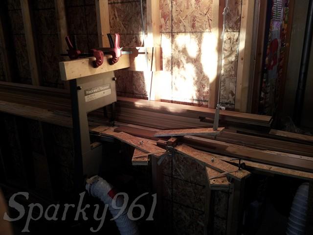

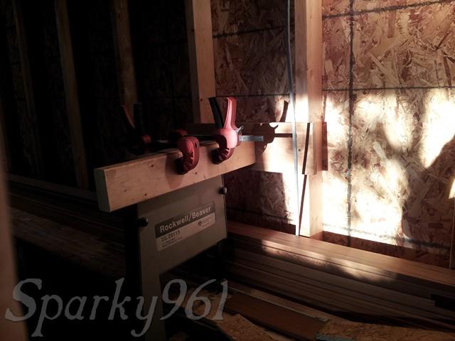

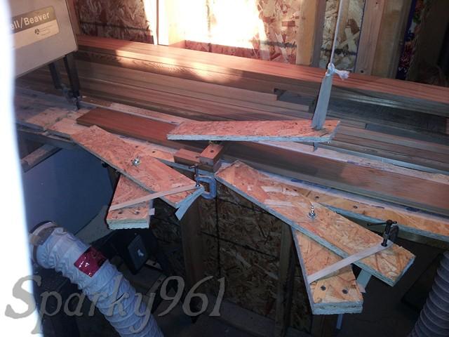

I was flipping through some pictures tonight and ran across a few I snapped while cutting the strips.  I sawed them from 3/4" clear cedar, if I recall correctly.  After sawing they all got a bead and cove as well.  The pictures are a bit of a whirlwind tour, as this took many evenings and a few weekends to complete.  I know think hope I have more than enough to complete the job and select some nice contrasting colours.
By the picture's filename, it looks like I was doing this in October of 2014... right around the time I switched jobs, so no big surprise that it got pushed to the back burner.
The attached pictures show my cobbled-together setup for ripping the strips.  Looks like hell but works quite well.... maybe I should adopt that as a new motto.
I'll try to describe the pictures in less than 1000 words:
The device consists of shelf brackets attached to a bare studded wall that hold pieces of wood comprising the infeed and outfeed tables.  The bandsaw is set up in the middle of these.  My longest piece was about 12' so you can see this required lots of space.  And for those who have been paying attention, yes this is shorter than the kayak I'm building.  Strips will be joined strategically and doing so does not compromise the strength.
Attached to the table is a wooden fence covered in tape to reduce friction.  There are three spring-loaded (elastic band) fingers that hold the board down to the table and against the fence.  This is important because it's almost impossible to guide it by hand and end up with consistent strip width.
I noticed early on that my strips were getting wider and wider and couldn't figure out why.  Turns out the saw was dancing away along the floor so I knocked together a little bracket that I clamped to the top of the saw and screwed to the wall.  It didn't move until I was finished.

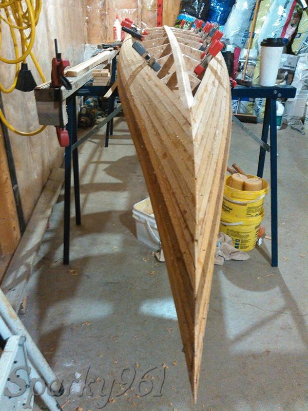

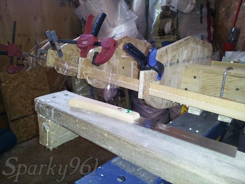

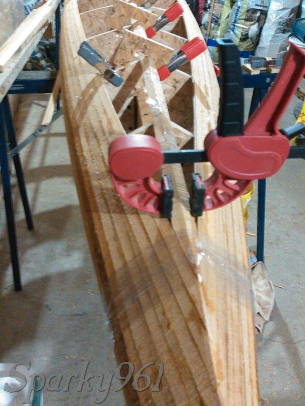

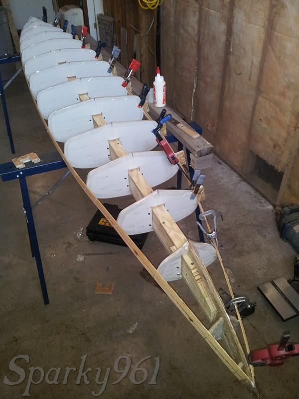

A little update to my slow-motion kayak build... got the first couple of strips mounted.  I think I was putting it off for fear of messing things up, but seem to have gotten over that now.  There's a lot of up-turn in the bow and stern so these first few strips have been putting up a good fight.  I learned quickly that I don't own enough clamps but might just try to make do with what I do have.
I'm trying to avoid putting too many staple/nail holes in the strips, though the bow and stern have been exempted from that requirement.  The combination of staples, finishing nails, clamps, and packing tape seems to be holding things well enough for now.  My only fear is that half way though the job - or even when removing it from the forms - I'm going to hear a loud "CRACK" and a bunch of strips are going to revert to their preferred "straight" orientation.  I hope that the bend will have a tendency to set into the wood by the time I'm ready to take it off the forms.  Once I get the glassing done I doubt anything will be able to move.
I believe these first couple strips will be the most difficult.  The rest shouldn't be quite so difficult to bend and the rest of the boat will provide structure to attach them to and hold in place while the glue dries.  Because I'm trying to go mostly staple-less, applying the strips will be a slow process indeed.  Meh... no rush.  This is something I'm doing when I can't bring myself to do other things.
Oh, and something else that just came to mind when I was adding the pictures below.  I had forgotten from my previous wood gluing experiences that putting metal clamps directly in contact with wet glue leaves nasty black spots on the wood!  DOH!  I think they'll clean up alright with the planing and sanding to come.  I have a plan B if they don't.  I've been putting clear tape underneath them now.

Glad that you are making progress but making me somewhat jealous.
As for black staining, might I suggest oxalic acid?  Working as we did on 'folders' there was a lot of ashwood and it stained really badly especially immersed in sea water.
I'm going back a bit( well, more than a bit, but we pinned veneers down but with bits of scrap veneer.

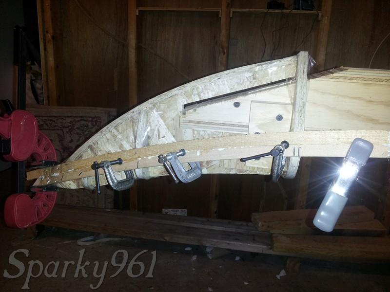

I've been continuing to plug away at this in very small increments, but I recently reached a bit of a milestone so I thought I'd put up some recent pictures.
As the strips are laid side by side up the hull, you get to a point where the ends meet more horizontally than vertically.  According to Nick Schade's book, this is when you install the keel strips.  That's where I'm at!  I know it doesn't seem like a lot, but I've been taking my time on this making all of my joints fit as well as I can make them.  I'm also not using many staples/nails so it means that only one strip can be applied and the glue left to dry.  So at most I can do one strip per day, though I've done two on some weekends. :)
The keel strips are interesting.  There's about 5-6 hours of work in those two little strips!  There are two angles that need to meet snugly in the bow (front), and the same angles plus overall length in the stern (back).  At the same time there's a bevel that gets planed between the two so they meet at an angle and have a wide flat gluing surface.  This bevel varies over the length so it's rather finicky.
Plenty of clamps and tape later, plus 2 days of drying (the ends were _really_ sprung so I wanted the glue _very_ dry before trying to remove the clamps) and I'm very happy with the results.  The ends meet as nice as I'd expect, the bevel looks good, and most importantly it runs in a very straight line down the middle of the hull.
The next step is to start filling in the two voids on either side of the keep strip.  It's starting to look like a boat!
