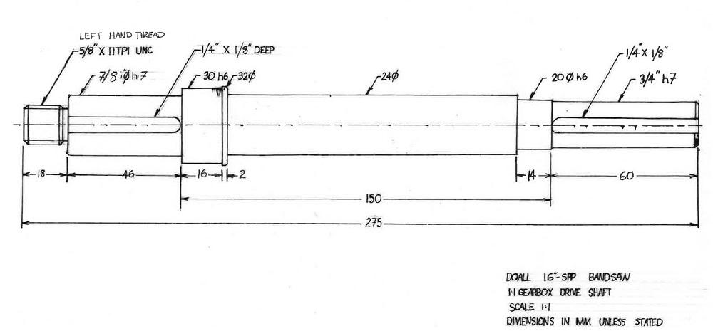

I used Inventor at work but not very much. I couldn't say it was very easy to use but an improvement over Mechanical Desktop which was Autodesk's previous 3d offering.
For 3d over the years I've used Medusa, Mechanical Desktop and Inventor at work and ViaCad and Autocad at home.
I'd love to try Fusion 360 but it will only run on a 64 bit operating system and I haven't got 64. I'd upgrade but I have some other vital software that won't run. Fortunately before downloading it told me my operating system wasn't suitable. I was keen to try it's 3d CAM.
99% of stuff I do doesn't need 3d and I'm happy with Autocad (2008) that I've been using for many years. A friend has done lots of 3d modelling in Autocad. This is a model of Lion - the loco he and I are building:
I haven't now got any examples from Inventor but it could produce photo-realistic output.
