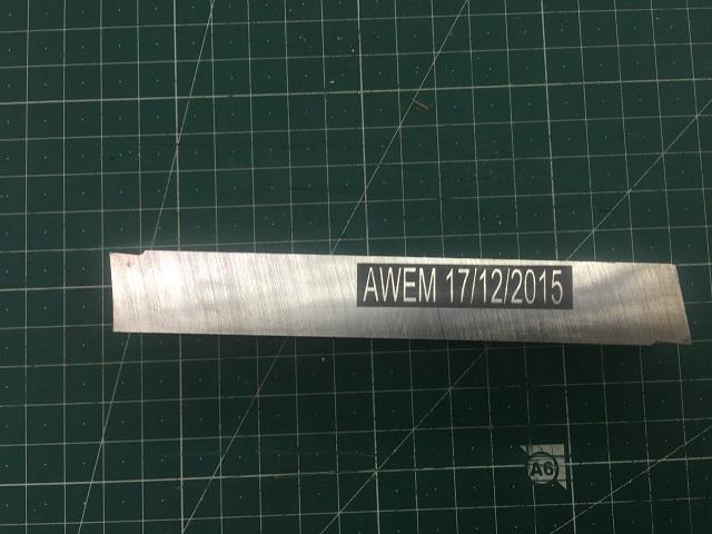

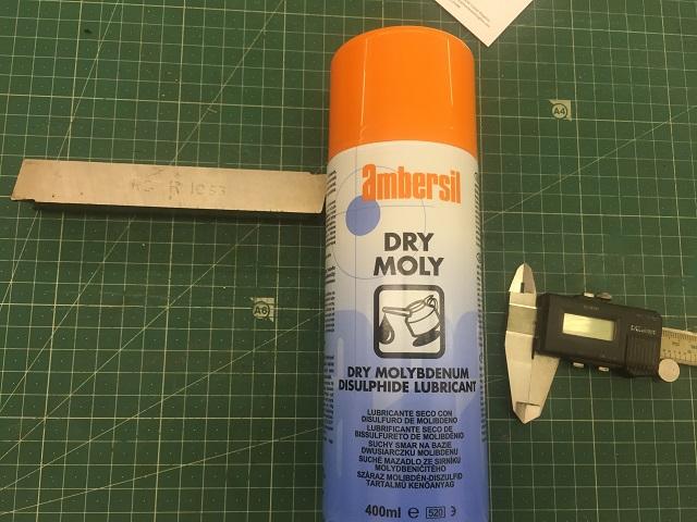

Cheap imported 50 watt laser engraver / cutters won't cut metals, or engrave them without jumping through hoops. There is a hugely expensive spray, meant for marking steel with a laser, that contains exotic ceramic materials that the laser presumably fuses and effectively marks the steel. But it also marks you wallet at £100 per aerosol can  :bugeye:
On another forum John Stevenson mentioned that he'd been using Ambersil 'Dry Moly' for the same purpose and it was effective. As this is far less expensive (I paid £14.99 including postage) I thought it worth a try, and ordered some, which arrived today.
The 'Dry Moly' is resin bonded according to the can - possibly it's the resin rather than the molybdenum disulphide that's doing the work, but hey, it works so I thought I show you the results.
This is a 20 mm square HSS form tool that according to the date I put on it, I've had since at least 9/4/89 as I've marked it with an electric Actograph pen with that date. How things have progress since 1989 in the home workshop  :ddb:
The result seems quite durable but I've not tried to scrape it off yet !

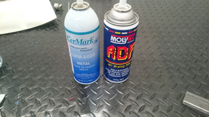

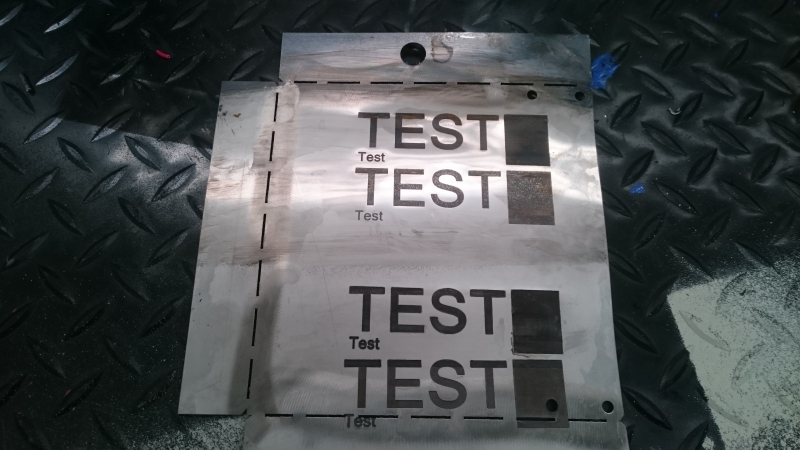

So I said I'd do a comparison when the dry moly spray got here.  Well it never did. After about a month, a can of PCB lacquer turned up from Farnell! WTF?
Anyhow, I found this other stuff at the local nut and bolt shop, it appears to be MDS in an acrylic binder. I figure the binder isn't going to last more than a milisecond under the laser so I grabbed a can at AU$36
Sitting next to it is a can of CerMark LMM-6000. this is the stuff we use on our products and it comes in at the bargain price of only AU$165 per can.

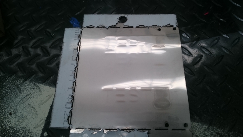

The test
I did 2 tests on each spray, both at max power, one at 20mm/s one at 60mm/s (which is the speed we normally mark at) on a 120W CO2 Laser.
The substrate was some 0.8mm stainless sheet.
The top to are the MDS spray, the bottom two the CerMark.
Nb, by the time of the last test (60mm/s on the CerMark) the steel was quite warped
So it didn't turn out quite as well as our production work.
So it looks like the statement "Dry Moly spray gives results that are almost as good as the expensive marking compound for a fraction of the price." holds true. Unfortunately for us we're always chasing a high quality mark so we'll be sticking to the CerMark...

« Reply #13 on: June 14, 2016, 02:22:50 AM »
Not sure what we are seeing here PK. In your first picture both upper and lower tests look to have come out well, and in your second picture both seem to have been erased  :scratch:
Offline PK
  • Posts: 369
Re: Laser Marking Steel
« Reply #14 on: June 14, 2016, 03:17:06 AM »
The bottom pair are noticably darker in the flesh. It's more pronounced at the 60mm/s speed.
The bottom picture is of the back of the sheet showing the distortion caused by the amount of heat that went into it.

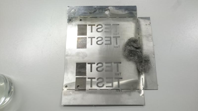

So here's the abrasion test. I used some OOO steel wool and scrubbed as hard as I could for a minute or so.
All the tests Held up about the same and pretty well I reckon.

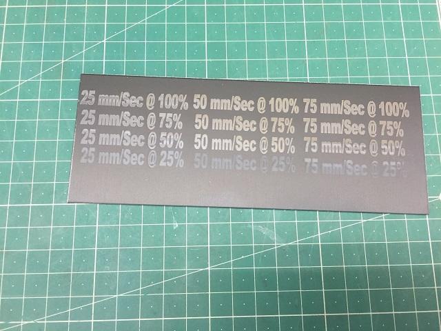

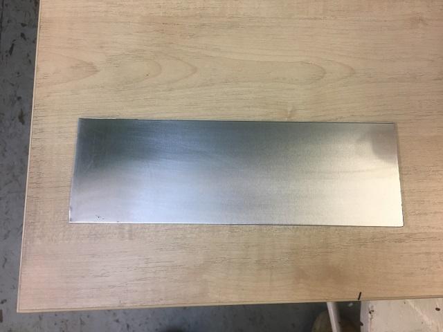

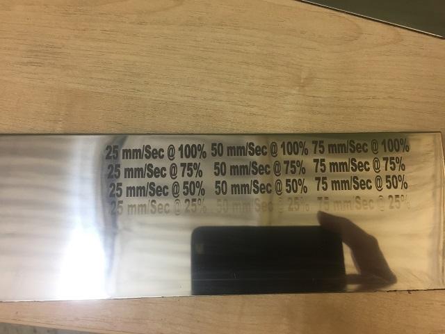

I'm reviving this thread as I've been doing a bit more work on the subject.
I needed to make a label for my Flail Mower - chose to use Aluminium, and totally failed to produce a result. Ended up using non-optimal settings on Stainless Steel resulting is it taking over 6 hours to scan / laser a label. Hence wanting to see what's what and find some optimal conditions to use in the future.
Now my Laser Engraver is a 60 watt model so if you are using a different one you'll need to scale things accordingly.
First I produced a set of twelve sets of text, defined with power ratings ranging from 25% to 100& and travel speeds of 25 mm/Sec up to 75 mm/Sec
Then I prepared a sheet of aluminium, sprayed it with a good coat of 'Dry Moly' by Ambersil and lasered it. The theory is that the Moly bonds to the underlying surface when hit by the laser and any unbonded remnants are cleaned off with acetone.
The results confirmed my suspicion that this process does not work with Aluminium  :bang: As you can see NONE of the Moly bonded to the aluminium - zilch, nowt at any of a wide range of settings :scratch:

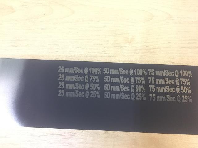

So now to repeat the process with Stainless Steel.
Good results this time - only a finished photo - sorry I forgot to take a pre-acetone cleaning one but it looked just like the Aluminium.
From my tests it seems that a travel speed of 75 mm/Sec with a laser power of 50% is the optimum for laser life and time taken - overall a good test and one I should have done years ago !
The resulting bonding seems VERY tough - I cannot scratch the 'blackness' off the substrate.
