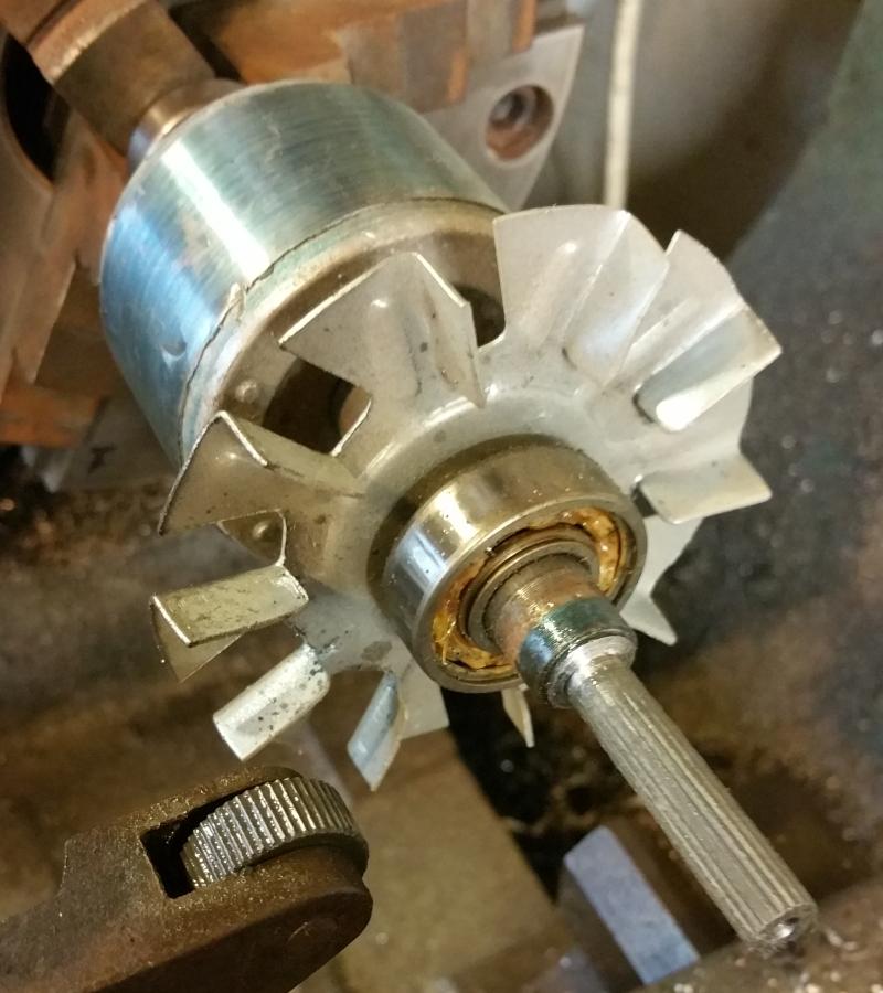

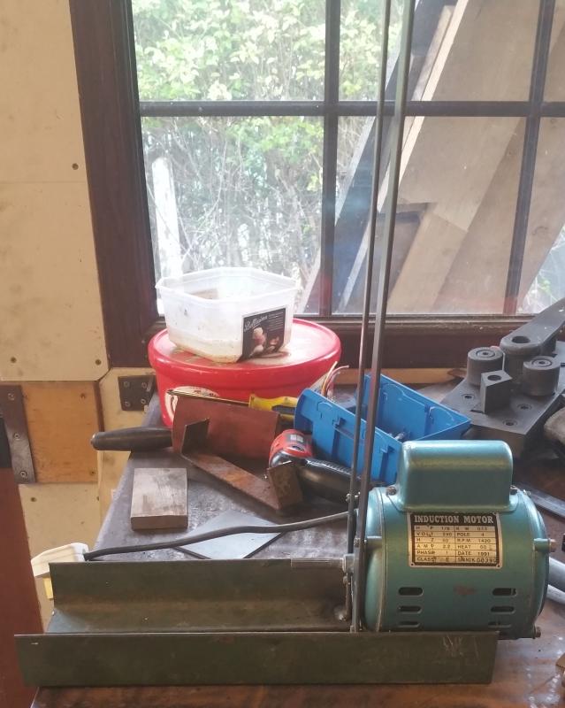

I waited a while before posting this because I wasnt even sure it would work but I am making a tumbler with the hope it will crush up some cat litter to use in casting sand.
Started by taking a little 1/6 hp motor from a cheapo piller drill, took it apart and turned the shaft down to 9mm before using my knurling tool to add some splines. (pic 1)

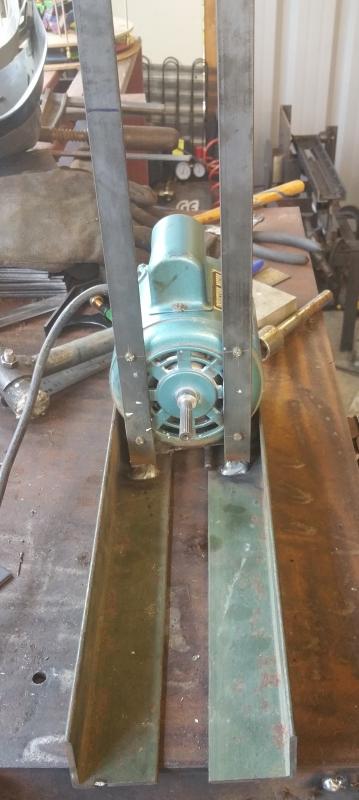

After that I made up a fixture for the motor with some scraps of angle (from a bed funnily enough) and some 3mm strip. (pics 2 and 3)

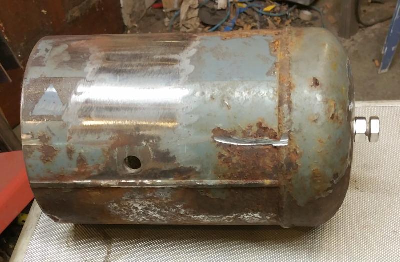

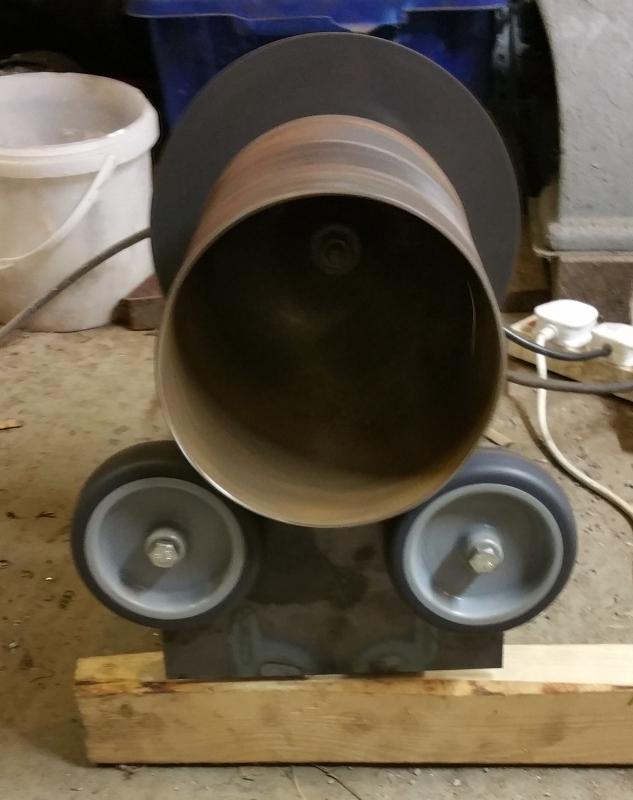

The tumbler itself is a receiver off a old compresser which I took to work and chopped the end off, then I put a couple of nuts and a bolt on the other end. Still need to fill a hole in the side. (pic 4)

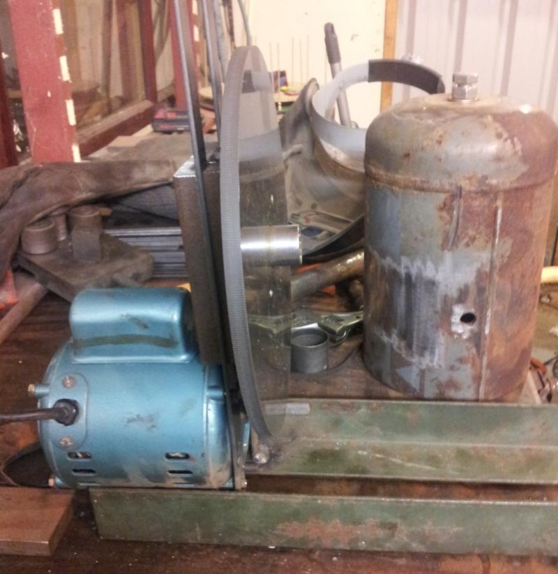

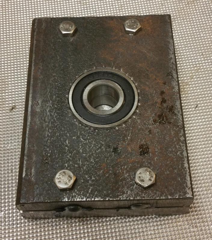

Not exactly sure what to name this bit but its two bits of of 120 X 90 X15 and again two bits of 3mm strip all bolted together to form a hub? that will slide free on the two bits of strip on the above fixture with two bearings inserted. (pic 5)

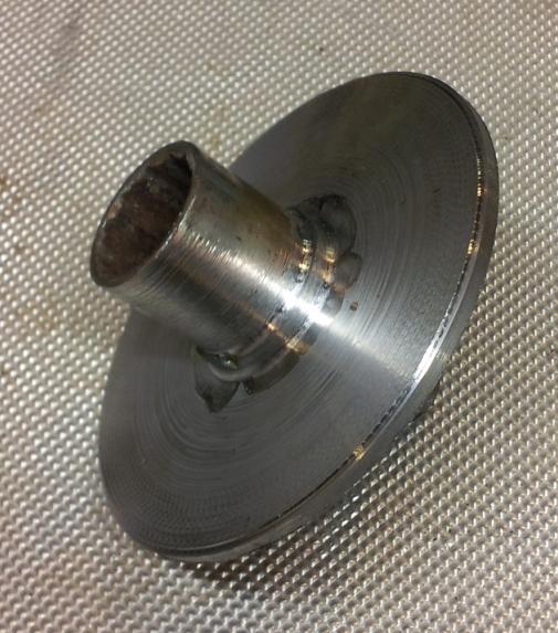

In which goes the drive dog which consists of a old 19mm socket welded to a shaft to fit the bearing and hold the plastic disc that run on the motor shaft. (pic 6 and 7)
Finally for now I welded a plate at the front of the fixture and mounted a couple of caster wheels for the front of the tumbler to run on. (pic 8)
still needs a little more work but here a test video  :ddb:

 :doh: I forgot to add the reason for the 19mm socket was so that the tumbler is not fixed and I can remove it for easy filling and emptying.
I also meant to ask if anyone thinks I should put some mixing fins inside to help stir things up a bit?
