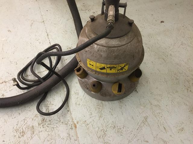

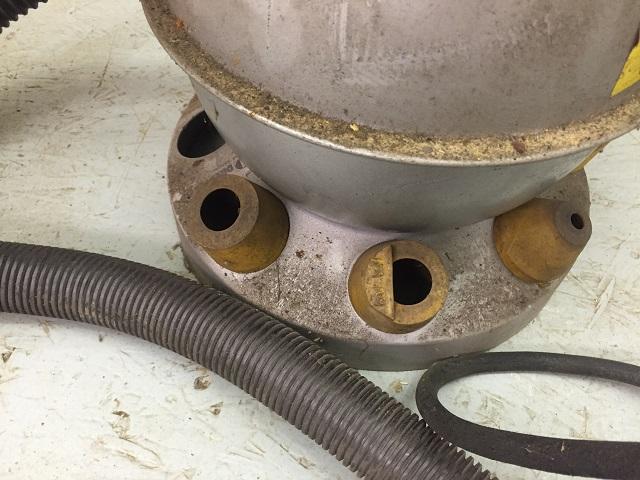

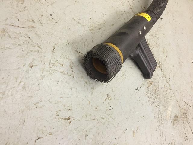

The little spherical tank was originally a sand blaster in it's own right. A gun using a compressed air line sucked the sand up by venturi action, and the used sand was sucked back into the pot by an attached vacuum cleaner down the outer of a co-axial tube, the centre of which was the 'sucked up sand' line. The blasting nozzle was surrounded by one of several shaped rubber cups that restrained the used sand. If you look at the 'skirt' of your tank, those holes were where different shaped rubber cups were stored. They were intended for small scale car rust removal - just small spots of rust - the shaped rubber cups were made to fit round things like door edges, and also there were flat ones for spots in the middle of a panel. Tediously slow to operate if doing more than the odd square inch.

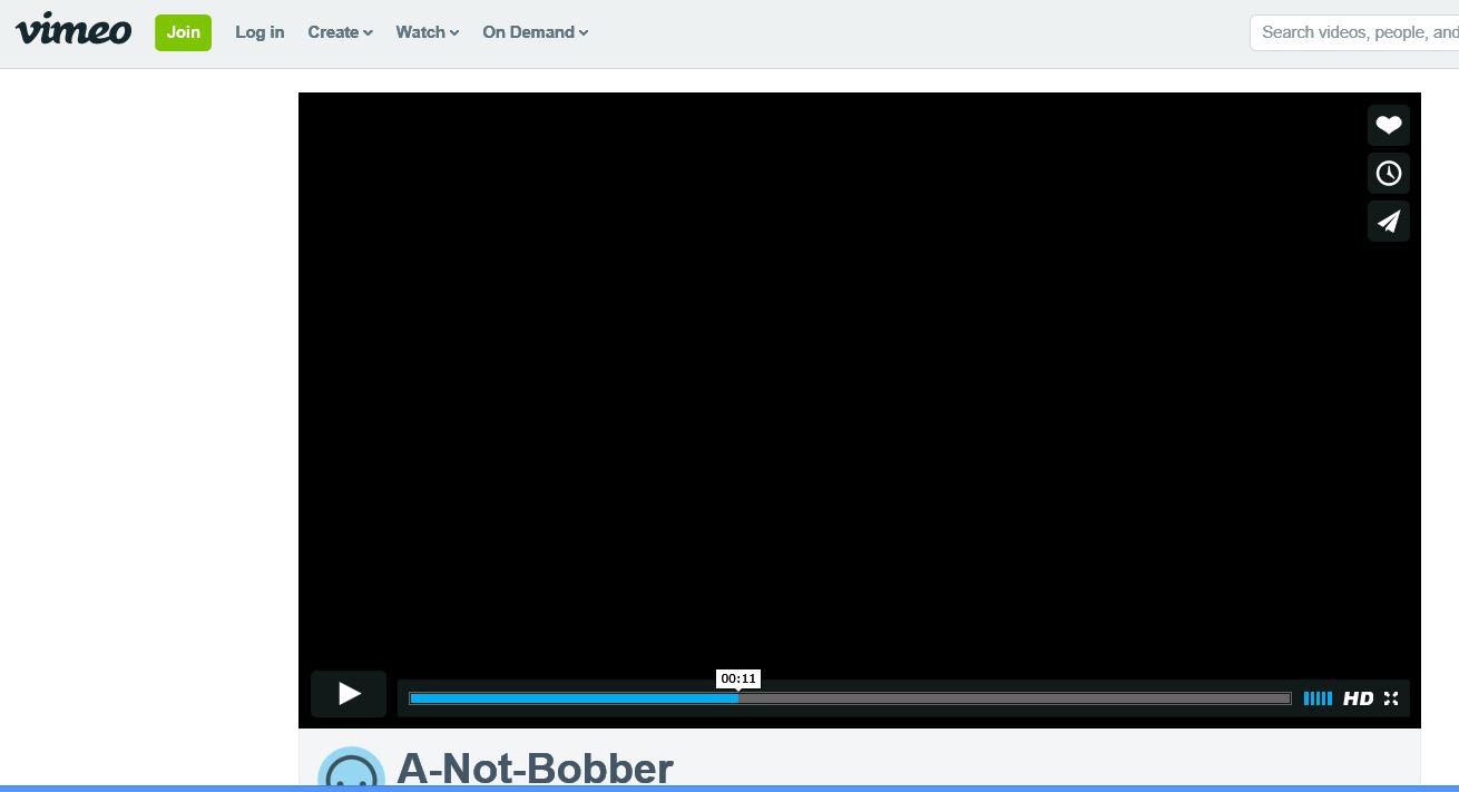

Works great once dried and cheap £2 a bag. It should perform totally different to the video. Give you some idea it must have took two minutes to do a spec of paint that with same gun can do in 5 seconds by altering the pickup.

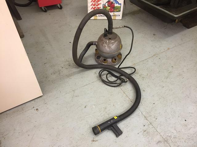

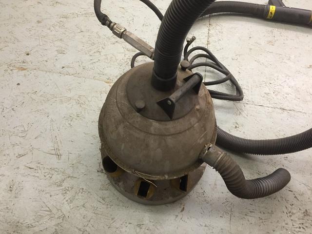

Re: Sandblaster project completed !
« Reply #13 on: January 02, 2016, 06:59:37 AM »
Ksor,
A blast from the past - I've been clearing some shelves, and discovered that I DIDN'T sell the little spherical spot blaster that we discussed back in July 2014 - it is the same as the tank you used in your blaster - so I thought that you'd be interested to see how it was originally.
There are various differently shaped nozzles that mask the area to be blasted, and the grit in vacuumed back into the tank
It's in a bit of a mess having sat in a box for 8 years unloved !!!
(Having a New Year clear out  :clap: )
« Reply #15 on: January 02, 2016, 02:13:35 PM »
I understand that it was originally sold for touching up car bodywork. Just blasting away the odd rust spot without creating a big mess. I'll probably fettle it a bit and get it working again, as it's a useful addition to the weapons  :clap:
Funny - I was convinced I'd let it go when I moved house, but found it when I needed more shelf space  :ddb:
