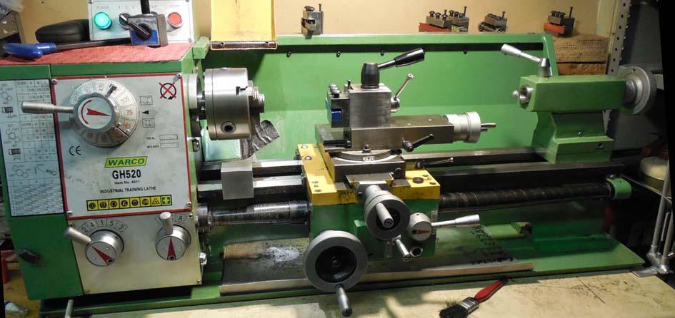

It would seem that like myself, most people aspire towards a QCTP as opposed to the 4 poster that comes as standard with our machines.
For my little wm180 I bought an Indian one, Soba I think, however when it came to my Warco GH520 with its 5 inch centre hight, I decided that something a little heavier was called for. After spending a few weeks looking round to see what was available both on ebay and in various web based shops, I started getting feeds to youtube videos showing how to make your own. Most of them were complicated double headed devices that were far beyond my ability and the ones to buy were quite expensive.
I decided the best thing to do was to design and build my own by adapting various ideas to fit my lathe and my needs. The first step was to decide on tool size and as I already had 16mm tools from the four poster that came with the machine, I thought I'd stick with that. Then I looked at a compromise of what sizes were popular for the body and tool holders and what size of stock was available at my local metal supermarket. I decided to make the main body from 70mm x 70mm  by 60mm mild steel and got a big lump of 50 X 50 to cut into 70mm lengths for the tool holders. Once I had the sizes I drew the rough plans on my computer and converted it into a pdf. I then discovered a  tool post simillar to mine, incorporating 60 degree dovetails, that was free of copyright on an educational website so used the drawings from that to make the tool holders.
I did most of the work on my AXMINSTER ZX30M MILL DRILL and the turning on my WM520 Lathe over a period of a few weeks but I'm well pleased with the results and it's as good as any I could have bought but at a fraction of the cost.
I've attached some photos of the finished Items but if anyone wants pdf plans I'd be hapy to post/email them, just ask.
Cheers, Griff.

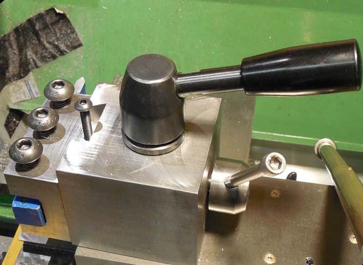

To be honest I wasn't sure the depth stop adjusting screw would stay put and was thinking of devising some kind of a knurled locking collar but none of them have moved and I could just as easily use a drop of non permanent thread locking compound in order to add a little friction.
Cheers, Griff.

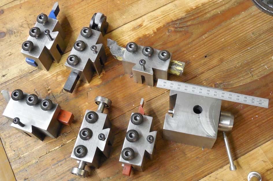

Yeah Jonny, Got a couple more feet of 2 x 2 square bar ready to make more holders but the six I have will do until I get into the new year. Got a bit of a backlog of work to get through at the minute.
I like the round centre post clamping type QCTP and almost chose that kind of design for mine James & Bill, but wasn't sure they'd be heavy duty enough for my WM520 lathe.

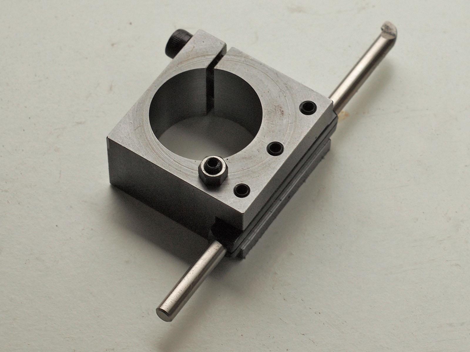

Hi G
It's for truing up your work on the lathe in a three jaw chuck before fully tightening the jaws.
Got the idea from John on you tube Sunday night night cap, I think he's double boost on this forum. Find him on you tube and you'll see how simple and clever it is to use.
I just turned the ends of some round mild steel bar down and fixed the bearings in place with lock tight, after milling a flat in order to clamp it into the tool holder.
I'll post a photo as soon as I get chance to get the camera out.
Cheers, Griff.

just a query on the height adjustment... does the end of the adj' screw not bear down on the locking piston/bolt end, in which case would a little brass plug inserted help prevent any damage,  or am I missing something   :scratch:

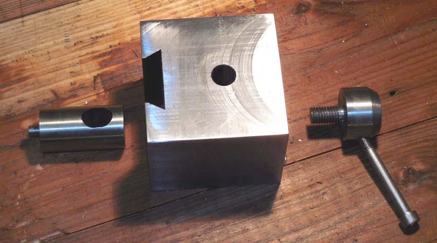

Hi George,
I would normally use a soft plug if the end if the adjusting screw was enclosed and if it was exerting a load but the end of the screw protrudes out of the threads so a plug would just drop out. Also the tool holder is unlocked when adjustment takes place and there is very little weight on the stop pin. Once adjusted, the tool holder is locked up tight against the dovetails, so again there is no load on the pin.
So far no damage or marking has occurred to the 6mm stop pin on the end of the piston, or the ends of any of the adjusting screws, although I agree there could be the possibility of damage to the ends of the threads if they were miss-handled. If this were to happen I would reduce and dome the ends of the adjusting screws where they touch the stop pin.
Despite any misgivings some may have, it is quite a heavy duty affair and it does work really very well. As soon as I get chance I'll post a photo of the whole thing dismantled, this may explain the above better than my words.

As promised, here is a photo to clarify how it goes together and how the plunger/piston works.
Cheers & all the best.
