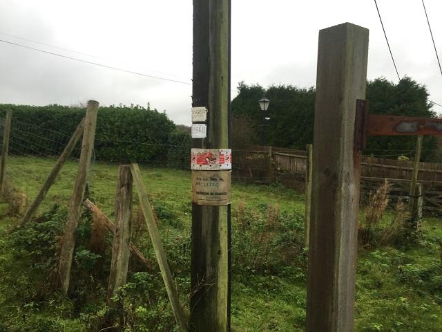

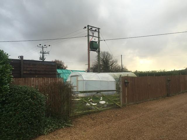

When we moved here eight years ago, I was aware that the mains voltage was quite high. Not really surprising, as we are supplied overhead by an 11kV three phase line, and the step down transformer to 415v three phase / 240v single phase is on our land.
This means that we are at the feed end of the cable, so if they are to allow for voltage drop to premises at the far end, we will inevitably be at the high end. Indeed, my barn / workshop is a direct cable from the transformer pole, and the farm house is 'one pole further downline', and typically there is a one volt difference in the mains between the two.
In the picture, the cable going to the left feeds only my barn / workshop, and the cable going right feeds the house then onwards to our neighbours half a mile away, and a small industrial estate.
« Last Edit: December 08, 2015, 11:28:55 AM by awemawson »

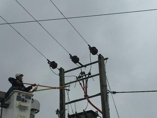

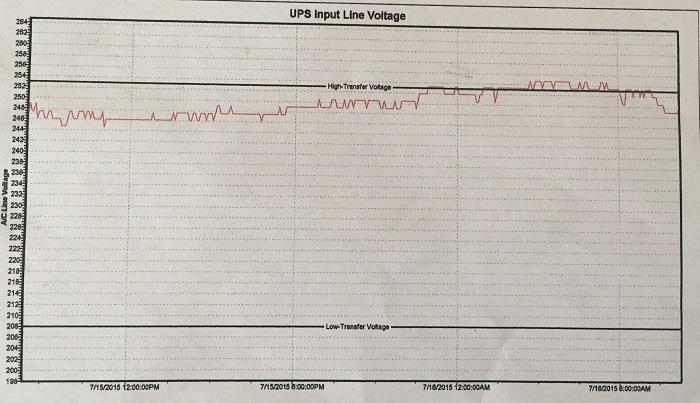

Now we've had problems with rather a lot of bulbs blowing, especially LED GU10's , but when I've measured the mains it's always been within the legal specification of 253 max.
However, when I fitted UPS's to the PC's, they continually monitor the voltage, and were giving me high voltage alarms. Plotting out the recorded data it was obvious that when the load was low 'down line' at night, in fact the volts were going as high as 256 and once 257.
I reported high voltage, and a 'UK Power Networks' man came out, measured, said it was in spec but on the high side, and although he couldn't act on my figures agreed to fit a voltage recorder for a week to see using their own calibrated instruments.
Sure enough his measurements exactly traced mine, so he went out to the transformer and inspected the 'tapping switch', which was set to the highest voltage. That's wrong he says, they should always be 'one tap down' or even more - I'll get it altered.

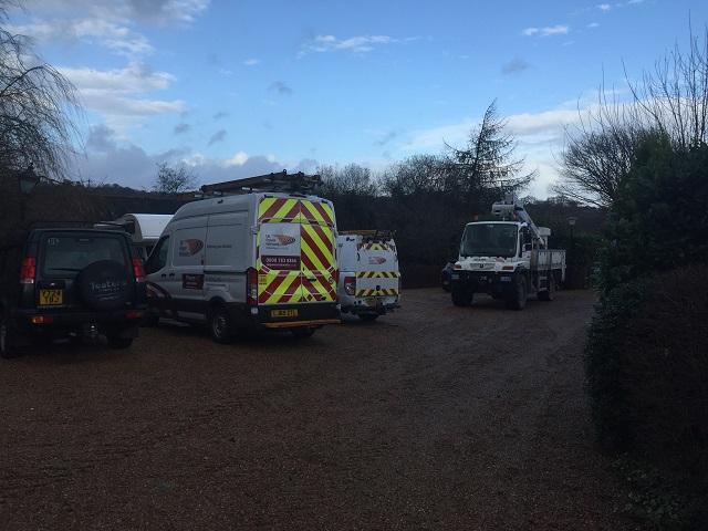

That was in early July. Since then we had a further five visits by various bits of the organisation 'just checking' resulting eventually in a notice through the door advising of a 'scheduled power cut' for today (8th December). Hooray - at last - about time.

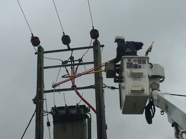

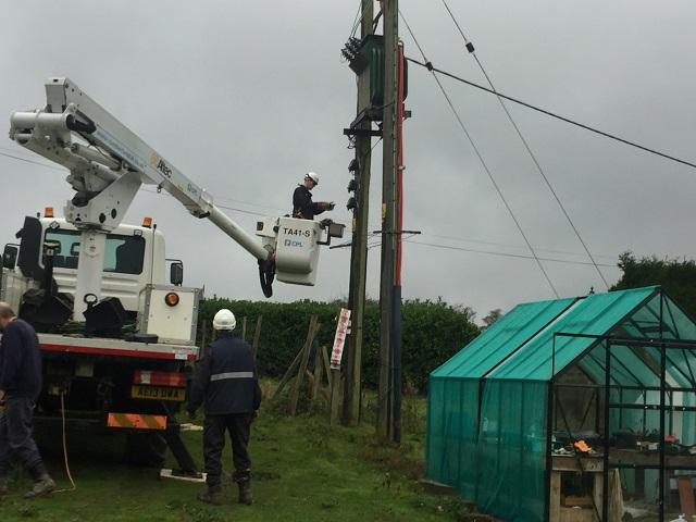

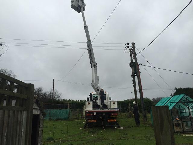

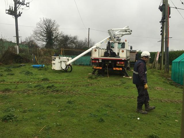

So 09:30 this morning a large Unimog access platform, and two vans arrived. First thing to do was set out a matrix of earth stakes and earth the Unimog, that had churned it's way into our goose field.
Then they pulled the LV (415v) 200 amp fuses on the transformer pole. Then they had to 'mark the pole' to stop anyone else re-fusing

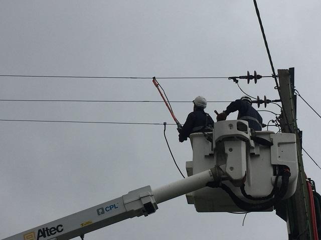

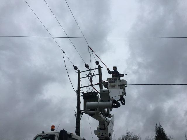

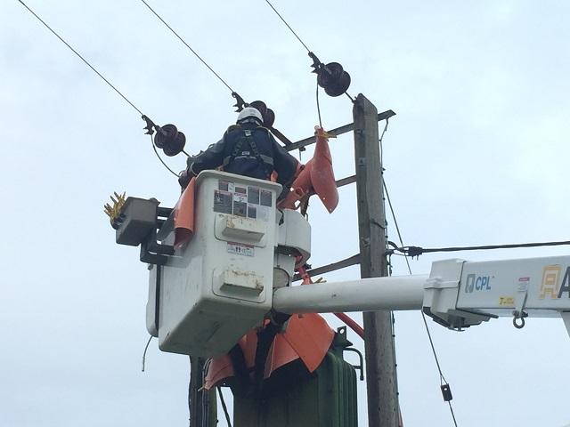

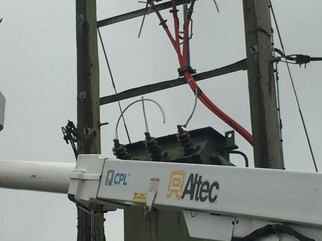

Next they chopped out a section of the feed cables from each phase of the 11kV overhead line down to the transformer - all done live using long fibreglass tools and rubber gloves.
Two man job, with one cutting the cable and the second grabbing the cut off bit to stop it falling onto the transformer

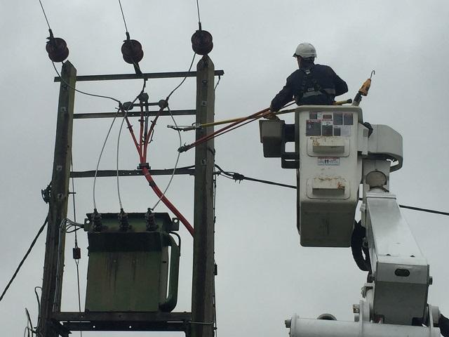

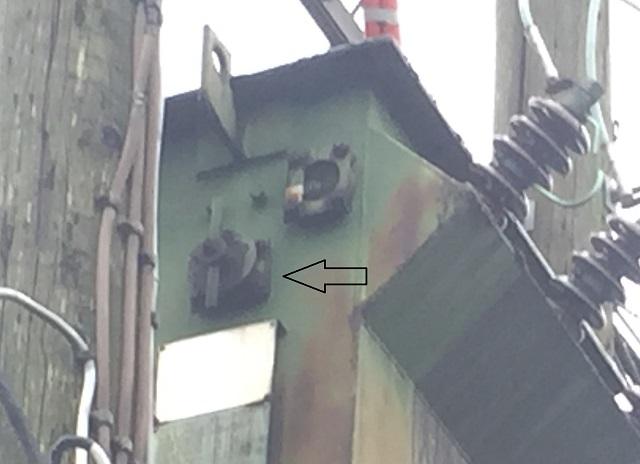

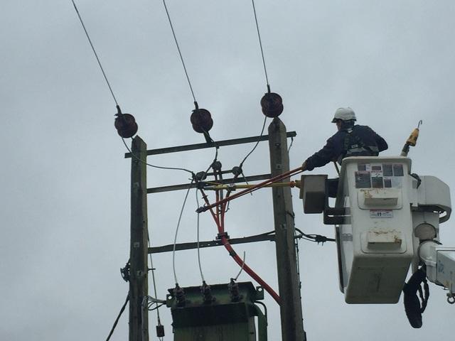

Then came the 'tap changing' - this transformer seems to date from the 1950's. The 'tap switch' was locked shut, but the lock got cut off with a big cutter. Then the chap trying to alter it convinced himself that it didn't 'feel right' - certainly there were no 'clunks' as it rotated - indeed it rotated apparently quite freely.
We had visions of something from the switch mechanism falling off inside the transformer, so having theoretically moved it two tap positions they decided to temporarily re-connect to measure the voltage (which had been 250 / 251 when they arrived)
Hooray - 240 volts phase to neutral - the switch must be ok  :ddb:

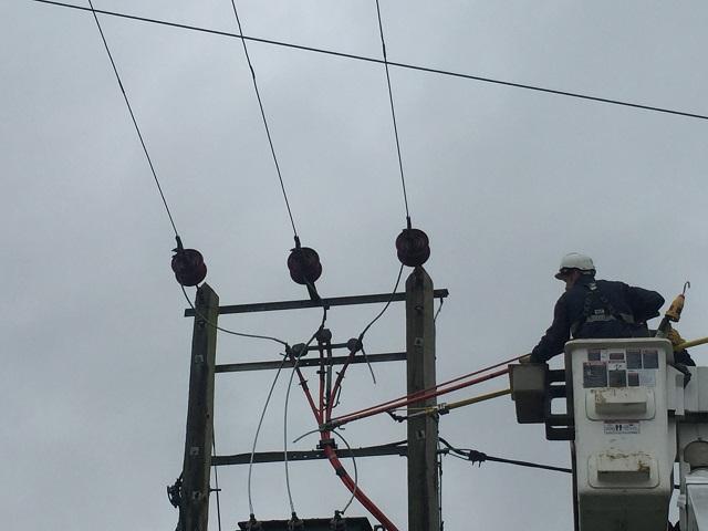

« Reply #6 on: December 08, 2015, 10:50:24 AM »
So then they could take off the temporary connections and re-crimp onto the stubs left where they cut the three phases.
To do this the various live cables were wrapped up in blanket red rubber  insulation, just in case something fell or went wrong

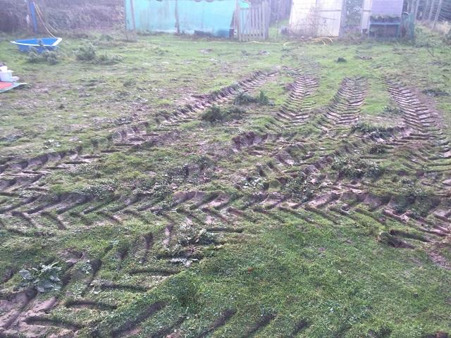

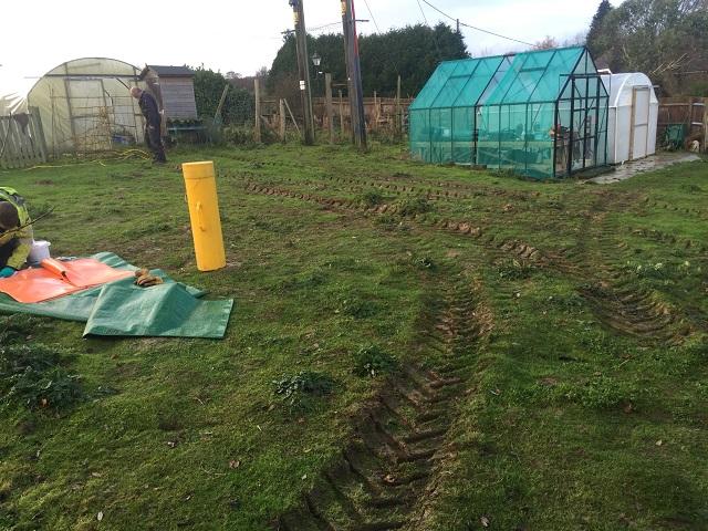

Then they moved their 'vehicle collection', back out into the yard to try and start trampling down the horrid mess they made - very soft clay soil that goose field  :bugeye:
Re: Too Many Volts
« Reply #7 on: December 08, 2015, 10:53:38 AM »
In fairness we've been offered a load of top soil and grass seed and a gang to spread it so they are trying to make things better !

WHen I first looked at your photos I was puzzled as to why they cut the droppers to the transformer ?
Then I noticed that theres a HV cable heading off underground, Is this the supply to the ind estate?
Usual method of isolating the trafo would be to pull the HV disconnect on the pole just before the trafo
Obviously they did not want to disrupt supply to the cable ??

The transformer is fed 11kV from two directions. There is the overhead route via that isolator that you have spotted on our boundary with the water pumping station, then there is the red cable running down the pole which crosses our drive underground, and goes across the A21 to another pole where it continues above ground.
The industrial estate is only fed 415 v three phase in the bundled cables to the right of the transformer that call first at our house where we take one phase at 240.
Incidentally the water pumping station has a three phase 415 v feed down the pole and into their premises under our vegetable patch for which I don't think they have a way leave, a fact I'll keep up my sleeve I case I need leverage in the future  :ddb:

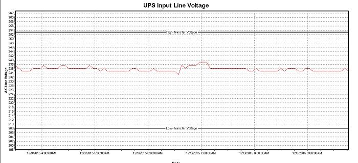

So I thought it'd be interesting to see the over night results from the UPS voltage recordings:
First picture as it was one night in July - significant over volts in the small hours
Second picture - last night - far more healthy
