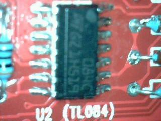

Very tempted to buy one oscilloscope kit. There does not seem to be external triggering. I was checkking the same type two channel scopes (could use another channel for triggering and it would show the trigger point on the screen) but they were whole lot more complicated or too expensive to justify.
I checked some readymade modules too, they don't look much better on display or sampling rate.

I guess you could duplicate the Y amp up to TP3
disconnect R13 from TP3 and add a switch to select Y or external trigger source
Oh, that will clear it!
I had wrong diagram! Found all relevat parts on:
DSO 138 Oscilloscope DIY Kit
Rev. 04 Applicable models: 13803K, 13804K
Starts to look very promissing!
Thank you very much!

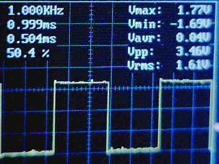

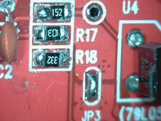

decided to assemble my DSO138 oscilloscope kit this afternoon
it worked first time even though the solder didn't flow that well on the surface mount components - an excuse to buy a smt work station I think ?
for now I've used the switches provided but may change them when I mount it in a box
modding is a must !
two things needs investigating
the variable capacitor C6 does not appear to do much
and the trace shows some noise from the power supply
http://forum.banggood.com/forum-topic-61279.html
added picture of screen showing the noise on the trace -
not too bad considering its a £15 kit
« Last Edit: January 22, 2016, 07:15:09 PM by John Swift »
Heat and flux are the key, use plenty of both and avoid lead free solder.
We keep a bag of 1000uF caps. Mostly for investigating these sorts of problems. But sometimes, on a one off job, they just get left in place.

Hi John ,
Some how I just knew you would find putting the DSO kit together to be a walk in the park  :thumbup:
do you think the noise problem is fixable ?
Oh yes modding is a must lol , when you find a source of good quality switches could you post a link to them please  so I may purchase some replacements   :dremel:
Cheers Rob
