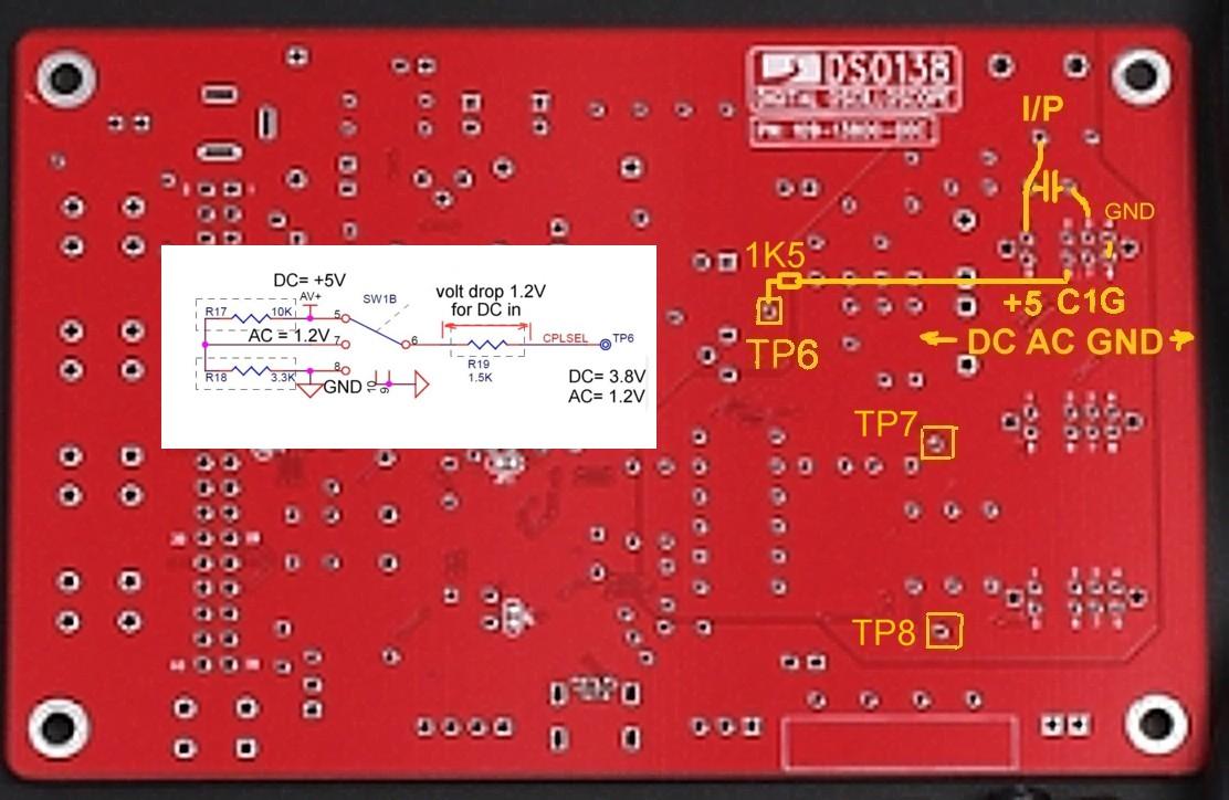

Hi Roy
the voltages measured will depend in the input current into pin 13 of the micro controller
but this picture shows  what I expect

Offline John Swift
  • Posts: 344
Re: Digital oscilloscope project/kit
« Reply #152 on: January 07, 2016, 10:12:16 AM »
Hi Roy
what did you re work to fix the original problem ?
with switch 1 grounding the input
pins 1 , 2,  3 , 4 on switch 2 (SEN1) should all be at 0V
 the switch common (pin2) is connected to the input pin 5 of the unity gain buffer U2B
the voltage at TP 2 should be the same
possibly a splash of solder is shorting some thing to the negative supply AV-
PS
how negative is TP2
just noticed U2 negative supply pin 11 is next to pin 10 U2C's input
 which is connected to switch SEN2 's common

Yippee.
I think I've fixed it.
the first thing I did was reflow R18, that fixed the AC problem.
I just reflowed pins 1 to 7 on IC U2 and all the voltages are correct now.
PHEW!
thanks for the help.
Roy.

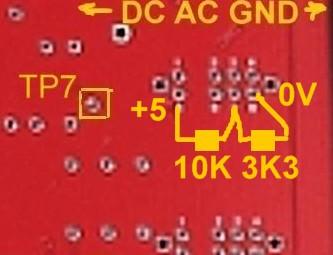

I am cracking on with mine but ran into a problem on the surface mounted resister 20. I couldnt get the solder to take and after a few tries the pad came loose.
It looked to me like the connection is to the large area under the R20 so I scratched a little of the paint away and bridged the solder to that but it would be nice if someone could confirm that this is the right thing.

« Reply #157 on: January 07, 2016, 04:57:28 PM »
I've not found a good photo showing the PCB without R20 and R21 fitted
but I've highlighted the connections you should have
If all else fails it should be possible to fit wire ended resistors directly to the terminals on switch SEN1 to replace the surface mount resistors

I suspect the resistors are the wrong way round....
Sure this doesn't belong in the "cruelty to apprentices" thread? :poke:

Yes that is what I meant...10k at the bottom, 3.3k at the top.....

Just to be clear here......
I thought you may have got the two resistors transposed, and that was why the readings were wrong....but as you said in a previous post, the joints were not good and you reflowed some of them.
So as the resistors appear to be correctly placed, that is the 10k is connected to 5v and the 3.3k is connected to 0v, the junction provides the third state for AC indication.....
As it is all working ok now, you dont need to fault find anymore.... :zap: :)

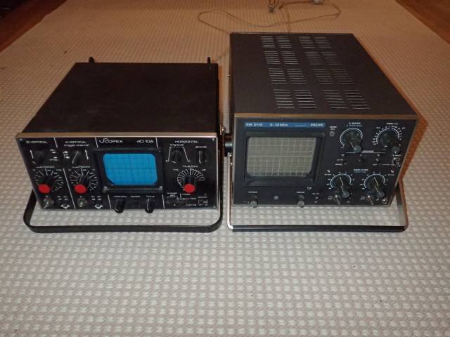

« Reply #172 on: January 09, 2016, 05:38:31 PM »
With a few more legs and a tyre you might have invented the wheel!
Mike
« Reply #173 on: January 09, 2016, 06:05:51 PM »
Clacking bell!
I was minding my own business, measuring DIY spotwelder controller with a transformer and doublecheccked each time all is fine....Then it got time to measure thyristor and ofcourse I checcked that scope body was "zero" and same "zero" that line that feeds the thyristors.
I put the shuko on  :zap:
Yup this outlet could go either way...I though I did not fiddle with it. Wife noticed that fuse blew, because outlet from that bedroom went off too. I was affraid that that I fried the scope, but noooooo.....Just good oldfachioned scope "ground" to phase error :doh: :doh: :doh:
OK. This scope is nowwhere as good as these beauties, but maybe it's easier to float.
Pretty german Phillips (Two tubes, othervice transistors) does not sync. I got one nearly as old UK made one and that mostrly works...
Where you get 1:1 and 1:10 scope probes?
