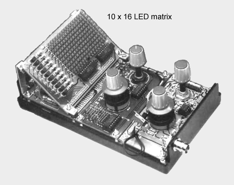

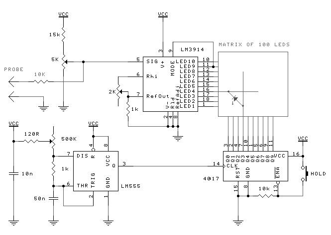

Hi Rob
a simple LED oscilloscope from 20 years ago
the circuit shows the principle
the 'scope in the  photo has an adjustable sync  , time base and attenuator
as expected in a usable  tool
the oscilloscope is usable up to 30 KHz

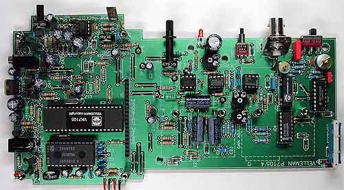

Hi Rob.
I've just finished building the scope kit and it all seems to work OK apart from one thing, the top l/h switch for AC, DC and ground, I can only get the display to indicate DC or ground.
have you any ideas what to look for?
cheers
Roy.

Hi Roy
All I can think of is you may have a faulty switch  ,
From pin 2 on the back of the board to the outer of the BNC plug ,
 http://i1066.photobucket.com/albums/u410/RobWilson100/Electronics%20Projects/1_zpskuqqpncw.jpgDigital oscilloscope project/kit
http://i1066.photobucket.com/albums/u410/RobWilson100/Electronics%20Projects/P1100791_zpschhqsxrb.jpgDigital oscilloscope project/kit
With the switch  in the Ground position you should have continuity .
http://i1066.photobucket.com/albums/u410/RobWilson100/Electronics%20Projects/P1100792_zpsmt90nwrp.jpgDigital oscilloscope project/kit
In AC or DC there will be a high resistance , if you still have continuity in these positions the switch is bust.
DSO  Manual attached for the pros to cast an eye over .
Hope that helps ,Rob

Rob,
I just checked the switch and I get what you say on pin 2, continuity to ground, high resistance on AC or DC.
why is there an arrow pointing to pin 4?
Roy.
Re: Digital oscilloscope project/kit
« Reply #143 on: January 06, 2016, 06:23:15 PM »
Rob,
Roy.
Hi Roy
 Pin 4 is connected to BNC outer ,it was easier/clearer  to use a crock clip on the connector and take the photo .
So its not the switch then . mmmmmmmm

Hi Roy
just double checking
when you say I can only get the display to indicate DC or ground.
do you mean it does not show "AC" at the bottom of the LCD
or the trace is a straight line
if its not indicating "AC" at the bottom of the LCD then check the voltage at test point TP6  ( switch 1B terminal 6 )
+5V for DC
 +1.2V  for AC
and 0V for GND
if its the trace not responding
check C1 is 0.1uF (marked 104)
if for instance a very small value capacitor that should be C2 , C3 , C5 or C7
virtually non of the AC voltage at the input connector will be passed onto  switch 1A terminal 3
Offline wheeltapper

Hi John, thanks for the reply.
It is the indicator on the LCD, it doesn't change to AC.
I was going to do some voltage checks as soon as real life gets out of the way. :bang:
I'll get back with the results.
Roy.

Thar's interesting, I'm getting 3.8v on AC.
I will look further.
Roy.

3.8v is too high....should be around 1.4v.....it looks like the software isnt switching as a result...
I suspect the resistors are the wrong way round....
You need to check the values of the resistors in the chain......
