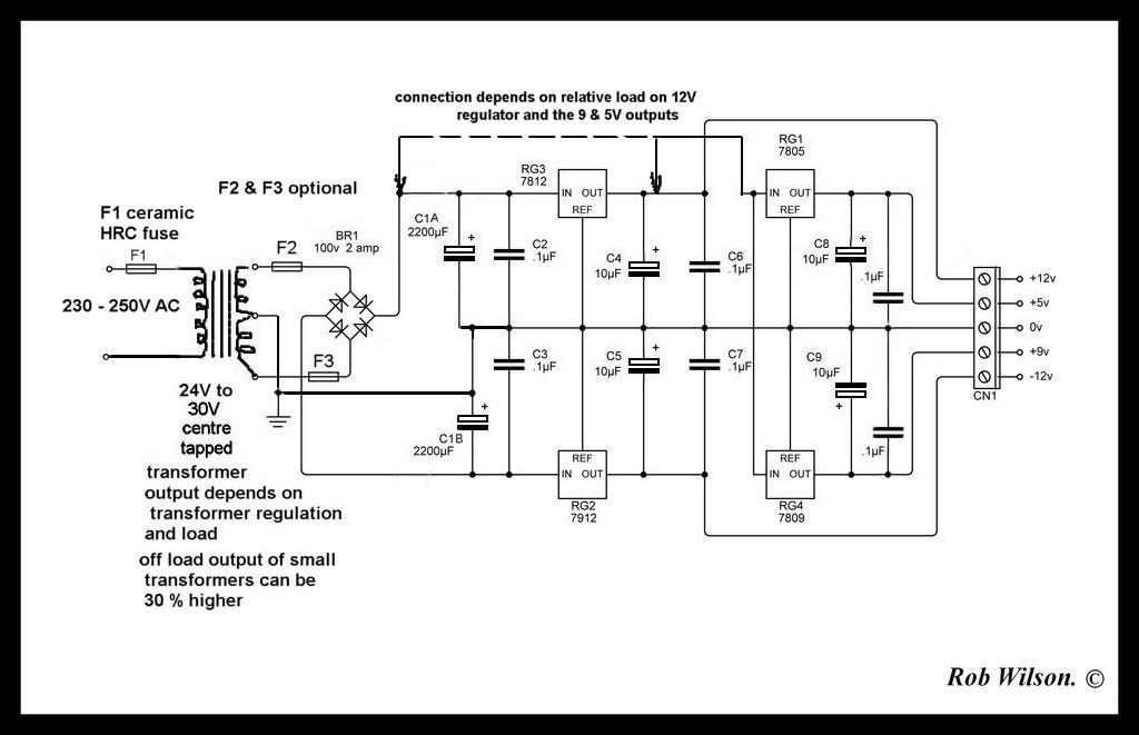

You've no business wiring up 79xx regulators arseaboutface, that's my favourite faff-up.  :D
BTW, you should really put a 100nF to ground close to the o/p pins on 78xx and 79xx ( and any other regulator for that matter ) otherwise they will tend to oscillate ..  :thumbup:

 :lol: :lol: Hi Dave I bet it will not be the last time I get a component arse about face  :Doh:
I will amend the circuit tomorrow as you suggest  :thumbup:  , I was wondering why I had a strange ripple  on the 9 volts out .

Something like this Dave  :wave:
http://i1066.photobucket.com/albums/u410/RobWilson100/Electronics%20Projects/Circuit%20Wizard%20-%20Power%20Supply_zps6bbyasg5.jpgDigital oscilloscope project/kit
I think I will change the output connector to -12, 0 , +5 ,+9, +12
cheers Rob  :beer:

« Reply #79 on: December 31, 2015, 09:38:45 AM »
Well, 100uF would maybe improve things, but ..... it's the high frequency instability which causes the grief. So, if you actually freakin' READ like what I have writted  100 nF ie. 0.1 uF ...   :D  :D
Electrolytics in general are not very good at getting shot of HF noise 'cos of their inherent construction. An el-cheapo ceramic is all you need. You can leave the 100uF caps. there. Won't harm anything.
Good day to you, Sir ...  :ddb:    Late lunch today ... starving ....
BTW
I think your 0V centre-tap should be grounded ??
And that is the symbol for a safety earth, ground is an inverted triangle.  :thumbup:
What current are you drawing from these regulators anyway? The 12V ic's. will have some 25V i/p, this gives about 13V dropped across them. If I assume the max. of 1A they will dissipate some 13W which is a lot for a TO220 package without a fairly large heat-sink and/or a fan. A 15 - 0 - 15 transformer would be a bit better ...

 :lol: :lol: :lol: :lol: I was full of the party spirits when I redrew it last night  Dave ,,,,,,,,,,,,,you try reading with a pint and a half of vodka and coke in you  :lol: :lol:  :beer:

oops I thought there was something else missing ,its grounded  :zap: ,, about 200 milli amps Dave
Have a butchers at the new new version PDF  :lol:

Well, my thoughts are:
The fuse is in the wrong position ......transformer primary would be better......
Not sure if there's sufficient headroom for the 9.0 v reg to work properly.....3.0v differential between in and out....close to the drop out voltage.....
If I were designing it, I'd be looking for around 16.0v in to the 12.0v reg, then connect the 9.0v to the 16.0 v supply....
A 15-0-15 transformer would be better as Dave says....I'd even try going as low as 12-0-12 to reduce the dissipation even further.....
Item 311 512 from   https://www.esr.co.uk/electronics/products/frame_transformers.htm

I will move the fuse , I should have had a question mark next to it .
I have at hand a 12-0-12 and a 18-0 -18 transformer  , the simulation did not like the 12-0-12 transformed ,no head room , and the simulator says I should get 9.74v  :scratch:
See new new new attachment lol
Cheers for the input lads  :thumbup:

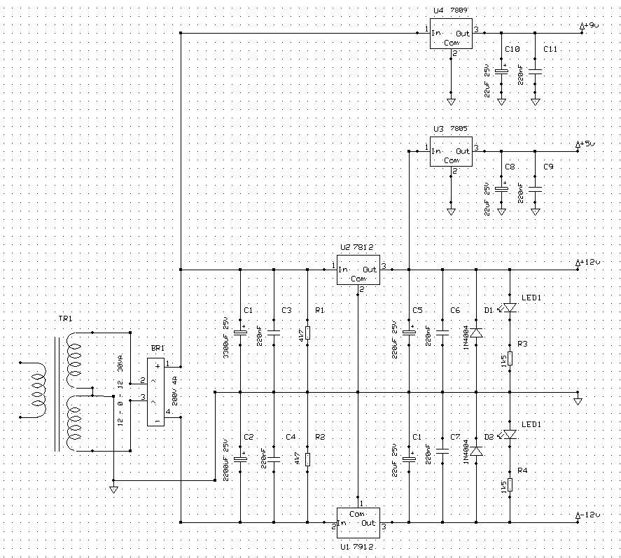

John is right, it will work with a 12 0 12 transformer .... depends somewhat on the VA rating ...  :thumbup: so what is the rating on the one you have ??
Why ??
OK. So, lets imagine we have a tranny 12 0 12 out at 24VA [for no other reason that it's easy to work out]  :thumbup:
24vac out 24VA gives 1 amp load current.
BUT  ... trannies here assume the EU nominal volts in to be 230vac  ... we're often nearer 245vac.
The output voltage is at the full rated load ! ie. 1 amp.
Now we come to LOAD REGULATION
On a relatively small tranny it won't be very good, at 24 VA it's probably about 12%.
Which means at no load the output volts will be 12% higher than the full load 24 vac ie. some 26 vac.
To compound the felony we are shoving more volts into it than the 230vac nominal.
The upshot of this tripe means we will get considerably more DC volts, AT SMALL LOADS, than we think.
Hence a 12 0 12 12VA tranny will be quite OK in practice even if your wretched simulator doesn't think so.
If you get one of these really titchy 3VA trannies and measure the no-load volts out you will be surprised [ at first anyway] they are often way above the advertised value  :zap:  but shove a 50mA load on them and they calm down.

There are a couple of reasons for putting the fuse in the pri,
1) it will blow if theres a short on the secondary or primary side......
2) the big 2200mfd cap will appear as a short circuit for a brief period as it charges up....depending on the fuse size, would cause it to blow...
Its moved John  :thumbup:

I've not been a big fan of sims.....much prefer to see what happens if approach.....
Best thing to do Rob, is lash up the circuit on some Vero board with the 12 v transformer and measure what comes out.....
If the usual approach of  V ac in x 1.414 is applied and subtract the Vdrop for the diodes, the actual output is usually different to the theoretical calculated..... :coffee:
The meter never lies.... :lol:

I have attached two files showing the regulator output voltages , one with an input of 12-0-12  and the other 18-0-18
The 12-0-12 gives out less than 12 volts  :scratch:

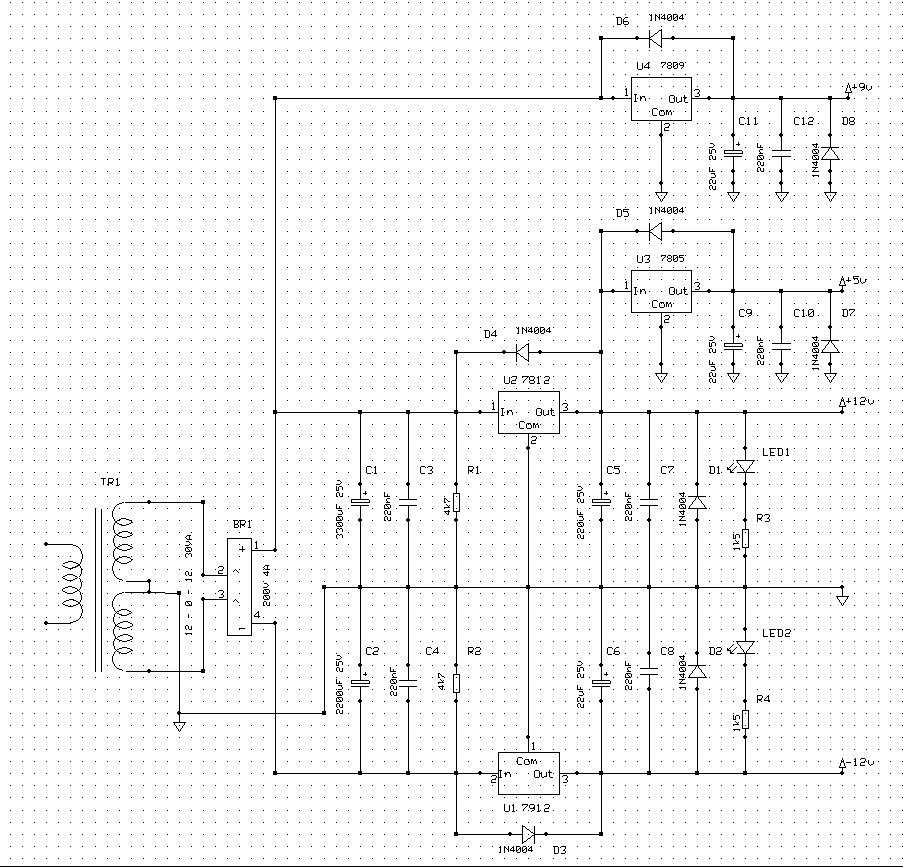

Found the schematic:
The bottom bit, ie. + / - 12V was the original I built.
I've added your 5V & 9V, think it's OK ...  :scratch:
I've upped C1 & C5 a bit to reflect greater load but I don't think its really required for your application.

Resistors are to discharge the 2200uF caps. Just considered good practice.
Diodes there to protect regulators from inadvertent connection of reverse voltage from external circuitry. [ If you use PSU for experimenting, anything can happen  :zap: Done it. Also, I did use the PSU to drive a small 24VDC motor, all sorts of spikey crap comes off them ].
You should really put more diodes across the regulators to prevent damage by putting volts on the o/p with no power to i/p. Regulators don't like it up 'em the wrong way ...  :thumbup:  I will amend schematic to show this. Also I notice some wrong component numbering ...

Amended schematic:
This sort of thing is quite common. They all do the same job. Take the 9V regulator.
[1] The 1N4004 across the output. If I shove a reverse voltage into the output, the diode will conduct and effectively prevent any reverse voltage greater than some 0.6V appearing across the o/p to 0V. The regulator lives on.
[2] The 1N4004 connected across the regulator, output to input. If I shove a normal polarity voltage into the output with no volts on the input, the diode will conduct and charge the input capacitor. The reverse voltage across the regulator is again limited to some 0.6V and again the regulator survives.
Regulators don't like outputs higher volts than inputs or outputs lower volts  than ground. They often exhibit their displeasure by snuffing it. Bugger eh ??
If you consider it's not going to happen D1 - D8 can be left off, no problem, it'll work just fine without.  :clap:
