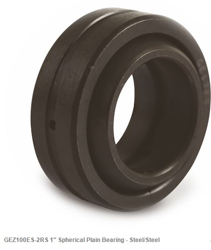

Not so much  'How do I?' as 'How do They?'
Prompted by my repairs to the steering ram on my Thwaites 4WD dumper, it prompts me to ask how the female half of a spherical bearing is made, and how do they put them together  :scratch:

« Reply #3 on: November 24, 2015, 06:55:14 PM »
Heat the outer race and chill the inner race.  Heat being about 600°F.  Chill being liquid nitrogen.  Then, act speedily.
Re: Making Female Spheres

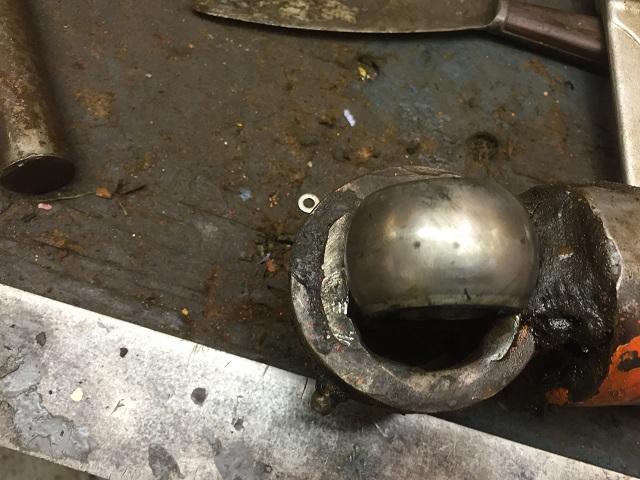

« Reply #4 on: November 24, 2015, 07:20:58 PM »
To dismantle turn the inner sphere so the inner and outer bores are at 90 degrees plane from each other and there is usually a pocket or flat on one side of the outer where the inner ball can be extracted/inserted. Much the same way that the bearing insert fits into a pillow block assembly.....OZ.

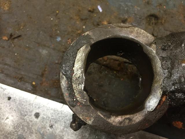

« Reply #5 on: November 25, 2015, 12:03:05 PM »
The outer ring is split ,look close , they just snap together  :thumbup:    ,,,,,,,,,,,,,but its an interesting point how are they made  :scratch:

« Reply #6 on: November 25, 2015, 06:29:34 PM »
Most of these are made from sintred steel and are formed in a mould under pessure.  The outers normaly have a crack so the inner can be fitted.
Abraham
« Reply #7 on: November 26, 2015, 02:47:13 AM »
Yes certainly the new ones have a single crack running in the bore direction.
