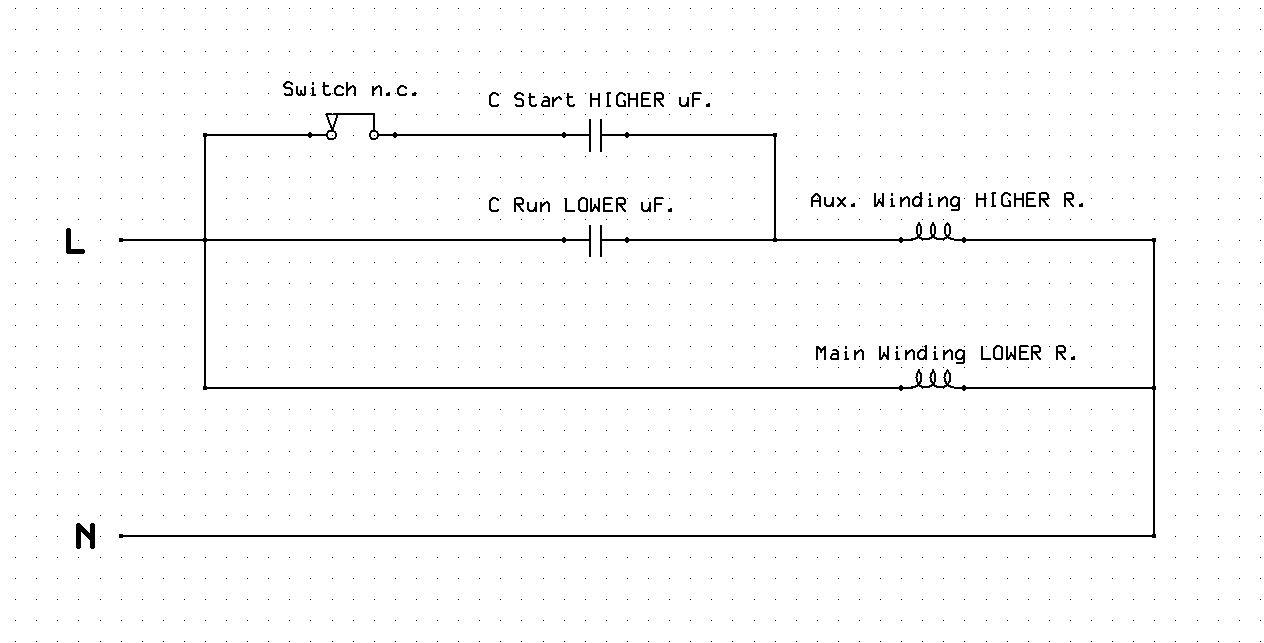

PS: is the run Cap the high or low number? :doh:
Re: Chester 626 Mill
« Reply #5 on: November 24, 2015, 05:33:35 AM »
Almost invariably the LOWER  value.   :thumbup:
( There is more than one way to wire a cap. start / run motor   :hammer:  depending on the whim of the designer, or what he was smoking at the time ...  :palm: ... but that is generally true ).
It may look like this:
