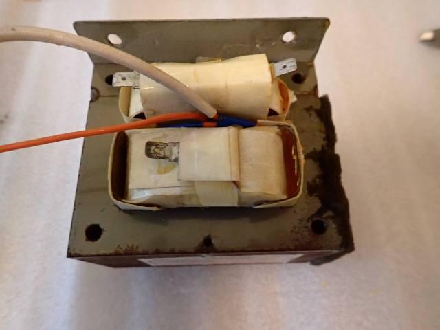

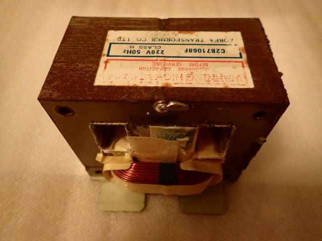

Ten years ago I read about MOT spot welders and confiscated one MOT from korean owen that was scraped.
Fast forward 10 years: I found that MOT when I was cleaning up garage and desided to find out if it works.
Has any of you build MOT spot welder? How much power you get out of it and what V/A?
I removed secondary and noticed that there are shunts between primary/secondary. Are these shuts good to have?
I put one round of solid copper wire on secondary and got about 1,6 VAC (per round, no load current was 3A on primary). One, two or three sounds of as thick cable I can cram in?
There are estimates on transformer VA-rating vs. core area. Are those estimates any use here or are they out of whack?
Plan is to check if this transformer is any good for small jobs and lab timer circuitry with it. There is a buzz box type welding machine waiting to be butchered for real attempt.

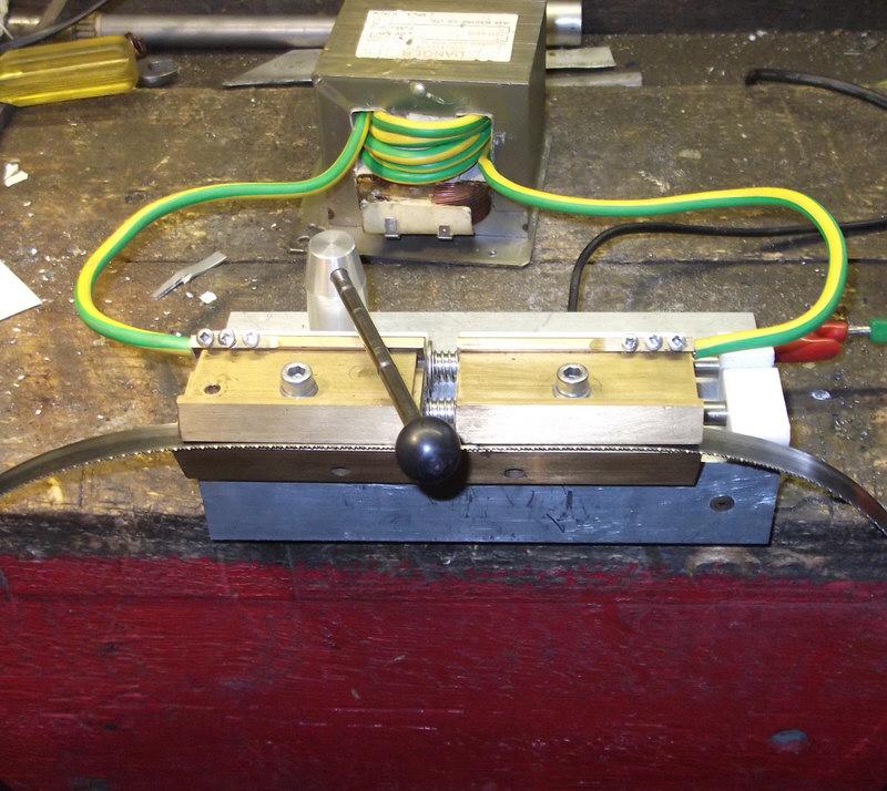

I've been playing around with a MW transformer making a bandsaw blade welder ( The butt weld mechanism has to be surprisingly accurate  - so far I have made two good welds from several feet of blade :LOL: )
Initially, I tried using a spot welder to power the blade welder, but the spot welder is low voltage (~1.7vac - one turn with a 230v primary) .The blade welder needs two or three turns ( I've been experimenting with more but 2-3 seemed to work best)
For a spot welder you'll need to mount the transformer as close to the jaws as possible to keep the resistance down. The current flow is huge: I measured way over 600A from a small hand-held spot welder.
Use the as much copper you can squeeze into the transformer gap (I'd use multiple strips lacquered or taped to insulate them ).

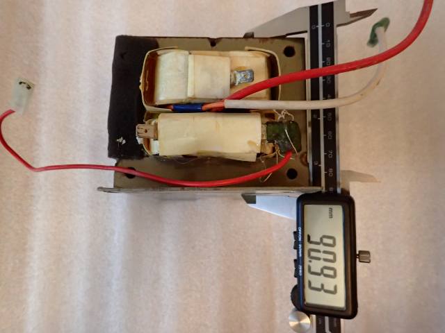

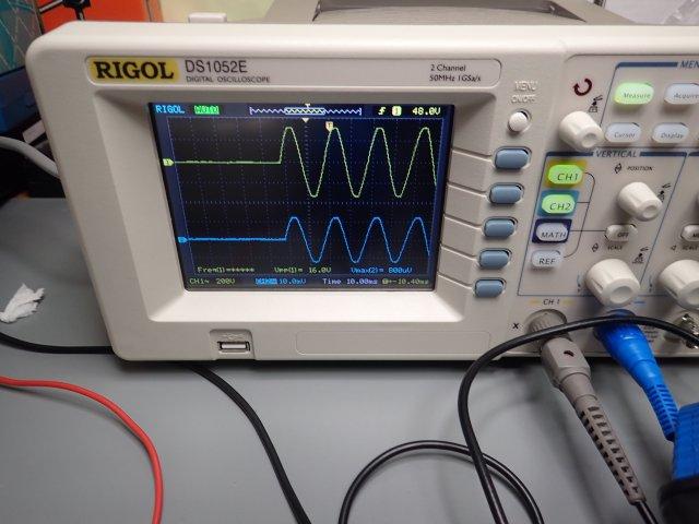

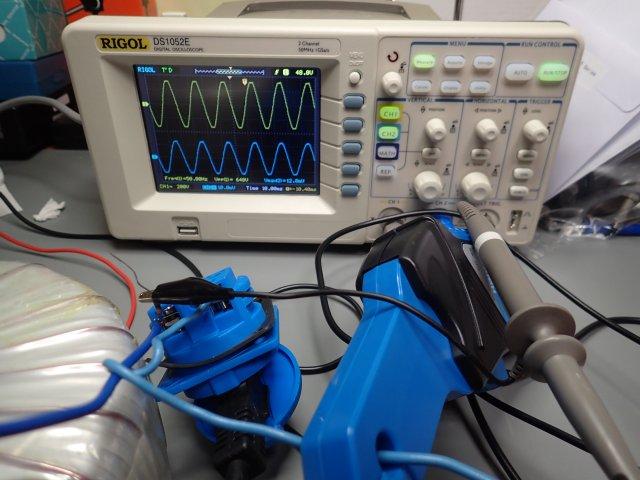

Quick measurement shows core cross section area of 22cm2, which quick&dirty formula says would produce 470 VA of power....
On spot welder dirty deeds done dirt cheap....what voltage (vs. amps) I should coax it, before something starts to smell?

The little piece of metal core between the windings act as a current reducer. Removing them increases the output current.

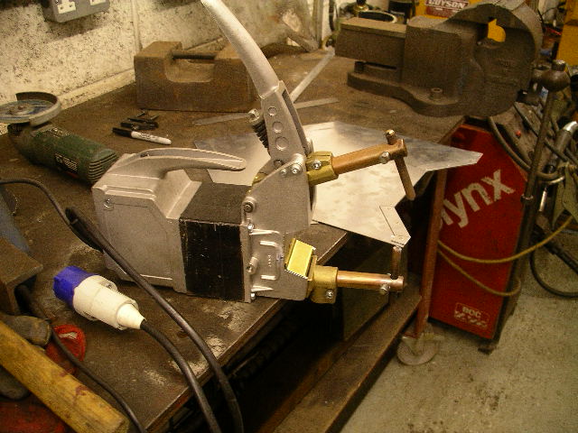

I had a spot welder for years to go with my then selection of other welding tackle. It was all sold on my present move but I bought a cheap scrap MIG for the hell of it. In another forum there was guy from Oz who had built much the same  thing but principally the arms etc were wood. Nevertheless, it was a fair idea for intermittent use. His arms went on fire.
I thought that there was a simpler and more reliable tool in a £40 arc welder and coupled with another £10 or so for a copper earthing rod, it was all quite practical  using scrap 1" square arms from an old table set of legs.

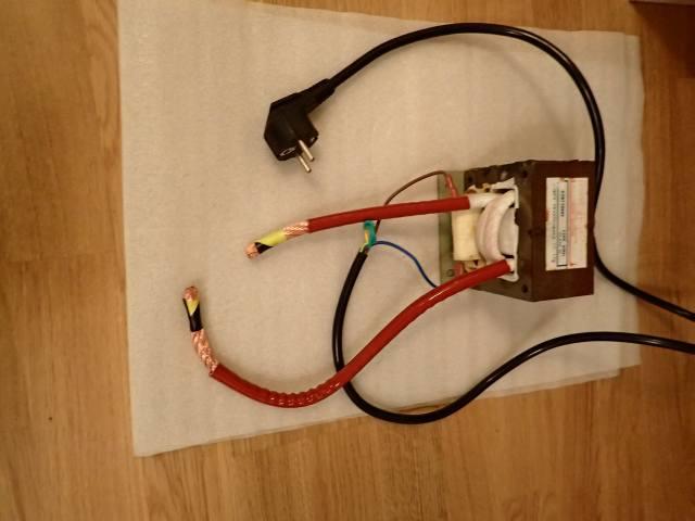

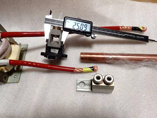

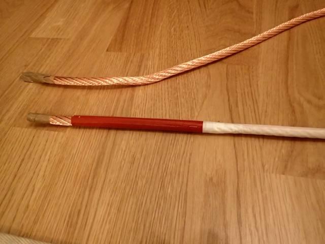

Old isulation had taken a little hit from secondry removal. Put some tape over the core.

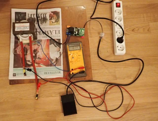

I was able cram 2 2/3 rounds of copper rope on the MOT. That produces 2,4 VAC unloaded on secondary. I measured less that sec partial secodary shot circuit (tried to make it short, but it buzzed and arched), primary pulled 14A and voltage dropped 230->220 VAC. Looks like this will do.
I wonder if copper grounding electrodes could be used as a welding arms or electrodes.

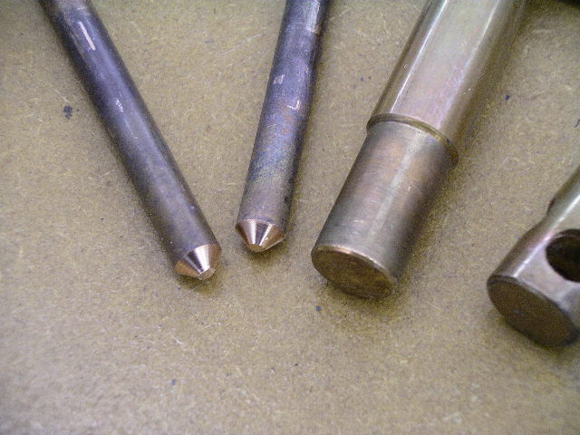

Andrew is perfectly correct in describing the joining process as a 'plug weld'.  It does get a bit pedantic when a spot welder has to melt its way through normally used galvanised body steel to create a joint and replace the anticorrosive properties of the zinc- which should- if you get it right- create an as new joint- with(( clears throat again) the same ability to be torn on impact rather than the incumbents. Its all in Thatcham, the exact number of spot welds to be replaced.

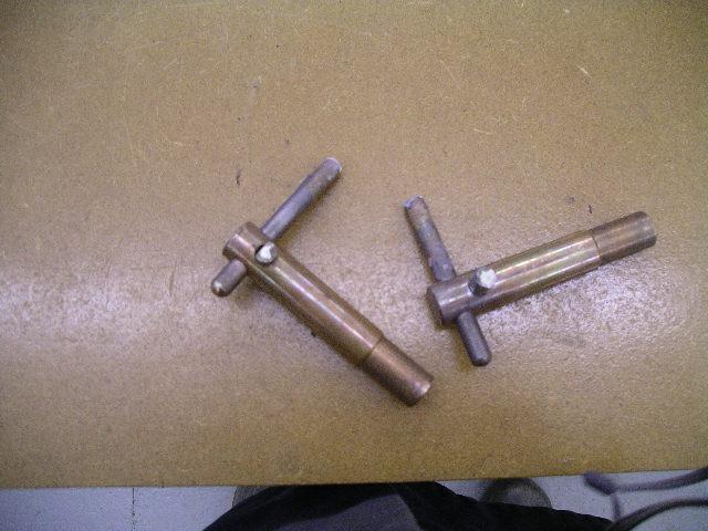

Regarding the spot welder, mine had the existing copper arms but with home turned inserts  but in order to reach more inaccessible spots, I made up a set of longer arms in copper with copper electrode tips. However, after discussion with the gurus at Gateshead College, it was suggested that the arms could have been made out of steel again with copper tips.
My present plans are inherently simpler and will utilise nothing more complicated that cheap and easily obtainable copper earth rods material which comes in 4 foot lengths which could have supplied the local Nissan factory where we obtained donor reject Nissan Primeras. Air hacksawing and stitching up almost pristine body panels  was a joy rather than a chore. I did, however, design and make welding clamps to hold the compound shapes.
Re: Microwave owen transformer spot welder?
« Reply #19 on: November 21, 2015, 07:41:43 AM »

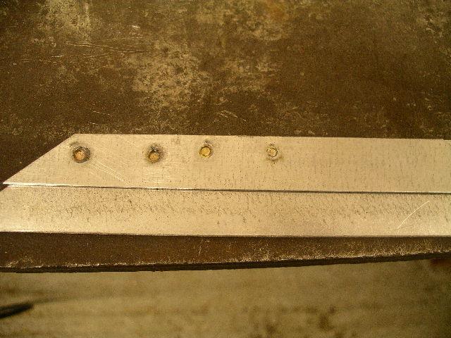

My spot welder, which is a hand held type,  has approximately 1" diam main arms and 1/4" electrodes. I am always amazed how hot the 1" arms get in use. I cannot believe that it is directly the current flowing in the 1" bar that is causing the heat. I suspect it is the resistance of the brass coupling to the body of the machine and the tips themselves whose heat is being conducted by the fat copper bars.

Oh, I never have used those small spot welders, they look a little special and probably something worth imitating.
If you do the math, there must be very little of restance on every joint, therefore my goal is to minimize number of components and connections on secondary. Plan is to terminate other end of the copper rope (secondary winding) on lower (fixed) arm and the other end to pivoting upper arm.
I was toying with the idea of using steel profile/pipe as arms and put the conductor iside of them, but big current here might interfere here and my intuition tells that this might be of complication.
Thanks to Andrew, I got a bag of M6 MIG wire tips, they feel like a good candidate for this small spot welder.
I have one grounding electrode, OD is about 13 mm and it looks like copper.

From a theoretical point of view, a straight line squash is best, but an arc should be fine, as the displacement is microscopic (or should be). I set mine up (with the power off !) to firmly nip the pieces together. Then adjust performance by varying the welding time. It often pays to do a few trials to check what time is best. In my test piece the one on the right is when I was happy with it functionally and cosmetically.
Clean electrodes help enormously  :clap:
The electrodes in mine are fixed using a tapered cotter in like the old bicycle pedals used but without the retaining nut, so they are just tapped in - rather crude but it seems to work.

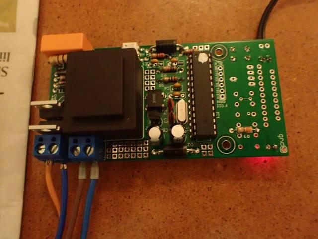

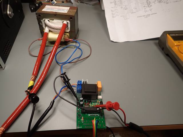

Another avenue: Which type of solid state relay to choose? I have used triacs with zero crossing switching...apparently not that great here: Highly inductive load.
« Reply #23 on: November 21, 2015, 02:59:10 PM »

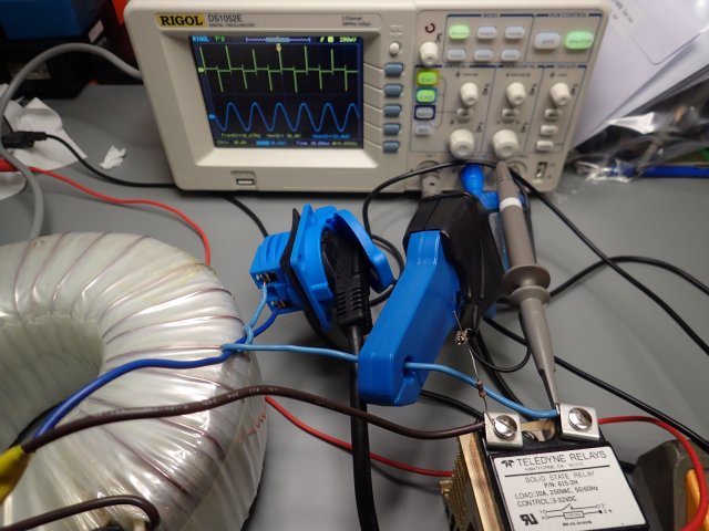

Assuming that you intend to switch the primary of your transformer (which I'm sure that you do), so long as you use a solid state relay that is very well over specified for the load you should be fine. Some useful gen here:
https://www.omron.com/ecb/products/pdf/precautions_ssr.pdf
« Reply #24 on: November 22, 2015, 03:41:57 AM »
Yesh...primary. And that one is chalenging eneough. Some swears on zero (voltage) crossing switching some swears at it. I tried to google answers and I got even more confused that I were before.
Like this, halfway down and not geting anywhere....
http://electronics.stackexchange.com/questions/181874/when-where-to-open-and-close-a-transformers-output
Finally I setled here:
http://www.automation.com/library/articles-white-papers/industrial-io/understanding-solid-state-relays
Transformers
In controlling transformers, the characteristics of the secondary load should be considered, because they reflect the effective load on the SSR. Voltage transients from secondary load circuits, similarly, are frequent in transformers and can be imposed on the SSR. Transformers present a problem in that, depending on the state of the transformer flux at the time of turn-off, the transformer may saturate during the first half cycle of subsequently applied voltage. This saturation can impose a very large current (10 to 100 times rated typical) on the SSR that far exceeds its half-cycle surge rating. SSRs having random turn-on may have a better chance of survival than a zero cross turn-on device, for they commonly require the transformer to support only a portion of the first half cycle of the voltage. On the other hand, a random turn-on device will frequently close at the zero cross point, and then the SSR must sustain the worst-case saturation current. A zero cross turn-on device has the advantage that it turns on in a known mode and will immediately demonstrate the worst-case condition. The use of a current shunt and an oscilloscope is recommended to verify that the half-cycle surge capability is not exceeded.
A typical approach in applying a SSR to a transformer load is to select a SSR having a half-cycle current surge rating greater than the maximum applied line voltage divided by the transformer primary resistance. The primary resistance is usually easily measured and can be relied on as minimum impedance, limiting the first half cycle of inrush current. The presence of some residual flux, plus the saturated reactance of the primary, will then further limit, in the worst case, the half-cycle surge safely within the surge rating of the SSR.
Although. I was about to give it up ans use a contactor and RC-snubber (that's hard eneoug..)
Oh, and I found this, but those rocks looks diminutive.
http://www.avdweb.nl/Article_files/Tech-tips/Spot-welder/Spot-welder-controller-circuit.jpg
http://www.avdweb.nl/arduino/hardware-interfacing/spot-welder-controller.html
Second link confirms of switching SCR:s on near maximum voltage.

Got yesterday 20 mm copper rod and big enough CU/AL connectors. They are pretty nice, all data is available down to screw torque.
I found out that grounding "copper" rods are steel rods, that are plated with copper....
Found out place that sells spot welder electrode rods by metre (or even pieces). They have 8,10 and 12 mm at the small end.
Postal service is on strike......

Ok. Got 1 metre of 10 mm spot welding electrode rod and 1,5 metres of 12 mm diameter. Those were smalles amount (cutoffs....) from the welding supply shop that deals with individuals here.

I have a concept for mechanics, I was going to rocker type. Mainly because of the simplicity and I don't need high cycle time. However the pneumatic cylinder I have is too smal for normal rocker, I need to make swing arm to have eneough force and to keep the whole contraption compact.
I have two problems:
1) How to hook up the current from tranny to electrode holder
2) How to make the electode holder adjustable and I would like very much to able to adjust the holder position and to swap the holder and to turn it over (other end having 90 degree mount for electrode and other 45 degree or special).
Both would be simple if I had two big chuncks of copper. Big square piece, 20 mm bore for electrode holder and four bolt mount. Really elegant solution. Copper has excelent electrical and mechanical properties for this part. But I don't have it, nor I can easily get one!
I was considering similar construction of aluminium, I have it, easy to machine and I have a special clamps to connect copper cable to aluminium. Main problem I have is that I don't believe there is a good enough electrical contact between this aluminium bar and 20 mm copper bar (electrode holder).
I was thinking of "tinning" the 20 mm hole (for electrode holder) in this aluminium block, but I never have soldered aluminium and googling it produced mainly special fluxes and solders that seems proprietary, expensive, dubious mixtures of mainly tin and rest of it mainly zink....resulting in about 25% conductivity of the aluminium. Could aswell use steel or brass....equally bad results and wole lot cheaper.
Only way I can think of using the aluminium mount, is to make a sleeve of copper tube. Standard sixe OD22, ID 20 would be close enough and probably could get two metre piece without breaking the bank. This thin sleeve should work well when clampd between rod and split block, and still have enough of cross section area to conduct the current.
There might even be insulator material that would survive between the copper sleeve and aluminium block?
Is there a problem I don't see or would this work?

ONE person said that he has 30*10 mm copper buss barrs....length 2400 mm! I'm pretty sure that is pricey. But it's only 90 km (one way). Not too bad.
Now...If I would cut a 40 mm piece of that bar and make a v-groove for electrode holder. Multistrand cable is easy to attach on that coppe piece, no problem there, but would this two 40 long line contacts give enough cross sectin for the current? Probably yes.
Another idea is to make close fitting 20 hole + slit other side onto piece of this buss bar for the electrode holder and cut a little (17*10*20 mm) lug for the cable connector. This would only work as an connector and there would be a separate mechanical split holder for the arm.
Tonight I'm going to order some electrical parts for the controller.

I'm having a bit of trouble picturing your current troubles, but I've thrown in some possibly useful idea starters below.
I am electrical engineer and I have some experience on various systems. Therefore I'm little apprehensive when I push componenets beyond their intended use. The way low voltage circuit works on resistance spot welding machine is simple on most of the aspects, but there was very little at the university that prepared me to work few volts and thousands of amps...
Right now I'm consentrating on a bit that connects secondary coil conductor on the stationary and moving electrode holder.
The conductor has very fine multistrand braid, about 35mm2, should be fine for short pulse of 1100A.
Electrode holder is 20 mm pure copper bar used on electrical cabinet construction.
This piece has two functions:
1) To connect tranny secondary to electrode holder with minimal resistance, this is not one time operation, but must allow mechanical adjustment.
2) Mechanical: Attach mechanically bar to arm.
This is a small part, maximum linear dimenssion 40 mm, 20 mm hole trough it.

Oh, and I got a piece of copper tube ID 20 mm and outside 22 mm, tried and it is a nice sliding fit. About 66m2 of cross section area if I need to go that way.

« Reply #47 on: January 04, 2016, 03:38:10 PM »
Got electrical board ready and tested on open secondary. Seems to work.
Has been too cold to work on mechanics.
A little progress.

And the electrical parts looks pretty much like this.
Just wonder how to measure thysristors on the circuit. Have to take oscilloscope out of the shelf and power it up.

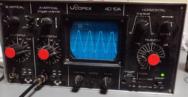

Got one old UK-made 10MHz scope for free and nearly fried it today....
Got some measurements done. Have to dig up and connect my isolation transformer somewhere.
Have to get some probes and acessories.

OK. ordered one hal conraption that might get me somewhere on current measurements, this type, but different shop:
http://www.amazon.com/Hantek%C2%AE-Current-Clamp-kHz-20mA/dp/B00BLD6FB8
It's on the mail...I have palyed with hal clamps and transducers before...not having utmost trust on that one, but it IS isolated!
More questions:
1) Anyone found source for reliable shunt resistors (kelvin type)? No point of buying bad one measuremet, this one will be used for accurate measuremets and verify other measuremets.
2) Found few reasonable circuits for isolated differential probe, one way too much overspeck, but not too expensive BUT circuitboard would be a problem.
It's on the mail...I have palyed with hal clamps and transducers before...not having utmost trust on that one, but it IS isolated!...
Got it some time ago and it works! Pretty close on sine wave and it does shows if there are any triaks on the line.
I'm been reading and shifting some info on "floating" measuement and it still is as it used to be before: Needs very carefull concideration. Next measurement is going to be scope grounded, but DUT floating. Basically I'm grounding the DUT fairly close to return path anyway, therefore I should be able to to measure it without blowing anything up and measurement should be safe too. Now I can put my 100:1 probe on good use.
I actually might still try to build isolated differential amplifier, but there are some steps I'm not too confident with, like SMD and making circuit boards.

Put those probes into some use.
Probes were 1:100 passive probe and HAL current clamp.
My friend has a problem: He has a ceramic oven he plans to use for hardening and tempering. The thing is someone "rigged" it for sale: Heater resistors are 110V + big transformer 110/230VAC, broken temperature sensor and controller that does not belong to it.
Cunning plan is to use main contactor that feeds the tranny and then put SSR between tranny and resistor. Good thing that a little hysteris will not kill the main contactor, bad thing is that SSR needs twice the current rating on secondary.
But I need to test the concept. I had 15A zero crossing SSR that is too small for the job, but just fine for a quick and dirty test: isolation transformer, secondary on float. SSR between secondary and 200W load resistor. Secondary nulled where comfortable for voltage scope ref (ground) and current clamp allows current measurement at will.
1. even with zero crossing, there are 32v "spikes" over the SSR, nothing to worry.
2. current and voltage wave form is nice into resistive load
3. zero crossing switching ON!
