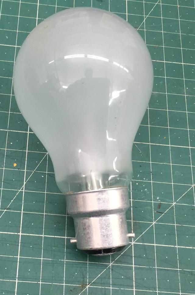

I need to get a new bulb for a milling machine work lamp which has a 48V AC supply.  The bulb holder is a conventional (for the UK) bayonet fitting as used for 240V bulbs.
It has occurred to me that it might work with a modern LED type lamp as these incorporate a switch mode power supply.  I have only found one spec sheet which says 100 - 240 V AC - but that's clearly what they expect it to be used with.
What does anyone think? :zap:

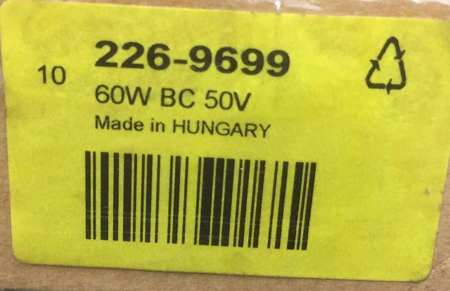

Russell I have a feeling that I have some 48v bulbs tucked away somewhere, let me do a search after lunch
  • Posts: 537
Re: 48V lamp
« Reply #2 on: November 17, 2015, 08:16:27 AM »
Thanks Andrew
It's not that I can't get a 48V bulb - more that it would be more convenient and cheaper if I could use one from the supermarket.
Re: 48V lamp
« Reply #3 on: November 17, 2015, 08:18:28 AM »
Here if you need it :)

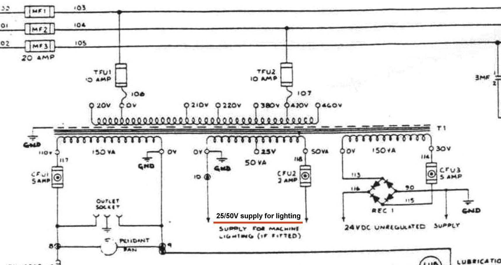

all the machines I've seen with a low voltage work light
had a either 415V step down transformer with a 25 / 50V secondary
just for the "Lo Vo" light or
had 25/50V a winding on the machines control transformer
like this on a Bridgeport
PS
How about using a 24V automotive light run from the 25V tap

By the time you have bought all the bits to convert this, you might as well bite the bullet and just pay the £4.00 each for some GLS lamps surely?
50v gls lamps are awful , they have a horrible yellow glow that barely lights the work and seem to darken the room when on.
I have  working bulbs, just much prefer leds. I had previously had three 12v lamps in series with a small dropper resistance (12v lamps are fine up to about 20v)
