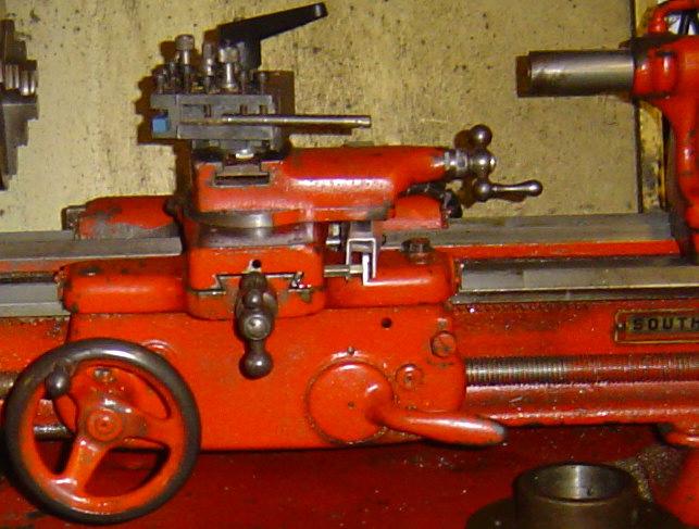

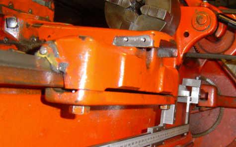

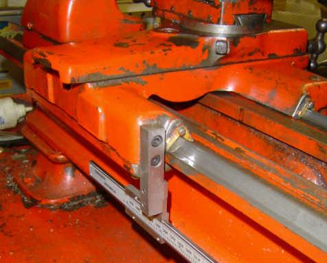

Not a great idea to mount a scale near the chuck - for obvious reasons.
Have you seen Doubleboost's videos about fitting a dro to his Harrison? They might give you some ideas
Years ago, I fitted a pair of cheap calliper scales to my Southbend , but they were a lot smaller than typical glass scales.
These are the best pictures I can find  :(

Thanks for all the help guys, this really is a headache!! Billtodd - your image is identical to my setup but there is no way I could fit the glas scale under the slide - just no room!! I really really do believe for the small scale work I do, I'll actually get more disruption interfering with the reach of the tail stock if I mount it rear side, that I would have issues with the chuck in the chuck side. That said, something cries out to me that chuck side is just wrong. More thinking is required.....

First picky of Bills attach one end of glass scale along where its down to bare metal with two tapped holes. Can go further in so tailstock clears, nothing lost. If scales a one piece no backing with just elongated holes at each end will need to mount that to a support going outboard and in turn to cross slide. Will need bracing up.
L shaped bracket to mount the reader head off that raised lug just below. Check travel may have to mount further out.
