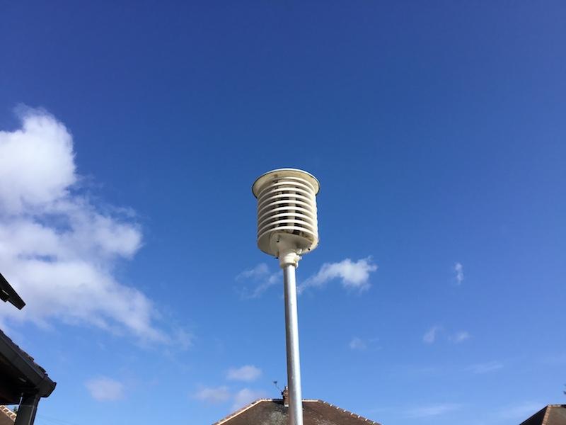

  • Posts: 1321
Re: 3D Printed Solar Shield
« Reply #14 on: January 17, 2016, 07:13:43 AM »
Pete, I am seeing no effect from the Australian sun on my PLA  :scratch:
http://i7.photobucket.com/albums/y253/joulesbee/3D%20Prints/IMG_0106_zpsux2rxshq.jpg3D Printed Solar Shield

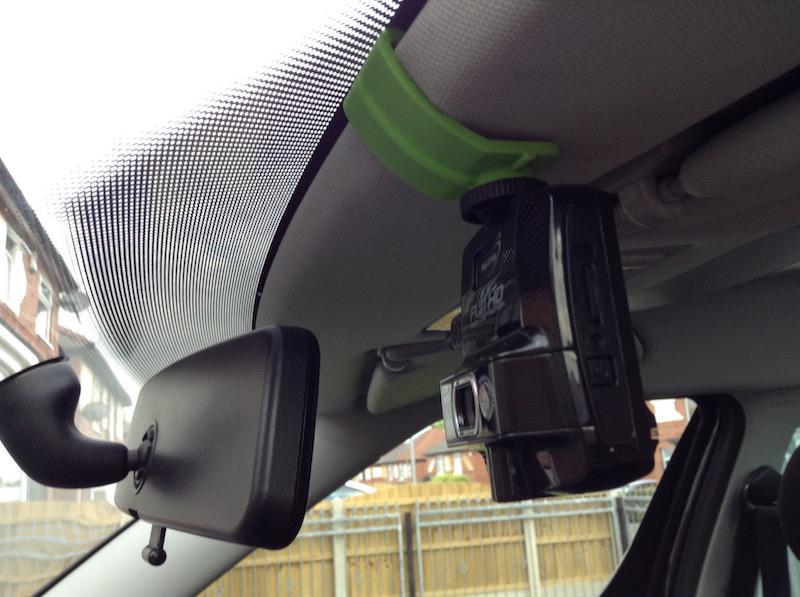

  • Posts: 1321
« Reply #19 on: August 25, 2016, 05:58:26 AM »
I did a dashcam mount in PLA, my first total part failure, but not unexpected due to the heat at the top of the windscreen.  It did prove the design though as I have a bit of PLA knocking around.
My mate printed the final part in E3D's Edge PET filament.  It has survived all the recent sun and gone on to be my second favourite filament.

My dash cam was a commercial ABS (?) camera and the case died fairly quickly, didn't last the summer. I just warped around the internals so that the controls wouldn't work. The new one I remove as soon as I park up for any longer than 10mins. At least they be cheap enough to replace for now  :doh:
  • Posts: 1321
« Reply #21 on: August 26, 2016, 02:19:24 AM »
I don't think black is the ideal colour for a dash cam.  You might notice the mount I designed was to get the camera under the roof lining to offer it some protection from direct sun.  Ours is a cheap Aldi camera and works surprising well, once I cracked it open and refocused the lens.

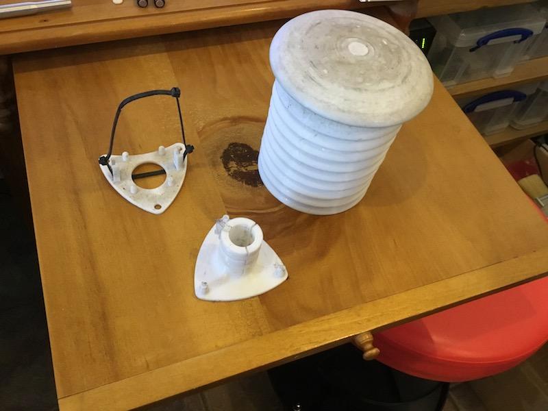

« Reply #23 on: October 29, 2016, 06:34:17 AM »
Hasn't time flown, the battery in the sensor packed up so needed a replacement.  It's almost a year to the day that this went up, it's dealt with the UK weather, some discolouration on top, no delamination of the print.  It's now back on its post for another year of operation, pretty conclusive evidence that PLA is suitable for outdoor use in the UK at least.
http://i7.photobucket.com/albums/y253/joulesbee/3D%20Prints/IMG_0171_zpsu8byw5jf.jpg3D Printed Solar Shield

You could print a clip on replacement cover.
  • Posts: 1321
« Reply #25 on: October 29, 2016, 06:43:33 AM »
If you look back through the thread each component is an individual part so the top cover would only need re printing.  As it is, I want to see how long before the parts start to break up, we'll see next year.

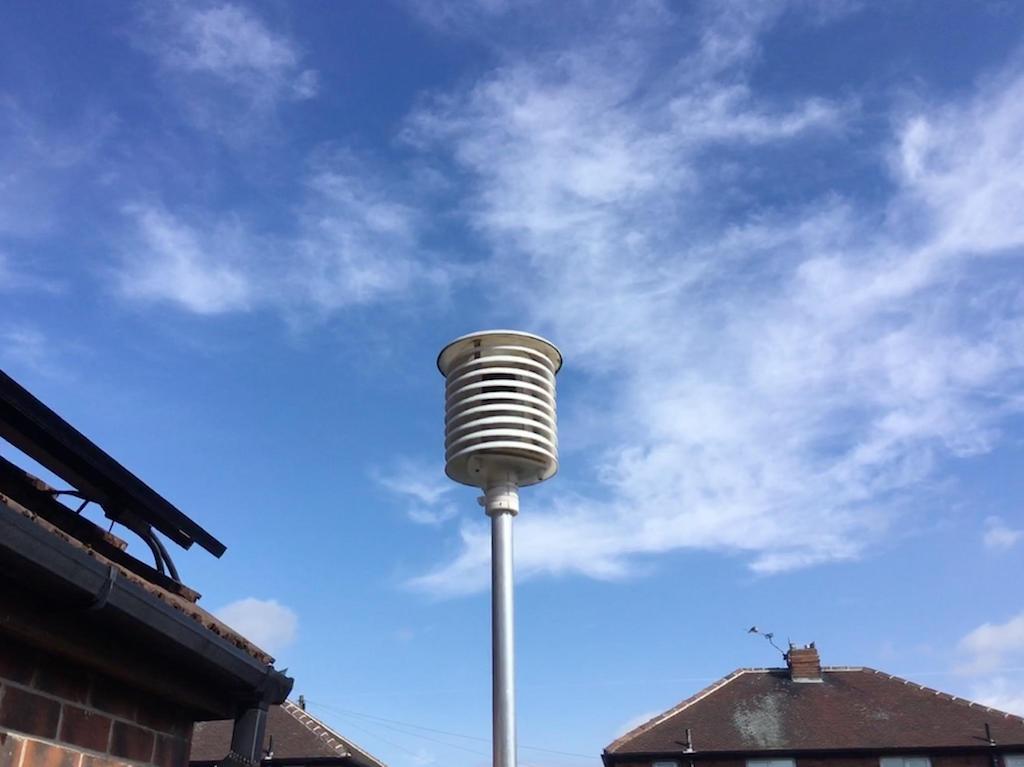

« Reply #34 on: March 20, 2019, 08:12:44 AM »
LOL, I missed the 3yr update, so here is a picture as of today.  The solar shield is now in its fourth year of being outdoors and still shows little sign of breaking down.
How long does PLA last ???   Here in the UK, quite a while and longer than I expected.  I think next doors football will most likely be the killer of it.

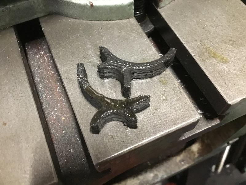

  • Posts: 1321
« Reply #36 on: March 20, 2019, 02:22:47 PM »
Andrew, here's a PLA example for you.   Perhaps you remember the dampers I showed, printed in 2014 using a Rostock Max to fix the lead screw resonance in an old CNC router.   These samples have been sat in oil since then, your post reminded me about them so pulled them out, photographed and put back in the oil.  They were ugly prints then and still ugly prints now, but no sign of degradation.

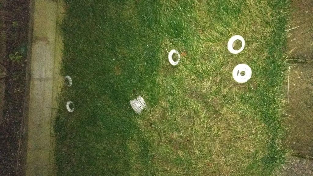

« Reply #38 on: December 24, 2023, 05:57:57 PM »
After 8yrs of service, the solar shield fell victim to the storms tonight.  PLA is good for +8yrs, weather permitting.
