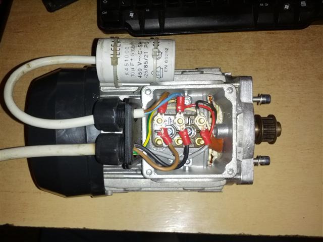

I have this little 3 phase motor that I took out of an automatic barrier. The barrier runs on single phase but I couldn't work out at first why the use of a 3-phase motor and capacitor, then it dawned on me. I knew that you can run a 3-phase motor on single phase by putting a capacitor to the spare leg but these guys have gone a step further and configured it so that powering one leg of the capacitor for forward (barrier up) and the other for reverse (down). Similar to reversing two of the three phase supplies on a 3-phase motor for reversing.
I thought I'd post here just for interest.

A nice bit of lateral thinking.
Thanks for sharing  :thumbup:

Interesting, thanks for the picture.

So just to be totally clear:
Am I correct: Grey is the Neutral and either Brown or Black is the live (depending on direction you want)?

Hi Will,
Yes, that would be right.

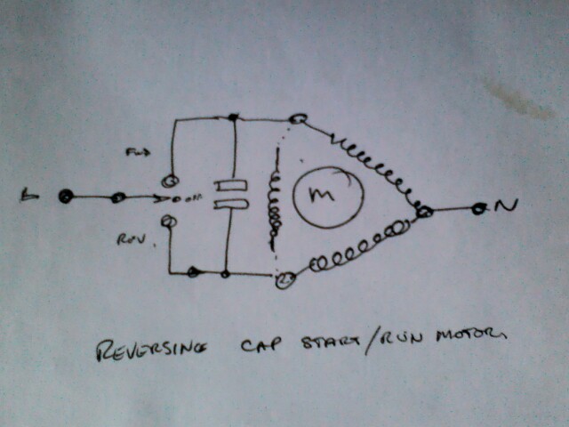

« Reply #9 on: October 16, 2015, 04:33:14 AM »
That's not an unusual configuration for a  capacitor start/ motmotor. If the start and run windings are the same then a simple change over switch is all that's needed to reverse it.
(just so happens that my dad made me a toy with one in and showed me how it worked while i was at primary school! :-)  )
The diagram below shows a typical configuration and how the third phase of a 3ph motor would be in parallel with the start/run cap.

Very interesting, I had never come up against it before, except done deliberately by home users.

I went to hook this up to a small VFD and suddenly realised that it only has the three wires coming from the stator. So it seems they have either used a 415V motor wired in star on a 240 supply or it's been specially would for the application. I can't believe they'd custom wind a cheap motor when they could have just used a 6-wire one so I guess it's the former. Anyway, I hooked it up and the VFD runs it just fine giving around 1420rpm at 50hz. It is a little buzzy though which I wasn't expecting.
