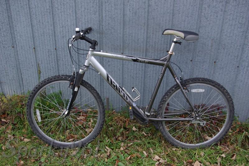

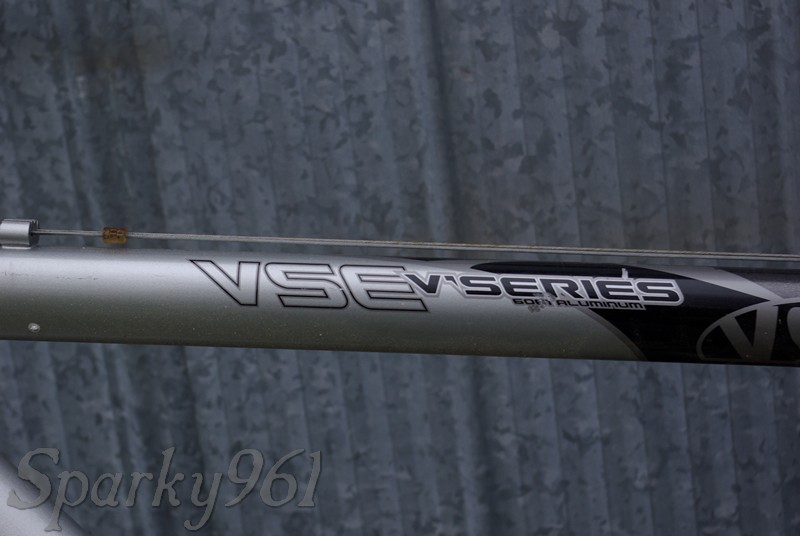

Absolutely, I'll add some photos to this thread and detail the issues I know of.  To the best of my knowledge it's not a department store budget-buy but also not top-end.  I purchased it used from a store that only sold bikes somewhere around 7 years ago and paid approximately $600 if I recall.  Haro is the make, not sure of the model but I'll check for identifiers when I do some pictures.  It's an aluminum frame with aluminum wheels - but I suspect this is probably the norm these days.
It's a solid frame with only front suspension.  I'm a big guy at 6'2" and 220 lbs, and when I looked into getting a bike as an adult it was recommended that rear suspension wouldn't serve me well.  Dissenting opinions are welcome on this, because as I get older the jarring force that's transmitted all the way through the bike's components and into my back is not at all pleasant.

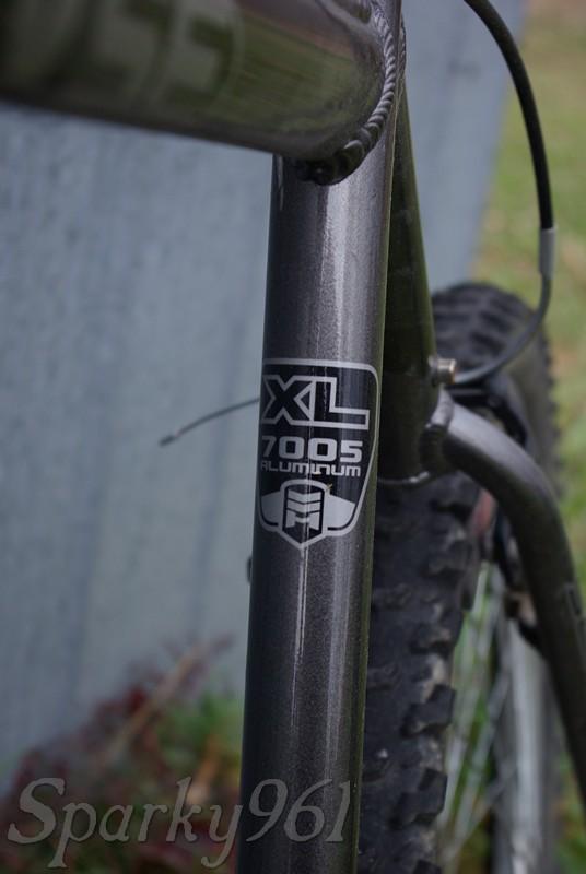

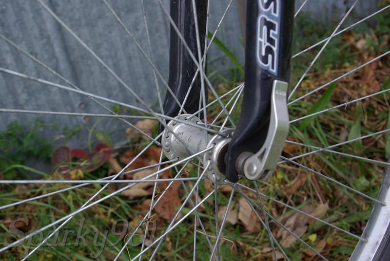

So, I don't seem to be very productive today so I went and pulled the bike from the shed and snapped some photos.

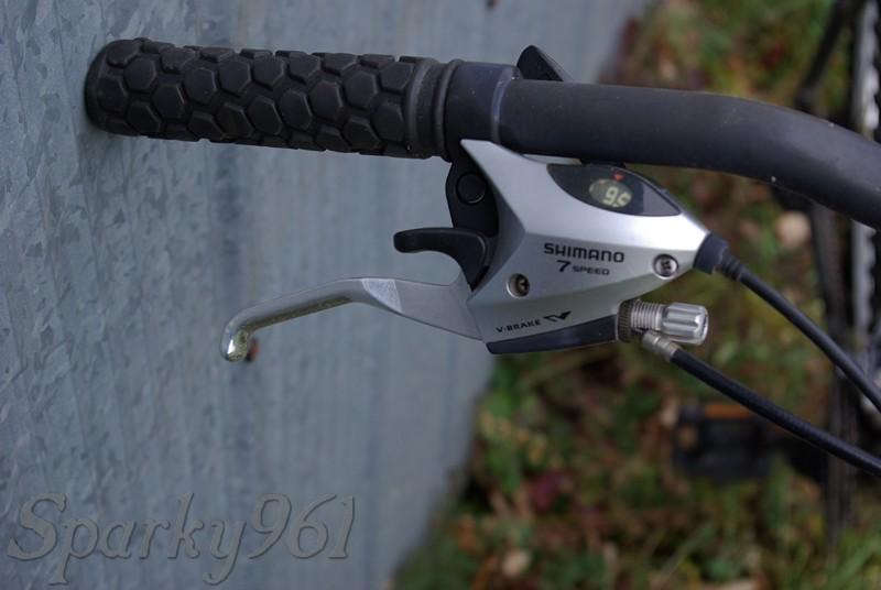

I had previously replaced the click-shift levers after a crash that left me with my first ever broken bone.  In addition to my clavicle requiring about six weeks to mend, the shift lever on one side was completely smashed.

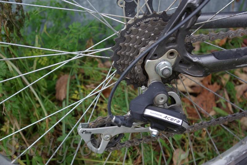

Also replaced was the rear derailleur.  On a separate occasion a few years after the first incident, a stick along a very woody trail became lodged in a very wrong place and quickly broke the pivot arm.  I can't remember if I was left stuck in a high or low gear but whichever it was I remember that getting back to the truck wasn't much fun.
Here is the list of issues I'm aware of.  It's actually smaller than I remember.  Funny how the severity of a project can get blown out of proportion in one's head, eh?

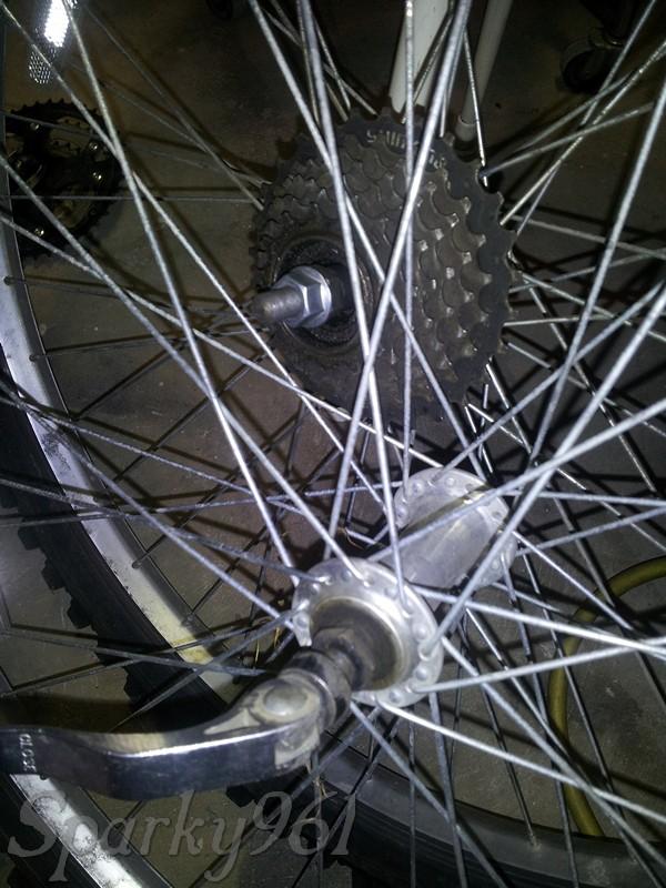

1. Rear axle/bearing
Can the bearing and race(s) be replaced without replacing the rim or does one just get a new rim?  How to properly measure a rim and ensure compatibility?

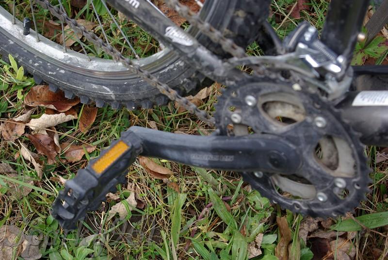

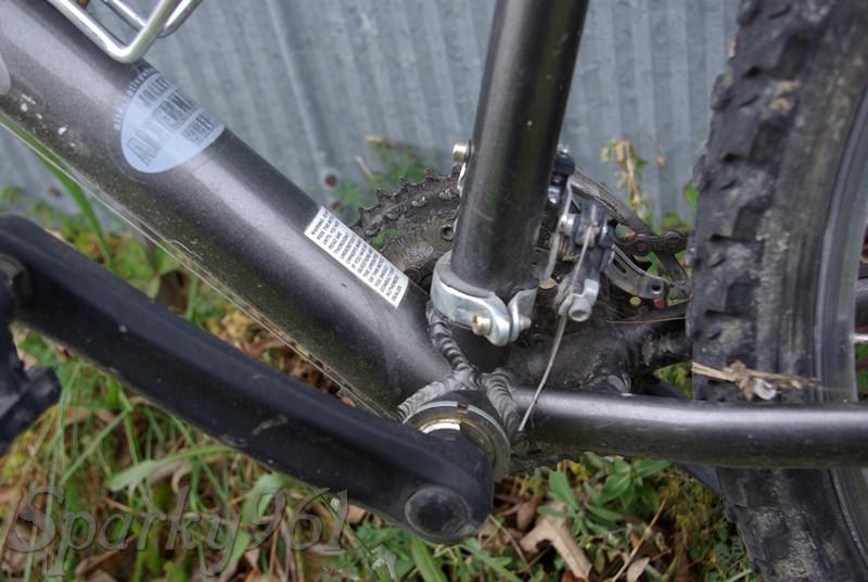

2. Crank bearing
This has always been an issue with occasional looseness taken care of by a slight tightening of the nut.  A cyclical "click" has always been present.

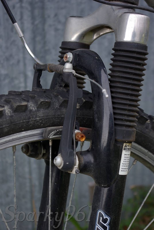

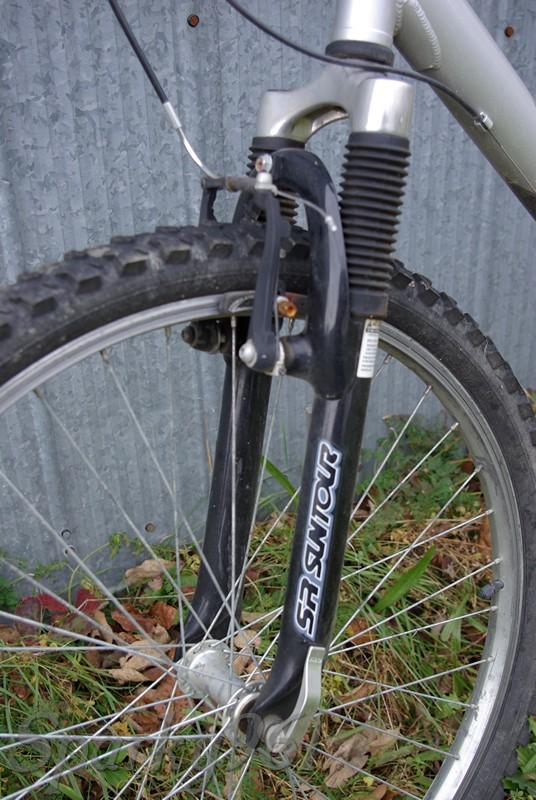

3. Front shocks
Some side-to-side wobble, a bit more than I'm comfortable with but not sure what's considered normal play for these.
4. Cracked rim?
I was sure I had noticed a crack in one of the aluminum rims and was going to take a picture of it.  Do you think I could find it though?  I did notice some very straight lines, either parting lines from a mold or where they've joined a rolled flat extrusion to create the rim.  I wonder if I hadn't mistaken this for a crack the first time I saw it.  If the only way to fix the bearing issue is to replace the rim than this problem is solved by default.
5. Upgrades
- Although I was able to find some brake pads that really impressed me, I was never quite satisfied with the performance in wet and/or muddy conditions.  If disc brakes reliably give that performance, I'd consider that upgrade.
- Better derailleurs?  I have yet to find a bike that shifts gears really nicely, especially if you need to do it under load.  I have also, on occasion, been able to overpower the grip/meshing of the chain on the sprockets and have it slip.  Of course this happens at the least opportune moment - like right at the top of a steep incline, heading "up".
Maybe some of my complaints are due to my ignorance of proper technique, but I think if you can solve the problem mechanically than damn the technique. :)

The frame looks decent and having front suspension is nice.  I've got a very similar bike (a kona).  Having rear suspension might be easier on the butt however it tends to add quite a bit of weight.
I believe the brakes are V brakes - in a cable style brake they are quite decent.  Changing the pads and adjusting them should make a big difference.  You could also give the rims a bit of a cleaning as that will make the brakes work a bit better.  Retrofitting disk brakes might be quite a bit of work and expense.

Shifters/derailleurs - New cables, chain and rear cluster and possibly the two plastic idlers on the rear derailleur should make it shift quite nicely.  Keep in mind that cables will stretch so you may need to do some adjustment after a few km. on the bike.  You may have to learn to be subtle with the shifting  :).
You will need the proper tool to remove the cluster - I install the tool, held lightly with the nut on the axle and then mount that tool in a vice so that the wheel is horizontal.  Turning the wheel will give you some leverage and make it easy to remove the cluster.
Can't help with the give in the suspension.  You may be able to check out another bike or two and see if it's similar or something to be concerned about.

Don't have much time to comment tonight, but I have brought the bike into my workshop as my next somewhat long-term project.  After watching more YouTube videos than I care to admit, I have a pretty good idea what I'm in for.  I'm a bit disgusted by the number of custom tools required for each assembly and every version thereof.  It does, however, look like an opportunity to "make something useful" out of metal.  Certainly cheaper to buy the tools, and I will if making them is a no-go.  But plan to make the attempt for the majority.
I did try to use a simple puller to get the crank off the square taper off the bottom bracket (what a dumb name, eh?  call it an axle or a bearing assembly).  That wasn't successful, so this tool will be the first one I make.
I'll document what I can here in pictures.

I've made a small amount of progress since the last post.  It is, however, very satisfying to write that the first custom tool was a success.... at least the second time around.
Opening up the plastic cap pressed into the pedal crank reveals a bolt and some much larger threads
Thinking I'd be smarter than the people that sell all the custom tools for bikes, I figured I'd just use my handy little puller to get the job done.  If trying this yourself, don't bother.  There's too much deflection, too little grip, and not enough force to get the job done.  It just made a mess of the aluminum where the fingers were digging in.  No harm done though, I'll just clean it up a bit when I reassemble.  Oh and YES, I did have the bolt undone.  I replaced it loosely to give something solid to push against.
It's tool making time!  I read about a guy that successfully made this tool from aluminum and since I have a bunch of round stock I gave it a try.  Threading is a pain to set up on my machine but with a nice big undercut to run into it isn't bad to machine.
As things turned out, the tool above didn't quite thread in.  I measured the pitch diameter later at work and it was right on what it should be.  So why didn't it fit?  I think the threading tool form wasn't quite ideal and there was a lot of tearing and such.  The threads didn't look great - which is a good indication whether they'll work or not.  I got it to thread in a bit but it started galling and making a mess of things so I stopped and went back to the drawing board.
No worries.  CNC makes things so much easier. :)  About an hour of effort produced a new tool with absolutely perfect threads.  Oh, and this one is 4140 HT steel.  The setup was reversed from how I did it manually and I left a long stub that I could hold in a collet block to put the flats on.  The external thread is a non-standard M22 x 1.  The internal thread is 1/2-20 UNF which was drilled on the CNC but tapped by hand.  It's iffy tapping a one-off hole on the CNC lathe with the tools I have available.
Lots of grease was added to get the most pressure with the least friction.  I could have used a slightly longer bolt but, again, materials at hand.  I ended up sticking a smaller SHCS down inside the hole to take up some extra space and give me enough length to pull the crank arm off the taper.
I was able to remove one side of the bottom bracket without any special tools.  Really big pliers did the trick without any damage.  That said, after what I found I'm not planning on trying to salvage any of the parts.  I'll be installing a new sealed type as long as I can find what I need.  I've been known to pedal through water that's above the bike's axles, so that's likely the cause of some of my troubles.
I still need to come up with a way to remove the nut on the drive side of the bottom bracket housing.  It's really not the brightest design in my opinion.  It's round with two very small flats - which don't give much to get a grip on with traditional tools.  Can anyone confirm that this is a left hand thread?  It would make sense and I've seen a few references to this fact online.

I've always found the easiest way to undo those is by picking the bike up, holding the two flats in the vice and turning the bike.
I can't remember which side is LH threaded but one is - so if the one you've taken off is RH - then this will be LH.

I got around to figuring out what I needed to measure tonight, in order to figure out what I need to buy. :)
I got 68mm width for the tube that's part of the frame (confusingly referred to as "the bottom bracket", in addition to the bearing assembly itself) and 122.6mm for the axle length.  It seems like there's a few mm of leeway on the length of the axle so I'm not splitting hairs with the measurements.  It's hard to throw away a few decimal places when you regularly work with 10ths.
Since receiving the suggestion of MEC for parts, I've been putting together an order of a bunch of outdoor things plus the bike components.  I've tentatively settled on the following bottom bracket as being a reasonable replacement that should keep me going for a few years without breaking the bank.  Though there may be better designs there's no reason for me to replace the cranks, pedals, or chainring(s) at this point.  So, instead of changing things I'll just replace with a working part.  Hopefully "sealed" cartridge actually means it keeps the water out.
http://www.mec.ca/product/5021-557/shimano-alivio-bb-un26-68x122mm-eng-square-tapered/?q=bottom%2Bbracket%2Bsquare
Now, my reason for pointing out the above is this: I know which tool to buy to install it, but considering I'm trying to build tools as needed I'm wondering if anyone has such a tool and would be willing to send enough dimensions to duplicate it on this end.  If not I can reverse engineer a tool when I get the part.  But I was hoping to make it up and have it ready for when the part arrives in the mail.

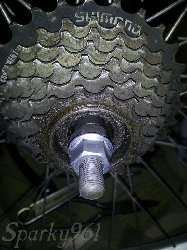

Well, I took off the wheels this evening and got a bit of a surprise.  The one rear axle is really bent!  Rotating it and watching it, I'd say there's 1/16" to 1/8" or runout where it sits in the frame.  I'm guessing this happened at the same time I broke my collar bone.
Spinning the bearings feels about as smooth as if one used topsoil instead of grease.  The front is rough but not loose.  The back is rough, loose, and bent.
So am I correct that there are only so many components that are replaceable in there?  Is my best (or only) option to replace the entire wheel assembly?  I thought of maybe getting new hubs but re-lacing and truing the wheel myself doesn't seem like a good idea.
And hey, while we're on the topic of wheels (and tires)... is there such thing as a bike tire (or car tire) that doesn't slowly lose air?  I hate topping up tires but it's much worse trying to ride/drive without enough air in them.
Re: Anyone a Mountain Bike Expert?
« Reply #24 on: November 12, 2015, 02:54:55 AM »
Can you not pull the axle out and straighten it in a press on Vee blocks? It's only short - even a bench vice might do it if no press to hand.
From my dim and distant recollection of bicycles I seem to remember that the axles are only a bar with bearing cones screwed on at each end with possibly flats. If straightening doesn't work, make a new one.
