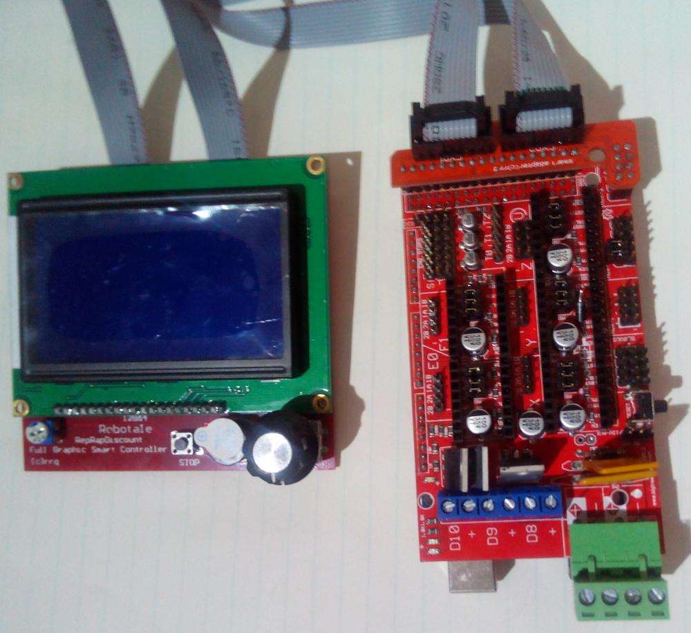

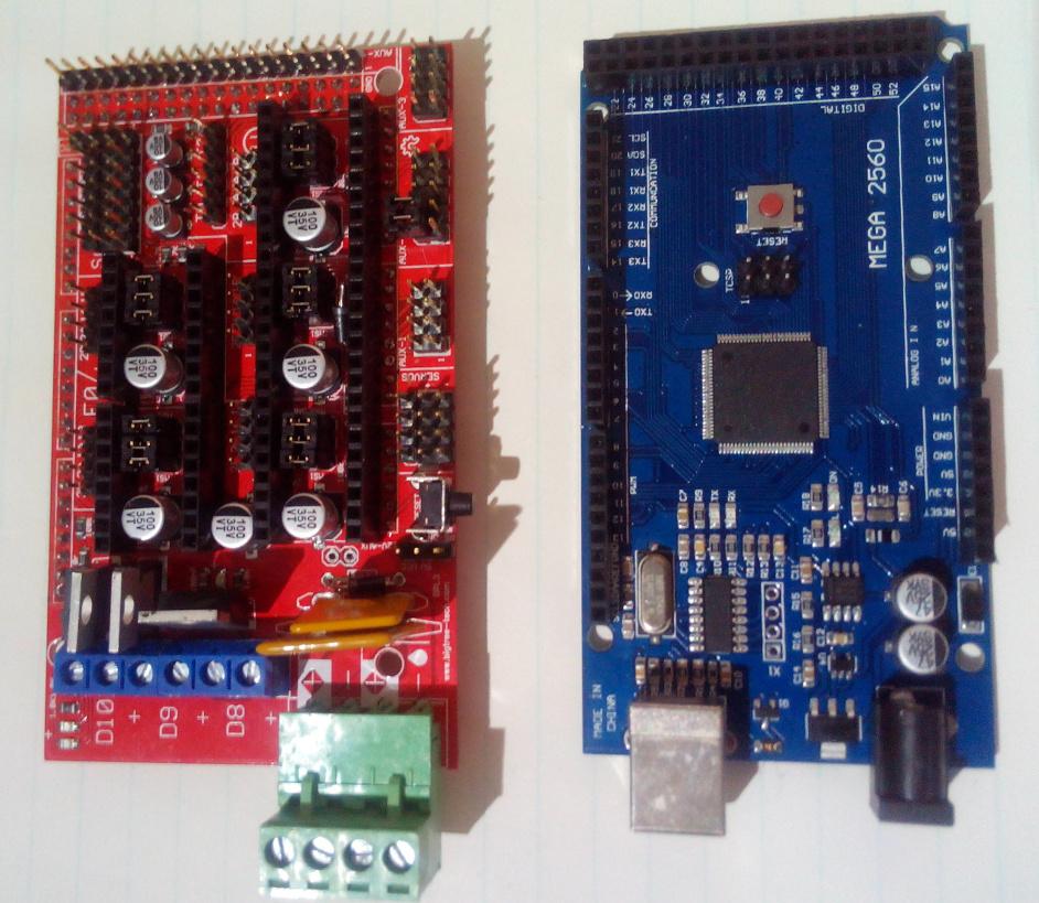

Electronics using Arduino2560 R3, with Ramps 1.4 board, and graphic controller card, Marlin software, all powered by the usb cable.

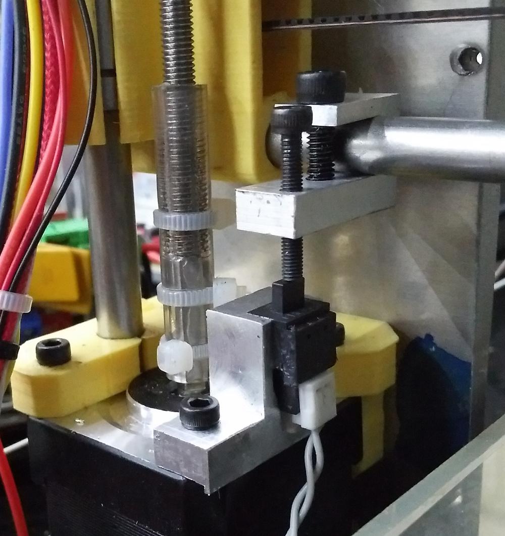

« Reply #5 on: November 05, 2015, 02:30:20 PM »

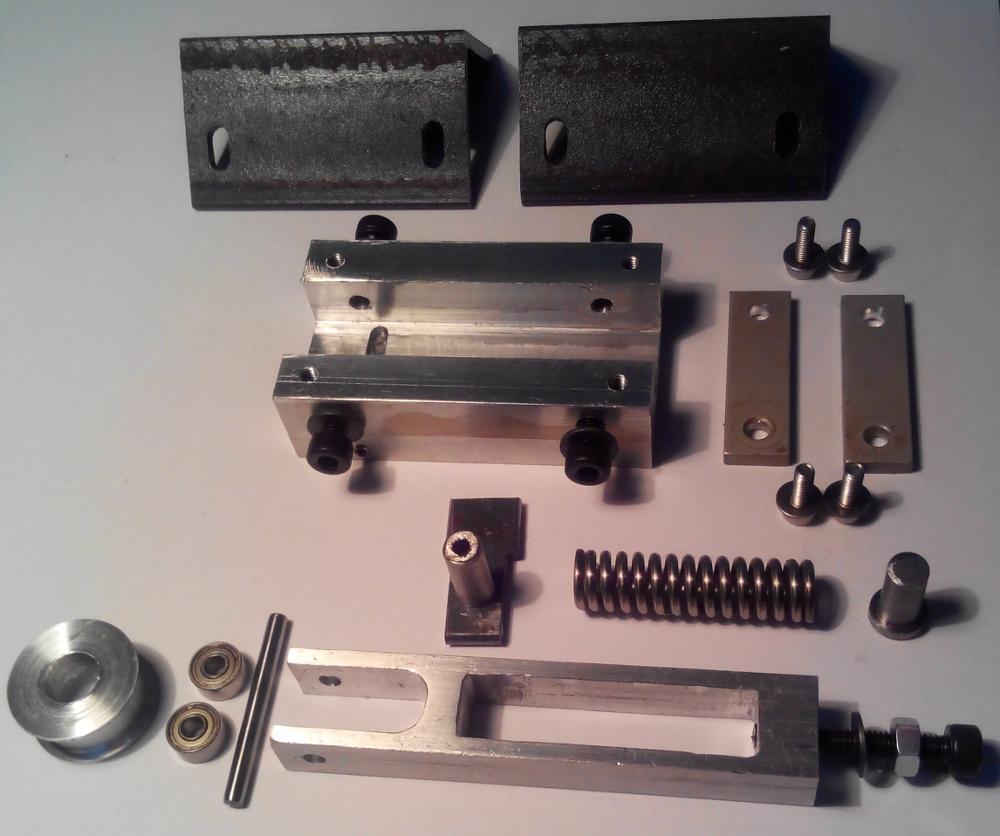

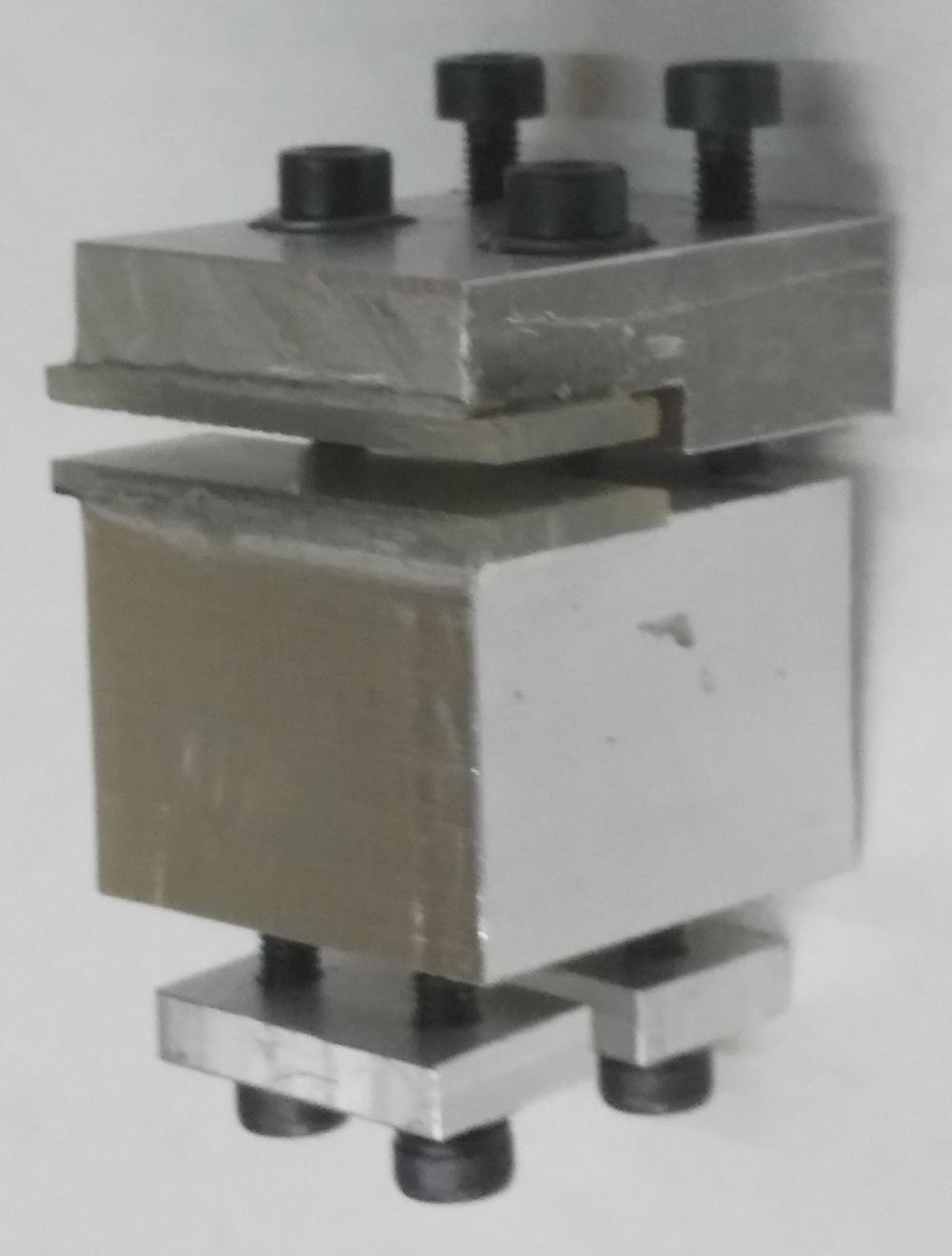

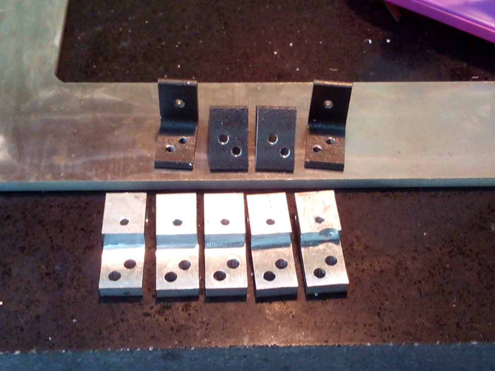

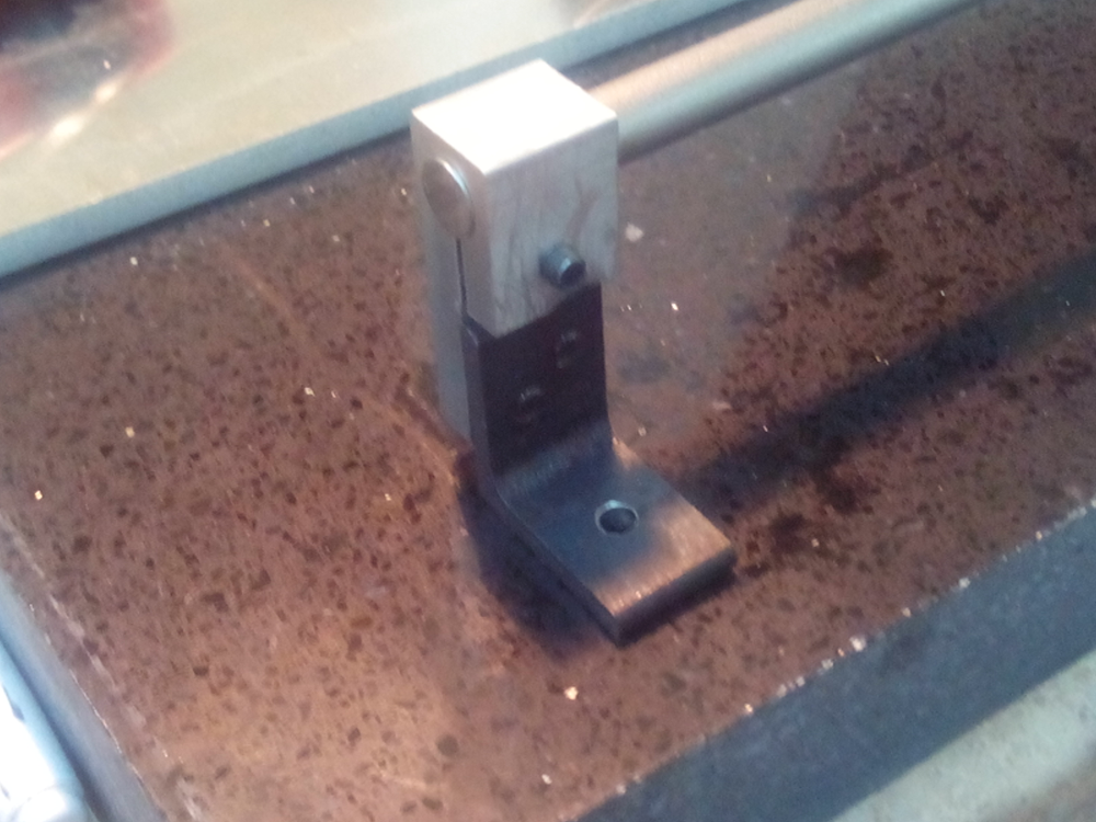

OK next installment. Pictures of the adjustable y axis rod mounts, also picture of a budget (99p) adjustable buck convertor. This will allow me to run the 12 volt fans and power the Arduino board from a 24V supply. Proposed design (pdf) for the print bed minimising weight.
More pictures and progress as soon as I get time.

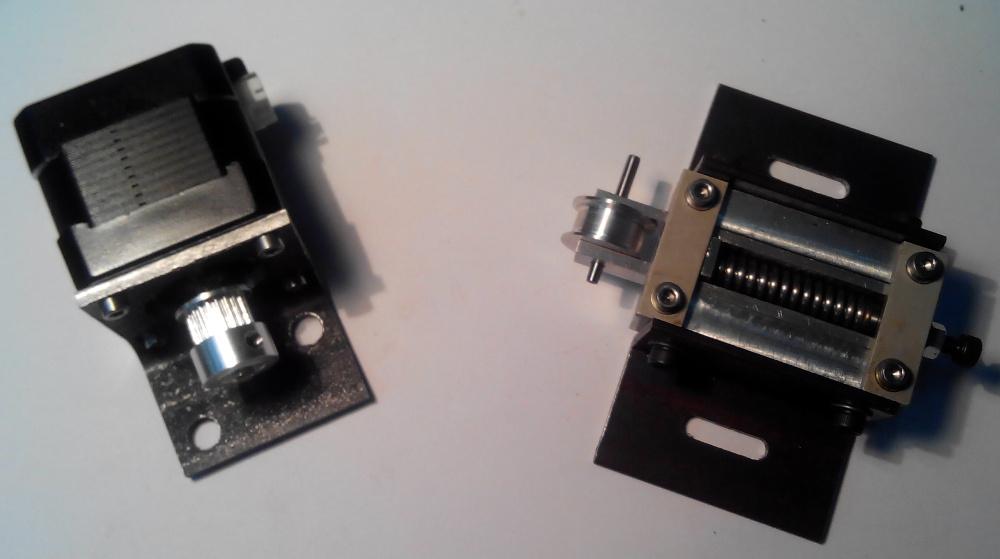

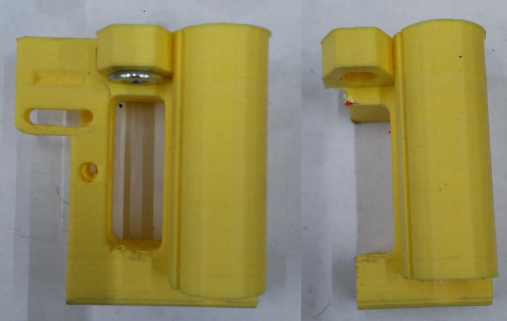

A little progress. Y belt tensioner and motor mount. The vertical belt alignment from drive to bed to idler seems quite critical if accuracy is to be maintained. Even small errors may cause belt stretching which will erode the accuracy. Simple spring belt tensioner with scrap will make system more forgiving.

« Reply #7 on: November 16, 2015, 03:40:23 PM »
That is a very nice tensioner. Dare I say a bit over engineered, but then the very best things are always over engineered :thumbup:.

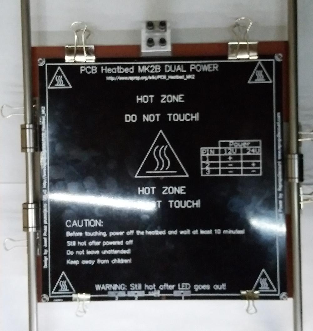

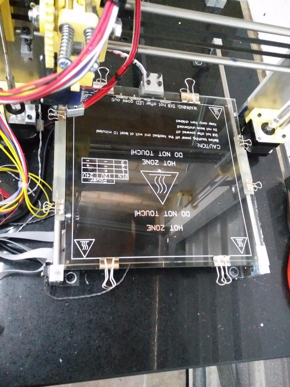

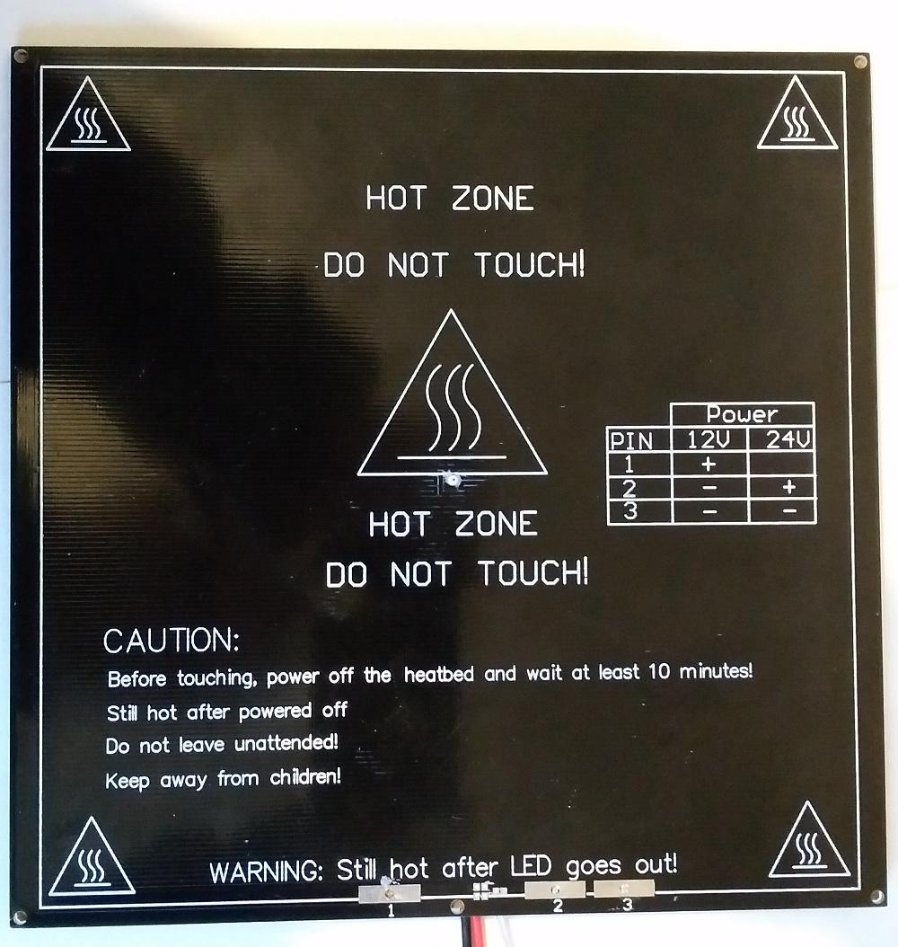

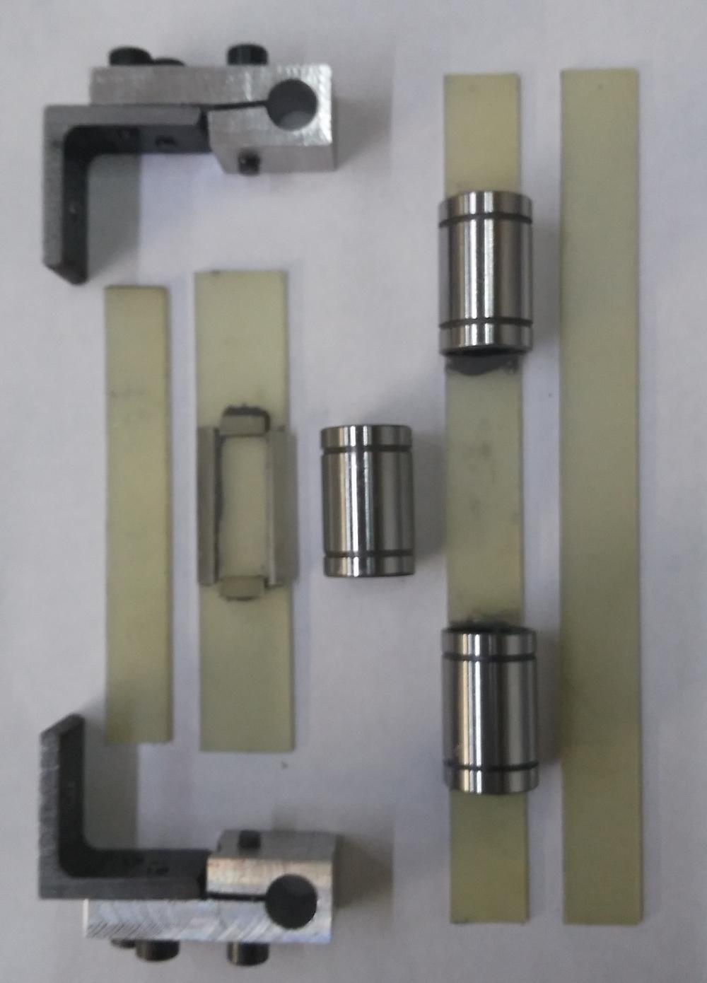

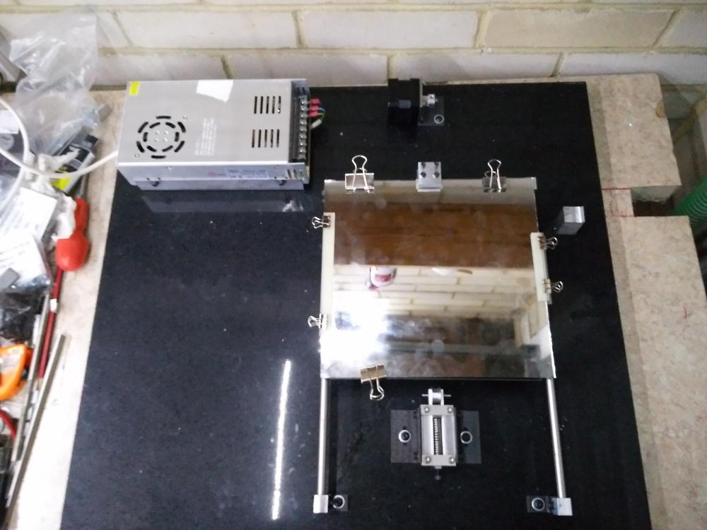

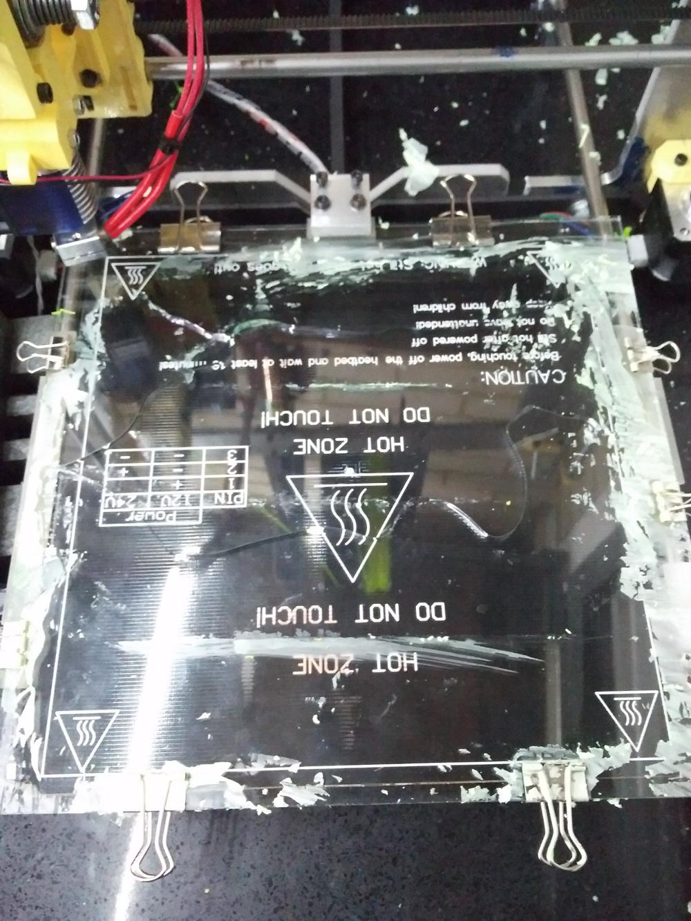

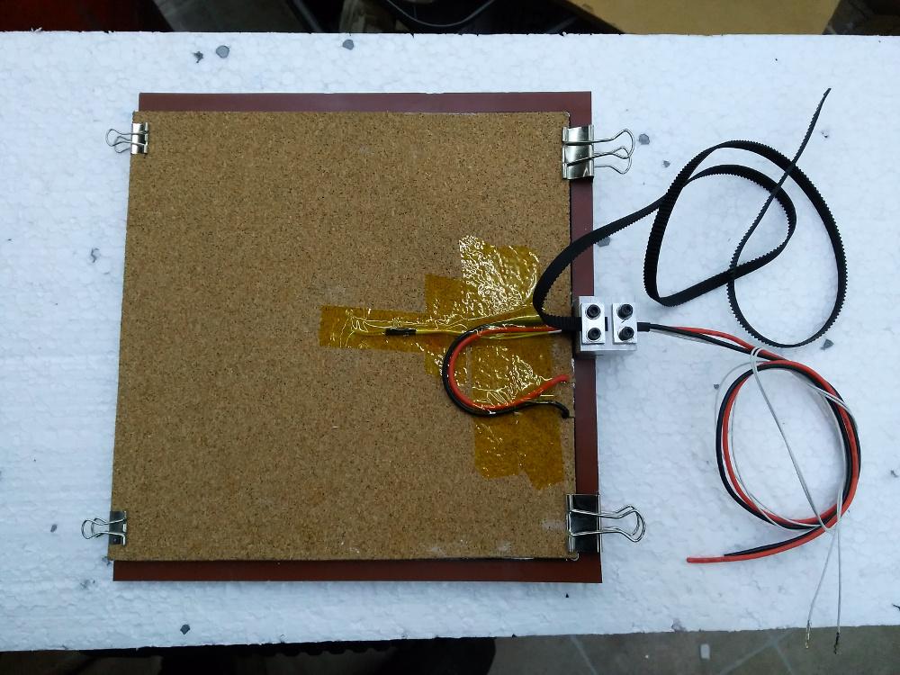

So i have finally finished the parts for the bed. Pictures tell the story. I have high hopes for light weight, accurate tracking and good precision. The glass looks red in the pictures because that's the back of the mirror coating.
First the belt to mirror clamp. This clamps onto the end 10mm of the bed glass, based on an engineers type clamp. I was concerned about lack of grip but I statically tested it to over 5Kg then pushed probably at least another 5. The clamp is very good.
Next the bearing carriers. These are made of 1/16th fiberglass,  The two bearings aligned on a smooth rod then epoxied to the carrier. Surfaces were roughened and high temperature epoxy used. The bearings were aligned so that the 4 internal races were at 45degrees to the vertical to ensure accurate tracking when weight is applied. The single bearing and carrier float to become self aligning. Approx 2mm of lateral movement is allowed.
Full bed assembly showing heater pcb. This will be covered with 2mm of cork to decrease heat loss. Clip handles will be removed when in use.
Next installment drilling the granite worktop .

How is the heated bed attached to the linear guide assembly ?
Offline picclock
  • Posts: 613
Re: picclock's modified i3 3d printer attempt
« Reply #11 on: November 27, 2015, 05:44:23 PM »
Hi nmrl
The heated bed is attached to the glass with clips as per normal, as shown in the picture.
Best Regards
picclock

Sorry I meant to ask how it was attached to the bearing linear rod assembly. Is it glued on to the little fibreglass boards or just clipped on? I can't quite figure it out from the picture.
Offline picclock
  • Posts: 613
« Reply #14 on: December 02, 2015, 05:25:25 AM »
Hi nmrl
The twin bearings are epoxied to a fibreglass carrier, and the glass is clipped to that. The single bearing is located in an open top 'box' which constrains axial movement but allows radial movement. Its only function is to maintain an accurate distance above the smooth rod. Gravity and the glass weight should keep it in place but for convenience I will fashion a clip, probably out of piano wire.  So the twin bearing smooth rod will control x,y,and z about the axis, And the single bearing is just responsible for the z component.
This leaves the glass easily swappable, with the only snag being the possible collision of head and belt clamp if not set up correctly. The distance between the smooth rod centres was changed to 230mm to facilitate this, also giving greater lateral stability.
Best Regards

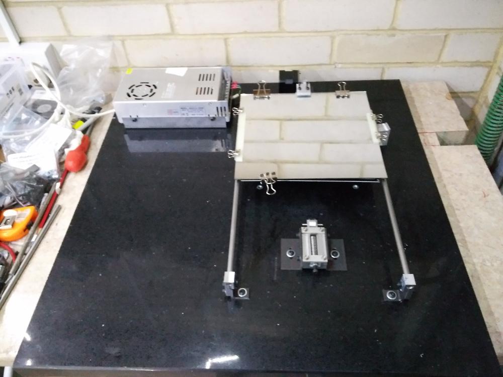

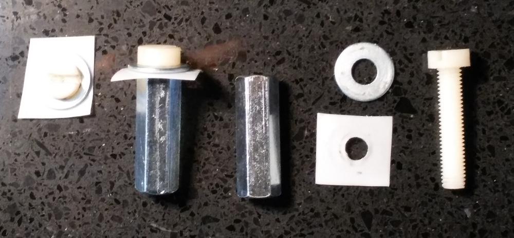

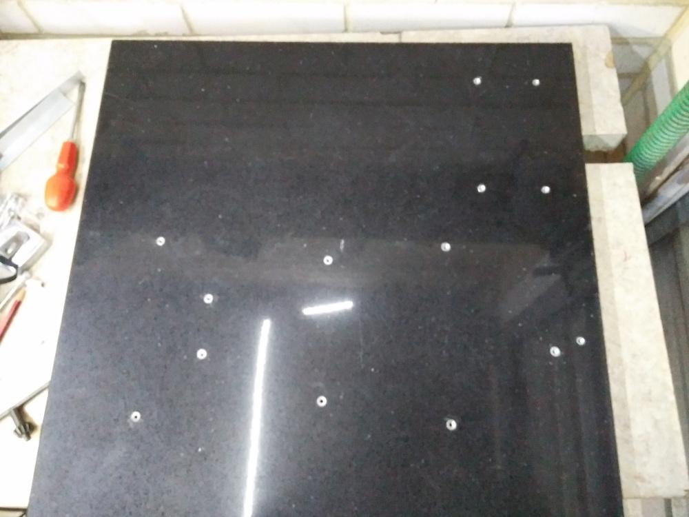

Just an update on drilling granite worktop. Bought some cheapo diamond core bits (9mm, 5 for £4-50) and some 25mm m5 threaded spacers. Marked up granite top to layout I had worked out earlier using sticky labels. Made a dam with plasticene and filled with water, then using and ancient pillar drill I had got busy with the boring. I slipped some neoprene rubber sheeting under the drill to stop movement, and it all went fairly well. On one hole I managed to break right through but the rest were ok. I found it quite hard to get the remains of the core out of the blind hole.
I tried various epoxys for fixing the spacers on the non critical stuff and found permabond steel offered the best characteristics, although the setting time proved unpredictable, so I could only do one at a time. Tried two and ended up drilling it out  :wack:. The spacers were fitted with a nylon screw fully inserted. Under the head of the screw was an M5 type c washer and another washer I had made out of ptfe gasket material. Once the epoxy was mixed a suitable 'dollop' was put into the hole followed by the spacer/screw assembly. This was pushed down until the washer was resting on the surface of the granite. I used the pillar drill as a weight while it set. After 10-12 mins, the epoxy had hardened but not fully. At this point I removed the nylon screw and the washers, and used a sharp blade to clean up all the excess epoxy which had squeezed out of the hole.  This seems to be an easy way to get the spacers flush to the granite top.

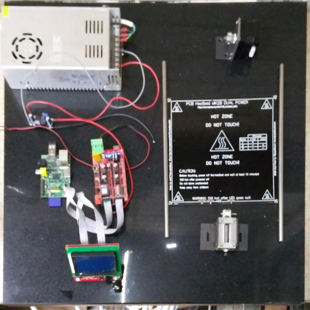

Once completed I mounted the smooth rods and brackets for the y axis and printer bed. It seems to work very well, with nice smooth travel. The rod heights were set with a spacer block I machined to 36mm, giving a rod center of 40mm. The spacer was placed under the rod next to the support bracket, and the adjustment screws tightened whilst applying pressure on the rod. This technique enables easy, accurate setting height of all 4 ends, within quite tight tolerances ~1thou difference measured.
Gantry and X axis next time. Thanks for your interest.

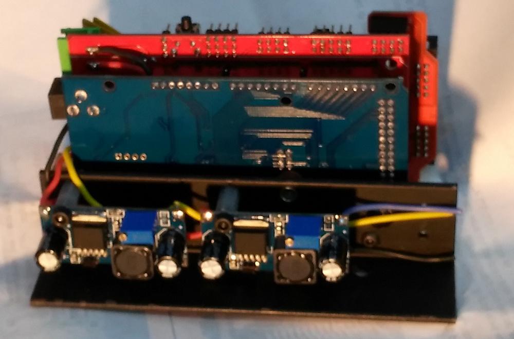

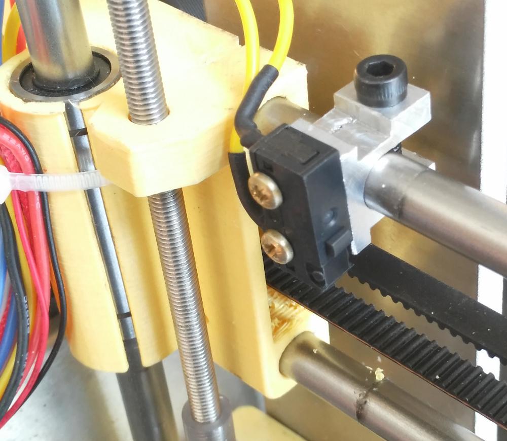

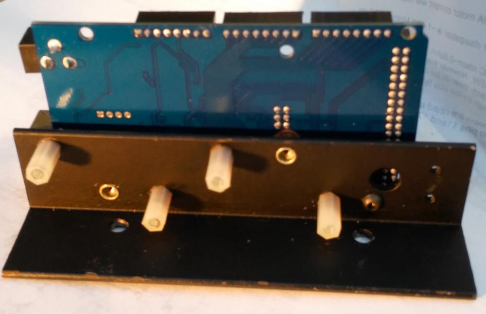

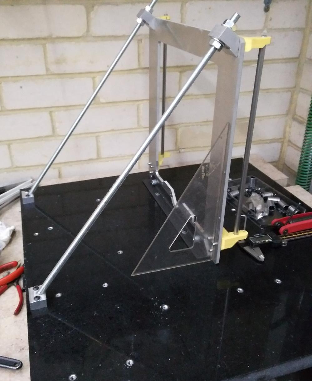

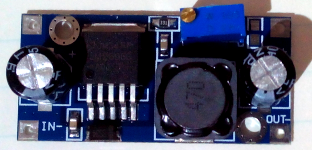

The gantry is mounted at the base with angle iron and supported at the top by two pieces of M10 studding. This allows fine tuning of the vertical and horizontal axis with respect to the Y axis rails. I had originally planned to use triangular braces to set the vertical right angle but in the end I decided on this method as simpler to implement and adjust. Even so, I threaded the base mounts at the wrong angle (both 3.5 degrees out  :scratch:), still don't know how that came about but easily resolved. As drilling the granite is a bit of a job I made the decision to get the rest of the holes done in one go.

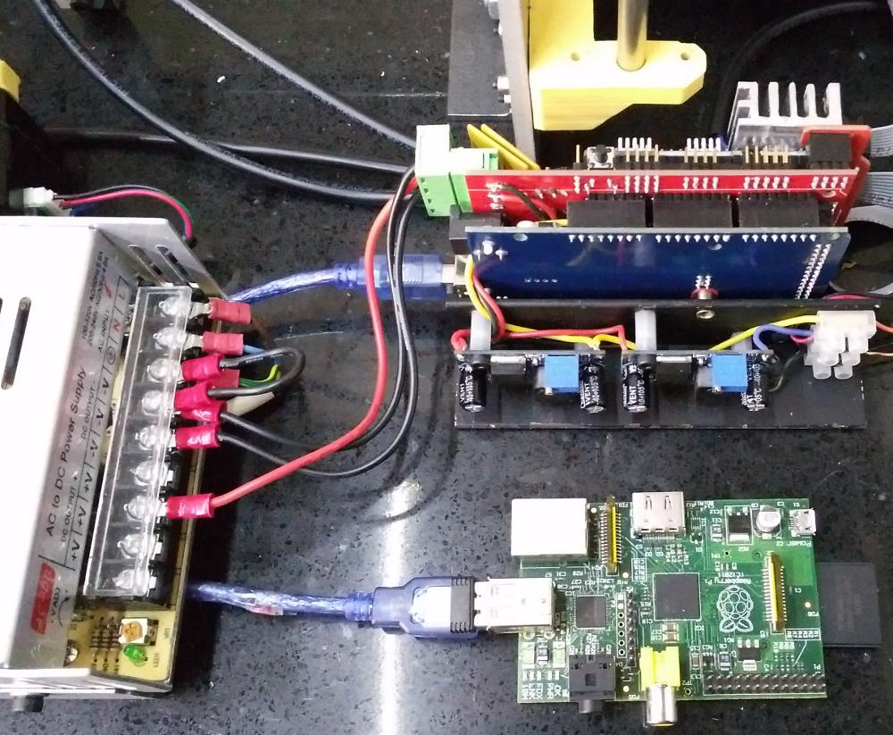

This led me to constructing the carrier for the Aruino/Ramps/buck convertor boards. I then needed to find out if I would need stepper driver heatsinks and a cooling fan. This led me to setting up the system and setting the driver current. The drv8825 driver chips, with 0.1 ohm current sensing resistors have a reference voltage gain of 5. So 1 amp of winding current will need a reference voltage of 0.5V. This can be set using the small trimpot and measuring the wiper voltage using a metal screwdriver and a crocodile clip lead. The reference voltage range is up to 3v or so, even though the useful maximum is 1.25V, making the setting more difficult. I intend to run the motors at 1.5A so X,Y,and Extruder setting will be 0.75V. As the Z axis requires two motors and as the driver current is limited, 2.5A or 1.25A per motor, requiring a reference voltage of 1.25V. This assumes that the motors are connected in parallel (the normal configuration), although there would be minimal downside to running them in series, just slower movement speed.  The chips have a thermal trip which operates if the junction temperature exceeds 150C. Temperature measurements indicate that a fan is essential but that the heatsinks only reduced the junction temperature 10C or so. Measurements were made with an infrared thermometer, and via a thermocouple to the underside base pad. For the Z axis driver with its much higher current, the small heatsink would not be adequate so I have decided to machine one up from some aluminium scrap.  If this works well I may make heatsinks for the other 3 drivers, just to be kind to them  :wave: .
Y Axis testing and X axis assembly up next.

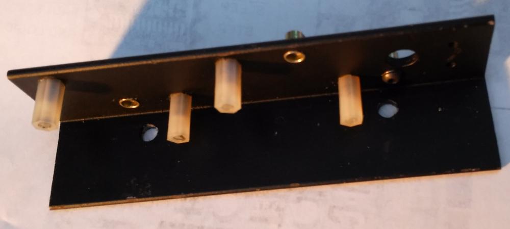

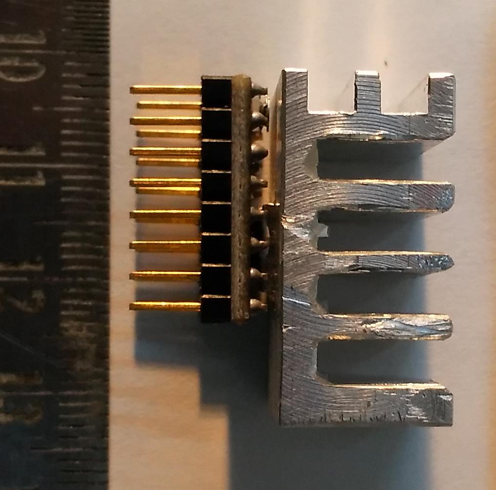

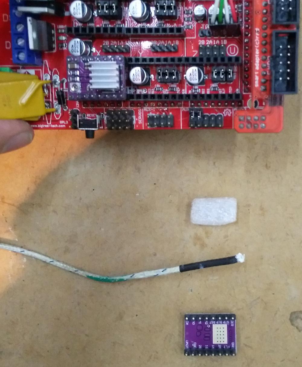

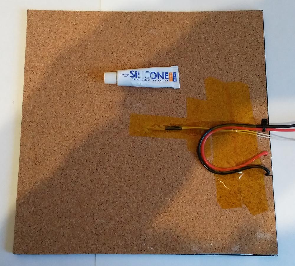

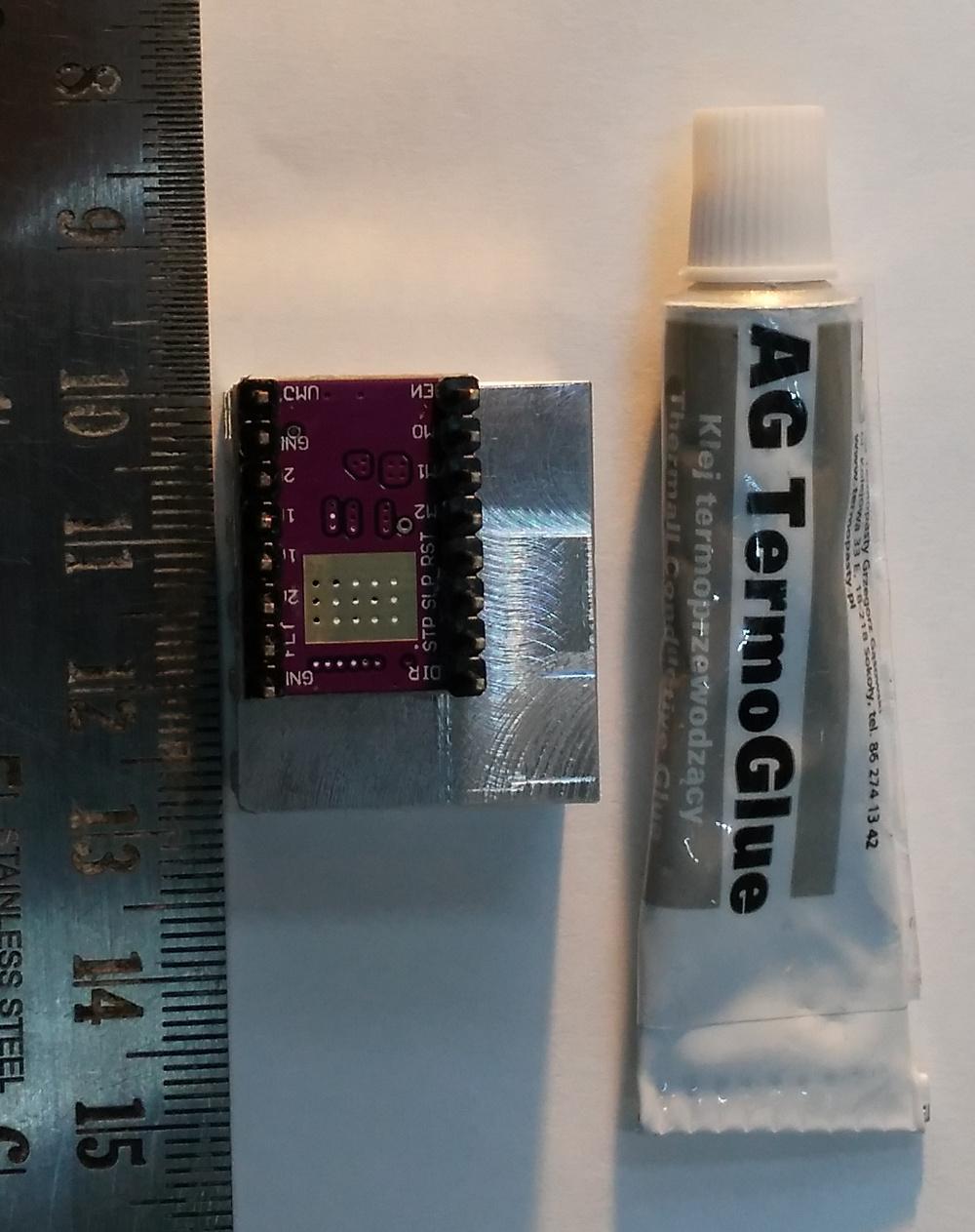

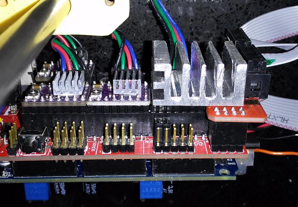

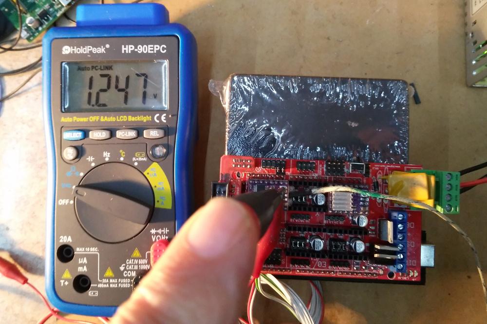

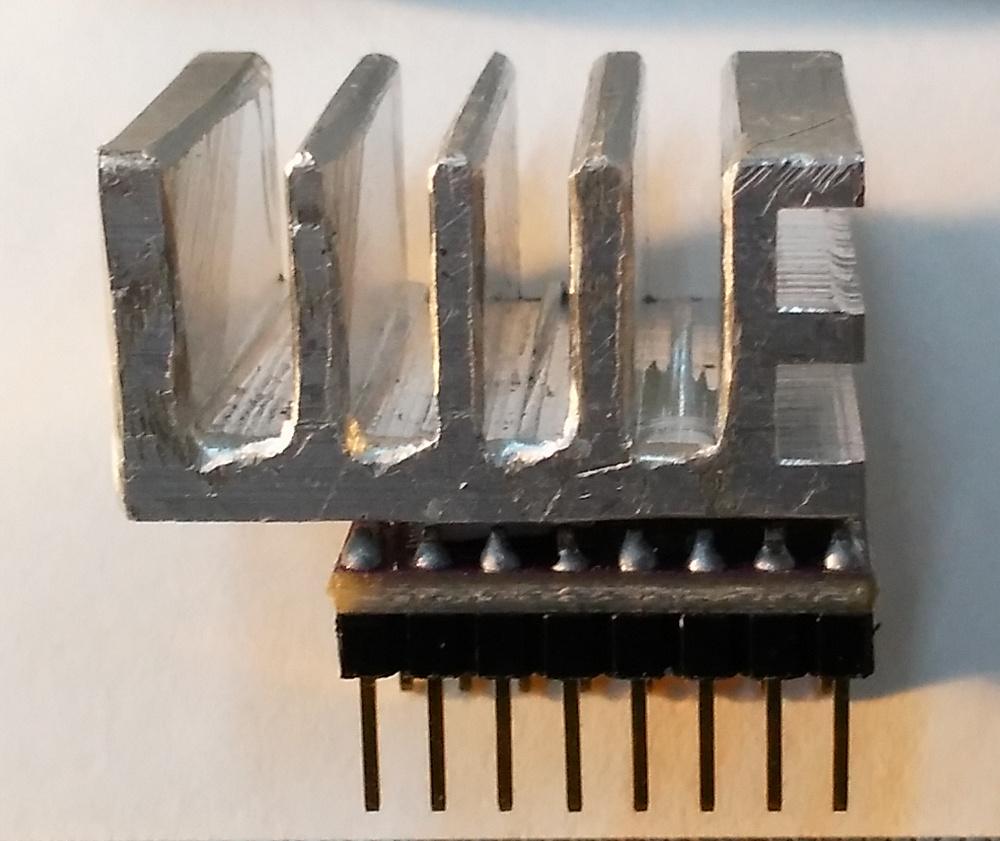

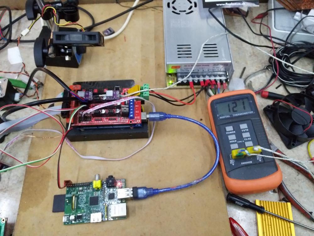

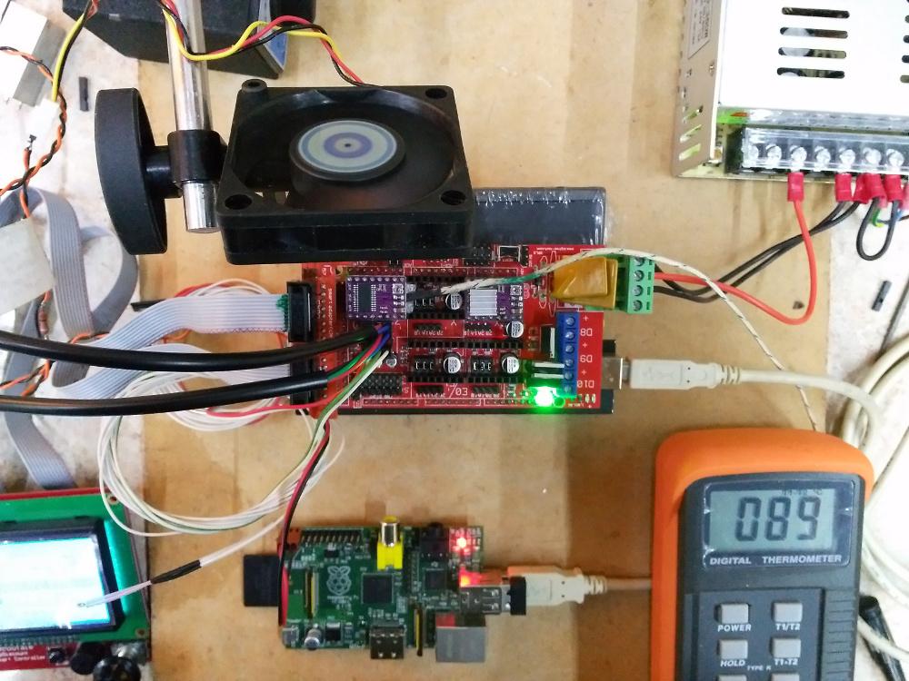

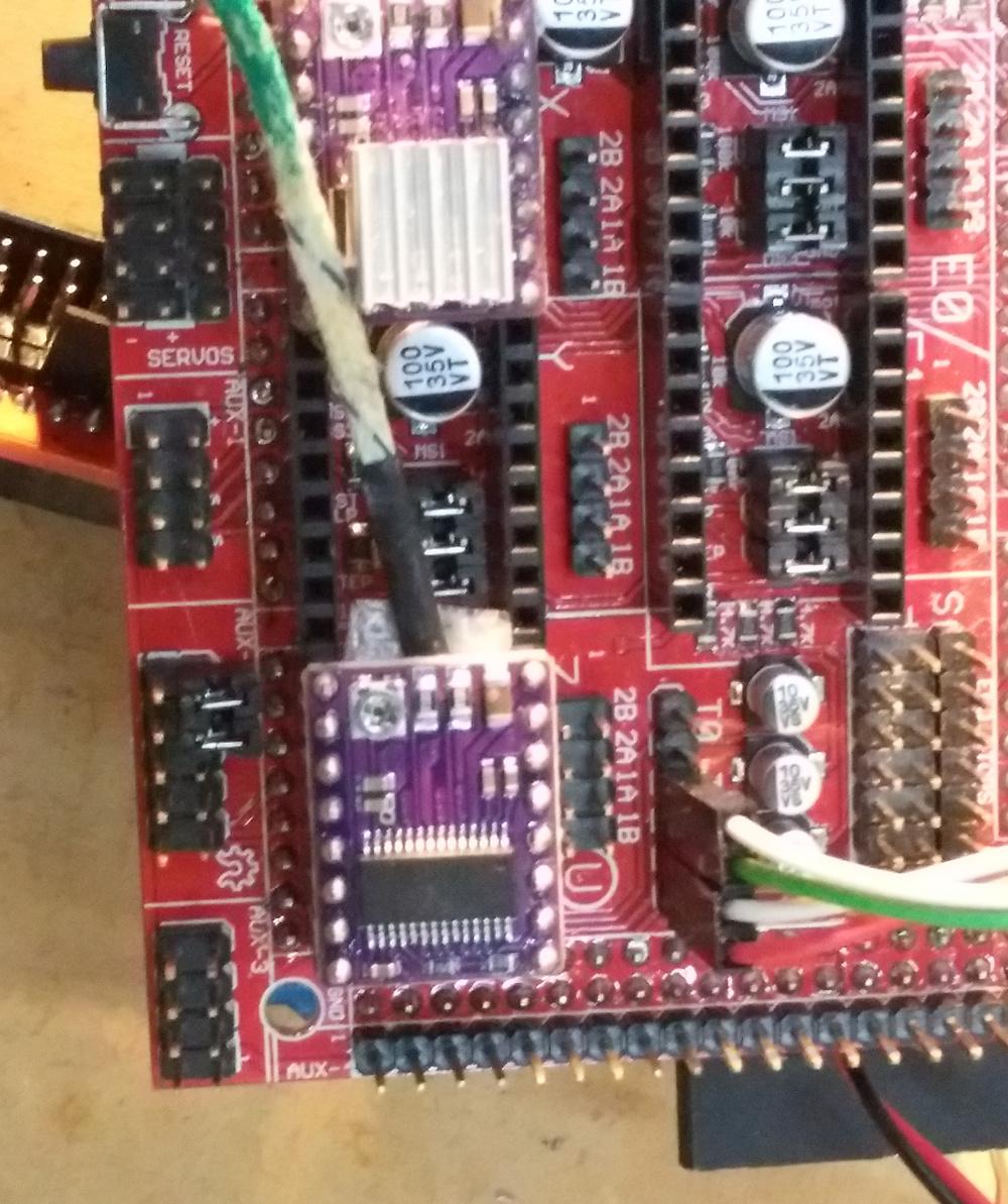

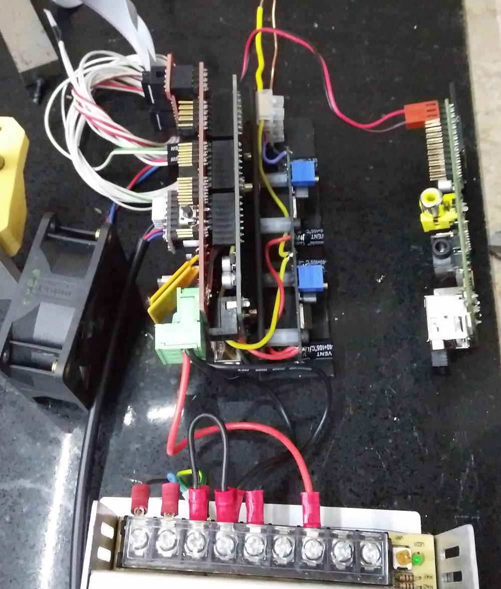

Just an interim update on progress so far. Z Axis driver overtemperature could rise to over 120C above ambient (see piccy with std heatsink and fan blowing directly onto it). Tests were done using a mobile phone and octopi over the local wifi  network. Seems to work very well. Max temperature is achieved when one winding only is driven, a condition which occurs at full step positions. I think max t occurs because localised heating causes the fet resistance to increase, and power is I2R.
Three possible solutions occur. Use a separate driver for each z motor. Marlin will allow the second extruder motor to do this, but I want to keep this option for feeding carbon fiber loaded filament at strategic locations. Second option is to connect the motors in series. This will keep the driving current the same as a single motor but halve the maximum running speed/acceleration. Quite a good solution, but I opted for better chip heatsinking with a homemade heatsink, see piccys. This reduced the max temperature change by 40C allowing good margins for normal operation.
Bed heater preparation was made by fixing cork sheet to the back of the pcb using a high temp silicon glue. The board connections were made with flexible silicon wire, soldered in place, ensuring the top surface remained flat. The thermal sensor was also affixed using high temp silicon. I have little faith  that the glass temperature will accurately reflect the sensor temp, as only the top of the sensor is in contact with the glass, the rest being pulled toward the temp of the surrounding pcb. Depending on performance I may opt to change this for a clip on thermocouple attached directly to the glass surface.
In my final y axis preparation I made a new idler pulley with a slightly smaller diameter. In order to ensure concentricity between the outer and inner parts of the pulley I bored the inner to take the bearings. I always find small hole boring tricky because I never have the correct boring bar size. So I used a two flute endmill, axially offset by one or two degrees to ensure that just the tip cuts, a neat dodge I have used before.
Thanks for looking
Best Regards
picclock.

Your "extended" heatsink for the drivers are quite a lot larger than the standard small ones. They will definately do good work. Reworked pats from a larger heatsink or your own design?
/Peter
Offline picclock
  • Posts: 613
« Reply #22 on: February 09, 2016, 02:40:05 AM »
Hi PeterE
I think design is too strong a word  :dremel:. Measured available space on ramps board and dug around scrap box for something close. Ended up with piece 27.5x23.6.x13.6mm. cut 3mm wide grooves to suit with stack of slitting saws. Only hidden detail is that contact pad (10.5x7mm) connecting to chip is raised 0.8mm to ensure hs did not touch connections on board.
Original hs surface area around 200 mm2. New hs area around 3400mm2. Original hs only affects chip temp by around 10C even when blown.
Best Regards

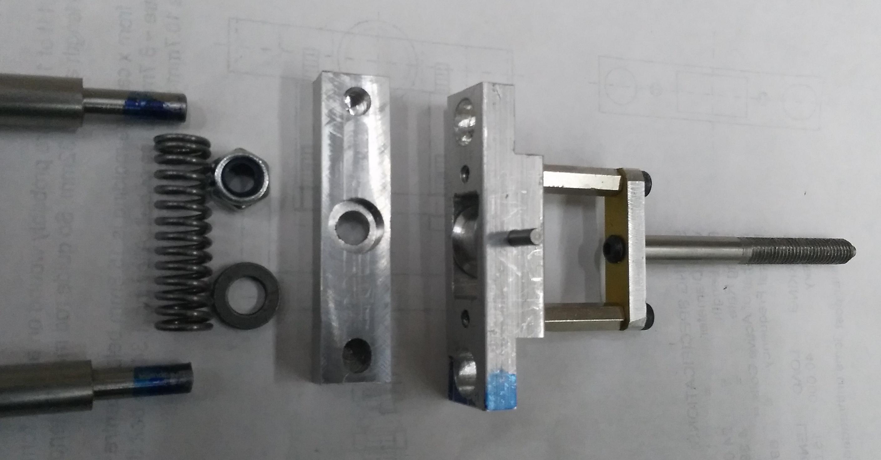

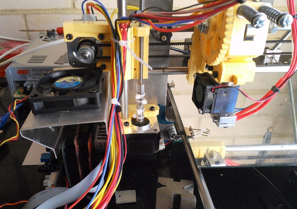

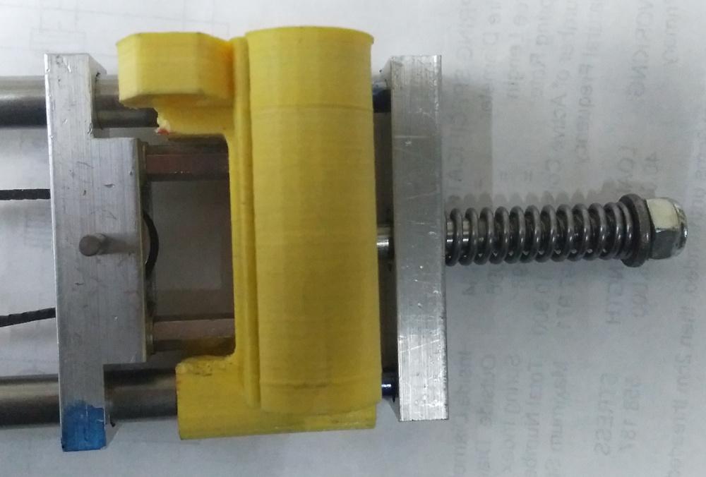

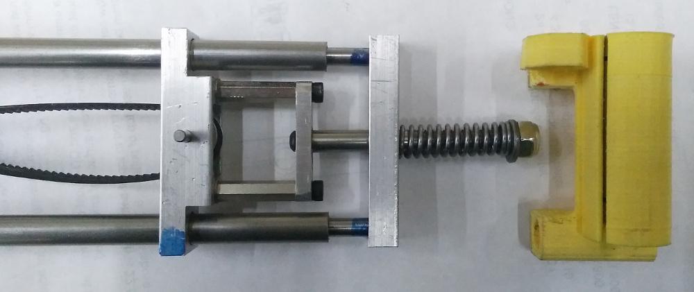

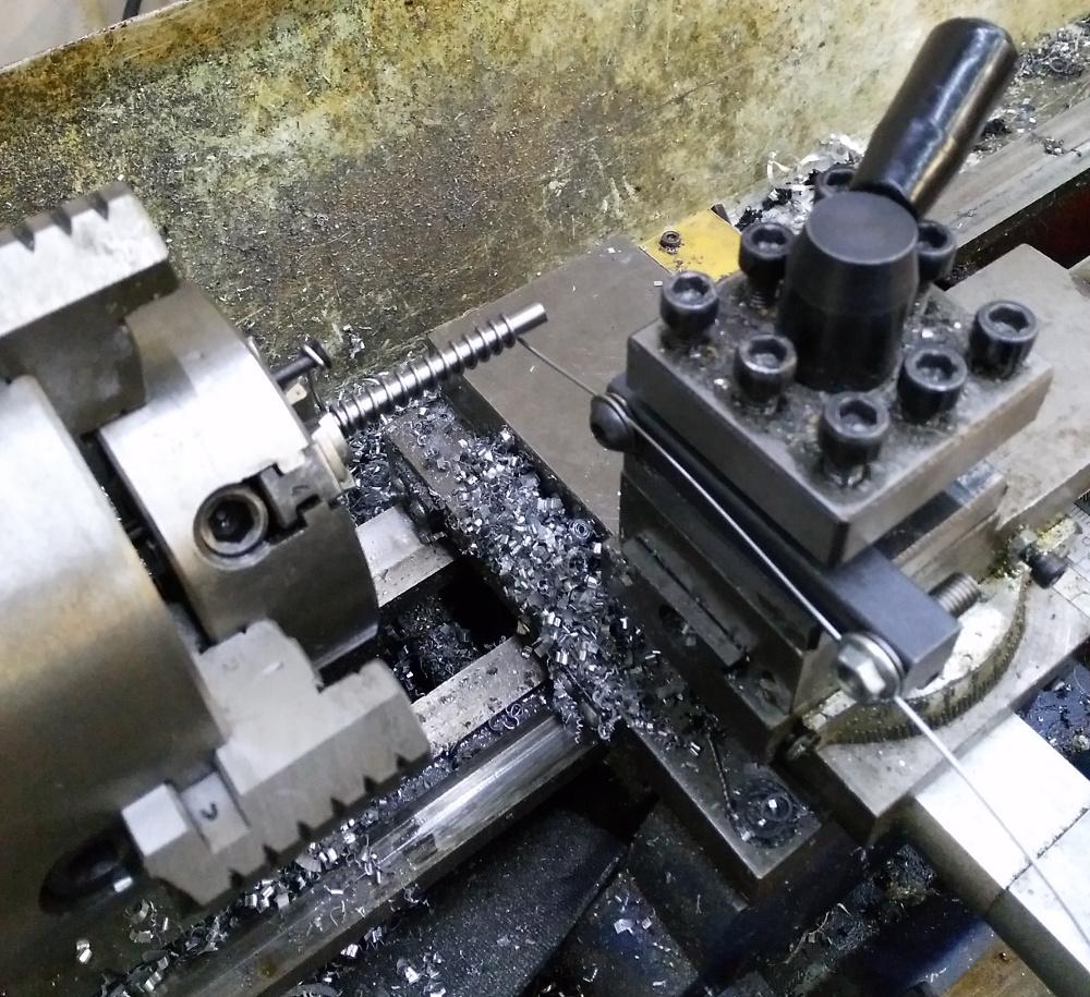

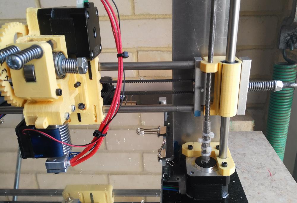

Hi. Just a few pictures of the X Axis belt tensioner and idler. This uses the two horizontal smooth rods to generate force against to maintain belt tension. It is effectively decoupled from the z axis rod as the plastic support allows the horizontal rods to slide smoothly. The X axis smooth rods were drilled at the end and an extension piece of 5mm dia bar were inserted. The original plastic part was altered as shown. The adjuster arrangement slightly increases the available x carriage movement.
Spring is 11T of 1.2mm piano wire wound at 2.5mm pitch on a 6mm rod to allow tension adjustment up to 4Kgs. Max motor rating is 2.8Kgs at 20mm from motor flange.
Best Regards
picclock

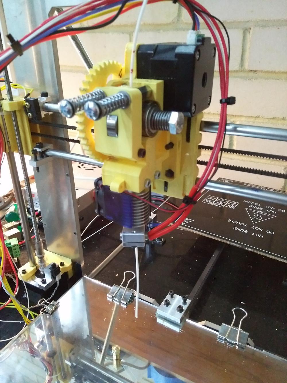

« Reply #24 on: February 25, 2016, 08:22:02 AM »

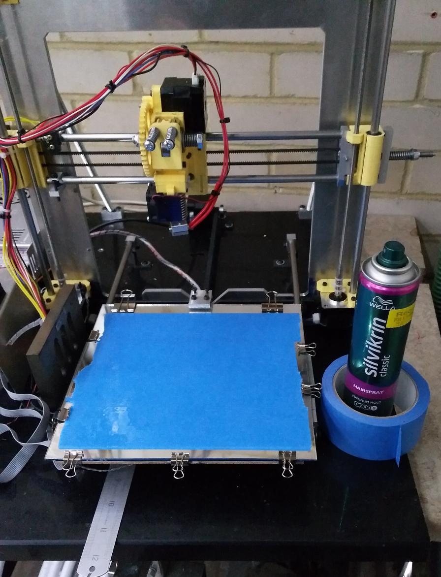

A little more progress. Pictures of installed X tensioner and belt, with extruder mounted. As soon as I get acceptable prints I will replace the extruder, and at a later date install a bowden type version as this will reduce the load on the X axis. Made a neat bracket for mounting the X limit uswitch. Also made a mess of the cooling fan shroud as it hits the X carriage as it descends. Its about 17mm too high so I think a redesign is likely the best approach.
Best Regards
picclock

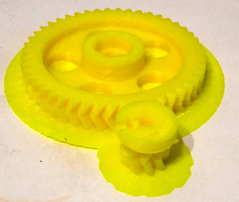

Looking good! Will be interesting to hear your experiences of the build. You have a number of neat solutions of which some will be on my list for improvements.
I hava also been thinking a bit about the extruder, I have the Wades version a bit like yours, but not completely. With the stepper it is a quite heavy bit to be carried by two 8mm bars. Moving the feed to the portal and having a PTFE tube leading down to the hot end would relieve the X carriage of some weight.
BR
/Peter
Offline picclock
  • Posts: 613
« Reply #26 on: February 26, 2016, 04:35:12 AM »
Hi PeterE
Thats my opinion also. One of the issues with Bowden feeds is that the longer the feed and the more that it bends the greater the likelihood of the filament buckling/jamming. I have in mind to limit the range of bowden movement by supporting the extruder drive above the centre of the X carriage whilst connecting it to the Z bar supports. This would make it a constant height above the head enabling a much shorter bowden length.
Re the weight on all the axis. The heavier and stiffer it is to move, the lower the accuracy will be. That is why I am driving the motors closer to the rating. If you think of the motor as a spring, the further it deviates from its intended position the larger the force needed to move it. But this means that for small deviations only a low force is needed. By increasing the motor current the spring is made stronger and better accuracy/repeatability more achievable. Obviously, this only applies within any given motor true step, typically 1/200th of a revolution.

Hi All
Things have moved on a bit since last post.
The bed wiring is now complete, with it passing through the belt attachment for the glass bed. When fully operational one of the first things I will print is cable chains for the X and Y axis. The cork is attached to the heater pcb with a high temp silicon adhesive, and this in turn is attached to the glass with clips as shown.
The Z limit switch is sorted, and the Y axis switch fitted. The Z limit switch is one I reused from a scrapped photocopier. Although it is push to make, (default is push to break so that wiring integrity is maintained) the accuracy and repeatability are better than I can measure. I put one of them in my mill vice, connected to a beeping continuity meter and used the Z digital readout to detect the point of switch actuation. The reading at the switch point was exactly the same, so its easily as good as 0.5 thou of travel. Picture with simple mounting and adjuster below.
The distance between the print head and bed is an important setting to ensure the correct adhesion of the first level of plastic. Having powered it up, I was able to set this to 0.05mm, by adjusting the screw and re homing the axis. Once the left side was complete I manually adjusted the right side to the same gap. I intend to automate the bed levelling process by using a servo and a limit switch, parts on order.

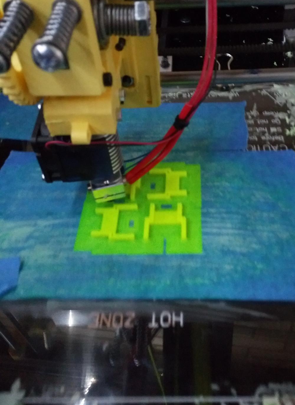

Next, the filament feed calibration. This is achieved by simply marking a piece of filament and telling the extruder to extrude a given distance. For this I removed the extrusion nozzle and set the minimum extrusion temp to 1C in the Marlin firmware. I had an extrusion rate figure from the internet, taking account of the different gear ratios, and in an unusual stroke of good fortune this proved to be exactly correct. I extruded 100mm, and exactly 100mm was extruded :thumbup:
So for a trial print. I thought I would try the blue tape adhesion method first with some hair spray to help things along. I loaded up a new reel of blue ABS filament, sliced the design for a cable chain link in cura, and dropped the file into the octoprint browser window. Had a quick think to see if I had missed anything, then clicked the print button. The bed started to warm to its final temperature (100C), once reached the print head quickly warmed up to its operational temp (230C), and the process commenced. I was very impressed with the fine detail of the outline and its accuracy. All seemed to be going well, with the first layer going down but after 4 or 5 layers the parts started to warp and come off of the bed, at which point I cancelled the print.
I thought I would try to improve the bed adhesion using abs juice so attempted to make some from the scrap printed parts and filament dissolved in acetone. I left this for several hours but was surprised to find that it had not dissolved, in fact was not even sticky. I took a piece of known ABS and dunked it and it went sticky almost immediately.  :scratch: I was thinking that I had been supplied with the wrong filament type, so I checked out a roll of conductive abs filament, which I had ideas about using for plated items. In doing so I came across the original carton which clearly showed that my blue abs was in fact nylon, and further checking of the order indicated this was exactly as ordered. Its a terrible thing getting old .. . :loco:
I have ordered some other colours of abs and hope to show some first printed parts soon. I may have a go using the conductive abs, but this is far from typical due to the carbon loading, so will not be too good for calibration. The white roll of PLA I have may be useful for testing or prototyping but not very good for calibration or working parts.
I also think that it would be a good idea to fabricate an enclosure to maintain an even, elevated temperature throughout the printing process, as this would minimise warping.

Looking really good picclock  :thumbup: :thumbup: :thumbup:
I was given the tip to use a dab of acetone at each corner of a beginning print to make it stick better to the build plate. That should be enough I believe. I will use one of those cottonbulbs on sticks (whatever they are called in english) to get that necessary small amount. Of course that means that I will be using ABS most of the time anyway.
The daughter is now nicely installed in her new apartment so time for shop activities is in sight  :drool:
/Peter

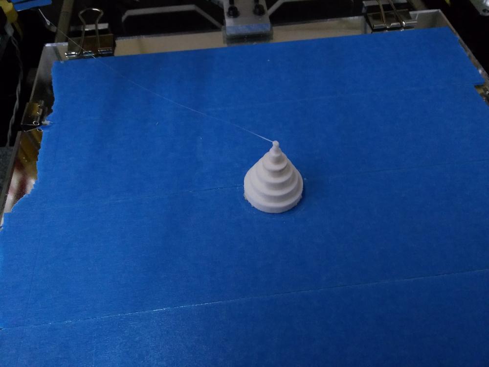

Hi All

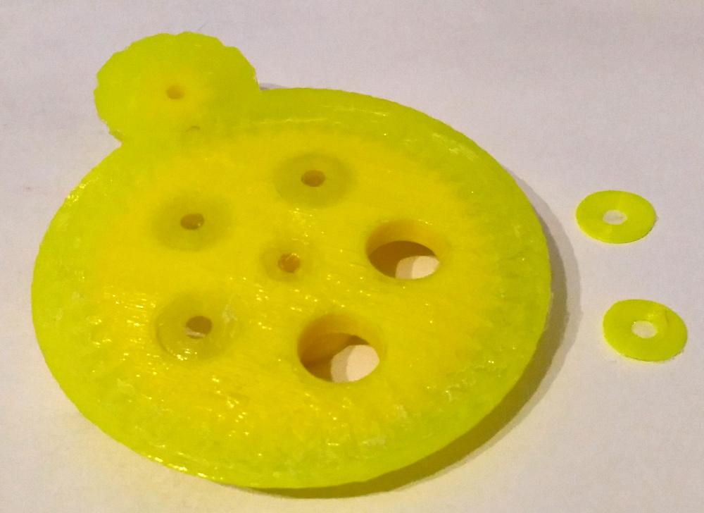

Thanks for your kind comments PeterE. How would you know where to put the dabs of acetone to hold it down? With a heated bed I would imagine it would evaporate very quickly, and when printing multiple items would be very difficult. Supposedly, with abs juice (a mixture of acetone and abs) you can just wipe the bed over and the job is done.

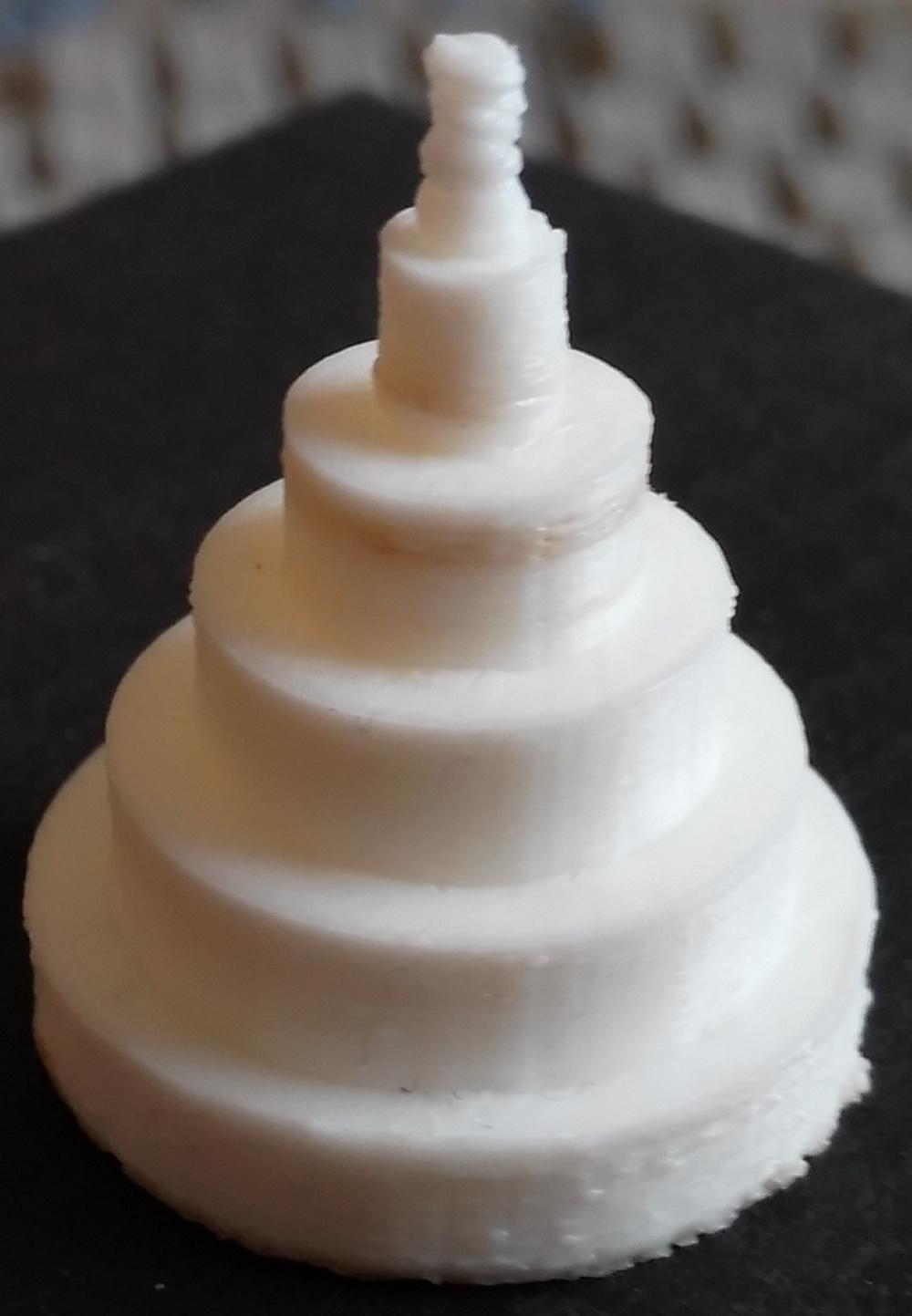

Picture below of my first print (PLA). On the whole, not too bad. Its the right shape and reasonably concentric. Surface finish is very good, better than I expected. Its all slightly undersized, likely due to shrinkage.
Measuring the 1st step up from the bottom i get 19.75 at the narrowest point and 19.90 at the widest, so about 0.15mm out of round, and 0.18mm too small. Part of this may be because the slicers define a circle as a multisided polygon, and the number of sides will affect the circles concentricity. The steps narrow slightly in the middle before coming out again at the top. The step heights are pretty good, at 5mm +-.05, which is impressive for two bits of M5 studding.
The top pillar is nbg, as the plastic did not have time to harden before the next layer was added. The slicing was done with Cura, with its recommended temp setting of 210 for PLA. Other users recon from 160 upwards so it may be too high. Also Cura allows the setting of a pause time between layers for the plastic to harden, so I may well experiment with that.
Unfortunately, PLA is just not suitable for the things I need to make, mainly because of its low temperature softening, so I will have to wait until the abs arrives.
Best Regards
picclock

  • Posts: 458
  • Gothenburg
« Reply #33 on: March 11, 2016, 04:48:50 PM »
The tip I was given on putting a dab of acetone to "glue" the print to the bed was to do it when the "skirt" is laid and then dab in "four corners" of course regardless if the object is round or not. It would evaporate quickly, but I don't think quickly enough to not glue the part to the bed plate. My own experiments will tell.
When it comes to temperature I have underrstood it so that the range given by the maker of the filament is the appropriate range, and I would start at the lower end to begin with. This to get a good bond between layers but still easy enough to spread. I guess this is one of the things that even may be different from machine to machine as the machine placement could affect the surrounding temp.
Making a box around it would make that easier to control, and you would get a chance to make an "exhaust" to guide the print fumes out of the room to keep it healthier.
BR
/Peter
Offline Pete49
  • Posts: 353
« Reply #34 on: March 11, 2016, 10:04:32 PM »
I have found the best glue to use is cheap hairspray :lol: It sticks ABS and PLA well and when it cools the items lift off. I put on 3-4 coats then refresh it every few prints. This is on a heated glass bed though.

Hi PeterE, Pete49. Thanks for your thoughts. I will certainly try those ideas next time I am printing.
Because my printer is in the garage, and I am in the office, I need a way to power up and program the printer remotely. I am using octoprint with a raspberry pi, and this can be modded to allow other control outputs, for remote power on/off and camera on/off. Then I will be able to print stuff remotely, check how its doing, and if necessary, power off the printer. To this end I have designed a very small pcb to attach to the pi to drive a solid state relay and camera on/off with a spare output for stuff I have forgotten. I will start a thread in the electronics section for this.

 Hi. So I have designed and completed my little RPi addon pcb - see http://madmodder.net/index.php/topic,11358.0.html. Octopi now sports two extra on off options on the system menu to control the power for the printer and webcam. So all appeared to be going well. The abs filament has arrived and I made some abs juice to try out as per web instructions. Fired up the printer with the intent to print some cable chains to try to sort out the mess of wires. Dropped the sliced Gcode file onto octopi and hit print. Then about 5 mins later as the bed was warming up there was a loud crack and the mirror bed had self destructed. :scratch: From the pattern of the break it looks like it may have been caused by differential expansion of the glass - it occurred at around 85C - see picture. Was not expecting that. Glass was 2mm, which may be a bit thin.  No other mechanical stresses on the glass. Looking at the odd fracture pattern it could be that the centre warmed and expanded more quickly that the outer edge.
Best Regards
picclock

« Reply #38 on: March 15, 2016, 05:33:40 PM »
picclock,

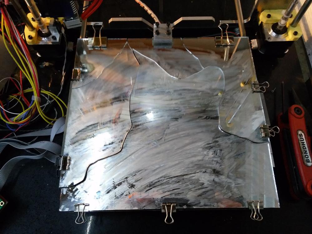

Ahh, too bad when such things happen ...
The glass for my bed is a 200mm square piece of borosilicate glass around 3mm thick, so thicker than yours but can also handle higher temperatures. Borosilicate glass is the same type used in some oven-proof bowls and dishes for pies etc. It may be so that the mirror glass is basically ordinary glass with less temperature range and together with the variation of temperature it could crack easier. This is just a guess though.
Another thing is that I hold the glass plate to the heatbed with just four clips, one in each corner, that will also slightly lessen the clamping forces if the bed warps or twists during heating.
My 2 cents ...

The glass that cracked on mine was only held by the 4 clips at the sides. The end clips hold the bed heater to the glass. The fittings that touch the glass underside are all fibreglass to act as a heat break. Borosilicate is without doubt an improvement, but have also read about that breaking, not sure what the mechanism for that could be. Several things spring to mind. It may be that adding an insulating layer to the top at warmup would cause the heat to be more evenly distributed, the layer could be removed prior to start of printing. An aluminium heat spreader under the glass could improve heat transfer. Alternately a slower warmup period would allow the heat to spread more evenly. Thicker glass would also help by increasing the heat conduction path to the outer edges. If I can get hold of some borosilicate glass I have no doubt that would also improve things, but I doubt it will be easily available.

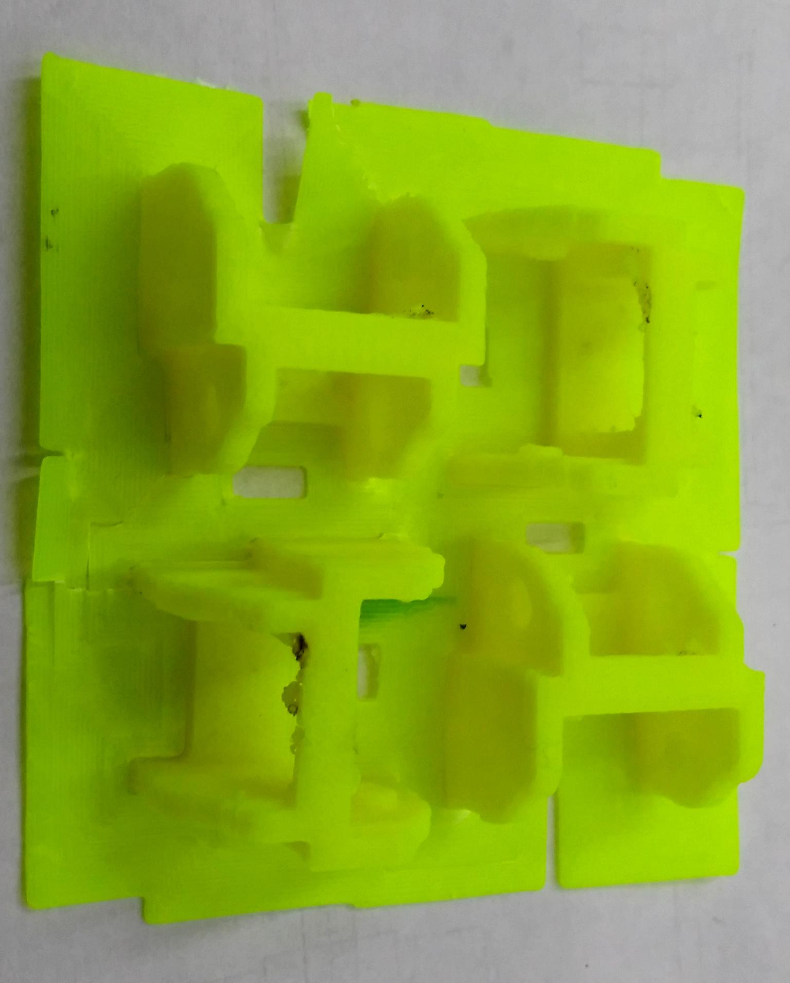

Hi. I have managed to print some usable bits but things have been difficult. I replaced the mirror glass with some 4mm glass liberated from a skip behind a window shop (with there blessing). I heated it to 115C and all seemed fine, but after the first print it had cracked again  :palm:. prior to the print I had been monitoring the temperatures with a thermocouple type thermometer. The nozzle temp was exactly correct - quite impressive really. However the bed temp is all over the place. The centre area, on the surface of the glass was about 95-98C measured, however an inch or two from the edge it had fallen to 55C or so. With that kind of temperature gradient over a couple of inches I am not surprised the internal stresses caused issues.  Also as the bed moves small distances cold air is pushed onto the edges but the centre always has warm air, exacerbating the thermal gradient.
So I have thought of several fixes which will hopefully improve the situation. Firstly, use an aluminium heat spreader directly above the heater below the glass (will try 1mm as I have it around). In the centre area of this I could put some kapton tape to further reduce the centre temperature and increase the heat to the outer edges. Secondly, I could fit an air dam around the bed, basically just a 25mm high strip of an insulating material, which will prevent cold air from reaching the outer areas so readily when the bed moves. Thirdly, a form of enclosure to prevent external drafts from having an effect. If I'm lucky this will bring things under control and resolve the issues.
Pictures of my first real parts follow. As you can see, the cable chain links were printed with a large raft to promote adhesion. The bed cracked part way through printing, though it was held together with the tape. Use of the tape likely increased the thermal differential even further, promoting the failure. The yellow stuff around the edge was from some attempts I made to print with ABS juice, which did not seem to work well. For printing, bed temp was set 110C, and nozzle temp 260C. Sliced with Cura, 0.1mm layer thickness. Layer adhesion was excellent, although it struggled with the bridge across the top of the links, as can be seen from the top right hand link in the 'chain links on raft' picture.
Hope you found this informative and of interest.

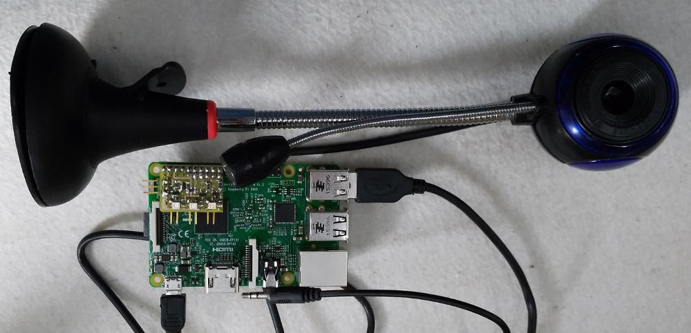

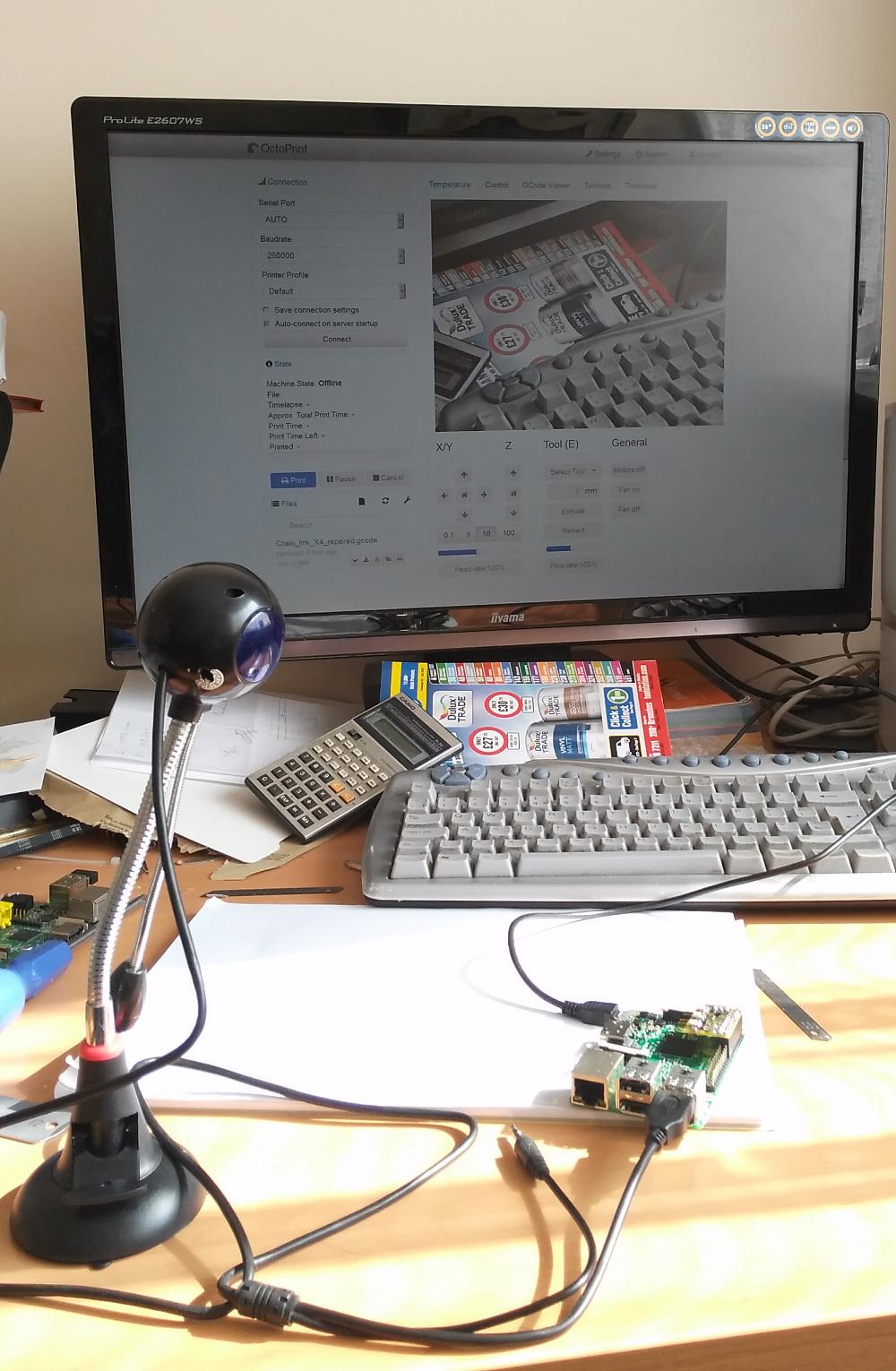

Just thought I'd share my experiences with a very low cost webcam. Advertised from ebay :
http://www.ebay.co.uk/itm/Mini-USB-2-0-PC-Camera-HD-Webcam-Camera-Web-Cam-With-MIC-For-Computer-PC-Laptop-/311435955773?hash=item4883078e3d:g:ipYAAOSwd0BV5En1
With the original description original Mini-USB-2-0-PC-Camera-HD-Webcam-Camera-Web-Cam-With-MIC-For-Computer-PC-Laptop
So I did what most rational people would do, having checked its functionality, and not believing a word of the advert, I took it apart. Did a quick internet search for the pcb number, and came up with :
http://www.penguin.cz/~utx/hardware/USB_Camera_AX2311/#cheap_usb_web_camera_teardown_analysis_and_examples
from Stanislav Brabec. So my HD webcam is in fact a more sedate 640x480 1.2Mpixel device. However, I am not surprised, as this is pretty much exactly what I needed, and combined with the any position camera neck and suction base I think that at £3.66 it represents very good value for money, though I have since seen it cheaper. The only mod I made to the camera was to remove a plastic ledge from around the base of the lens to allow me to focus it more easily. I found this works in Octopi with camera_usb_options="./mjpg_streamer -r 640x480 -y -n" set in octopi.txt
You can see the quality in one of the pictures which show it in operation.

A little more info. Earlier, i was having issues with bed glass cracking due to differential expansion. I measured a centre to edge glass temperature around 50C, hence the glass failure. I then fitted a 1mm aluminium heat spreader between the glass and pcb heater. This worked incredibly well, bringing the differential, centre to edge down to about 5C. After taping the edge the the difference over the bed is around 1 or two C, pretty perfect. However this has shown up weaknesses in the pcb heater, as it now reaches 100C/ with an ambient of 10C, which is a bit on the edge, but at least it allows abs prints to stick (with applications of hairspray, followed by ABS juice). I think it likely I will replace the pcb bed heater and spreader with a 2mm aluminium sheet with resisters attached, as this would allow double the heating power with much faster warmups. Because the sheet will be warmed evenly no warping should occur - well maybe.
So onto printing my first working parts - at least attempting to. In order to get parts flat I have found the use of a raft is essential. Picture shows raft pieces being broken out. However, if you look carefully at the topside picture you will see the top of the spur gear is missing. I thought this was a slicer area or software issue, but I later found the filament had caught in one of the notches on the supply reel, resulting in the filament being shredded in the extruder. Extruder maintenance now needed  :drool:

You are advancing very well indeed!  :thumbup: and solving the cracking glass plate matter as well - very good!
I notice that you are using a good skirt or raft which I also think is very useful when printing. All the parts I got to build my machine had the same type of raft. simple to clean out and it gives flat prints very well. Bugger about the filament catching the spool and shredding just at the final bit.
You are well on your way now.

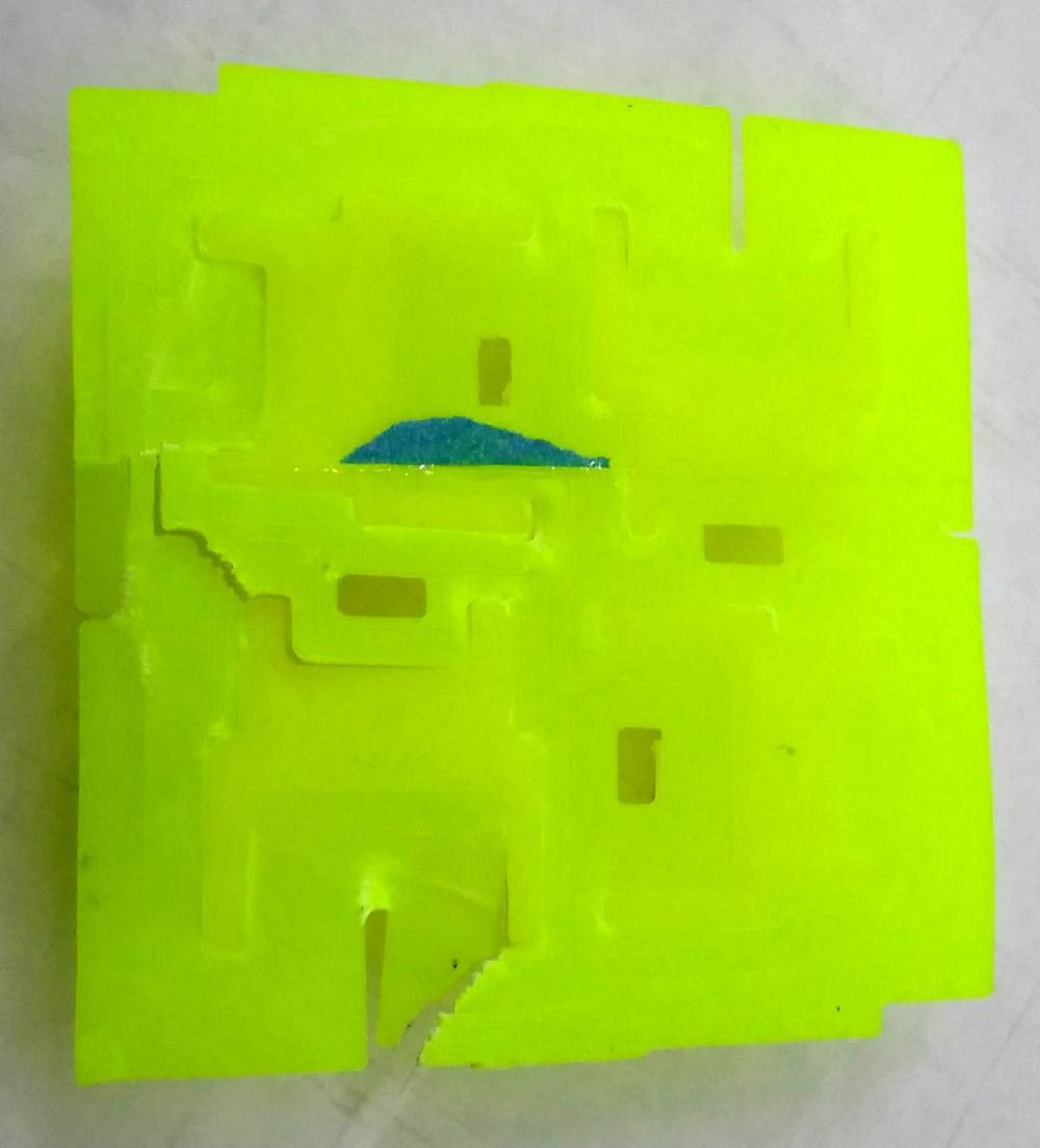

So having got to the stage where I can print some stuff I thought I would have a go at designing a new X carriage and printing it. It will incorporate a servo for automated bed levelling/calibration, a longer std Lm8Luu for the upper bearing and a std LM8uu for the lower one. I decided to use Designspark Mechanical because it is the right price (free !!) and simple to use - a definite requirement.
As you can see from the pictures I made the rookie mistake of generating an unsupported edge at the bottom which came out straggly. The part shown is still attached to the raft which will break away easily if I decide to use it.
I have also decided to scrap the underperforming heater bed and replace it with an aluminium plate heated with resistors. See next post.
Best Regards
picclock

Sadly the above part did not conform to the drawing  :scratch:. There appears to be a fixed extrusion error which makes all the parts 0.14mm larger than they should be in the X and Y direction. This is not a scale error, but a fixed addition. So that whether the part is 10 or 30mm long the length will be increased by 0.14mm. This also makes slots or gaps approx 0.28mm smaller. The part was made with ABS, a 0.4mm nozzle (Std E3D V6) and a 0.2mm layer height. I have tried adjusting the extrusion rate (Cura Flow) to 80% but this just seems to create weaker parts, with minimal effect on size change. The positional accuracy of the nozzle is pretty good (X is amazing < 1 thou deviation over 20mm), see attached pdf. So I think its likely that the slicer is not correctly calculating the extrusion bead thickness. I have checked the filament diameter, and its very good, varying between 1.69 and 1.75 mm. I have also checked that the correct amount of filament is being extruded by the firmware, and its spot on.
Any thoughts or ideas or fixes ( :beer:) much appreciated.

« Reply #52 on: April 29, 2016, 05:08:34 PM »
picclock,
I am inclined to go along with the answers in Pete49's thread in that the oversize is due to good accuracy  :loco:
What I mean is that your extruder nozzle lays the melt string at the center of the line stated in the program but it flows out a bit on either side then making the part ever so slightly wider than was expected. So like already suggested, try to compensate that by decreasing the important measures according to the overflow to give a detail taht is spot on.
You seem to have very consistent measures so accuracy is really not a problem. It is just necessary to compensate for the true width of the melt string to get items on spot.
One of those parameters to compensate for that was not obvious from the beginning.  Oh how much one learns from all these threads.
BR
/Peter

« Reply #53 on: April 30, 2016, 09:52:29 AM »
Hi PeterE
I'm pretty sure the slicer is supposed to compensate for the extruded bead width. I tried  the craftware slicer on one of my test pieces printed with 0.4mm nozzle and 0.2mm layer height as before, and although for some reason it failed to complete the print, when I measured the base it was pretty spot on, 19.99x 20.02 ~ so they clearly got that bit right. It sort of confirms my guess that the slicer is causing the issue.
Think I just need to find the right slicer. Am going to try slice3r, kisslicer, repsnapper, and any others that come to mind, feel free to recommend an alternate.

Hi all
So I have my printer up and running (mostly). I have replaced the original X carriage and extruder, and fitted a bed levelling servo, all very worthwhile. The extruder upgrade allows instant changing of filament and jams are a thing of the past. The bed leveling system is worth persevering with and works really well. Main snag I found was that the cura slicer preamble inserts an G90 absolute positioning code which destroys the bed levelling settings in marlin - so I edited the cura definition files to remove it.
But (there always is one  :scratch:) the performance is poor by my standards, probably aggravated by the use of ABS, needed for its higher temperature stability. The problem is warping of the part caused by the differential expansion of the plastic. The initial layer is stuck onto the bed by a combination of heat, pressure and a certain amount of magic  :med: in the form of ABS juice, PVA, hairspray, or whatever works for you. Bed adhesion does not seem to be a problem using just dilute PVA, and if you add ABS juice to it you will have a very hard time removing the part, however I digress. Once the initial layer is attached the next layer is added. The temperature of the subsequent layer is determined by temperature of 1st layer, surrounding temperature, and radiation/convection of the same. Subsequent layers therefore experience a different temperature depending of the heat losses of the layer, layer size (more time to cool for larger parts) to which to adhere. If the plastic is extruded from the nozzle at 240C, and the temperature at which it hardens is 100C then the surface temperature to which the subsequent layer attaches is very poorly defined. Once removed from the bed the temperature of the layers will becomes equal and warping occurs, because at the same temperature the layers are different sizes. It always seems that the bottom layer becomes convex which implies that the temperature of the plastic when deposted, bonded and hardend is higher than that of the bed, presumably because the heat maintained in the previous layer is greater than the bed temperature. So the upper layers shrink more and warping occurs.
ABS has a glass temperature of around 100C so one would think that provided all the layers were bonded at that temperature warping should be a thing of the past. I have already taken steps to guard the print bed from drafts but this does not seem to have improved things much, despite having an internal temp of ~ 40C.
It occurred to me that it may be possible to solve two problems with one solution. Instead of using a heated bed which adds to the Y axis movement mass, why not heat the whole interior of the machine to 100C using circulated air to even out the temp differential. Could use heat bed controls with fan for circulation. This would eliminate the need for an underglass aluminium heat spreader as the whole interior would be at one elevated temperature. To prevent heat damaging the extruder, belt, motor etc a plastic oven bag or sliding fibreglass/srbp heat seal could be used, attached just above the print head as a possible solution, minimising heat loss.
Still at the thinking stage on this so if anyone has tried this or has any further thoughts on this solution please contribute.
Best Regards
picclock.

Hi efrench
This is not a problem about bed adhesion, though I found that tricky at first. I'm using 100 or 110 for the bed and 260 for the filament - which may be a bit high but it generally seems to work well. I usually print with a brim and I don't get corner lifting, or if I do its very minor. Some of the best results seem to come when using a raft which effectively throws away the first three layers. The trouble with using a raft is that the finish is poor on the detached face.
Using PVA and a light smear of abs juice attaches prints almost too well, but that is not an issue. I always wait for prints to cool but once released they start to warp. The upper individual strands are under tension, the lower under compression and the only thing resisting this change is the stiffness of the material. I did a test with a heat gun warming a part and the warp increased from about 3mm to 7mm over 100mm.
Clearly this is an issue that needs solving. I understand that Ultimaker uses a fan blowing temperature controlled air across the top layer during printing as a way to improve this issue. Having thought about the heated chamber idea a bit more it occurred to me that I could do something similar and attach it to the print head. By attaching a conical hot air duct (made using soldered tin can) to the nozzle and heating the air with a couple of 40W cartridge heaters with a heat exchanger, I could use the waste air from the head cooling fan to cool the extruded bead in a controlled fashion, hopefully eliminating (or at least minimising) the problem. It should be possible to control the air temperature and set it just below the glass temperature of the plastic being used. Ramps and marlin allow for a second extruder so the temp control is already there with the addition of a thermistor. Not sure if that makes much sense but it is very much an idea in progress  :coffee:
Best Regards
picclock
Offline efrench
  • Posts: 218
« Reply #62 on: June 07, 2016, 04:25:58 AM »
Have you tried normalizing the print with the heat gun before removing it from the bed? It might work.  I haven't had any warping problems when the print stays attached to the bed, so haven't tried this.
I had a jamming issue which turned out to be lousy diameter control on some cheap filament.  Before I discovered the source of the problem, I increased the temp to 260. While this lessened the jamming problem, it didn't cure it.  After putting on better filament, I printed a temperature calibration object (just a tall single wall rectangle). I edited the gcode to change the temperature 5 degrees every 10mm.  After inspecting the print I lowered the temperature to  240/230.
Offline picclock
  • Posts: 613
« Reply #63 on: June 07, 2016, 09:39:39 AM »
hi efrench
The reason for 260C temp was to try to improve layer bonding. On tall objects there are visible gaps in part of the layers which start typically at 2-3 cms and occur every few cms after. I suspect the layer bonding and object warping are all part of the same problem. Thanks for the idea of heat treating the part before removal. It may well be a simple, viable solution and I will give it a try. I am not overly keen on it as it may introduce other dimensional errors but its certainly worth a shot. I suspect the trick is just to supply the right temperature for the right amount of time .. .   Also thought I might experiment with a heated chamber using my heat gun as a 1 off to try it - probably about 100C should do it.
Best Regards
picclock

Thanks for the reply. I have lots of heatshrink to fit the wires so the next project is going ahead.
I made a cardboard surround lined with alfoil to retain the warmth which works well and the power unit and Arduino board are outside of this to avoid heat related complications. I decided on cardboard (the type with 3 layers 2 smooth and an inner of corrugated cardboard compliments of her new TV) due to lightness, ease of access and the fact that our mild winters don't require extra padding. The only thing I felt needed extra work was making a base for it to sit on so I could secure the printer to it to make the print bed less flexible.
Offline picclock
  • Posts: 613
« Reply #67 on: June 14, 2016, 06:36:28 AM »
Hi Pete49
The base of any accurate machine is the most important part, as all accuracy depends on its stability. I used a granite kitchentop for mine, granite being commonly used for accurate measuring systems. For this sort of stuff most decent non temperature/humidity affected materials will work OK, and best of all, when you set stuff on it, it accurately stays there.
Good Luck
Best Regards
picclock
Offline Pete49
  • Posts: 353
« Reply #68 on: June 14, 2016, 10:38:04 PM »
Hi Pete49
The base of any accurate machine is the most important part, as all accuracy depends on its stability. I used a granite kitchentop for mine, granite being commonly used for accurate measuring systems. For this sort of stuff most decent non temperature/humidity affected materials will work OK, and best of all, when you set stuff on it, it accurately stays there. picklock
These are my thoughts too and the reason for wanting a base to solidify the machine. At the moment the heater bed section can move about 6mm either way and while it hasn't moved during printing yet I prefer it not to be able to move at all so a good base is my next move. The wiring mess has been brought under control while I wait for my new 2560 board. I haven't found the cause of the reason it went dark but I'm still looking :doh:
Offline picclock
  • Posts: 613
« Reply #69 on: June 15, 2016, 03:27:14 AM »
Hi Pete49
I had that happen to me early on. Turned out the on board regulator chip had died. I think it might happen when you plug it into USB (3?) whilst its still powered up. If the power to the USB goes the board tries to power it and it overloads the chip and its game over  :zap:. I replaced mine with a 7805 (see piccy) and once working then proceeded to blow up a different part of it by accident  :wack:. After that I ordered two, one for a spare.
Best Regards
picclock
« Reply #70 on: June 15, 2016, 06:01:58 AM »
Neat leg bending on that regulator  :thumbup:
Offline Pete49
  • Posts: 353
« Reply #71 on: June 15, 2016, 11:16:59 PM »
Ta I'll check that as I'm sure I did something similar. How do I check it? I can sympathise with you blowing anther place. I managed to kill the Da Vinci by shorting the thermistor by cleaning it with the supplied brass brush while the power was on.  They don't have a fuse as such just a o value resistor which I fixed by removal and a wire across the gap and put a 4A fuse in line. fired it up and the fuse blew now looking at finding that fault. :Doh:  No rest for the wicked at the moment.
