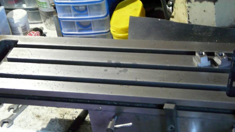

The table on the Ajax mill I'm refurbishing has some surface defects......some of these are quite deep....>~ 1mm...
What do we think is the best way to refinish the surface to remove these?
I've thought of clamping the table to that of my big mill (Chester Eagle 30 ) and using a fly cutter.....

Yeah I've seen various filling in options, but what I was hoping to achieve as a bonus was to rid the surface of the rust covering that it has accumulated too....Potentially I was hoping to off load the mill to sone poor unsuspecting type sell the machine on in good nick.....
Re: Mill table resurfacing
« Reply #3 on: October 03, 2015, 11:41:39 AM »
If you do remove much surface depth, make sure you don't take off so much that tee nuts bottom out on parts and accessories when tightened. Also, of course that the surface you leave is as true to the slides and ways, or truer, than you started with. A cosmetic cure can sometimes become a functional issue for a whole lot of different reasons. A buyer who is aware of cosmetic problems won't be upset with the purchase if it's reasonably accurate for its age. One who buys a freshly machined table that is inaccurate will feel resentment. Not saying don't do it, just think about it.
Rust can be removed by the electrolytic process with washing soda and a battery charger using a plastic dustbin.I've even done it in situ with cloth pads dampened with solution and a plate for an electrode over.  It's amazing what that can do to an ugly machine surface. It can look new in sheen, and any divots filled with plugs or epoxy filler so everything looks ship shape and well managed, just not perfect.

I've cleaned it up with a wire brush and it doesnt look so bad now.....  :scratch:
I may give a once over with some wet n dry paper to polish it and see how it looks after that....
The holes are relatively small, there are a few lengthy gouges in the surface but they are not deep....
Might be best to leave well alone?

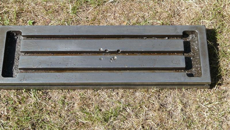

I filled mine with super glue and cast iron dust , the small ones just with super glue neat it takes a fair bit of sanding off
« Reply #9 on: October 06, 2015, 03:28:05 PM »
Looks a good repair... :dremel: :dremel:
I might give that a go.
That said,I have some aluminium based filler that I got from Halfords might do the job... :scratch:
