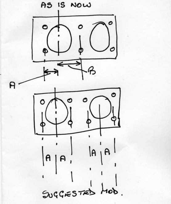

After lookomng at the drawings and measurements once more, it looks as if the 1.5x goal has put me into the "expensive materials" category, as the block will be just over 3" long and 2" high.  Trying to find brass with those dimensions doesn't appear straightforward.
I am thinking it should be possible to make two separate cylinder blocks.  Any reason that won't work?

Perhaps cast iron for the block would be possible using 1 inch thick bar stock which is a little thin

Kvom,
Are you going for steam or air driven?
I keep asking this question, but it does mean that if you are only going to run on air, then almost anything will do for the main cylinders, even something like nylon could be used if you can get nice smooth bores. I would suggest a nice cheap material like free cutting mild steel. EN1a here in the UK, or ali.
But if going for steam, then cast iron, bronze or brass should be your first choices.
I have included a C-o-C for perusal.
The central mounting bolts do play an important part in the makeup of the engine, in that they stabilise the central portion of the top mounting plate.
But if you can get the hole pattern in like is shown in the bottom sketch, that will do almost the same job, and I wouldn't envisage any flexing problems.
If running on steam, in fact, having a gap between the cylinders will help in the steaming qualities of the engine. It will allow the engine to warm up a lot quicker and produce less condensate. Have a look at how I have seperated the cylinders on the 'blinged' one. That reduces the mass for the steam to warm up, but still retains the one block principle.
Before doing all your final 'exact' calculations for the cylinder bores, settle on a size that matches generally available o-rings. The engine will run quite happily without rings on either steam or air if a couple or three fine oil grooves are put around the piston, but again, if you want to fit rings, if just air, anything will do, but again, with steam, the choice is limited to either Viton (recommended) or silicon (not recommended if WD40 or most other spirits are coming into contact with the engine for cleaning).
I hope this helps you in some way.

I will be running strictly on air, and using an oiler-regulator for lube rather than the displacement oiler.  For that reason I also plan to make the handle on the control block more like a manual one.  I plan to make the pistons from aluminum with oil grooves rather than rings.
I am really wanting to have an "all brass" engine for the look.  I could definitely change the mounting hole pattern for more stability.  I do have a block of a reddish brass alloy at school that might work, but will have to wait until tomorrow night to get a measurement.  It's the same material from which I made the cylinder for my beam engine; someone thought it might be beryllium-copper.

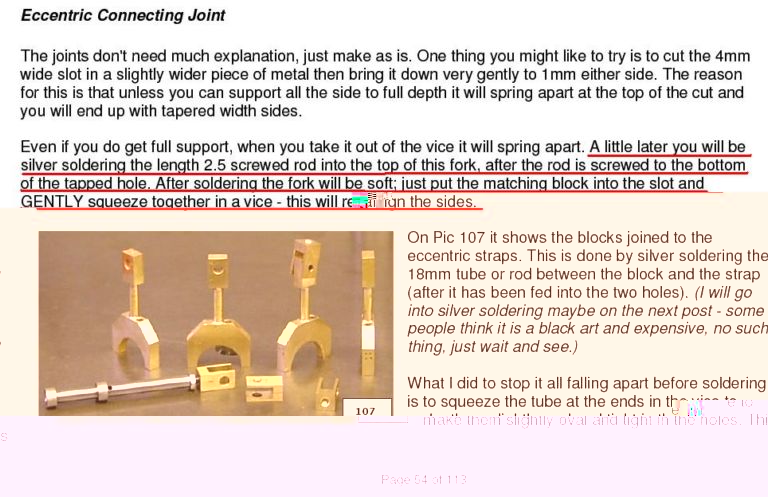

I can't seem to find a description of the threaded adjuster that connects the eccentric fork to the spool valve.  Can you point me to the right spot in the book?  Or is iit just a length of threaded rod with a jam nut?
bogstandard
Re: Bog's Paddleduck Engine
« Reply #46 on: May 08, 2009, 12:19:44 AM »
Kvom,
Here is the description, not much, so that might be why you couldn't find it.
Yes it is just a bit of threaded rod and a locknut.
Bogs
