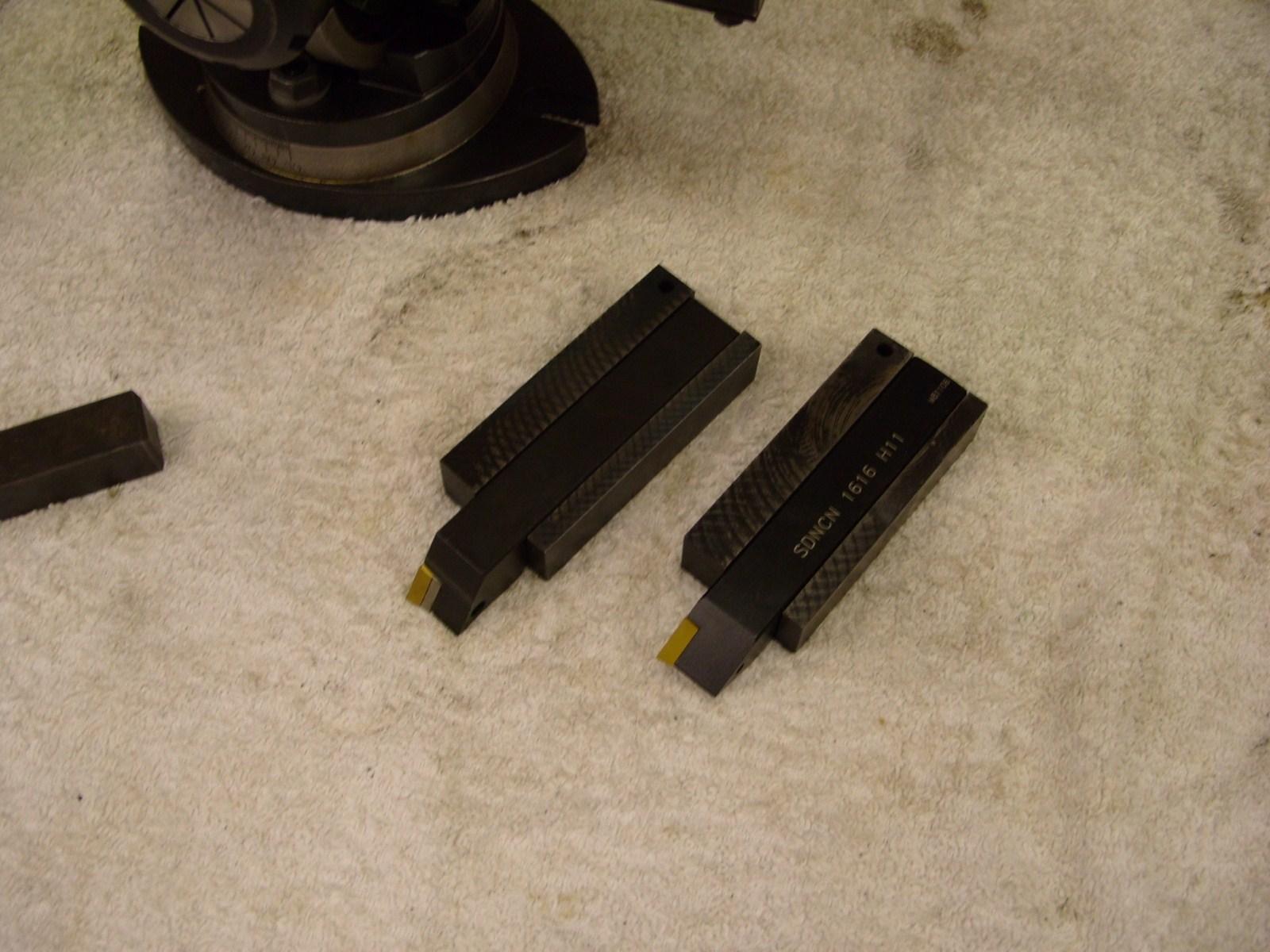

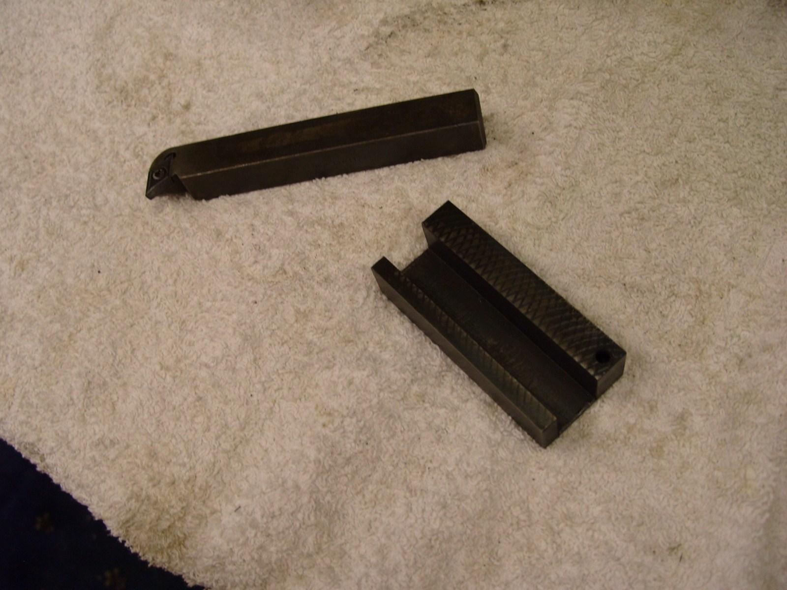

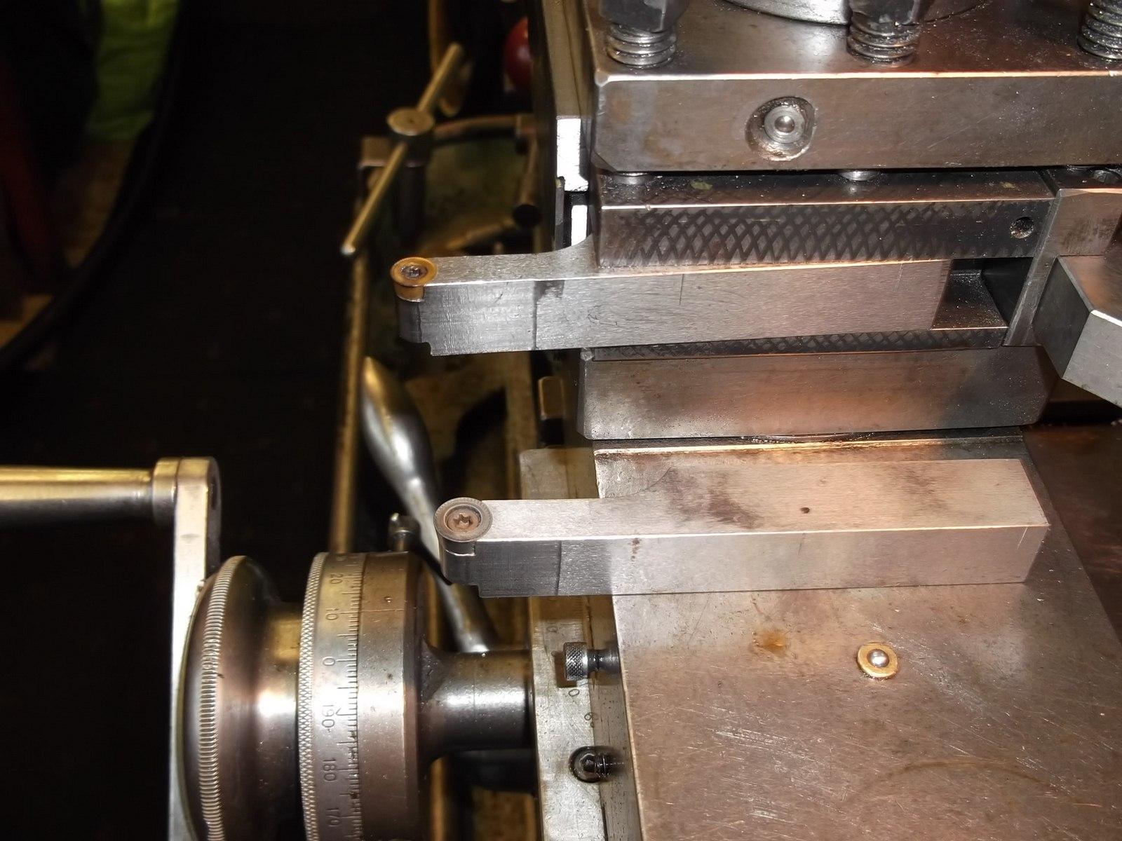

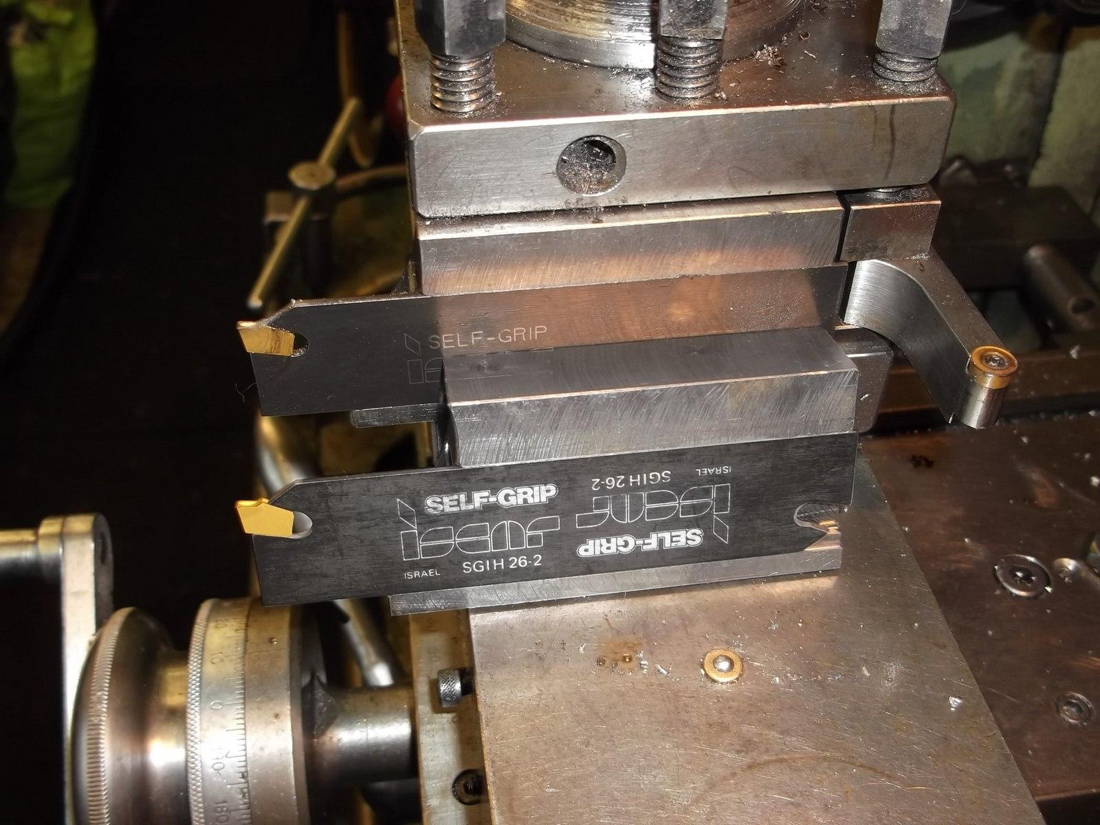

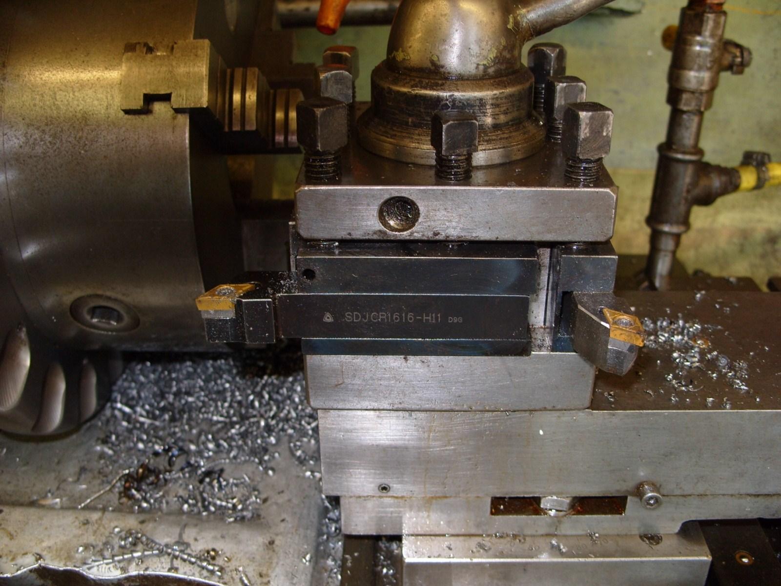

Hope I'm not treading on too many toes regarding QCTPs, while I can see advantages for them in some instances of personal preference, the 4 way toolpost has served me well for many cherished years...
The 4 way toolpost on my Colchester Master 7-1/2" has been refurbished a couple of times by myself, mainly to accommodate my liking for preset height tooling...
Right from the start I dismissed the practice of shimming...
I found 16mm square toolholders to be the requisite size for this 7-1/2" CH lathe...
So made preset blocks to take 16mm tools to correct CH, even made allinone Parting toolholders, and other profile tooling at 16mm..
Then loaded the 4 way with whatever tool I required to complete the job in hand, and had the convenience of being able to select the right tool just by rotating the 4 way to its positive stopping system...
Coupled this to my system of carriage stop setup, I could efficiently do repeat jobs if needed...
Below are a few pics of bought and shopmade tooling...
The round(RCMT) tools were made handed with the option of mounting the tip either top or bottom to facilitate LH or RH...
As a sort of PS. if you haven't the facilities to make the preset tool toolholders then this reply is sort of pointless and I apologize in advance...
Chris

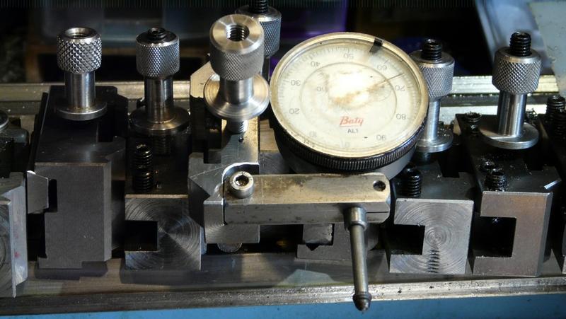

One thing that might be of consequense (or not) is how you like to use DRO. If DRO has easy way to input tool (and finds the offset) then mechanical quality (repeatability) is fairly high on the list. And so is the price.
Then again if workflow is such that there is no need to swap tools in between cuts, then it's possible to zero (or dial in diameter for) each tool when needed and good repeatability is not such a problem.
I bought two QC-toolpost and I mounted the first one that way, that second one can be adjusted same relative centre heigt, making it possble to use QC-tools on both lathe without disturbing the tool height adjustment. In my opinion ease of tool chance is convenice only if you need to set the height only once.
I have used cheap Fourway TP and they don't work for me....I use a whole lot boring bars, rest of tools are always on my way, if I need porkypine I rather had it on tail end than cross slide.
O-O

It was the right size for the centre height but the tools would have to hung out quite a way to clear the top slide.
My Chinese lathe had really bad topslide, I removed it and replaced with a 20 or 25 mm square spacer , where I drilled and tapped two M16 or whatever that central post bolt is holes. The holes were spaced only about 20-30 mm away from each others, but designed that way that:
* Tool tip will be placed stable side of the lathe guideways, no cantilever load on cross slide front shear
* AND with a conservative tool shank overhang big piece would clear the topslide and make it possible to turn just a little part that does not go over the cross slide, but you can get close to it. My lathe has central height of 125 mm or so, this is limitting factor many times.
* Possible to use limited travel of the cross slide to do some right/left hand boring/threading + do all external turning on one setup
* possible to turn the TP "ways" outside (towards you) and do a little oversize turning near the chuck. Handy if you have one big lefthand facing tool - it's used here as plain turning tool and right hand facing.
It's funny how much even 10 mm move on tool post central bolt has influence on how close you can get. This was very important, because I traded rigidy over top slide, but I can imagine that it does not hurt to do a little dry run with a few favorite tools on the TP before mounting it permanently.

So the tool post is installed on the Harrison.  I took the advice and made a tangential toolholder,
.  Seems to work well, although I have only ground the tool free-hand.  Next job is to make an adaptor for the tool grinder to fit 1/4" hss.
The design sits on the cross slide for max stiffness.  The single screw holding the tool in place looks a bit weak, but the bit of hss is a tight fit in the slot and I don't think it will move.  It is all about as simple as it can get.
Row o toolholders:

A toolholder for a dial guage makes it quick to set up , my one flipes thruogh 90 degrees .
Offline howsitwork?
  • Posts: 360
Re: lathe tool post advice
« Reply #42 on: December 03, 2015, 04:39:11 PM »
 :thumbup: Cracking idea Jeff
