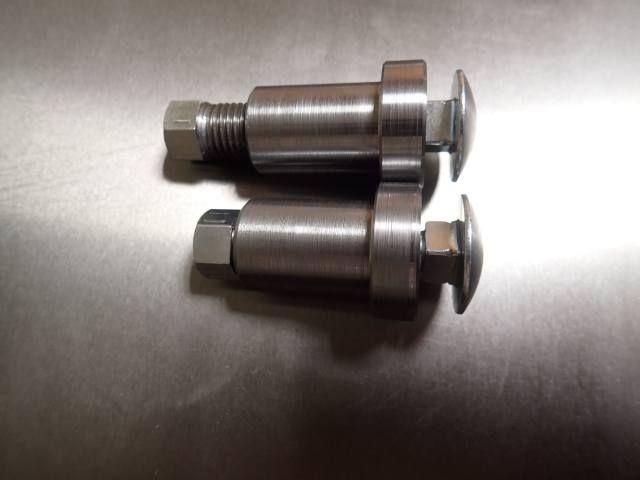

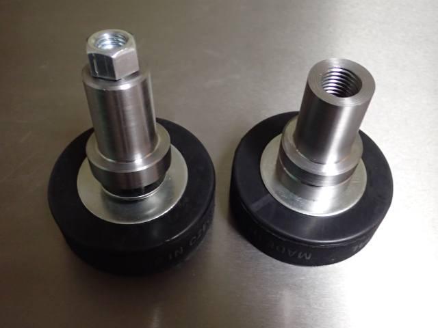

Nothing special. Just a puck lying on floor, a big washer as bearing plate (there is going be slight camfer on ID hole) and a carriage bolt to provide concave surface to allow a little tilt.
The screw is differential screw, but I don't know if it works good enough. M12x1,75 vs. M16x2,0 was the combination that came with tyhe tools I have and standard bolts. I would have prefered much M12*1,5 but that is not a standard. M10 but it looks thin and Could not have used standard long nut.
This screw gives a very sensitive adjustment range, downside is that there is very little of height adjustment overall. I need to get the machine fairly close to level to start with. This Grinding machine has three mounts. I'm planning to put single non differential screw on rear, get it fairly close, and use these more sensitive ones on front feets.

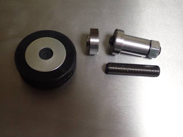

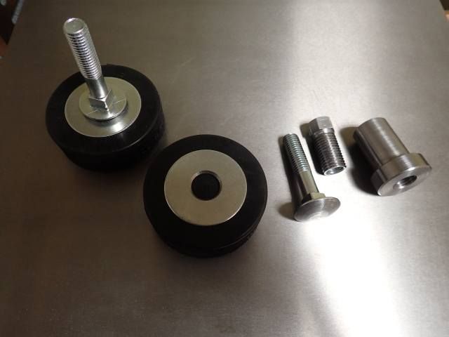

OK, two more pics, they should be pretty selfexplanaory..I spent more time on migrating from W7 to Windows #10.
Ruber was pretty hard and nice to turn,  but messy. Not quite like cast iron, but clearly messier than I'm used to. Whole lot nicer to tun that softer rubber.
I didn't find a proper M16 long stop screw I need to buy one and a lock nut on it. Those ase missing on the picture. Slight change of plan.

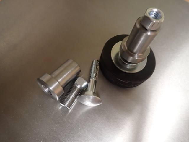

No problem Swafn'!
I have two dubious experiments here...contary my habits, but least I can test two permutations on one go!
1) I'm trusting carriage bolt dome and washer to conteract floor tilt. Downside is that if the grinder jumps, it might land on atypical attitude on floor....I might need to build a retainer. I would bolt shaper on floor or use a big board under and make holes to pucks with a hole saw or something.
2) Differential nut here trades stroke to ease of adjustment. It should allow 16 mm of nut movement (8 rounds), that translates to 2 mm of carriage bolt movement...I felt that 2 mm of lift per revolution is fairly difficult for leveling (least if you have more accurate that carpenter's level). I might have gone other extreme with 0,25 mm/r resolution, but that was possible with standard taps/dies I had.
Threads are far from perfect, but this does not depend accuracy on dial reading, therefore I felt that thread accuracy (lead accuracy and clearance) is no issue here. This is not a way to make a lead screw or micrometer.

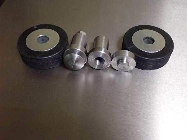

And one ugly rough adjustment one. I Should have made it more simple, but I could not help myself.
