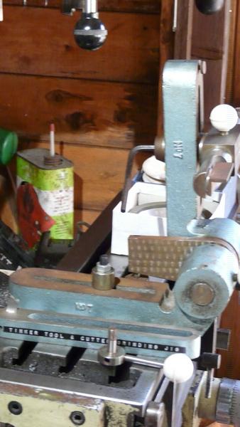

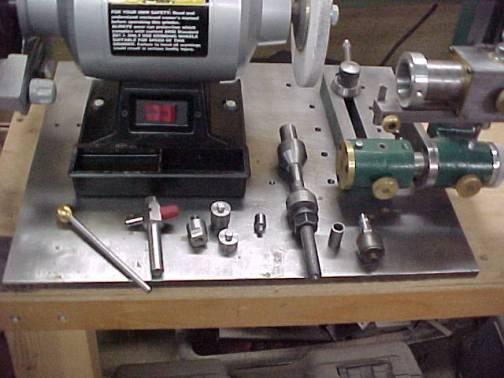

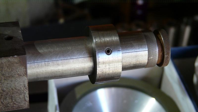

I scored a Tinker tool and cutter grinder yesterday for a score (£20) , a bit rusty and morse taper 2 that I will copy
to a 3 , does anyone hear have the instructions for setting and using one of these ?

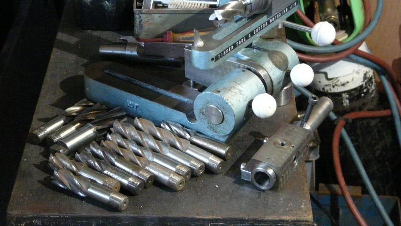

The top photo shows the lathe tool jig just a bit of angle with a bolt , the club has a box of scrap milling cutters weighing 3 or 4 kilos just enugh to pratice on , it's the setting jig I want details of .

« Reply #7 on: August 21, 2015, 11:30:04 AM »
You have any pictures of it ?

Norman do you meen the rod with a ball end ? Bobs site shows something different I think.

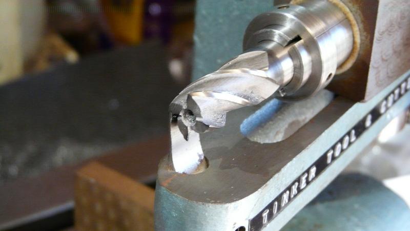

Jeff, no If you look at the Guy Lautard site for the Tinker, you will see the an end mill pointing down on the wheel to get the primary grind. Presumably(?) it is rotated 180 degrees and then turned again to do the first secondary clearance and obviously the last to complete the operation.
I may be wrong but, I do something similar with a the Clarkson with a BSO dividing head and holding a end mill in a collet. I have a simple block of metal under lip of the first lip- and then tilt to do both lands and then rotate the 180 degrees for a  2lip milling cutter( or 4 etc)
Actually I was checking with my Kennet and  it follows a similar technique- although there are no degrees marked simply graduation lines
Does this help?

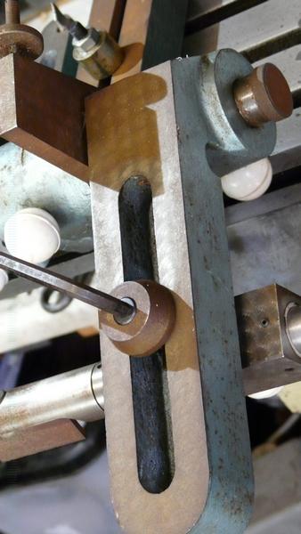

« Reply #11 on: August 21, 2015, 04:25:50 PM »
The angle for grinding the end faces I can work out , it's the angle for the flutes some form of height guage is needed , Proff Chaddock provides a table of angles to height for a six inch wheel .

« Reply #12 on: August 21, 2015, 06:00:20 PM »
The formula  for 1 degree clearance (.0088") x clearance angle x diameter of the grinding wheel( in inches)
It's very old maths but that is probably where the books of information started.

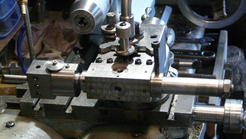

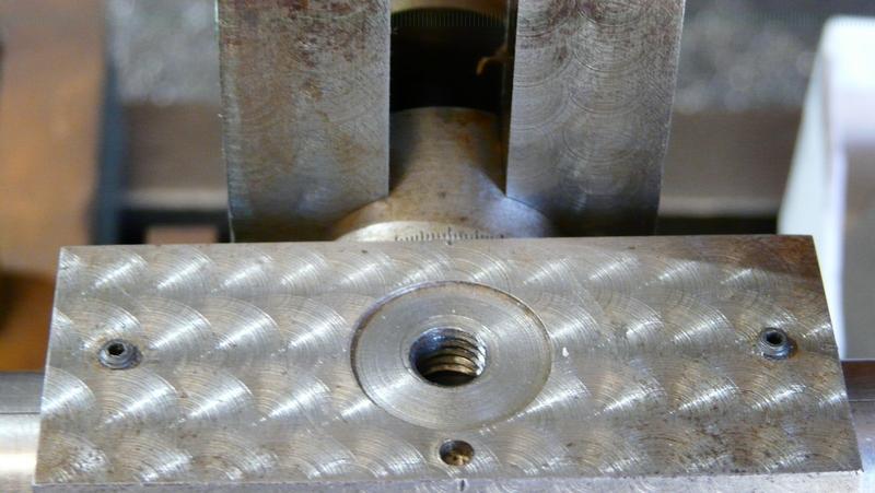

« Reply #15 on: August 23, 2015, 02:34:29 PM »

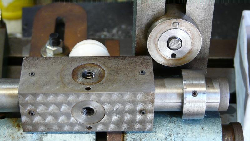

I had an old spindle that was bent in a lathe , trued the taper mounted between centres and turned down to my largest reamer size , a piece of 1 12" square bored and reamed , driled and taped cleaned up and I have a mt3 shaft and found a use for the old one a ball turning tool no less .

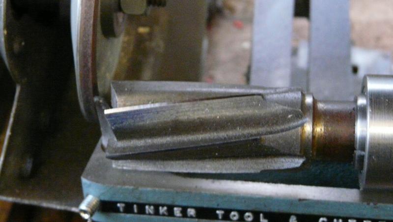

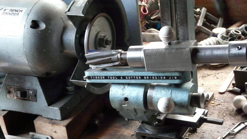

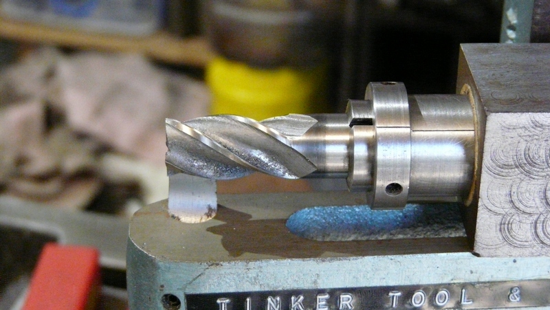

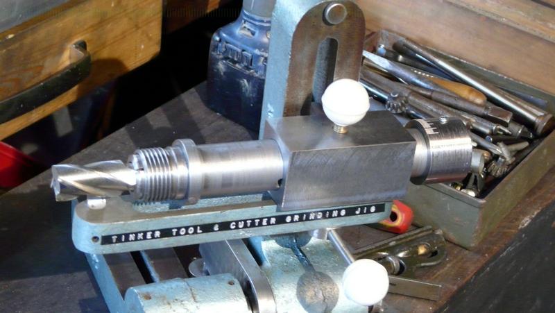

« Reply #16 on: September 13, 2015, 03:40:54 PM »
Finaly sharpened the flutes on a end mill , mounted the jig on an old cross and tool slide and raised the grinder , it needs to be raised another 20mm , then I can use a square to set the angles insted of tangently witch is a bit of a fiddle .
