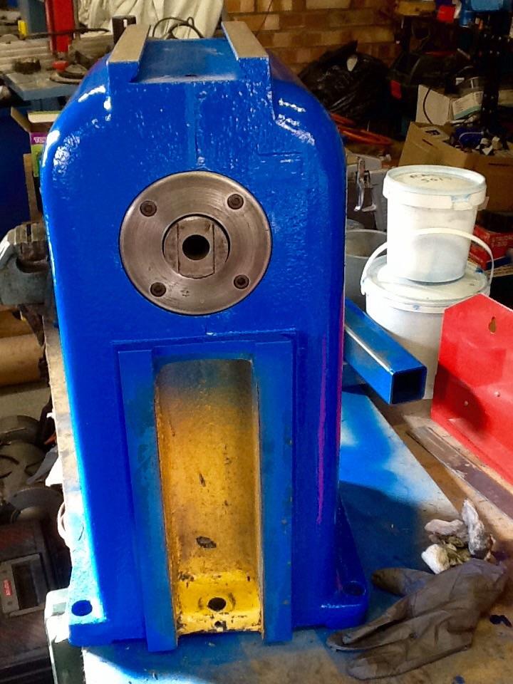

Latest pictures....
Main body stripped to bare metal, cleaned, primed and painted. Ignore the yellow....

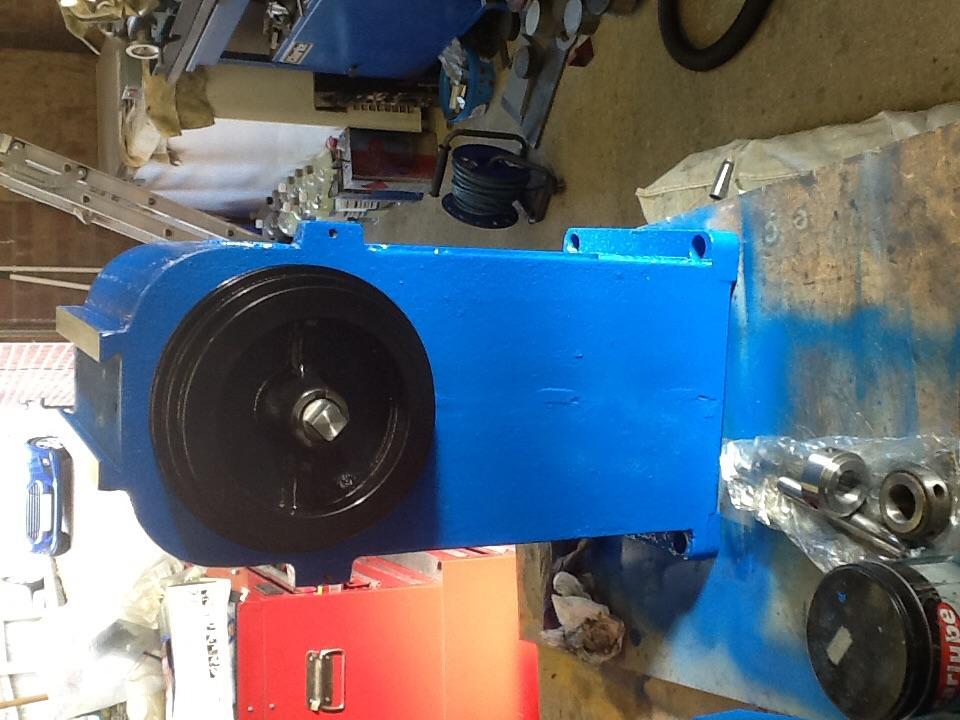

« Reply #2 on: September 29, 2015, 11:26:28 AM »
Got the spindle back in and added the freshly painted pulley...,

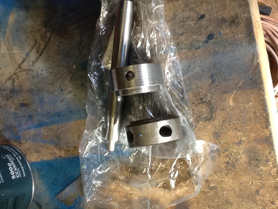

« Reply #3 on: September 29, 2015, 11:27:43 AM »
Here's the new spindle lock but I had long side the butchered original...new Tommy bar too..

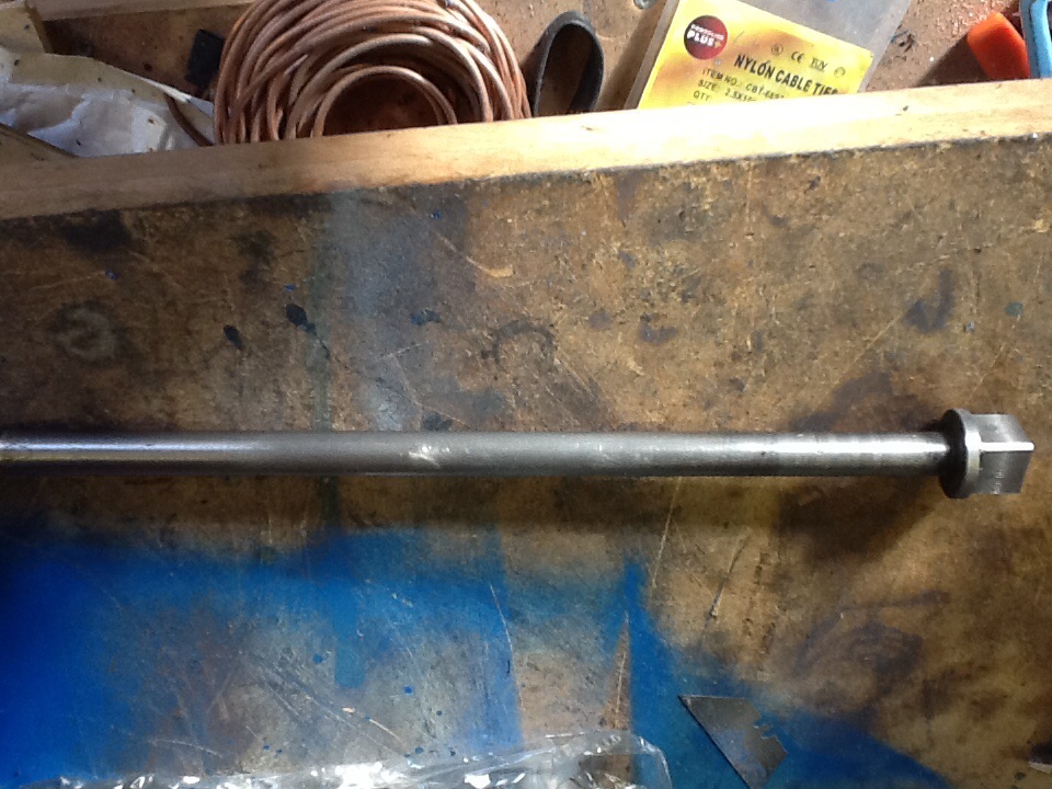

And the draw bar that it came with....well needed replacing with this....
