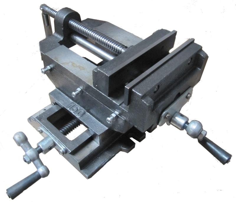

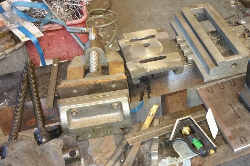

Along with the stuff I got with my lathe was a 2 way milling vice similar to the one in the first pic but not so well made. It was marked up as Jacob and has "made in taiwan" on the bottom so they are hoping people will mistake it for a Jacobs product and expect quality no doubt.
Anyway when I was handed it I wondered what the heck I was gonna do with it and it sat on the bench while I did others things.

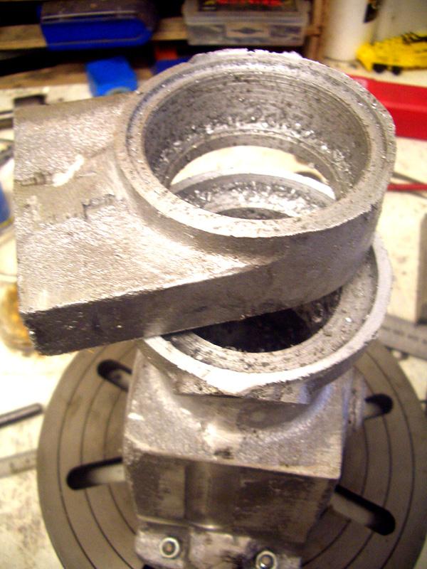

So I want to turn it into useful vertical slide for the lathe.
Started off by stripping it down and getting rid of the bits for the top slide (actually if I had thought it through a bit longer I would have left a bit more on it but never mind can't unturn it).

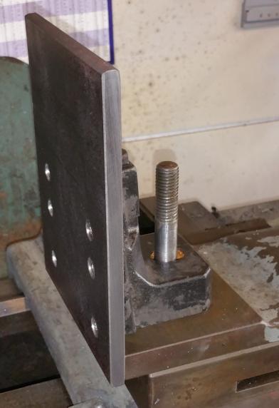

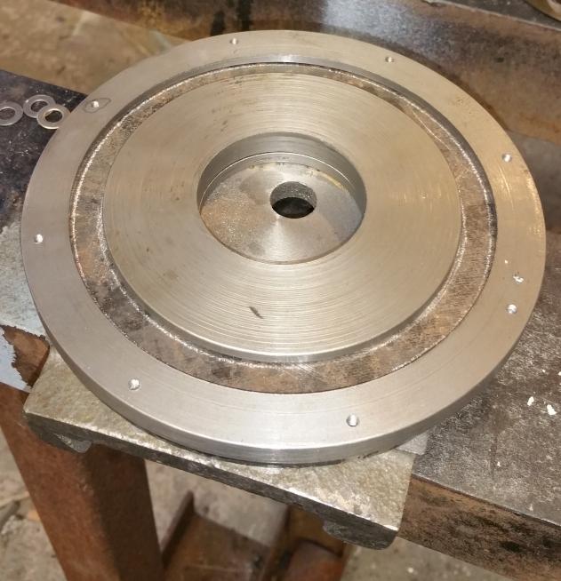

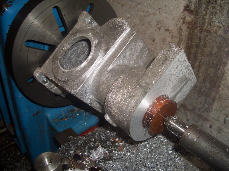

I was going to make it to bolt onto a right angle block I was also given but then had a better idea for a permanent solution, we scrap loads of bearing housings at work and I sometimes rescue them from the scrap bin with the intention of using them for ?something?
So I grabbed the biggest one I had stored in my area at work and saw the two ends off to leave enough meat to tap into and put the two together on the four jaw to turn it square. Turned out great according the the right angle block :D
The plan is to attach this to a plate with various holes to match the mounting holes for the slide which you can see in pic2 with the bearing housing part.
I did intend to mount the vice from the 2 way slide but then thought about the top slide from my old Drummond roundbed which I think will be a much more useful option.

Anyway Collected some bits to make the work turn through 360 degrees and I managed to get the plate attached to the right angle before being called away.

I had one of these XY vices fitted to a bench drill base and for that application it worked ok
It was a big old substantial drill press, so I thought I would try a small milling cutter to see if it would work
Short answer no :(
There is too much play in the travel nuts / threads,
Where the XY handles are anchored there are no bearings to take thrust so the handles dont turn readily under pressure
Jib strips adjustments doesnt  work very well, lack of parallesism?
In the end I gave the drill and vice away to some friends who would be happy with holding a part to drill a hole without  losing fingers  !!!!!

I Have looked at these before now thinking that maybe if you can get them clamped down securely they may do for very light milling but this one would have been terrible, I guess they are ok for just lining up holes but how many times do you have to drill so many holes in 100mm square (retorical question please dont bombard me with examples  :lol:)

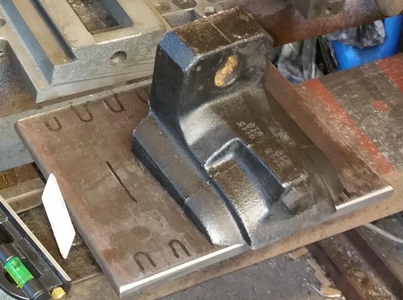

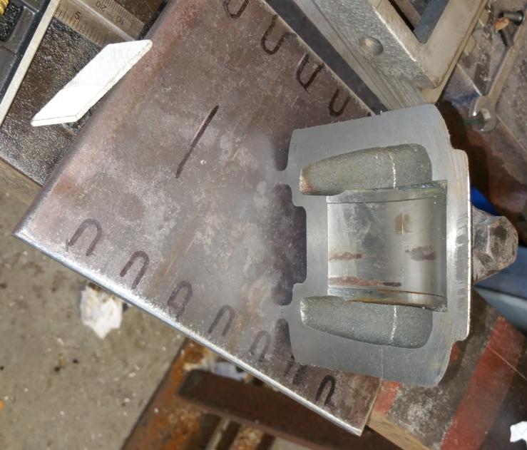

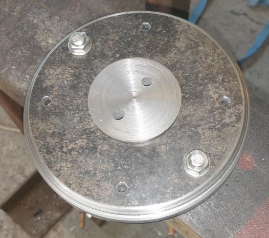

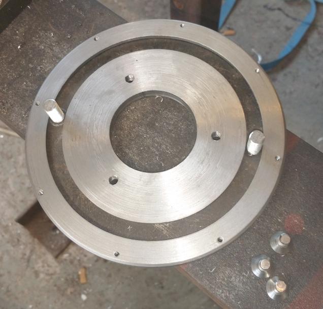

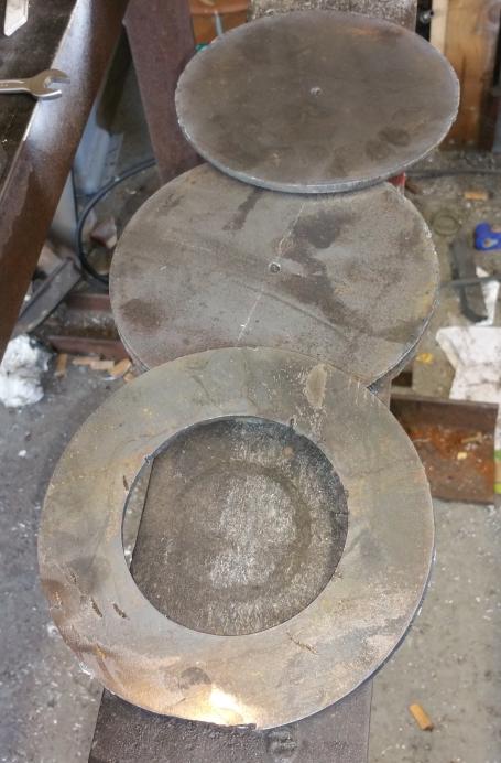

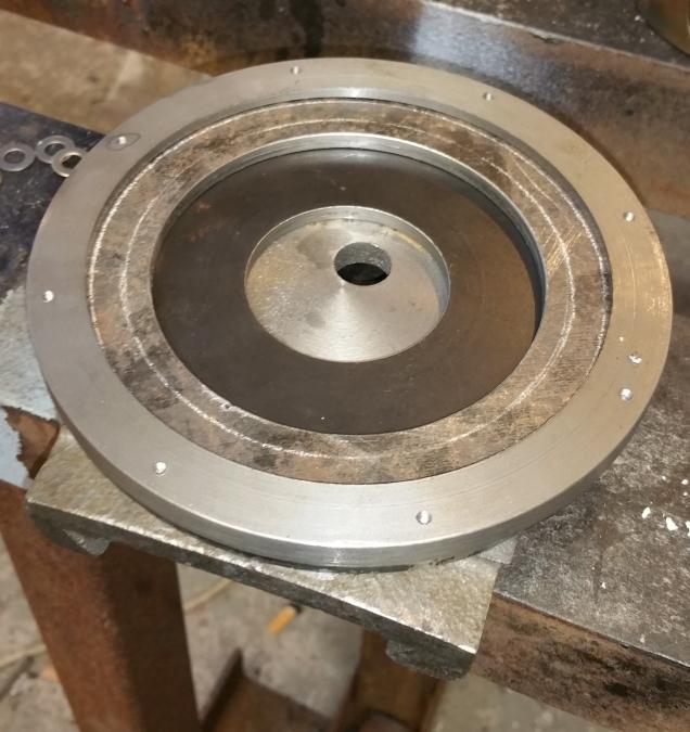

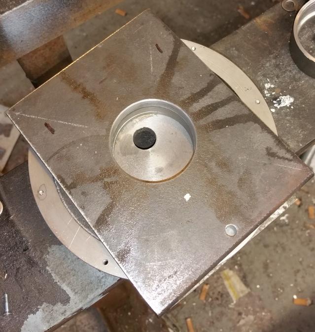

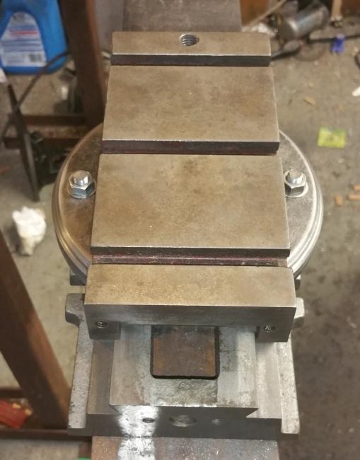

A few pics of the progress on the turntable? everything has come on pretty well but not happy with the top plate in pic 3 I am going to cut another circle while at work tomorrow the square plate was really a replacement due to a slight change of plans.
Offline shipto
  • Posts: 867
  • Redditch, UK
Re: Lathe milling attachment.
« Reply #7 on: September 16, 2015, 01:02:47 PM »

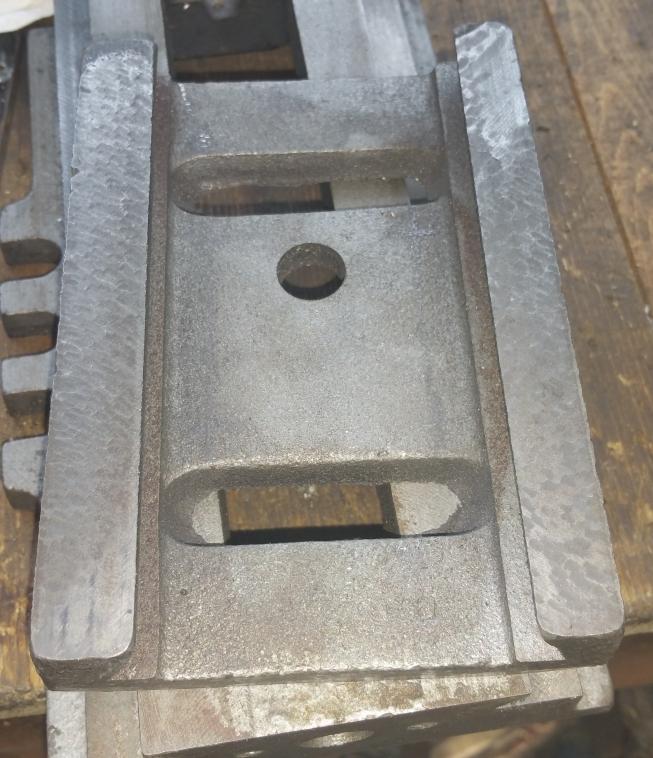

So new top plate cut and prepared and put the studs in the rotation ring just a little bit of drilling and tapping to do then its going to be ready to put it all together. After I spend ages making the slide better which I am unable to take a picture of that shows just how bad it is, its almost as though they said to themselves make it look scraped but only worry about getting each corner near right.

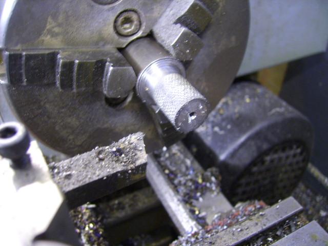

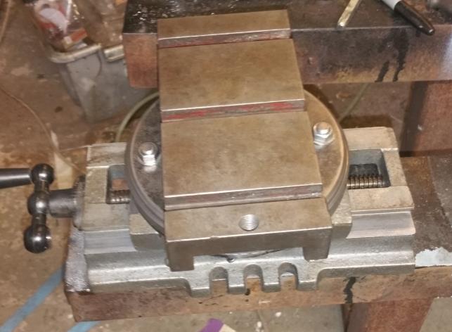

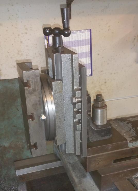

good progress today the rotary bit is pretty good although I would like to mark it for degrees but dont have any idea how to go about it.
I have done a bit of a half-****** job on the slide but if it works ok will spend more time on that.
A better handle is definatley called for the plastic offering is only just better thn useless.

I Have looked at these before now thinking that maybe if you can get them clamped down securely they may do for very light milling but this one would have been terrible, I guess they are ok for just lining up holes but how many times do you have to drill so many holes in 100mm /quote]
Couldn't even do that on mine, way too much play in threads, Jaws lift the job, tight and sloppy spots along the V's unusable. Best thing ever did was give it away 14 years ago.
I wouldn't make a habit milling on a lathe especially if its not robust and tight, it wont last 5 mins.

Hi,
If you look here, http://www.blocklayer.com/Degree-Wheel.aspx
You should be able to scale and print off a suitable sized degree disc,
You could stick this to your steel disc and mark through the paper  onto the steel
Square up the top table to mark the 0 degree point
HTH

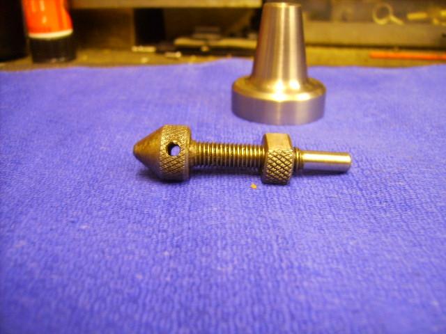

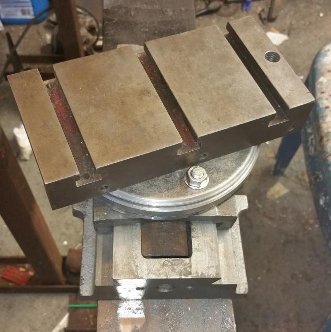

Mostly all done and I think its going to be useable with a little pre-thinking the jobs I wish do to, still not too happy with the leadscrew nut supplied but it locks up pretty tight so if I just use the up-down movement to set it then lock it up and use the lathe crosslide to actually mill it should work pretty good. I will still make a better handle for it than the plastic one but need to make square hole for it and couldn't face hours of filing today so thats a future job.
Easy 10 mins taking it slow, drill through hole to width of flats and hack out. When some where near feel for it going on, no slop or play the nut may not take out.
