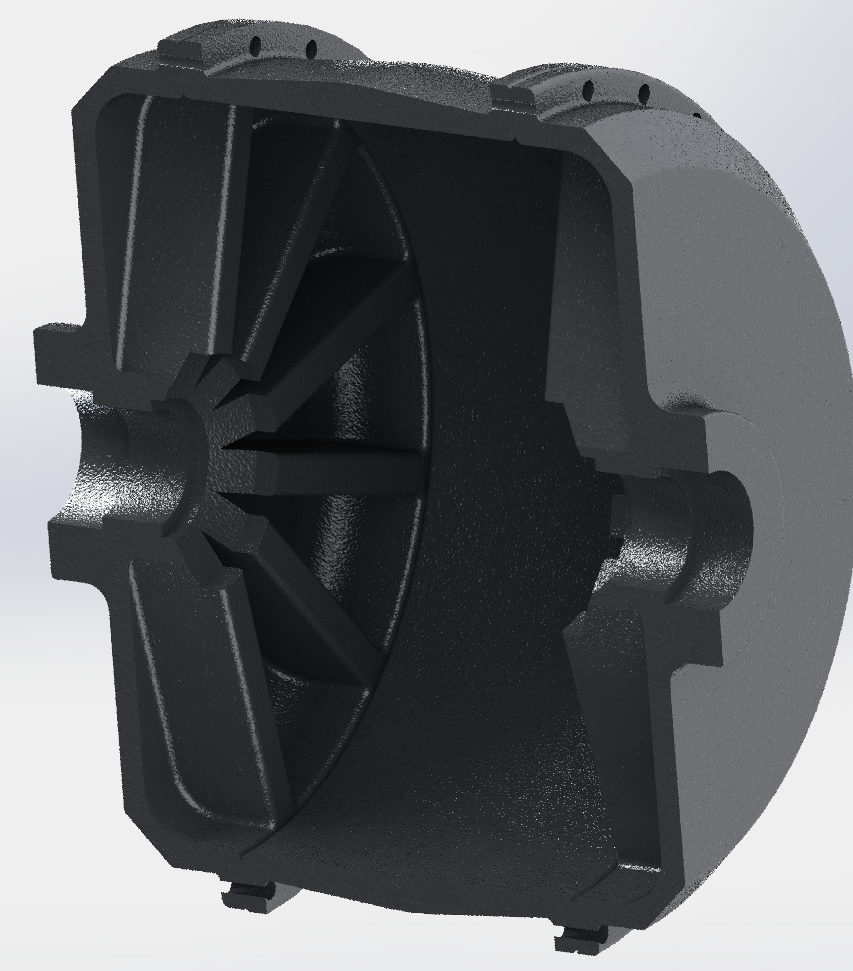

Offline NeoTech
  • Posts: 826
    • Roughedge Hobbyworks
Re: Dynamometer - a friend questioned and i have no idea.
« Reply #7 on: September 13, 2015, 02:41:35 AM »
The stator housing would need to look something like this. with squar vanes, and a return "area" for the medium, the impeller would also be of the square wanes typ but with no center opening so it pushes the water outwards and it will hit the vanes, return to the center and go out again.. in flow on both sides and an exit at the bottom of the stator housing.
