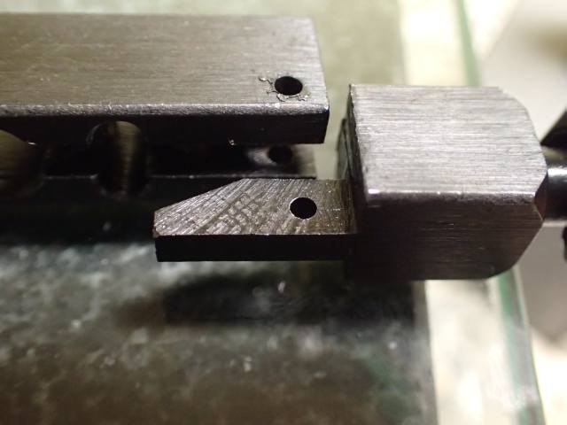

Hello all,
I have had one no brand very basic dial indicator holder for 18 years and it's pretty much ok. Not the smoothes and most rigid, but perfectly adequate. Until now.
Fine adjustment has started to act up, it's a little more rough than before and cleaning did not really improve it.
My friend helped mit ot measure my mill and he gloated with two very smooth mechanical centre lock/adjustment hi-tech-toy. I had used them before at the work, but thought they were really for rich kids or professionals.
Got flu and desided to cure it with new tools. I bough one new Vogel- brand (says Germany and all in it's burlap) and first one had a skewed base. Ok, they replaced it. I was using the new one and I was surprided to find fine tuning rough and harder than the old one!
And I'm using the standard 0,01 mm resolution clock, not the 0,001 mm one!
I was pretty disaponted, I disassembled the fine tuning and it had play everywhere and the build was susch that the play acted up not only against the spring, but also sideways and allows tiltting....making a whopping 0,05 mm uncertainty, depending which way measurement forces act on it. Moving surfaces are really rough and play everywhere.
http://shop.vogel-germany.de/Measuring-Stands--Roundnesses--Marking-and-Height-Gauges/Measuring-Stands/Accessories-217/Magnetic-Measuring-Stands/Magnetic-Measuring-Stand--400-mm.html?XTCsid=d0875cd3020bb002177ef2b303bb4a5d
Product No.: 255001
Could be just me having a bad luck, but twice on same product.
So, 60 EUR does not buy more that chinese poor quality, no matter what it says. Is there really anything under 100€ that would do, or am I better of buying traditional one, brand name?

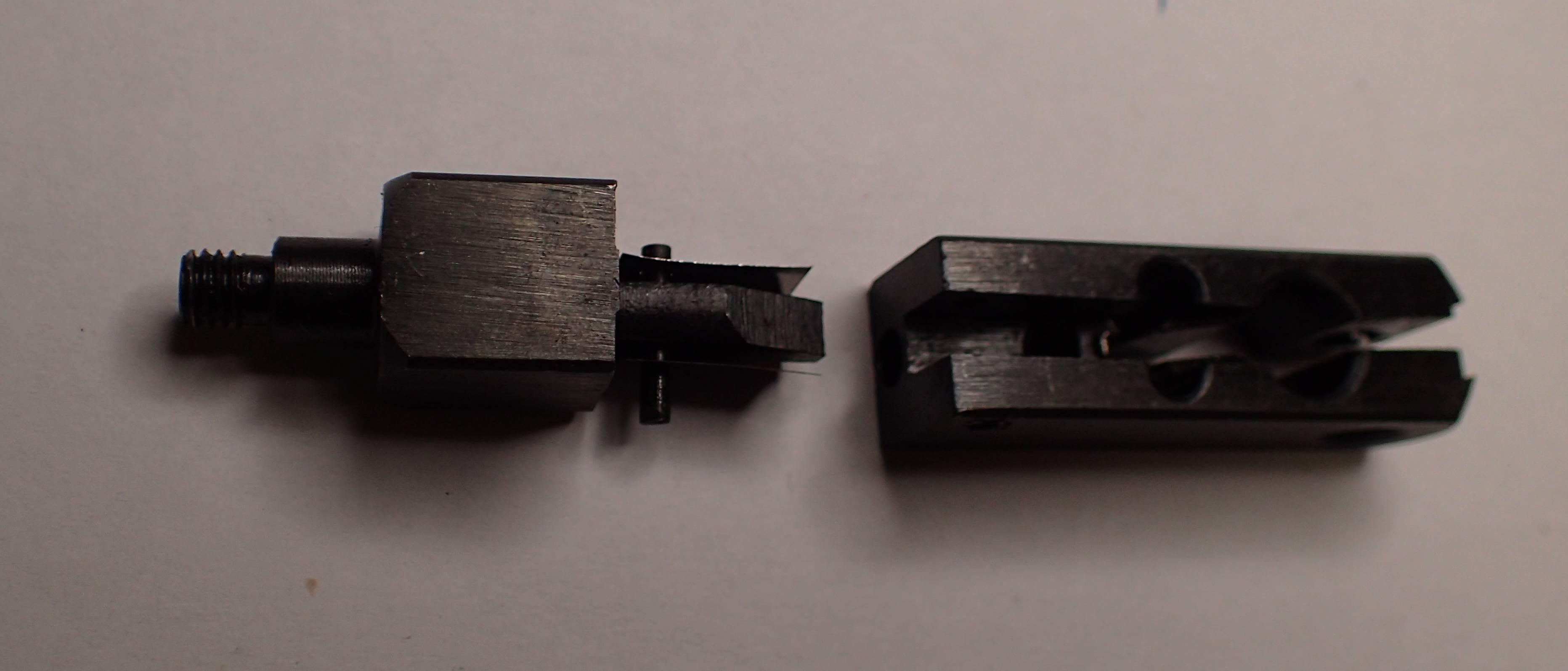

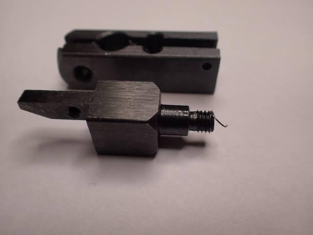

Tried to fix the play on fine adjustment of the stand. I can't make it smooth with the parts I have. Placing the 0,05 mm shim on both sides of rough/loose member removed some of the play, but the shaft is loose and allows tiltting, because it is perpenticular to the spring and exactly on the middle to make it inherently unstable. This tilting introduces close to 0,05 mm of indicated play on measurement.
My first instict was to clean/epoxy the joint, but the locking system is not smooth eneough to snug the clock on right reading....This needs fine tuning.
Suggestions of the mechanism to copy? Sandwitch between magnet base and arm?

Making a one hand indicator stand should not be that hard ?? Its just two rods with a 45 degeree in the ends and block that forces them outwards when its screwed tight. Harden the 45 deg. surfces and use a volfram ball or similar for wedge.

I'm going to try build simple fine adjustment on indicator holder. Actually I tried last one last night and I'm not happy with the original construction.
