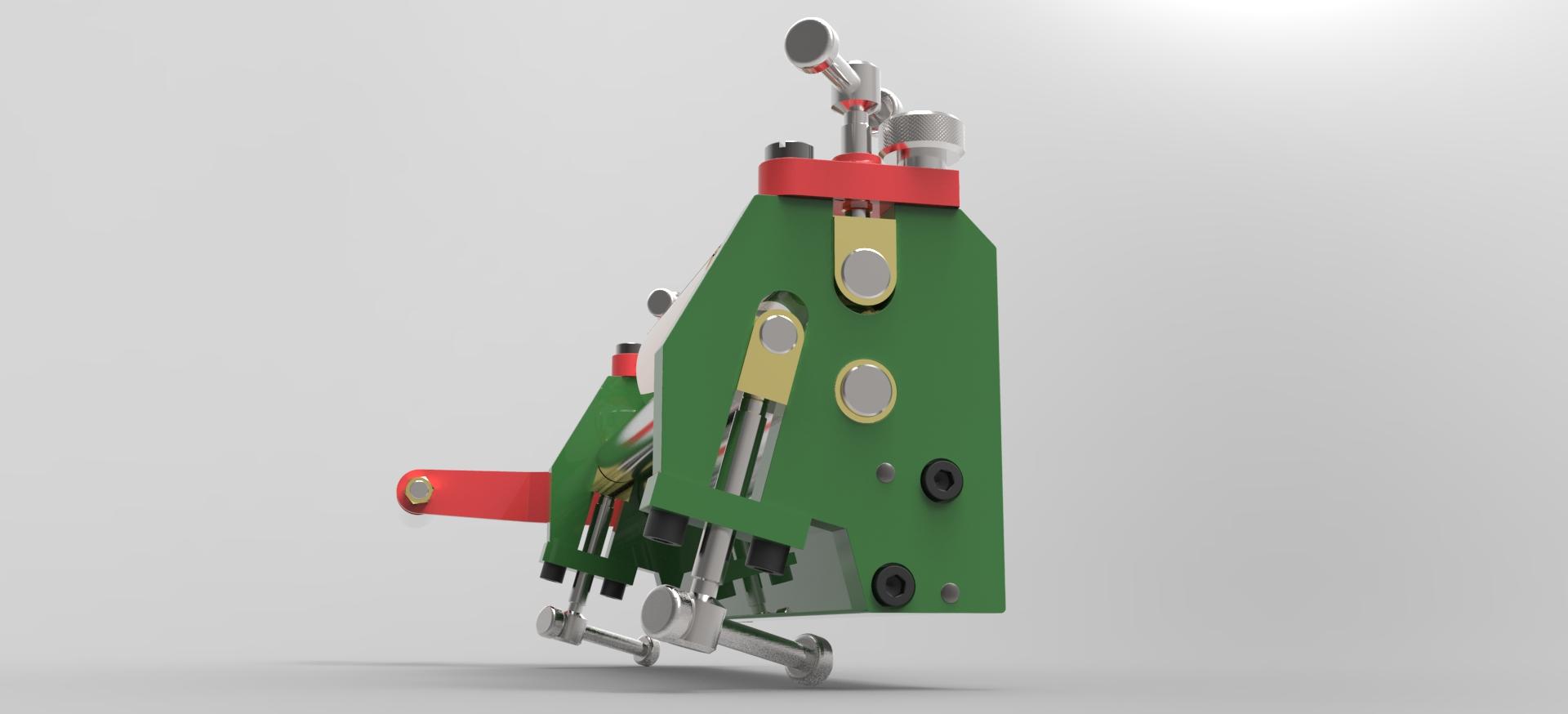

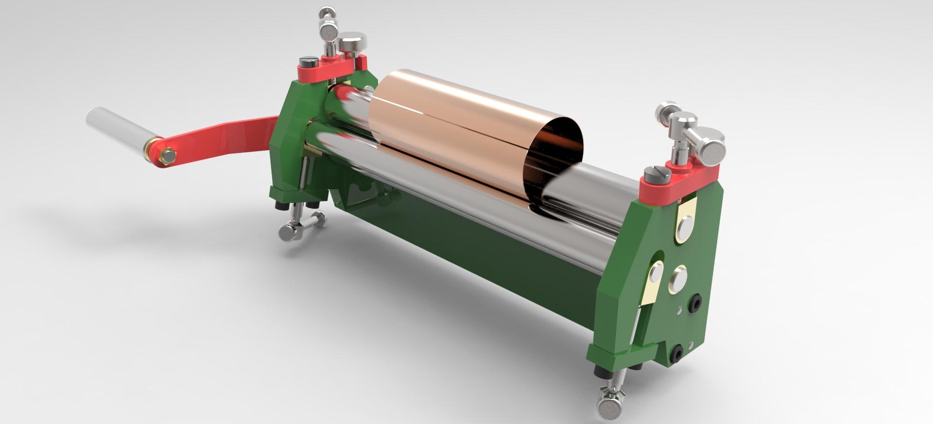

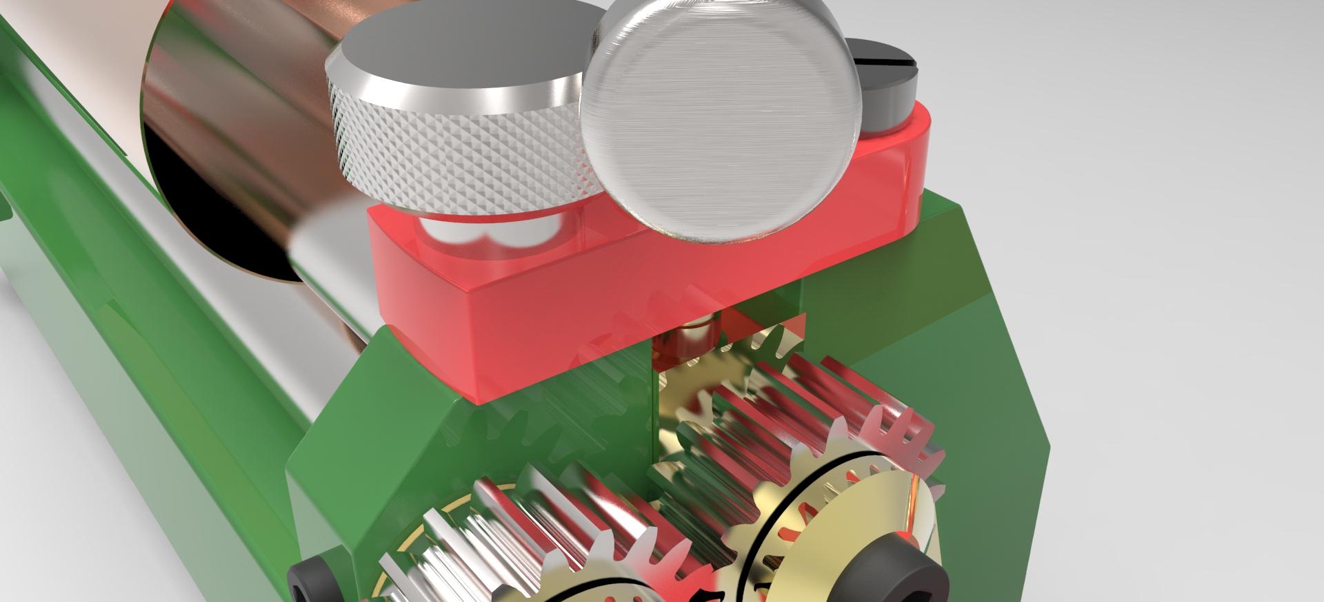

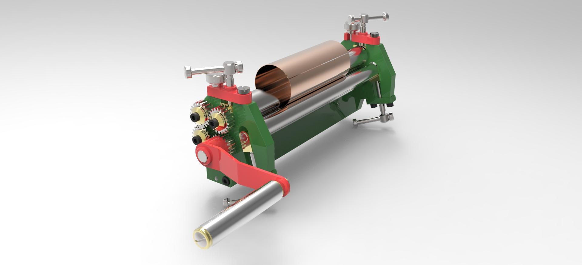

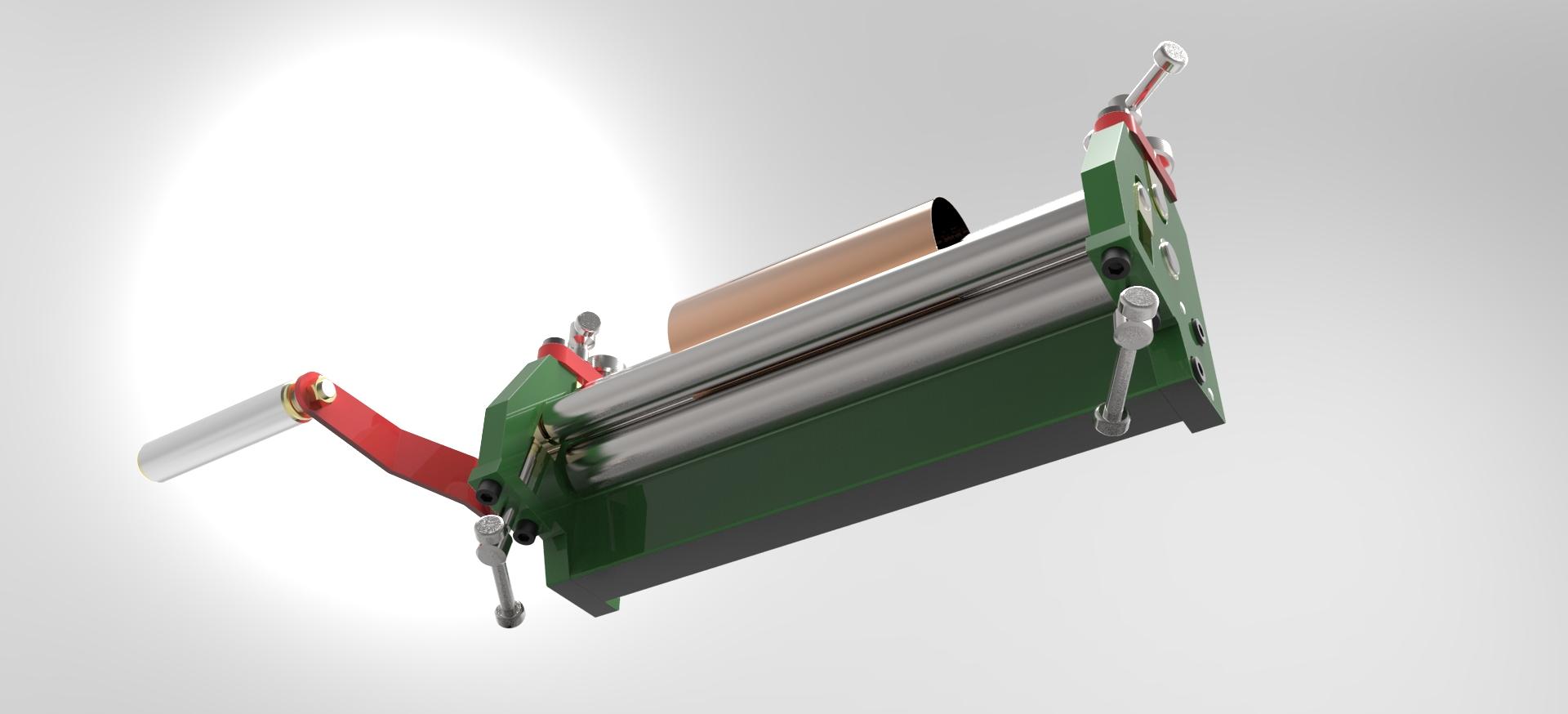

Just a quick CAD model from the plans supplied by Steve, thank you very much Steve.
Drawn with Inventor 2012 Pro.
Rendered with Inventor and Keyshot 5.
Also added a 3D PDF so people can have a look around it.
Hope someone likes or finds this useful.
Cheers.

wow I wish mine was going to look that good!  Thanks ausdier.

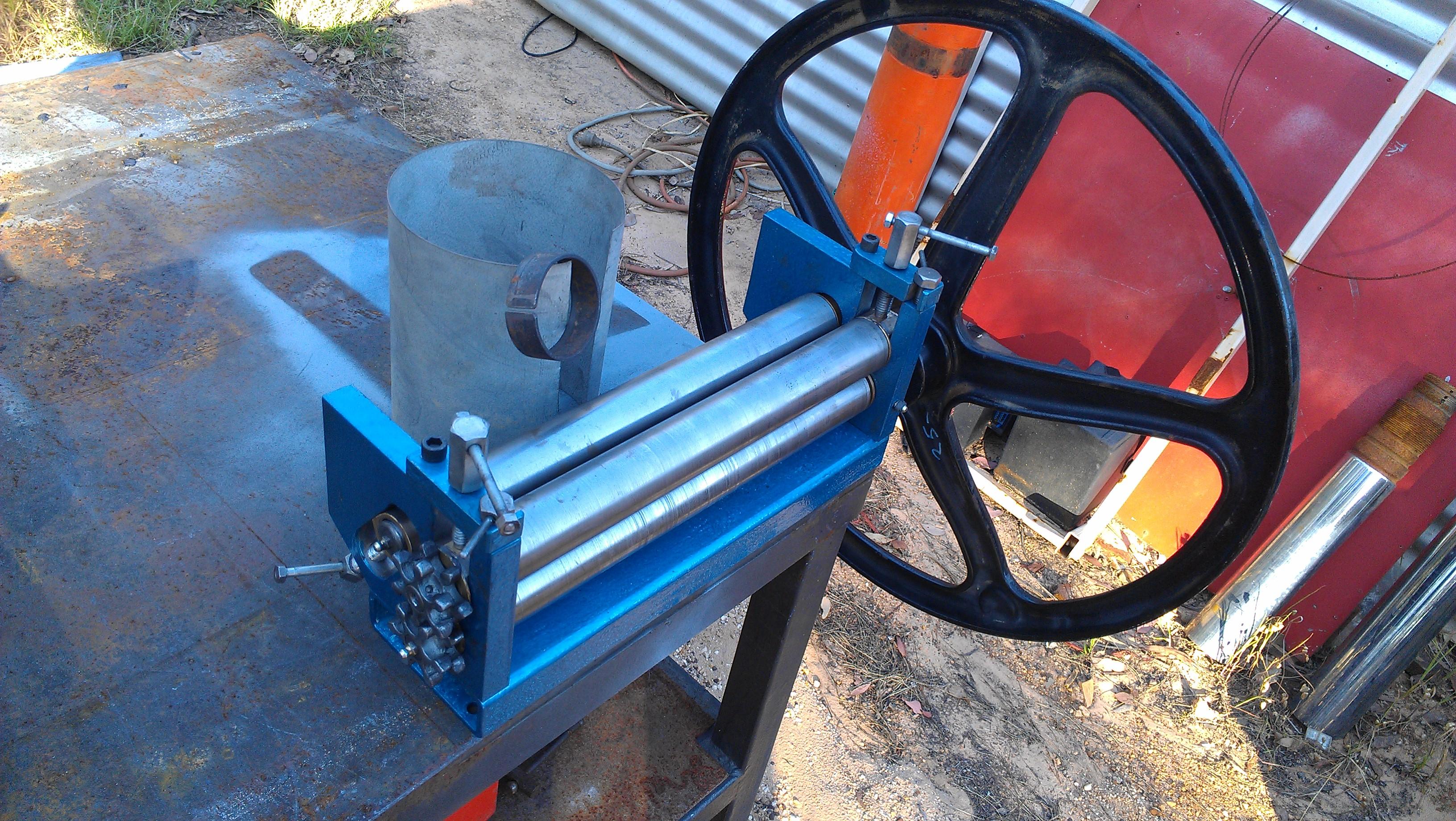

While you were posting your progress, I stole some of your design ideas and made one as well. I found your bushing design of the free-wheeling roler prevents rolling tapers. So I made mine without the outside flange on the bushes and turned a taper on the frame sides of the inner flanges, to allow the roller to be scewed as far as the diameter allows.
I also used a large (620mm diameter) wheel off some kind of large valve instead of a crank. I find the spokes on it allow better application of my muscles in all positions - whereas a crank will only work well in either straight pushing or straight pulling position. The inbetween positions where you have to push down or lift up don't work well with wide or thick material.
Works a treat!
Cheers,
Joe
