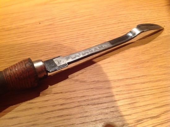

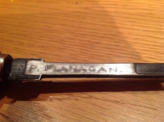

Evening guys,
How do you guys engrave steel tools? I've a number of hand tools, many old tools purchased second hand and a lot of lovely names engraved on them or more importantly, things like cutters and such have dimension markings on them. How do you guys clearly mark your steel tools with a strong etch. I obviously know and have stamped things in the past but that just isn't always possible.
I've attached a picture as an example.
Chris

Re: Engraving/marking tools
« Reply #2 on: August 24, 2015, 01:47:40 AM »
Chris,
I think that, as John mentioned, those were probably marked with a vibrating engraver. The extra deep 'dot' at the start/end of some of the strokes are symptomatic of these tools, where there has been a pause after 'landing' at the start of a stroke or a delay before lifting at the end of a stroke..
I have one of the Burgess hand-held models, they're still available (£40-£50 new, £10-£20 second hand) and you can get a wide range of points, typically carbide for engraving steel. The thing I like about the Burgess one is that you can vary the strength of the reciprocating stroke, although even on the softest setting I've never had the nerve (or to be honest the need) to try engraving glass with mine. The bigger kits also come with ball points so you can emboss leather/copper/pewter etc. and blades for cutting/carving.
You can write freehand with them but I tend to write with a Sharpie & then follow those lines with the engraver.
You mentioned engraving sizes on tools - the only thing to beware is that the reciprocating point does raise a tiny burr around the sides and if you needed it to retain a flat face you might have to stone it afterwards.

Thanks John, Dave - I've got quite a lot of stuff with similar hand written engraving so you have confirmed to me that it is a vibrating engraver. I will have a look at Burgess and see what I can find.

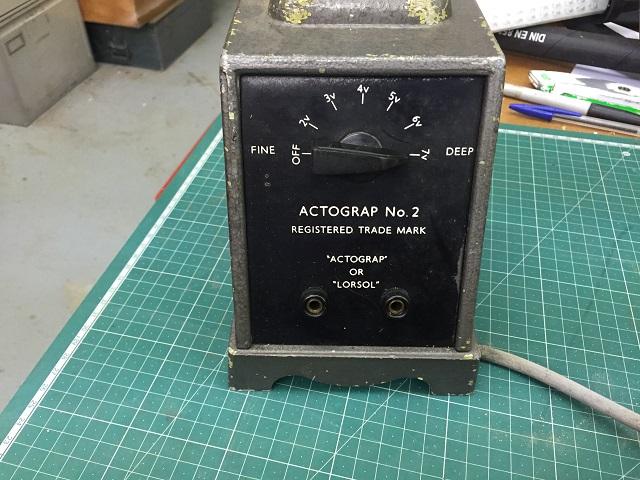

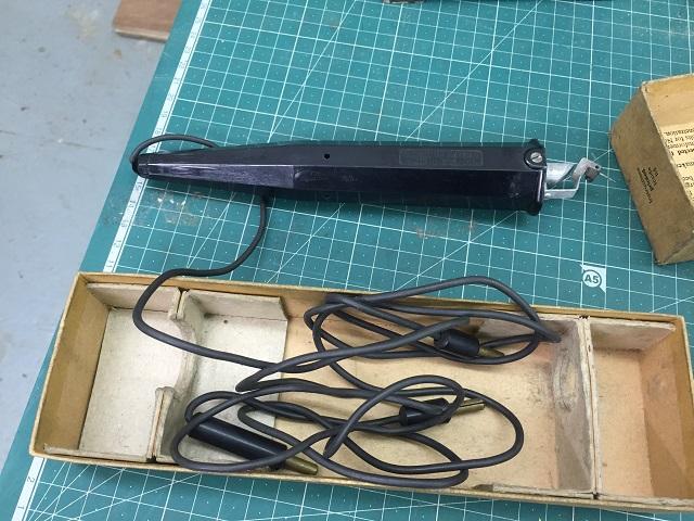

Hi Chris,
The engraving looks very much like it was done with an Actograp engraver. This uses a tungsten stylus and makes the mark by 'sparking'. The work to be engraved has to be conductive. When the stylus touches the work a circuit is made. This energises a coil in the handset which attracts the armature which holds the stylus pulling it away from the work breaking the circuit and making the spark (or arc). The stylus then returns and the circuit is made again. It's fairly easy to write neatly with one.
I much prefer mine to my Burgess engraver for marking tools. The Burgess wins on non-conductive materials.

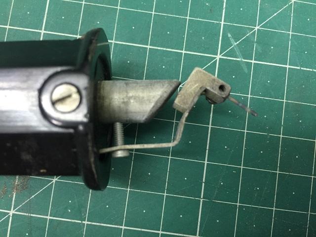

Hi Chris,
That's the one I have. I use bits of tig tungsten's as replacement tips
It's only really a buzzer - the holder is attracted to an electro-magnet, breaking the contact and arcing, it then relaxes and the cycle starts again. Mine has the original transformer with voltage tappings for varying the depth
