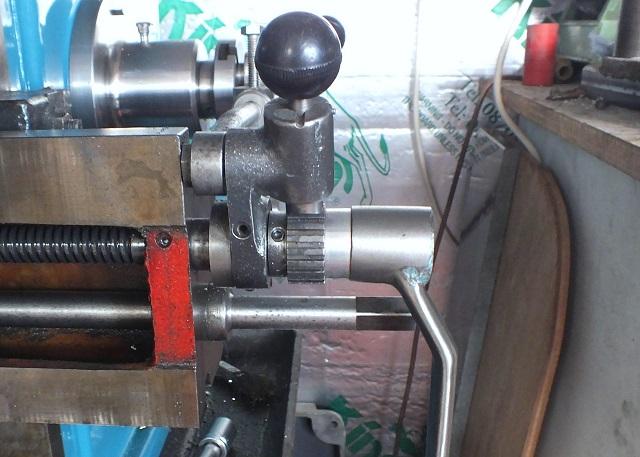

Re: Atlas Shaper Crossfeed
« Reply #9 on: September 05, 2015, 09:37:26 AM »
Sackett,the Loctite retainer grade probably would fix the ratchet to the leadscrew satisfactorily but it would depend on the clearance not being too large.
I would try Loctite as a first option then the grub screw if that doesn't work.
Here is a reference photo of the grub screw on my Alba 1A shaper ratchet......OZ
(Attachment shrunk by AWEMawson as requested)

Just a little update: further examination shows the leadscrew shaft has a conical detent drilled about 3.5mm deep and the grub screw is of the pointed type so it is effectively keyed onto the shaft.....OZ.

Tom,I would think the ratchet pawl carrier is the bit that is free to rock back and forth on the leadscrew shaft. The splined ratchet wheel itself has to be firmly affixed stationary to the leadscrew shaft or no advancement movement would be transmitted.
See my earlier photo of the Alba arrangement:
 http://madmodder.net/index.php?action=dlattach;topic=10925.0;attach=25310;image
OZ.

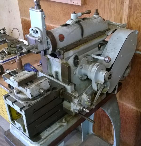

Offline rockknocker
  • Posts: 53
« Reply #22 on: September 07, 2015, 11:34:37 PM »
This is what my Atlas 7b shaper feed mechanism looks like. Is yours similar?
I'm not following exactly which part you're talking about. Mine doesn't have any exposed gears in the power feed...
Anything is possible when you forget what's impossible.

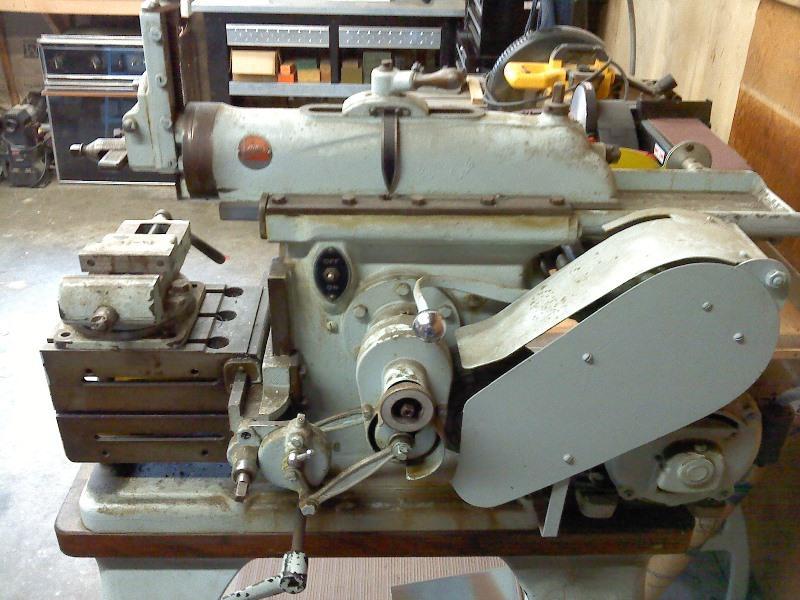

« Reply #23 on: September 08, 2015, 05:45:14 AM »
Here is the side of mine showing the linkage and the adjustment on the right, sliding the position outward increases the feed rate but if it is too close to the center it will just rock and the pawl will not engage.
And one of the crossfeed.
 After removing the linkage and center bolt it comes out easy I did not have to remove the feed wheel.
One thing I found interesting is how they machined the gear down on one side so the pawl fits. The gear itself has a bushing and no setscrews or keys it just freewheels being engaged with the crossfeed gear.
Hope this helps.

Guys, thanks so much for posting pics,, I havent figured that out yet.Rock, the offending part is in that small case just behind the graduated collar on the feedshaft.The pic that Tom shows of the pawl gear,,,,that gear drives a smaller gear on the crossfeed shaft. The smaller gear is the one causing me problems. Everything else works fine,,ratchet, ratchet gear ,left to right lever , ect
« Reply #26 on: September 09, 2015, 09:34:47 AM »
Here is a pic of the feed gear cover it's held on with the 2 philips screws but did not want to come free so I put the crank handle on and gave it a turn, turning it clockwise it began to release showing 2 pins and turned it till it was removed.
(Mind you looking at the pic I see the pins)  :doh:
Picture of pins
The gear has 2 key ways cut into it (I have tapped it over to show it better) and the center part seems to be one piece that is secured to the shaft by what looks to be a taper pin.
The one piece center part
Shows the pin that is visible when the gear is tapped over.
Hope this helps
