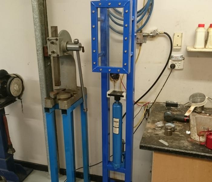

OK, so it only took me two weeks longer than I thought it would to get the project to this stage. But we're here at last..

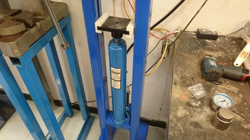

I've built a little hydraulic press for home.
Of note, I used one of these little units for the muscle: http://www.ebay.com.au/itm/331810274325?_trksid=p2057872.m2749.l2649&ssPageName=STRK%3AMEBIDX%3AIT
It has 600mm of stroke, an air motor on the back and is good for 8t.  I invite you to convert the price (which includes shipping) to your local currency. It's an absolute bargain!

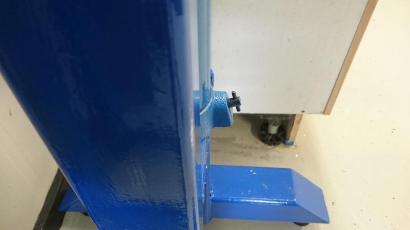

So I have all the heavy bits fabricated and working. Now I'm moving to the controls. What I want is a lever control for raise and lower.
The lever bit is easy, I have a 5/3 way lever valve.
The press bit is easy, just use said valve to supply air to the motor (might have to be via a pilot operated valve, this thing uses a bit of air).
It's the release bit that has me scratching my head.  I could use a rotary actuator. But the mounting brackets would be a bit of a pain in the arse because the little drain valve is at an angle .I'd prefer to use a ram and control horn, but the same applies. I'd really rather not strip the thing and add a separate valve...
Anyone got any suggestions?

If I've understood this correctly the screw just releases the fluid internally to let the jack come down.
How far does it need turning - if it's less than half a turn could you use a lever and air cylinder?
Or to simplify mounting how about a flexible coupling to your rotary actuator - or even just an adaptor sliding over the pins sticking out of the screw.
Yep.
Half a turn does it. The problem, as I see it is that it doesn't rotate on a convenient plane. When I add a few hundred mm of ram to the picture, bits and brackets are hanging out in inconvenient places..
Yeah, I thought about a universal joint.. Might be the go...
