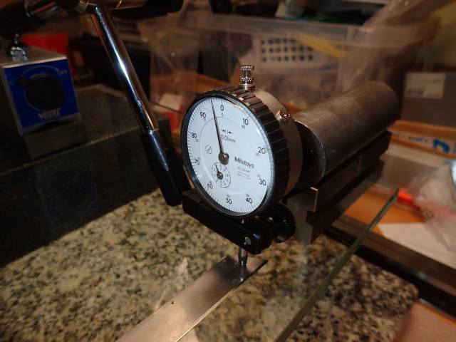

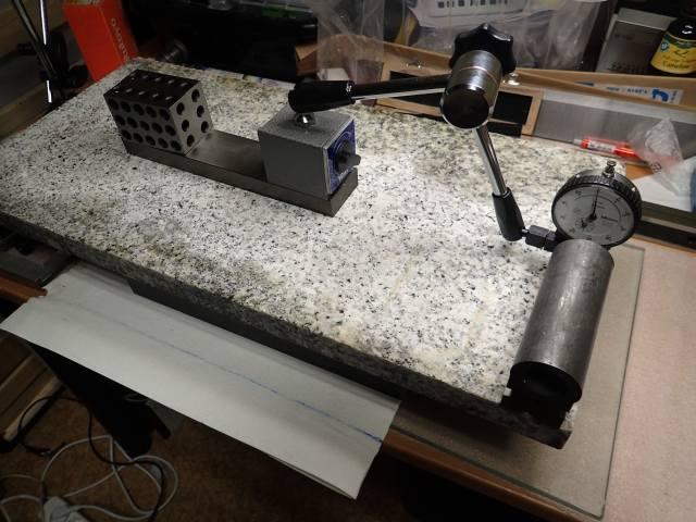

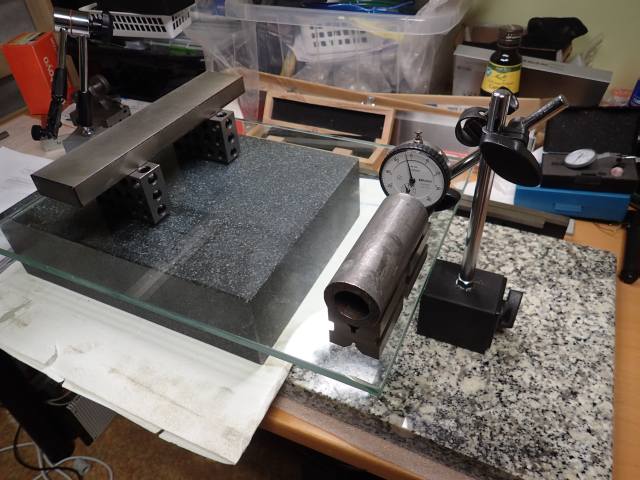

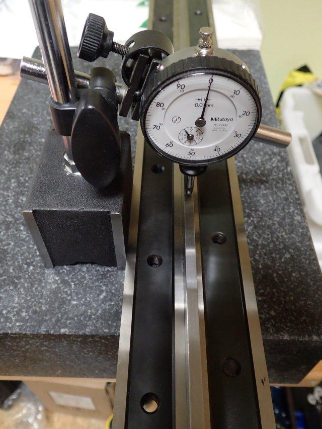

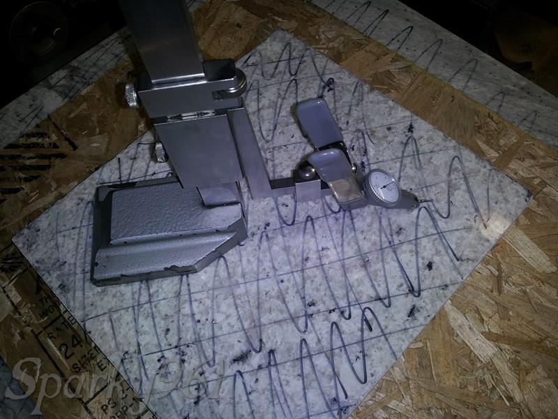

I measured flex of two common materials:
30 mm thick granite table top 290*600 mm
10 mm thick float glass. Plate size 300*400 mm.
I placed the spesimen on top of the small surface plate. Overhang was 240 mm and measurement point c/300 mm and 200 mm overhang. DTI was zeroed when there was no load and read when a dummy weight of 1320g was placed behind/front of the central measurement point.
With 10 mm glass plate the deflection was 0,05 mm and with 30 mm granite plate there was no perceptible change. This clock had a reading resolution of 0,01 mm. I do have 0,001 mm clock, but not that good base that it would make here much real life difference.
Soo it looks like if proper Bessel points are used to support the load/surface plate it should support measurement apparatus.
https://en.wikipedia.org/wiki/Airy_points
Therefore hunt of 30 mm and/or 60 mm granite interior decoration material is on the way.
Pictures:
Initial try....too much uncertainty, but it showed that glass deflected and that measurement system was not rigid enough. Also initial 100 mm overhang produced reading on the glass plate, but absolutely not reading on granite table top.
For next round I INCREASED the plate overhang to 240 mm and measurement point to 200 mm overhang and on width on the middle of the plate. Load was placed off centre fore/aft.
Next two pictures are measured on the same setting.

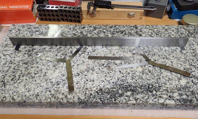

Re: Quartz Surface Plate?
« Reply #26 on: August 31, 2015, 04:07:46 PM »

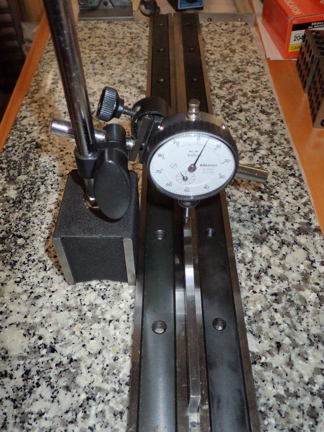

I have contacted two businesses both do headstones and table tops. But they don't have information on how true the tops actually are.
One is local and I'll visit it if I get from my work any time when they are open.
I have tried two method home:
1) Support good straight edge on top of the 0,05 mm feeler blade from both ends. Straight sample should allow a same gauge feeler gauge to slide under the straight edge. I found that same gauge feeler blade is just a tad tight....as it should be. I have 0,03 0,04 0,05 0,06 and 0,07 mm feeler blades. This shows pretty easy if there are any big problems.
On real surface plate 0,04 mm feler blade slid sweet, I could feel a little constant resistance. Same thickness feeler gauge was tight and tend to move the straight edge...pretty sure the DIN 874/2 straight edege has some 20 um variation....
On granite kitchen top piece 0,03 was tight on some spots and couple spots could place even 0,06 mm feeler gauge under the straight edge that was supported 0,05 mm feeler gauge at both ends, but it was nearly as bad as I tought.
Hair staright edge did emphasis high spots and walleys pretty clearly. Looks like colorful table top granite is not really a best choise. It might have harder and softer parts in it and it seems to show on surface quality.
2) I place straight edge on sample plate and imobilize it with a long parallels on both sides, Then I slide a magnetic TDI stand w/ clock on the side and indicate from top of the straight edge.
This was interesting...Real surface plate showed practically no clear movement on the dial...which was good, because it showed that the measurement can be used to indicate straight line and instrument was good for it.
On the othe had the checkered granite surface plate showed regular waviness and raising/dropping error trough the whole travel. Indicator base is relatively short, it would pick up easily surface undulation. Another thing is that DTI was at offset from the base amplifying the error greatly. I did not do math, but on real surface plate the indicator hardly moved at all and my sample of granite table top indicated worse than 0,05 reading, growing to 0,1 mm at the ends and also showed definite dip on the middle of the plate.
Now I have a way of field checking the embryo surface plate in a somewhat reliable way.
VT's comment on using a building aluminium straight edge is haunting me. I know that there are some very good aluminium straight edges, but I can't get my brain around the oxide layer/truing abrasion when used against feelergauge atc problems. But it could be cheap, rigid and lightweight. Can't really protect the soft edge with a steel strip from feeler gauge roll.
Took two solid hours to get repeatable results, but I think I have a method for testing now.

I have home two builders straight edge. They are good enough for building, general standard seems to be +/- 1mm/2m or better and they are somewhat better.
I'm thinking of buying pretty good 1 m DIN 874/1 straight edge. I also bought Russian? 400 mm long camleback, let's see how does it compare when I'll get it from the mail. At 40€ price range I don't know what to expect.
I'm including here some pictures that relate to my previous message. Hope they are more clear than my text.

......I'm including here some pictures that relate to my previous message. Hope they are more clear than my text.
Both are perfectly clear - thanks for taking us along on the journey.

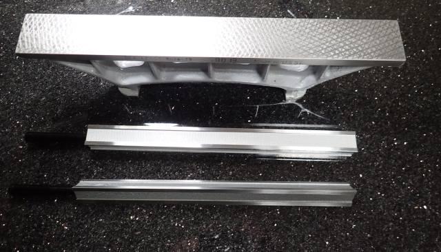

Plate is pretty, but looks like as a whole it is not straight enough.
But I got three weird knife straightedges and one camelback. They sem to be pretty nice.

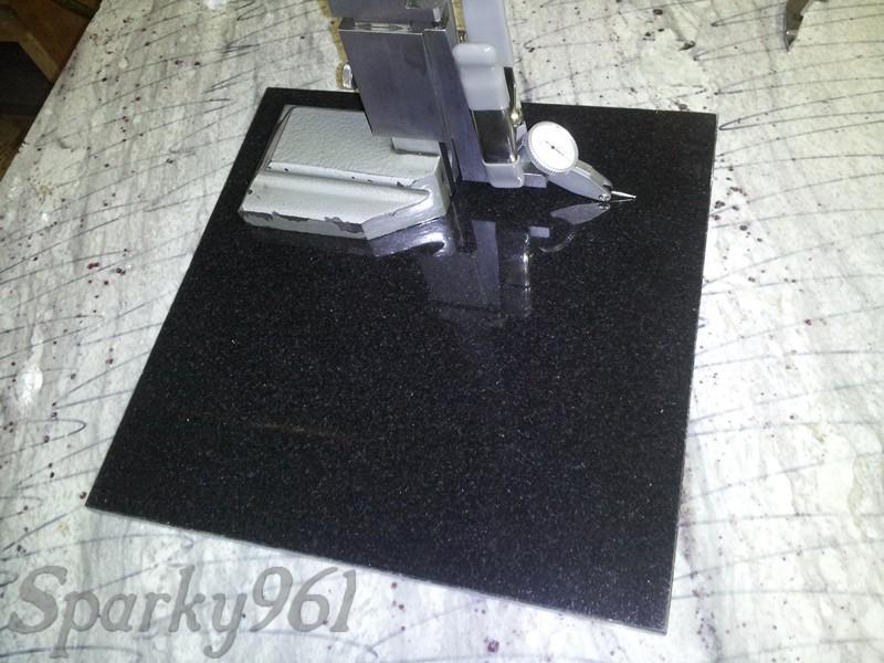

So, I had a chance to take a closer look at my haul tonight.  Spoiler alert: Don't get too excited.
Good news is that I was able to measure flatness deviation.  Bad news is that it wasn't difficult to measure.
To start off, my setup is far from ideal so take everything here with that in mind.  I have a shiny rock (could be granite, but how would I know?) about 26 x 26 x 1-1/4 sitting on a relatively rigid small table made of MDF.  Between the rock (we'll call it "granite") and the hard place (the table), there are three strips of minicell foam about 1" thick and maybe 12" long, placed somewhat evenly to support the plate.  Why?  I had some left over and it seemed this would allow the plate to "float" the best way possible with available materials.  With the indicator set up I pushed in various places and with a lot of pressure could move the indicator by about 2 tenths.  As you'll see in the next paragraph, proper support is the least of my concerns at this point.
After cleaning the slab, I proceeded to jury-rig my DTI to my height gauge.  Yet another tool/adapter thing to make.... The gauge base is about 5" long and my first setup put the indicator point about 6" from the end of the base.  Moving this around the plate in no particular pattern yielded a rough average of +/-0.005" deviation over 6", with a maximum of about 0.008".  The gauge base didn't slide nicely in many spots like you'd expect on a surface plate.  This probably explains the "grabbing" I noted earlier while doing my lapping trial.
One of the pictures below shows the granite floor tile I picked up at Home Depot.  It was more difficult to measure because there isn't a lot of room to move the gauge around.  I shortened the reach to about 4" and deviation seemed a bit better, maybe +/-0.003".  Given the smaller distance, this may or may not actually be any better.
So, in summary I don't think granite countertops are a useful surface plate as supplied.  If you're ok with +/- 0.010 or so then go for it, but I'm looking for better than that.
I'm going to continue working with some of the pieces I have to see if I can't find an effective way to improve the flatness.
« Last Edit: September 13, 2015, 11:37:24 PM by sparky961 »

I went through this exercise, to align my scratch built VMCs linear rails, 2200 mm long.
I found a vertex ground CI  straightedge, about 150€, new in the UK. Accurate to 0.04 mm.
A better option is a granite long parallel, but they are about 600 for 1.4 m long iirc.
Still thinking about it.
Machine builders square spirit levels, == 0.02 mm/ metre, were about 70£. I got two, and they make aligning stuff quite easy.
Testing the straightedge on a real granite surface plate, 600x440 mm, proves that you can easily see errors of about 0.01 mm, with a light behind it.
Putting a cig paper as a shim on either end, shows the lift clearly.
Since you dont need perfect, testing from the center to the edges should get you close.
Its feasible to sand steel pretty flat, ime.
I used a big, heavy, large belt sander.
Marking with a spirit permanent marker pen and sanding it off, shows you can get decent control on maybe 0.02 mm depth or so.
The edges get rounded.
The rails are mounted, and very well aligned, except at one spot. Its either high, low, twisted, or wanders from the front rail in some direction.
Plan is to put a dti on the ram, and check for rail error in the 3 axes.
Then just use a screw-jack to push it straight, and then tighten the mounting bolts.
You can easily feel any error over 0.01 mm while pushing the ram back and forth. Asain, cig paper as shims proves this quite easily..
The blocks are strong, and wont come to any harm from hand-forces.
I used 35 mm linear rails and blocks.
Hope this helps.

I've had the chance to spend a few more hours rubbing two stones together and I'm surprised to say that I wasn't really bored throughout the process.  It's rather relaxing and very rhythmic; albeit very messy as well.  It's to the point where I have one fairly large slab pretty much floating around on top of the other with little resistance.  Actually, a few times it just about got away on me and slipped off the other side onto the floor!  These pieces aren't light!  It's a bit strange to spin one atop the other with almost no resistance.  Hours of fun, in fact.
Now, the two issues I'm struggling with are as follows:
1. Flatness doesn't seem to be improving beyond around 0.001" max deviation over about 6".  Lots of places sit closer to a few tenths plus or minus but not as many as I'd like to see.
2. How to translate indicator readings into "map" of surface, most importantly the high spots.  The way I see it, a + or - reading could mean a small surface variation at the indicator tip, a large variation at the tip, or that the base is sitting on/in a variation that's causing the tip to erroneously read high or low.
How do you sort all of this out?
Is it possible without the fancy gadgets and software that professionals use?
Would 3-point contact of the height gauge base be of more benefit than the flat base that can rock a bit on imperfections?
Is this where it becomes easier to use a level?
For #1, I'm thinking it could be just that I haven't done enough work on it yet.  But what I don't want is to keep working and not see any improvement.  Hence #2, I want to be able to ensure its getting better, not worse or just shifting the variations around.

Hi Sparky
Use three ball bearings to stand your indicator base on.  If necessary a touch of super glue will hold them in place.
« Reply #63 on: September 23, 2015, 05:38:30 PM »
Thanks for the new info and tips. I'll give an update once I've made some progress.
