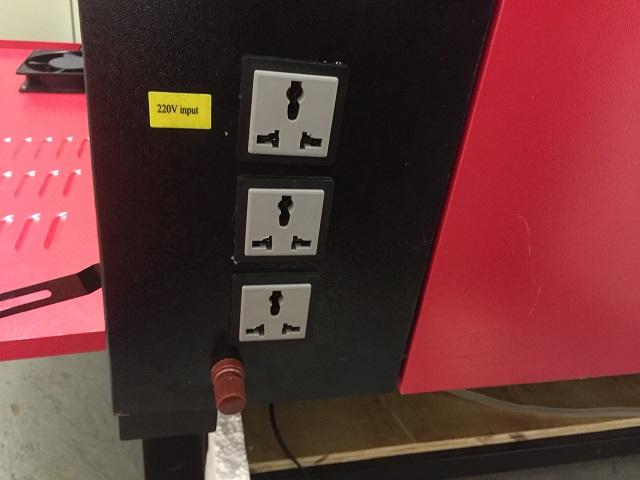

A little while back I bought an eBay Special 60W Chinese laser engraver / cutter which has featured in the odd thread here on the forum, but I've decided to start a new thread to gather all the bits I do into one place.
It's been mentioned here : (and perhaps a few other places  :scratch: )
http://madmodder.net/index.php/topic,10883.0.html

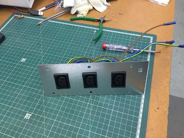

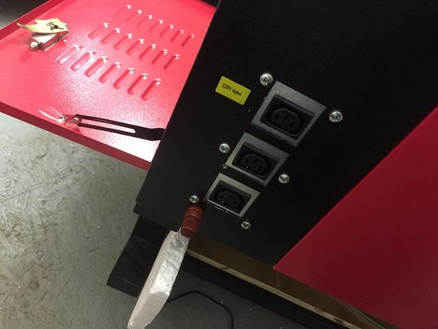

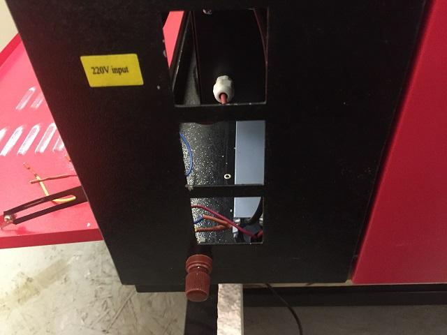

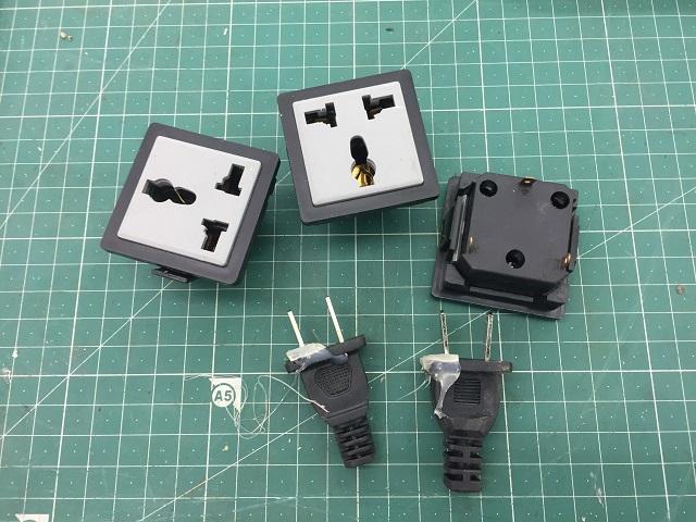

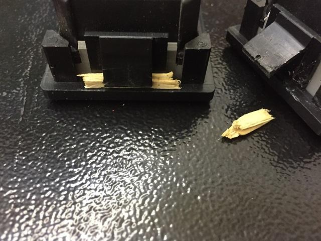

Today I finally got fed up with the lousy mains wiring to the peripherals and made up a new power output panel. The problem was that the originals were 'universal' sockets of rather poor quality that didn't retain the plugs sufficiently to take the cable weight
This is what there was
Re: 60W Chinese Laser Engraver Modification
« Reply #1 on: August 15, 2015, 10:05:46 AM »
Not only were the sockets poor quality, they didn't grip in their cut outs properly so the manufacturer had jammed bits of wood in to fix them  :bugeye:

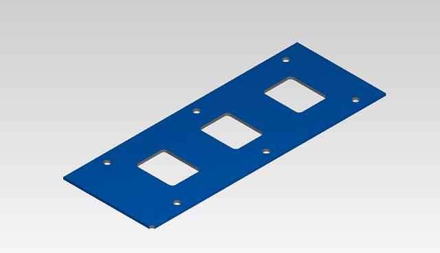

« Reply #2 on: August 15, 2015, 10:10:12 AM »

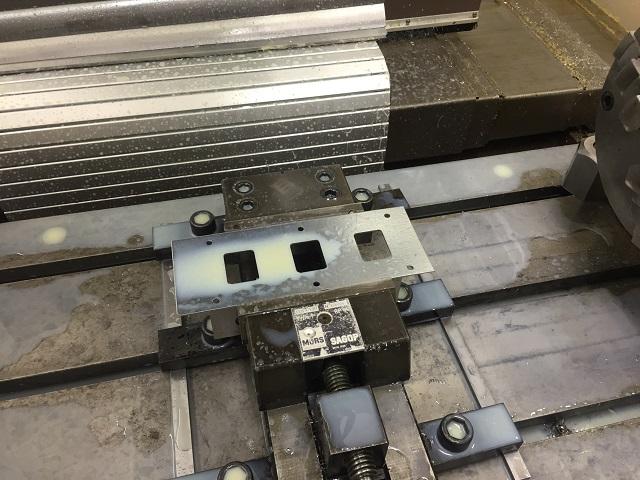

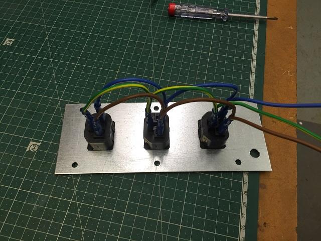

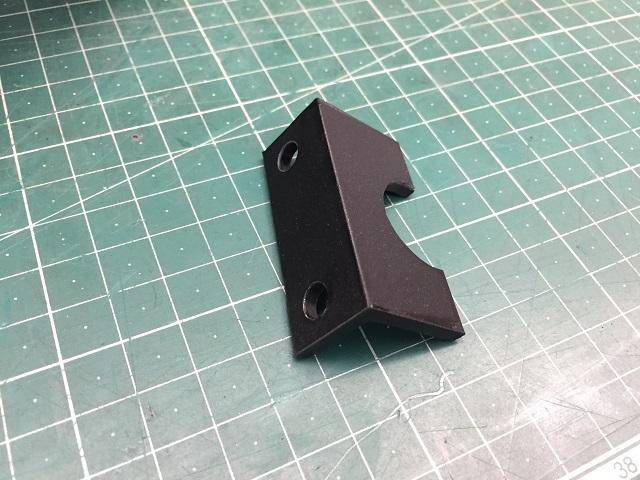

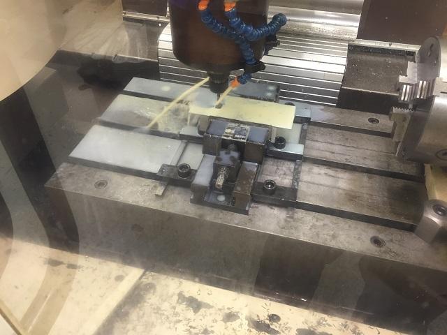

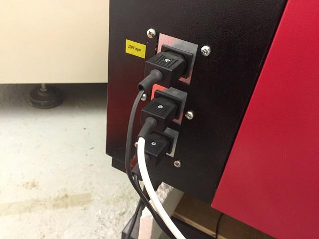

I decided to use "IEC" power outlet sockets from a reputable UK manufacturer (Bulgin) and make up a steel panel to fill the existing cut outs and mount the sockets.
So draw it up in FeatureCAM, cut a blank on the guillotine, mount it in the CNC mill and make it . . . it was one of the few occasions when the whole process went smoothly, even down to the slightly dodgy mounting of the panel as it was being cut - yes there are parallels below the panel   :clap:
« Reply #3 on: August 15, 2015, 10:13:57 AM »

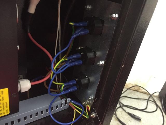

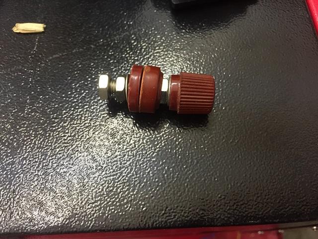

I decided to keep the "Earth Terminal" that all these lasers seem to have, as although I don't use it (as the machine is earthed via it's standard 13A inlet) it was a convenient way of minimizing the wiring changes
« Last Edit: August 15, 2015, 10:51:26 AM by awemawson »
« Reply #4 on: August 15, 2015, 10:17:50 AM »
So I was more than happy to consign all the old stuff to the dust bin and put the new into use.
I'm sure that there must be robust two and three pin US style plugs and sockets, but these weren't they  :clap:
At least now I'm not having to constantly check that the plugs haven't fallen out. One is for the water circulation to cool the laser and only a matter of a few minutes disconection would scrap £250 / £300 worth of laser tube  :zap:

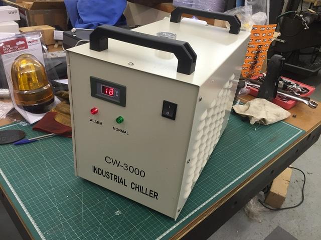

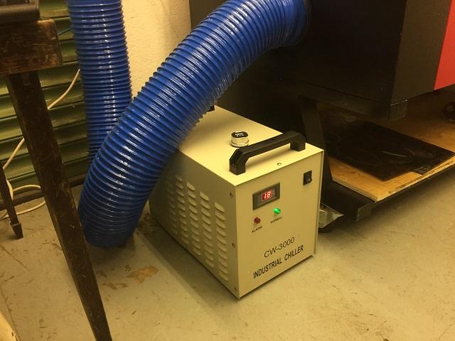

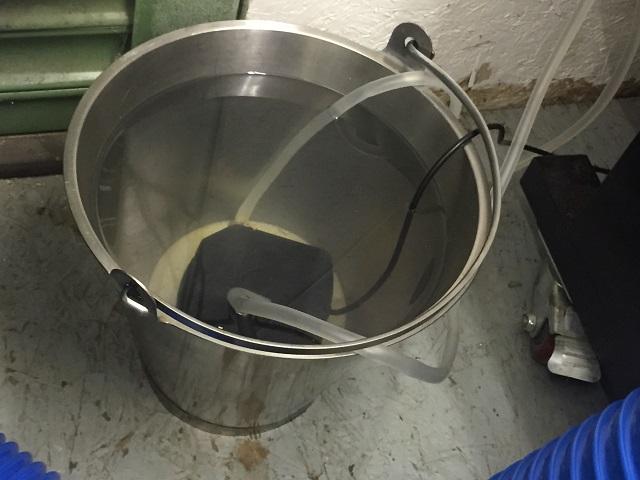

The laser needs water cooling, and now I've sorted out the power out sockets (incidentally labelled power in on the machine  :bang:) the time has come to sort out my water system.
They supply an immersible pond pump and suggest using a bucket, which is what I've been doing, but that has a few disadvantages:
A) I'd like to use anti-freeze as the machine is next to the roller shutter, but not in an open bucket when my dogs come to visit me playing in the workshop - anti-freeze is poisonous.
B) I just know that I'm going to kick it over at some time, because I do that sort of thing (unintentionally  :palm:)
C) An open bucket attracts 'stuff' - this one fills up with dead spiders, some of which float, and others sink  :scratch:
Now there are commercial coolers available with enclosed tanks, flow alarms and temperature alarms. All very good but they are really rather expensive for what is essentially just a coil of pipe with a fan blowing over it, so I've resisted up until now.
« Reply #7 on: August 17, 2015, 05:48:48 AM »

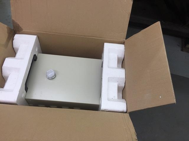

However one popped up on eBay at half the normal price, so suddenly the equation started to balance  :ddb:
As it was a one off 'buy it now' it seemed rude not to so I placed an order, and Angie, our local 'My Hermes' lady struggled in with a large box this morning  :clap:

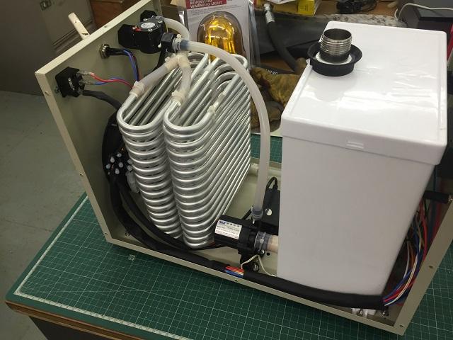

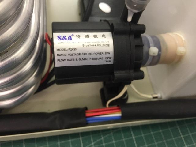

Obviously the first thing a real mad modder needs to do is pull it apart and see how it ticks  :lol:
It's actually quite nicely made
« Reply #8 on: August 17, 2015, 05:54:18 AM »

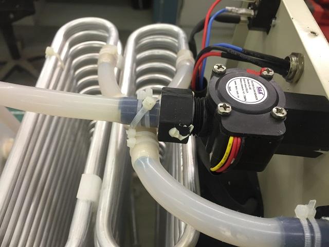

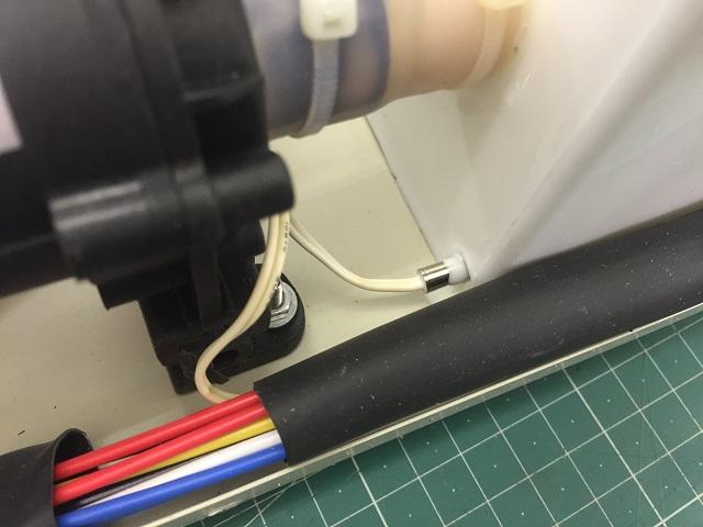

A nominal 10 litre plastic reservoir tank with embedded temperature sensor that feeds a panel display. Outlet from the tank goes to a 24v pump that circulates water through the laser tube, and back via the flow sensor and cooling pipes.
Note  that there is no 'active' cooling, (compressor / evaporator or Peltier element)  the heat is just dispersed to atmosphere by a fan
In built is an alarm that is triggered by either over temperature or low water flow, a very handy feature

So putting it back together I removed the crude bucket affair, installed the cooler, and filled it from my stash of pre-diluted anti-freeze (*). Connected up the plumbing and set it to work.
It is too tall to go on the shelf under the machine, and long term I intend to mount it on the side so as the machine is moved on it's castors you don't have to fuss around with pipes and cables, but for now it just sits on the floor.
I had contemplated making one but frankly the bits would have cost much the same as I paid by the time it was boxed and working.
A very useful side effect of the way that the engraving machine sequences up, is that as it goes though it's start up routine water flow isn't instant as some has drained back to the tank, so the alarm sounds for a second or two confirming that it still works !

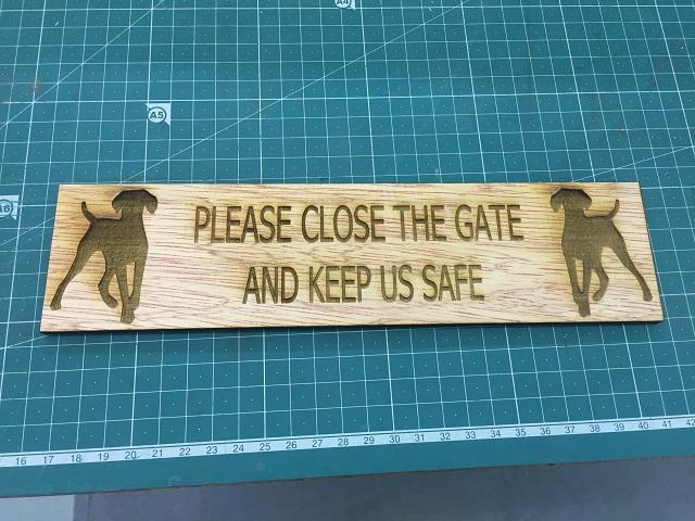

I'm getting to rather like this laser cutter  :ddb:

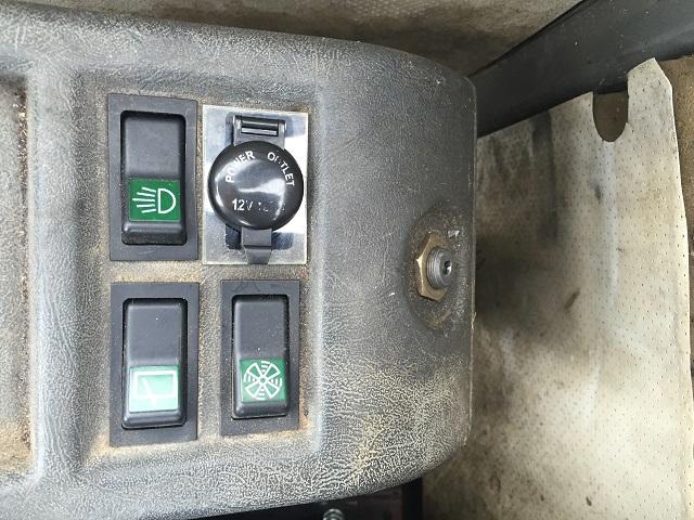

Today I needed to fit a 'cigarette lighter socket' in the JCB 803 mini digger - why as I don't smoke  :scratch: Well I need to sport an amber flashing beacon when I'm stream clearing on a public footpath that borders our land. Only place on console was a 'switch blanking cover' but totally wrong shape.

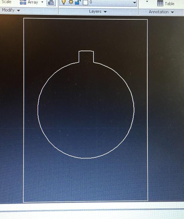

Needed to make up a little 50 mm x 35 mm plastic panel with a 'keyhole' for the socket. Quickly draw it up in Autocad, download it as a .DXF to the PC I've dedicated to the laser cutter, open it in RDworksV8 (which is the graphics package that came with the machine, squirt it to the laser cutter and bob's your uncle.
Literally quicker to do than type this description. Previously I'd have been drilling and filing and cursing when it didn't fit. This went in first time

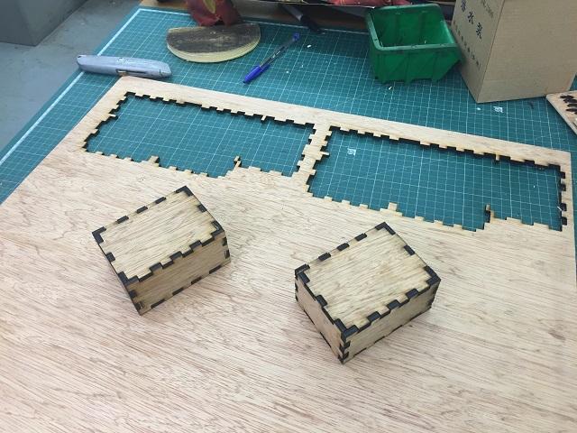

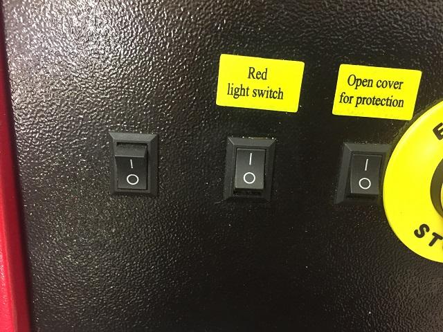

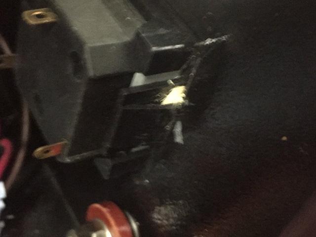

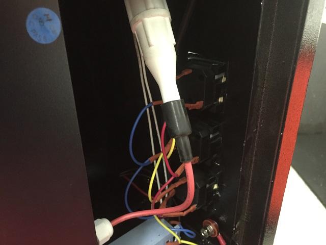

I decided to investigate further some switches on the front panel. I sort of half expected what I found, but it's a bit scary  :bugeye:
In the picture below:
a/ the left hand switch is not connected, nor are there loose wires, nor is it labelled, so OK ignore it
b/ the middle switch does what it says on the box - turns the low power red laser target finder on, so it's OK
c/ but what about this one on the right? Turns out that it is in parallel with the safety interlock on the machine lid, the one that saves your eyes. Flick this switch AND THERE'S NO INTERLOCK  :bang: :bang: :bang: :bang:
All rather nasty but easily sorted with a pair of snips  :ddb:
To celebrate I made a pair of boxes - these are 100 x 75 x 50 mm out of 5 mm ply

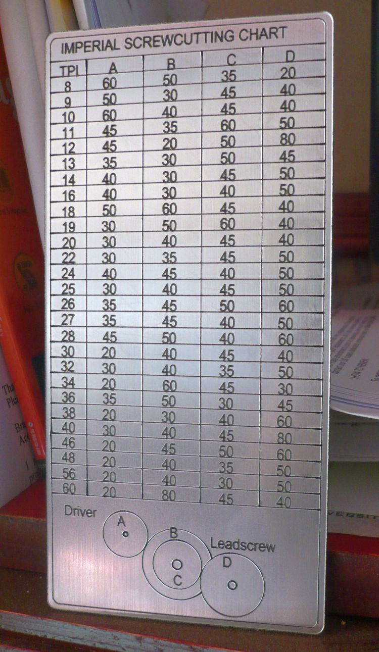

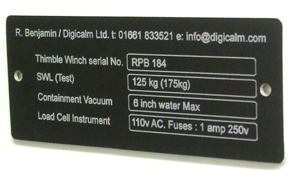

My parcel from them just landed 5 minutes ago. Also got a parcel of black anodised alloy sheet off Ebay for plates. They will engrave but not cut these.
You can use any colour but as the lettering is always white because it burns down to the base coat you need a good contrast. Black is best, the gold hardly works unless its in the right light and the clear anodised looks like the Italian flag, white cross on a white background.
Not my part but this is what the black plates come out like.

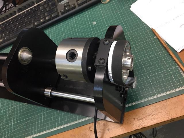

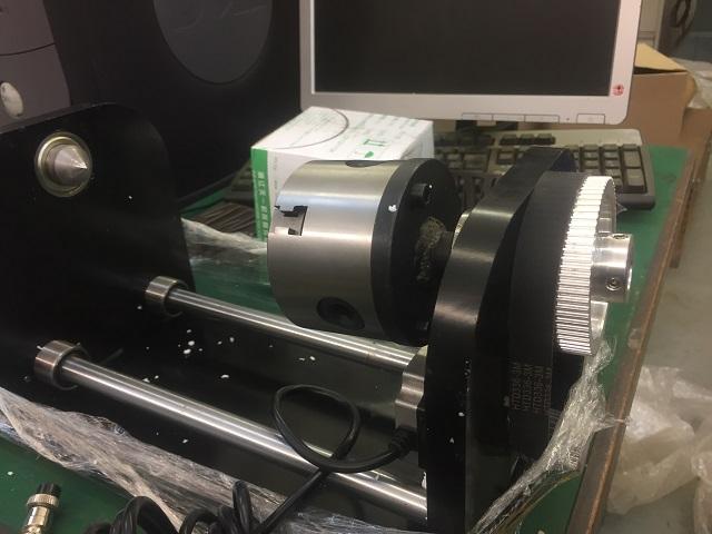

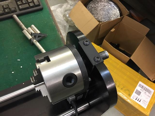

« Reply #23 on: March 08, 2017, 01:15:09 PM »
Reviving an old thread here but it is relevant  :palm:

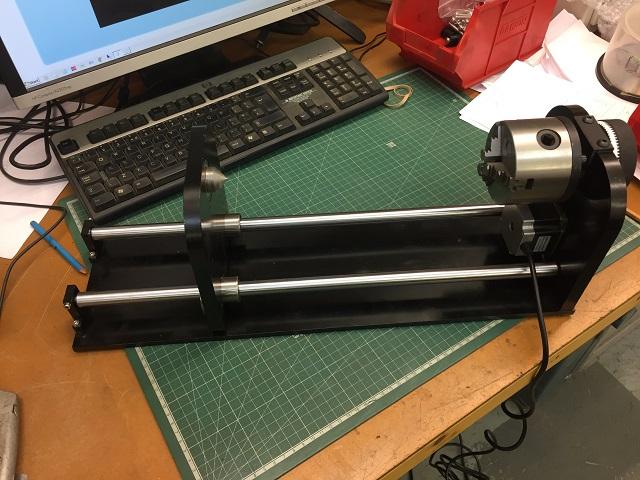

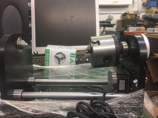

When I bought this Laser Engraver there were other offering from the same seller that seemed identical, but came with a 4th Axis and a VERY much larger price ticket, so I never went down that route. My version has the socket and cabling and the rotary axis is used in place of the Y axis by unplugging the Y axis driver cable and plugging this one in.
I've been keeping an eye on eBay since I bought the laser but have never seen one until recently when one popped up at an almost acceptable price, and a bit of negotiation around 'best offer' got one on the way to me  :ddb:

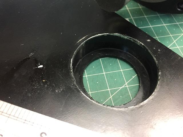

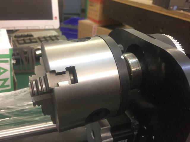

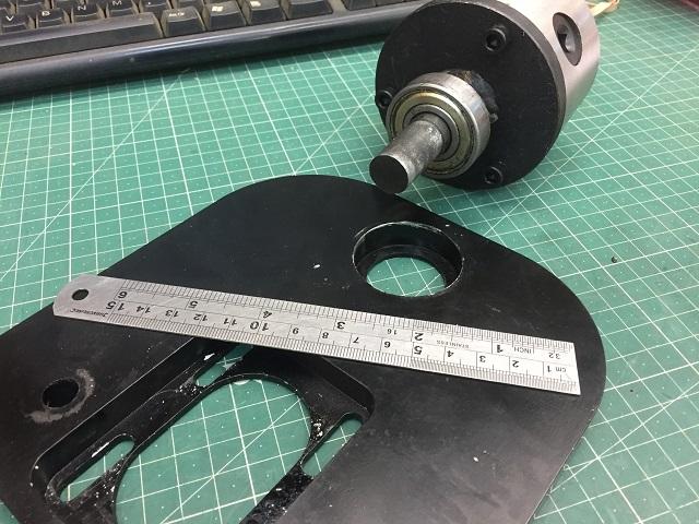

However when it arrived the main spindle bearing had been dislodged from its housing, presumably as there was no retainer and it had suffered a bump - the mass of the attached chuck ripping it out  :bugeye:
Now other than this problem it was fairly well made, so after a further bit of negotiation and a further discount I agreed to keep it and repair it. Well the 'round tuit' happened today  :clap:
« Last Edit: October 26, 2020, 07:36:15 AM by awemawson »
« Reply #24 on: March 08, 2017, 01:17:58 PM »
In use there is little force on the bearing - the laser exerting no cutting force - the design seems to rely on Loctite to retain the bearing against a shoulder
« Reply #25 on: March 08, 2017, 01:21:29 PM »
I decided to press the bearing back in, and make a little bracket to retain it. I'd hoped to be able to make a circular one, but the way the chuck backplate is welded to the shaft precluded this. In the end I made a little clip that bolts to the chassis upright - it should be serviceable in this application, but not if it was used (say) on a milling machine.
« Reply #26 on: March 08, 2017, 01:49:53 PM »
So putting it all back together it works ok - the only evidence of damage is slight scarring to the large drive pulley where it's been bruised on the extreme edge, but not where the belt runs.  :thumbup:
OK - so what does it let you do - engrave around the periphery of circular objects - I've even seen a Youtube video of a drinking glass being  engraved held in the chuck  :scratch:
Happy to have it, as it 'completes the set' as it were, but it probably won't see much use I suspect
