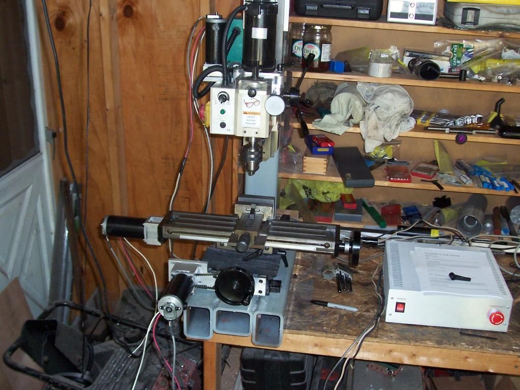

Some mods made to an X2 mini mill, this is still a work in progress.

I like the acetal nuts a lot. The thread here at homeshipmachinist got me started on them. They are fairly easy and quick to make but it does take a little bit of time and fiddling to get them just right.
They have good and bad points.  Good points: Zero backlash and very low wear. Bad points: They are temperature sensitive.  A nut made at 20 oC will be tighter at 0oC and looser at higher temps, but as I get older I prefer the shed temps to be around 20 degrees C so its not that big of a drawback.  The lesson here is make the nuts at the temperature that they will be used at.
Regards,
Steve.

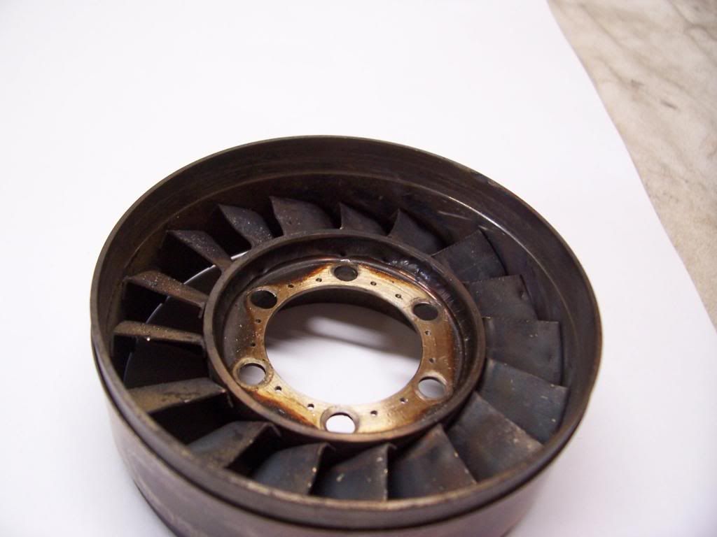

The original plan was to add free power turbine and fit it to a small bike frame, but, during one of my experiments with combustion flame holders, a largish chunk of heavy nichrome wire melted free from within the combustion liner and exited through the NGV and turbine wheel at about 50K rpm. The damage was slight but the NGV and turbine wheel need to be replaced. Here's a post mortem pic.
http://i87.photobucket.com/albums/k142/madluther/Turbine%202/100_1251.jpgSome of my stuff
The NGV is showing little spots of melted nichrome on some of the blades. Plus some of the blades have broken loose.
http://i87.photobucket.com/albums/k142/madluther/Turbine%202/100_1252.jpgSome of my stuff

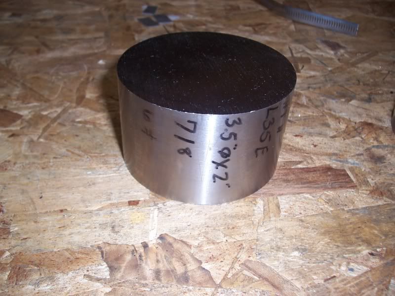

This is where the mill mods come in. The mill is in a state where it can take quite heavy cuts in steel and "should" be able to take light to moderate cuts in inconel. So the plan is to make a new wheel and NGV but this time the parts will be mostly CNC machined. The current stumbling block is I have a large chunk of 718 inconel bar stock, but no saw to slice it up.
http://i87.photobucket.com/albums/k142/madluther/Turbine%202/inco_718.jpgSome of my stuff
So the current project is building a power hack saw that can use tungsten carbide blades which is about 70% done.
I love the acetyl nuts, they are a genuine zero backlash solution, cheap and with a quality acme screw, very accurate.
