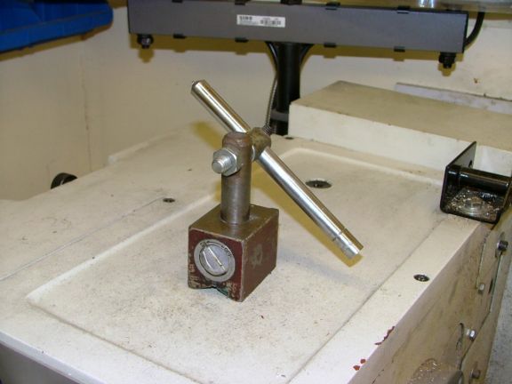

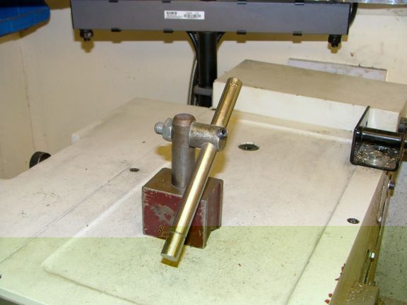

One thing to take note of, dressing the stone is of paramount importance, you can't usually do much about the balance. I made my own dressing unit out of an old mag base and a single diamond dressing stick. If you want a pic, let me know.

bogstandard
Re: tool post grinder?
« Reply #5 on: May 07, 2009, 01:30:26 PM »
Sorry it is a bit late Fred, but here are a couple of pics of my mobile dresser.

« Reply #6 on: May 10, 2009, 09:37:28 AM »
John,
Please give my Happy Mothers Day wishes to your wife and all the other ladies that put up with our eccentricities!
Thanks for the pics. I like how you made it. I will make a variation of it immediately. Sorry it took me so long to answer, but I haven't been on the computer much for a few days. My son is using it for his homework assignments a lot, lately.
