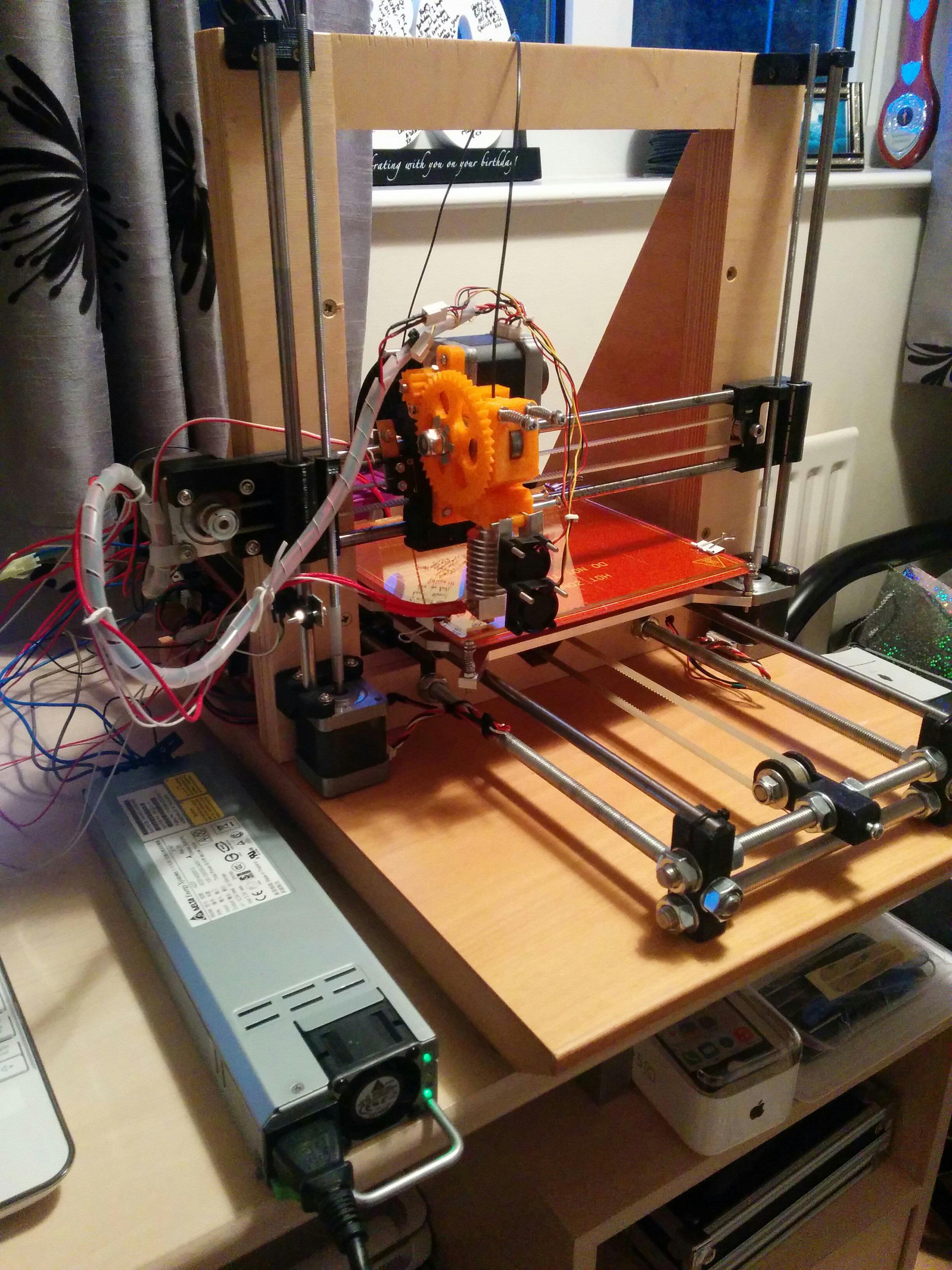

« Reply #56 on: August 14, 2015, 05:21:56 AM »

« Reply #59 on: August 15, 2015, 04:32:01 PM »
Swarfing,
The picture attached shows a lot but not all of your setup.
   I notice that you placed the bracing triangles in line with the central opening and not in line with the outer sides of the upright. Any particular reason why?
   The Y axis motion parts are as you say connected to the upright using the two Y axis all-threads and nuts, and I can also see that you have made the upright with double thickness compared with the drawings I have seen - much along my thoughts as well, but did that create the "too short allthread problem"? Menaning that it affected the length for housing the Arduino below the allthreads at the back?
   You mention that you have secured the upright to the base plate using screws from below, but have you also secured the Y axis motion end parts as well or is the only connection through the pinching in the upright slots?

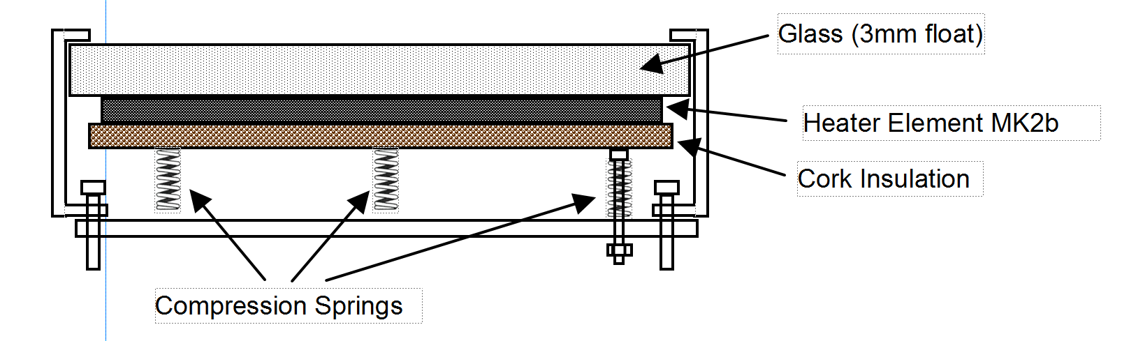

The bed levelling issue is mad. The bed is levelled by adjusting a heater board which buckles under heating due to differential expansion and is attached  via the screws and springs which is dubious at best. Much better (IMHO) to fix the glass and level it, then clip the heater board to the glass and let it go where it will.
I think some edge connection clamps for the glass, rigidly mounted to the y carriage with space underneath for the heater to attach would be a significant improvement, and once leveled should not need an readjustment.

Offline efrench
  • Posts: 218
Re: 3D printing
« Reply #62 on: August 16, 2015, 12:40:30 PM »
In that case I'd attach the heater to an aluminum diffusion plate. If you're going to be printing multiple items, then you will want to remove one glass plate to cool while printing on the next.
My diffusion plate is 8mm thick (400mm diameter) Mic6 aluminum and is attached at three points.  The bolt holes are oversized to allow for expansion.  Initially the heater will be held against the bottom of the diffusion plate with springs.  If this isn't satisfactory, then I'll use a silicon glue.
Offline Swarfing
  • Posts: 417
Re: 3D printing
« Reply #63 on: August 17, 2015, 06:26:04 PM »
Peter the ramps unit is fixed to the left triangle you see in the picture. unfortunately that is the only pic i have supplied by the owner. I only built him the basic unit and left him to finish all the wiring etc but I did have it running smoothly before handing it over. it leaves plenty of room for the electronics and the z axis is no problem at all with height. In short you can make things as thick as you like without affecting anything at all. The opening is still as per the original so no problems there with bed movement etc. Don't forget the original design is to try and make it as cheap as possible in-line with the reprap philosophy.

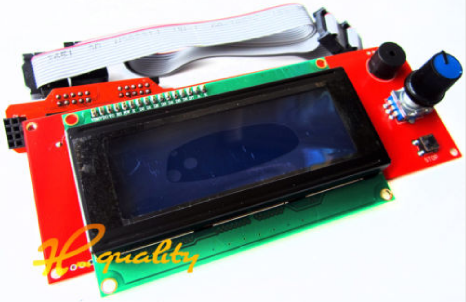

Offline PeterE
  • Posts: 458
  • Gothenburg
Re: 3D printing
« Reply #68 on: August 21, 2015, 04:58:20 PM »
The graphics display was included! At the top in the picture!

« Reply #70 on: August 22, 2015, 03:13:10 AM »
Hi PeterE

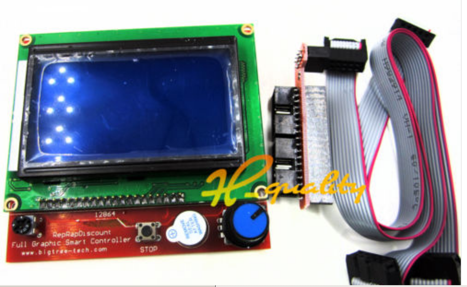

The display card you have is a 4 line text display - as is the one I incorrectly ordered. The display card I should have ordered is a graphic display - but I screwed up and ordered the wrong one  :bang: One of those late at night jobs .. .
The difference is that the graphic display can show temperature plots and other non text stuff and its easier to navigate between menus. Not sure if the text display will do the run standalone bit.
Have ordered correct one for £8.39 - don't usually make that kind of mistake. Pictures below for reference .
Best Regards
picclock
Offline PeterE
  • Posts: 458
  • Gothenburg
Re: 3D printing
« Reply #71 on: August 22, 2015, 08:56:56 AM »
Aha, THAT was the difference  :palm: I just thought it gave more text rows ...
