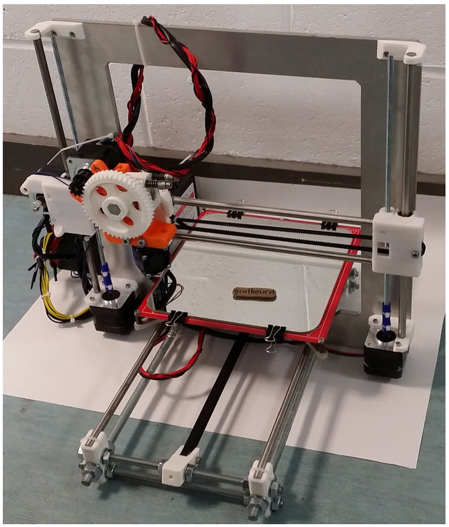

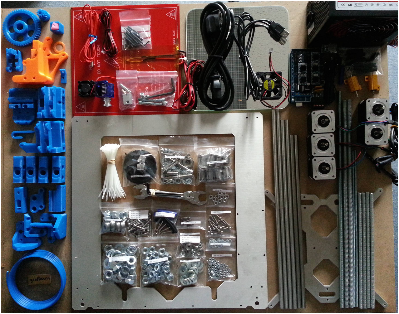

I am considering investing in a 3d printer in the near future. Ideally one which would produce parts in nylon and abs. I have seen a very low cost kit called a two up :
http://www.productchart.com/3d_printers/5843
which looks too good to be true.
Does anyone have one of these or an alternate and what are the pros and cons of the machine you have ? What is the best UK website for info on these devices?
The idea of being able to produce custom gears and other small parts in nylon/abs seems very attractive to me.
Best Regards

I looked at the Da Vinci one but was put off by the need to use filament cartridges. My limited research has shown that some very exotic materials are now available, and that nylon can be used with little alteration. The two up is very much a budget machine, but from what I have read may be too troublesome.  I am now considering a Prusa i3 kit, which has a water jet cut aluminium frame. As you can specify the extruder head, I can select one which will do the higher temperatures needed for stronger materials.
The link to the kit is slow to load, http://semiu.co.uk/product/prusa-i3-complete-kit/ ,  the photographs are poor, however the information I can find about it seems to indicate that it will do the job. Will try to get some actual prints from the chap. AFAIK, the surface finish is determined by the nozzle size. So a small nozzle size will give a good finish but will take a long time to print. The mechanical positioning resolution of the printer is 0.0125 mm in X and Y and 0.00025 mm in z. Intend using E3D-online v6 nozzle which will go down to 0.25mm.
Still very much at the considering stage - far too much work on to do anything about it at this moment, but I like the possibility.

The gears look impressive although the surface finish looks a bit rough. This is one of the aspects I am concerned about, because as parts get smaller the roughness becomes a greater percentage of the part. Like the idea of using the different colours for a visual mesh check. At £400 your printer seems a very reasonable choice. Which software package did you use to design the parts?
The mechanics of the Prusa kit seem fairly OK. It has 10 linear ball races used with precision ground rod (0.03mm) and a water jet cut aluminium frame, which to me looks pretty good. I don't think they could get the head position accuracy figures otherwise. The only part that concerns me is that the vertical metal plate (gantry) attaches to the base with just two nuts and washers to keep it vertical. To be fair there is no load to move it from vertical but the dynamic loads caused by the movement of the head may cause some accuracy issues here. If I go ahead with the purchase I will measure the repeat accuracy with a gauge and anything that I find which reduces it I will stiffen up with custom mods. It looks like just mounting it on a known flat surface with brackets at right angles to the gantry (vertical plate) would sort it.
There is a computer generated assembly video which seems quite well done (and entertaining :-) ) :

Research on the internet has confirmed that unless you mount the prusa on something flat it will have to be recalibrated every time its moved. I know a guy who cuts stone kitchen tops to size and he has loads of scrap pieces in his yard. As we are likely to order our next kitchen tops from him I would think a granite or synthetic stone base would sort out that issue. The other thing I didn't like was that the end stops used on these machines are microswitches. Replacing these with opto sensors, especially the smd variety will give orders of improvement. Likely only really necessary on the z axis.
Just need more hours in a day to get the time to play with this technology.
