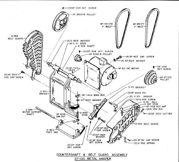

I recently bought a shaper. A 7" Delta/Rockwell shaper from 1952. It's in pretty decent shape and my goal is to get it running and reasonably accurate.
It is missing the motor setup, though. Originally, these shapers came with a 1/3 HP, 1725 RPM AC motor that ran a jackshaft (with about a 3:1 speed reduction as part of it) and then had a stepped pulley arrangement to provide four speeds for input to the bull gear. I'm missing basically everything in the "Shaper Motor Arrangement" picture (attached, I hope!)
So.... I guess I COULD try to find all that stuff, but frankly, I'm not interested in "restoration", I just want this thing to make chips so that I can figure out how a shaper works and what it's good for. As a result, my plan is to simply mount a VFD motor on the bench behind the machine, line it up with the input pulley and go for it.
Since I'm missing the 3:1 speed reduction, though, I was thinking of using a DC motor with a speed control here to improve low-RPM torque (also, looks like it's a little cheaper than an AC/VFD solution of a similar size.) My problem is that I'm not that familiar with the technology and wanted to check - do AC and DC motors "cross over"? (In other words, should I be looking for a DC motor of 1/3 HP ish? Bigger? Smaller?) Any tricks about buying DC motors for VFD usage I should know about? (I know that "inverter duty" AC motors are more expensive... is it the same in DC?)

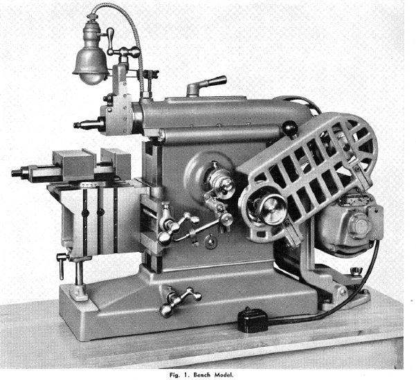

Does that work light REALLY go back and forth with the ram as it looks in the illustration? If so I can't imagine it lasting long.

Does it still have the original stepped pulley on the side of the shaper? That gives some scope for adjustment of speed and torque.
You'd need the smallest pulley you can get for the motor (normally limited by the belt).  You could get more reduction if you changed it to a polyvee belt drive as you could get a smaller pulley on the motor (polyvees go in smaller radii).
Is there room on the side of the shaper to fit a larger pulley there?
No, it's fixed on a bracket on the left side of the ram (behind the ram in the picture). Still works, too!
Yes, the stepped "input" pulley on the side of the machine is there. I suspect that this unit was driven like I plan to (with a direct drive) prior to this. Unfortunately, I bought it from a dealer and don't really have a history on it.
You know, I actually haven't checked what it uses yet. I was kinda assuming a standard 3L or maybe an A because of the age, but that's worth checking out.
Possibly.

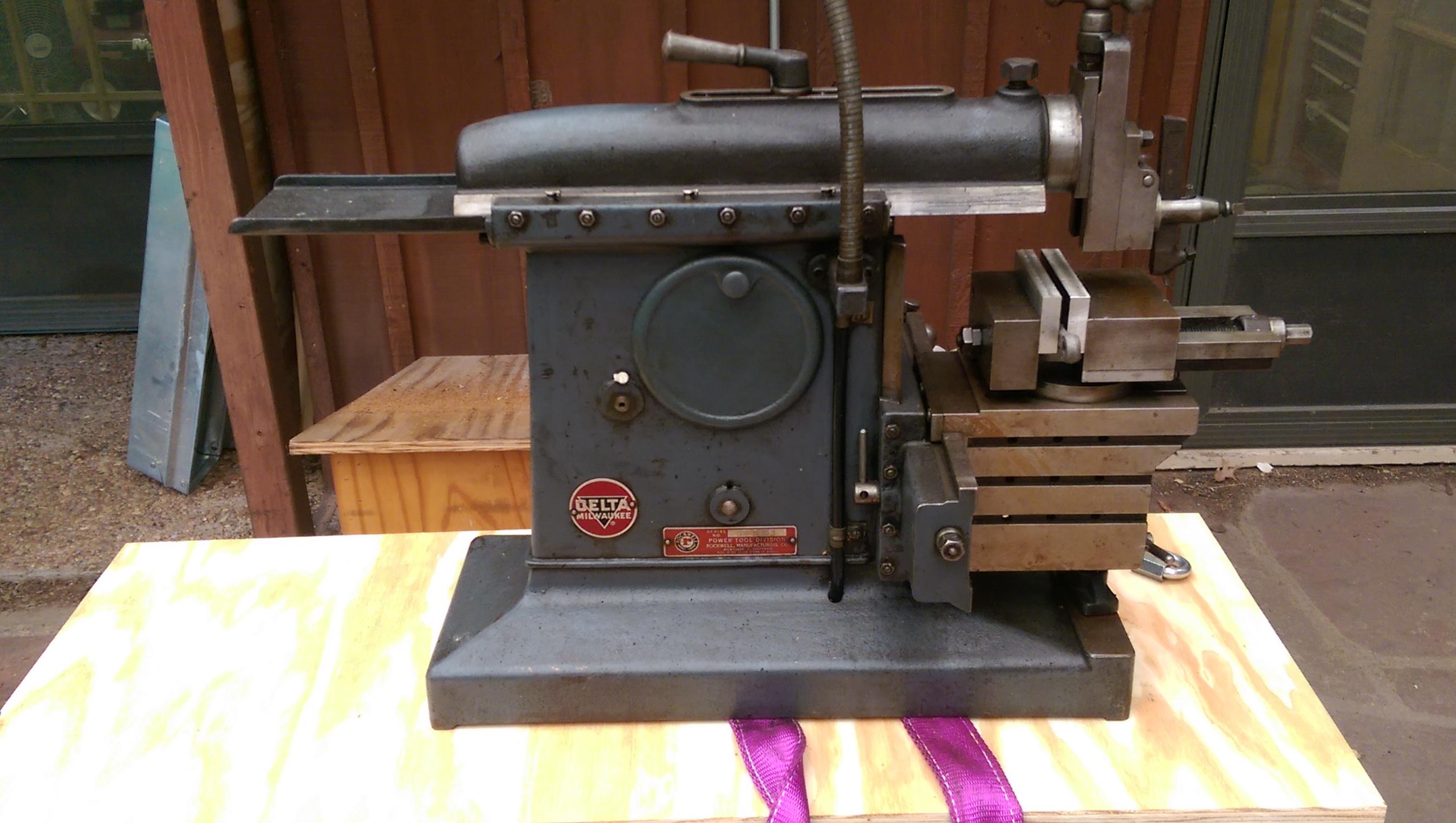

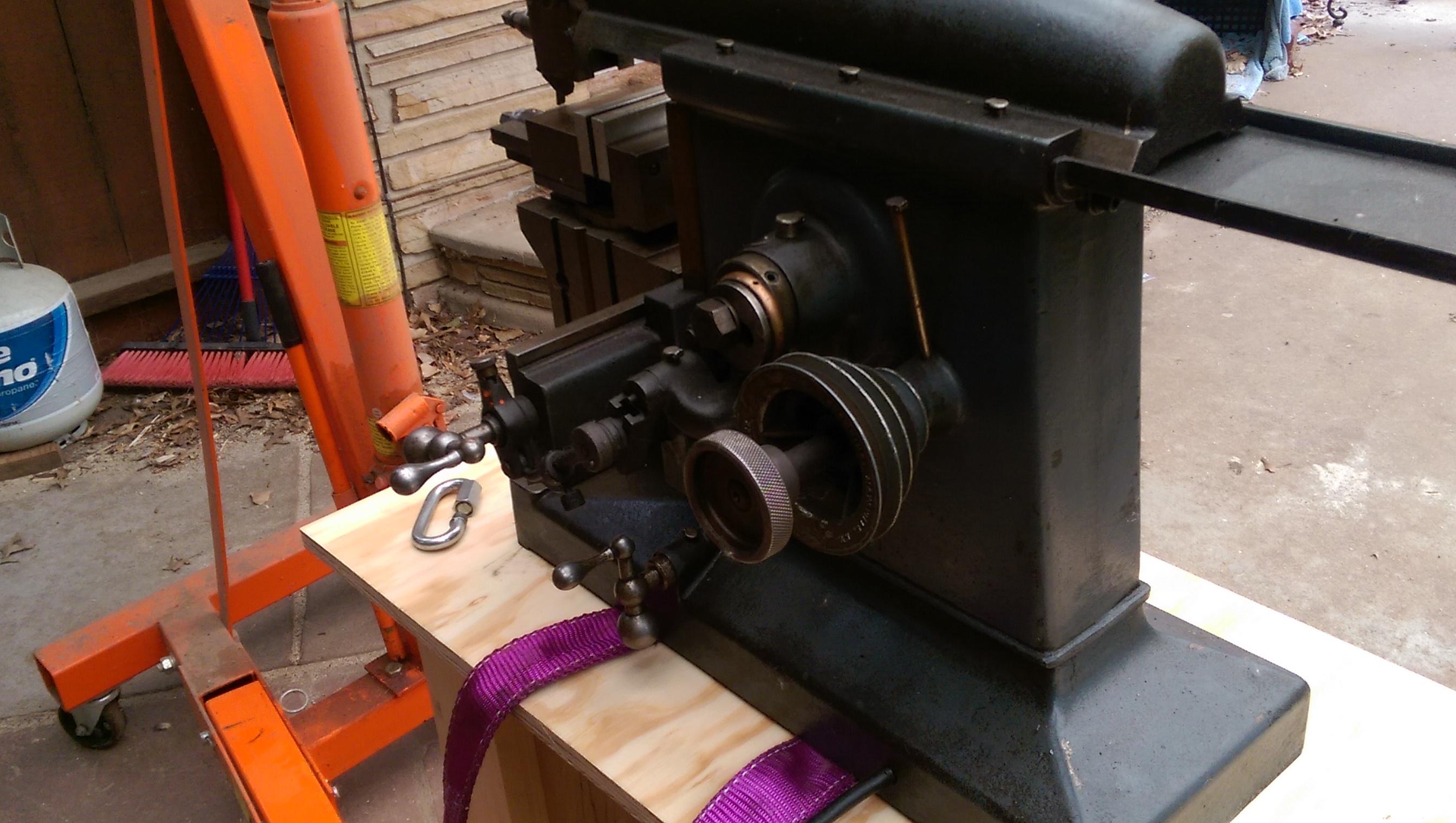

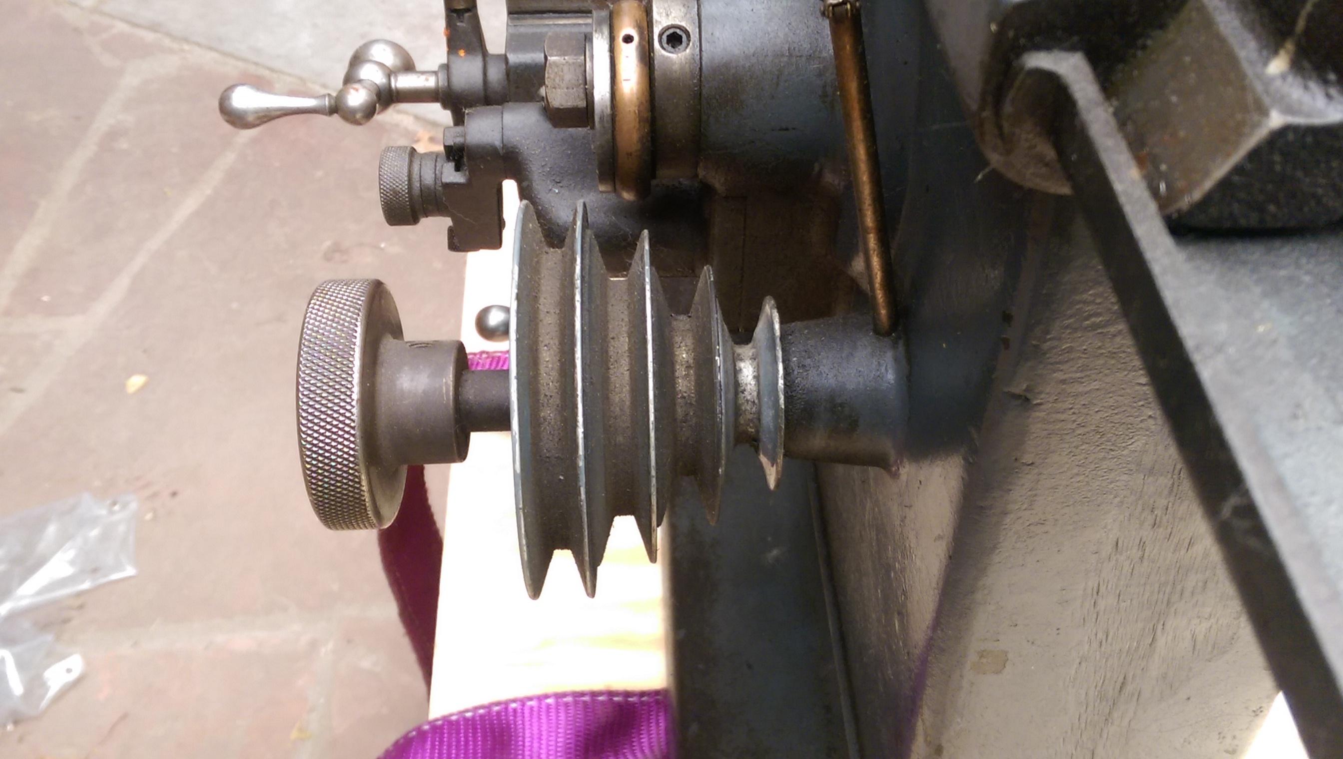

I spent some time today after we got back - last weekend I built a stand. It's a lightweight wooden job, but should serve (and if it doesn't, I've got another workbench.) Anyway, I didn't have much time, but I wanted to get the shaper up on the stand and figure out mounting/screws etc.
General shot from the left (non-pulley side) (Attachment 1)
A closer shot from the right side looking at the input pulley and table feed mechanism (Attachment 2)
and finally a shot of the end-on view of the input pulley (Attachment 3)
The rough dimensions of the pulley OD are 4.5", 3.5", 2.5" and 1" with a slightly over 0.5" pulley width (so I'm figuring an "A" series belt will work.)
One other data point I found - according to the original manual, the shaper was able to provide 40-180 strokes per minute. Again, I figure that the relationship between RPM and strokes per minute is consistent. However, it's NOT 1:1 as I thought earlier. Turning the unit by hand, it's about 6:1 (one full cycle of the ram for 6 revolutions of the pulley.) So that means that they were expecting no more than 1100 RPM at the input pulley, more or less.

Had look at this posting and it looks like you are on the right track with a 1/2 hp DC motor and variable speed controller
Retain the stepped pulley setup  to give better torque at low speeds.
Suggest that you use only the three pulleys I.E. 2.5 drive 4.5 driven, 3.5 drive 3.5 driven 4.5 drive 2.5 driven with 4 to 1  reduction from the motor to counter shaft.
Being a dedicated nut case for DC Drives This would be the only way.
A tread mill motor will do the job But will need a wider ratio primary drive ratio.
