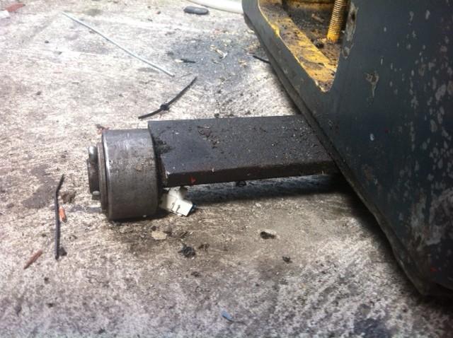

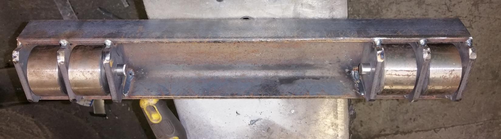

To move the Colchester Triumph 2000 into the workshop I made up a couple of axles using 80x10 flat steel with 25mm round bar stitch welded to it,
I used ball bearings as wheels as the concrete is smooth but larger wheels could easily be fitted
The 80x10 can easily be clamped as desired to the lathe base, (straight or angled to turn) so no fear of the lathe running off the rollers

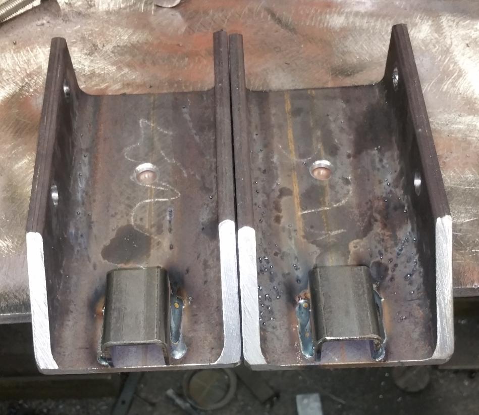

Having looked at the prices they want to hire/buy skates I am thinking about something like this I will probably use 76 X 38 channel to make mine however. Going over on saturday to pay him the money and do some measuring up.

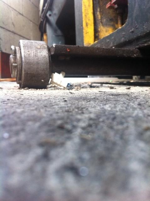

« Reply #13 on: July 17, 2015, 12:23:27 PM »
Made a start on some gear to move it  :D
might need to split the back one though for some reaon I had 18" in my head for the width of a slab  :doh: but its no big hardship to split it and lengthen it with a few bits of angle each side.

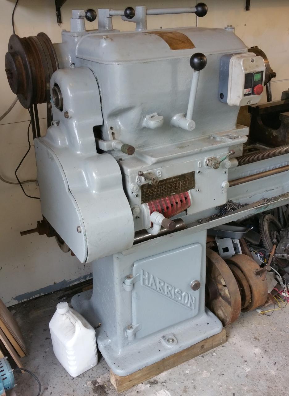

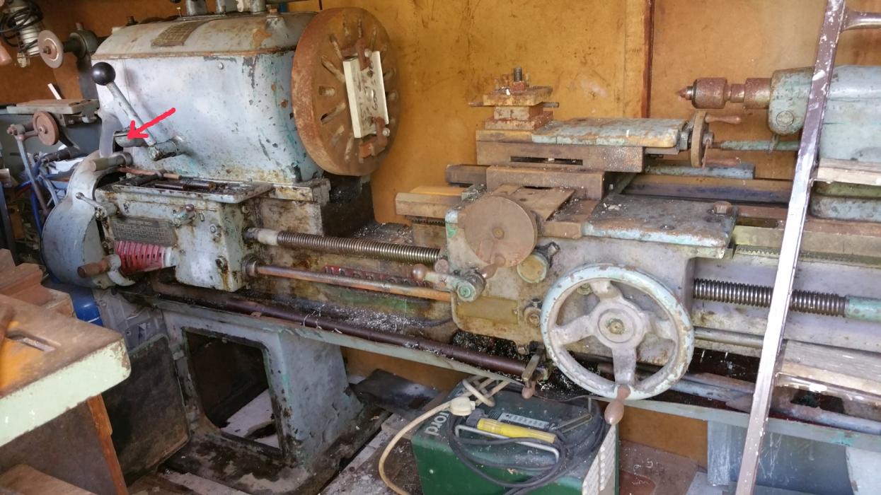

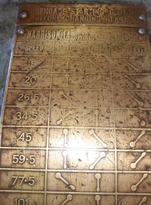

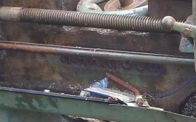

I have the chance of Harrison 14" lathe like http://www.lathes.co.uk/harrison/page9.htmlthis one. Does anyone have any experience of moving anything like it? how much can it be split apart?
Scratch that I was going on my uncle telling me it is a harrison 14 however it isnt. I looked at it today and to me it looks more like a early L5, or at least thats the closest I can match it from the lathes website. The one thing I cant find however is a model with the oil level pot (or at least thats what I think it is) like this one. I have a picture in all its rusted glory with the oil pot marked.
Dont judge too harshly my uncle is 89 and probably hasnt even turned it on for years but I do have a lot of cleaning up to do.

The other thing that is curious is the position of the saddle traverse hand wheel  :scratch: early Harrison lathes had the hand wheel at the chuck end of the saddle not the back  :scratch:

Another thing that is bugging me is  :scratch: the stand under the chuck end is very much like a Colchester as is the saddle and the cross slide  :loco: the Early Colchester lathes had the hand wheel at the rear  :hammer: I wonder if you have got a cross bred or a special  :Doh: I'll be very interested to find out what it is when you eventually identify it  :drool:

I think the traverse handwheel is on that side because it is a gap bed?, can't quite see in the pic but there looks to be two machined flats in the "gap" where the gap peice would fit. Colchesters are like this, straight bed(like mine) has handwheel on the left, gap bed has it on the right.

Its a possibility but the ones pictured on lathes.co.uk all seem have the handwheel on the leading side, however I was looking close at the picture and notice theres a little plaque thats been painted over just under the lead engage lever so all may be solved once I clear that.
The gap is with the lathe too.

I've just had a look at the Harrison 14" page that you linked to originally.
All the key bits seem to be in the same place levers wheels etc so I think it's an earlier version of that lathe.
Have you tried sending the photo to Tony Griffiths at lathes.co.uk?

Nearest I can come up with is first picky of hydraulic copy lathe and would say 50's. Hand wheel on the right, basic Norton gearbox and a variation of top head cover. http://www.lathes.co.uk/harrison/page10.html
Think there was a point where Harrison swapped hand wheel sides the main difference between Colchester and Harrison even though Harrison a lot dearer.

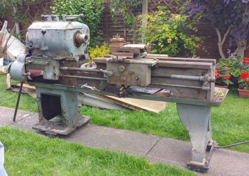

Well I am totally shattered but its out and waiting for the man with the hiab  :D
took pic at halfway point.

Headstock and apron do look sturdy! I imagine you're all out, alright! :thumbup: :clap:

Well done Shipto, it is never easy, I like the way your captive rollers work, a lot of that exhaustion you feel is due to the stress! It looks even more top heavy in the middle of the path than it did in the workshop, glad to hear you got it to the road without mishap. I also note that like me, you take off all the sticky out bits!

IMHO, that looks a bit bigger than an L5, and the bed casting doesn't look like a Harrison at all... it will be very interesting to see what you've actually got there.

The bed is definatly Harrison its hidden by the bottom bar (not sure of its proper name, transfer bar maybe?) but the Harrison name is cast into it. I joined the harrison Group and showed pic there and the prelimary conclusion is that its indeed a Harrison 14 but a really early version.
The numbers certainly match a Harrison 14 it has a little over 14" swing over bed and 24" within the gap even the space between centres seem like they will match that quote on the lathes.co.uk site.
