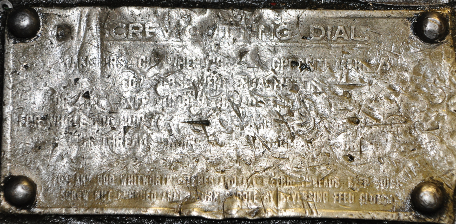

Well, I've tried my best to decipher the screw cutting dial plate, but it's just too far gone :(
I'll stick a picture on the web somewhere later (it's 11MB, too big to upload here, and I've temporarily forgotten the password to my web space...)
I can just about decipher the bottom two lines, which read:
"For any odd Whitworth pitches and all metric threads keep ???"
"screw nut engaged and return saddle by reversing feed clutch"
I'm not sure what they mean by "reversing feed clutch", as far as I know there is no such clutch. There's a forward/reverse gear, but I wouldn't want to try to use that while the lathe is in motion.

« Reply #53 on: June 21, 2015, 02:22:54 PM »
Take first cut when........ opposite mark
Or subsequent engagements...........
For whole even number threads engage at any..........(mark, probably)
For whole odd number threads engage at any number mark
For threads ending in 1/2.............
For any odd Whitworth pitches and all metric threads keep guide
screw nut engaged and return saddle by reversing feed clutch.
Re: The Eddgwick arrived!
« Reply #54 on: June 21, 2015, 03:23:03 PM »
Thanks Steve, that looks like a really good start to deciphering the plate!
Adev thank you for posting the pic of the plate! The last two lines I could read from my plate, it means, stop the lathe when the carriage arrives at the end of the thread without disengaging the half nuts, reverse the feed or the drive, and power feed the carriage back to the beginning of the cut.
thanks again, Matthew

Well we can intuit that it would probably say something like:
Take first cut when pointer is opposite proper mark. Repeat
for subsequent engagements.
For whole even number threads engage at any mark.
For whole odd number threads engage at any numbered mark.
For threads ending in 1/2 engage at the same mark.
For any odd Whitworth pitches and all metric threads keep guide.
« Reply #57 on: June 21, 2015, 06:09:39 PM »
Thanks Steve, that looks right, I'll try that when I get it back together!

I've searched the web for Thread dial information, and it turns out that Steve's "reconstitution" is spot on, nothing exotic or special about the Edgwick. Thanks again Steve!
