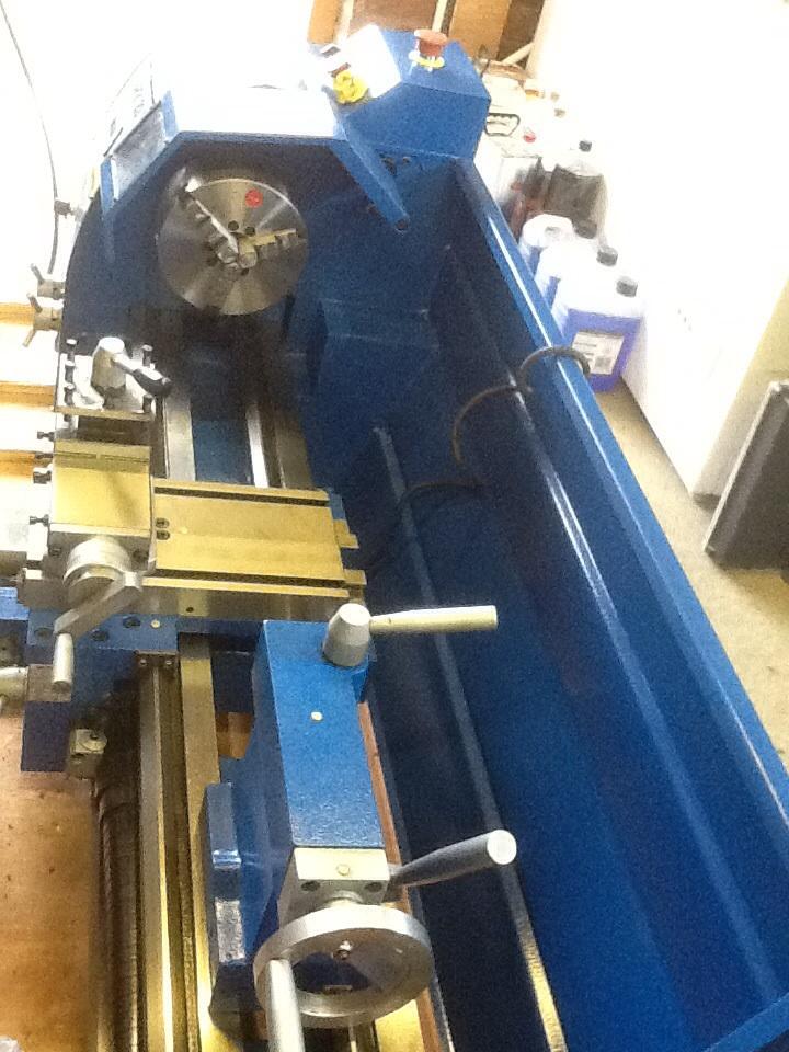

has finally arrived......
Nice shade of blue :coffee:

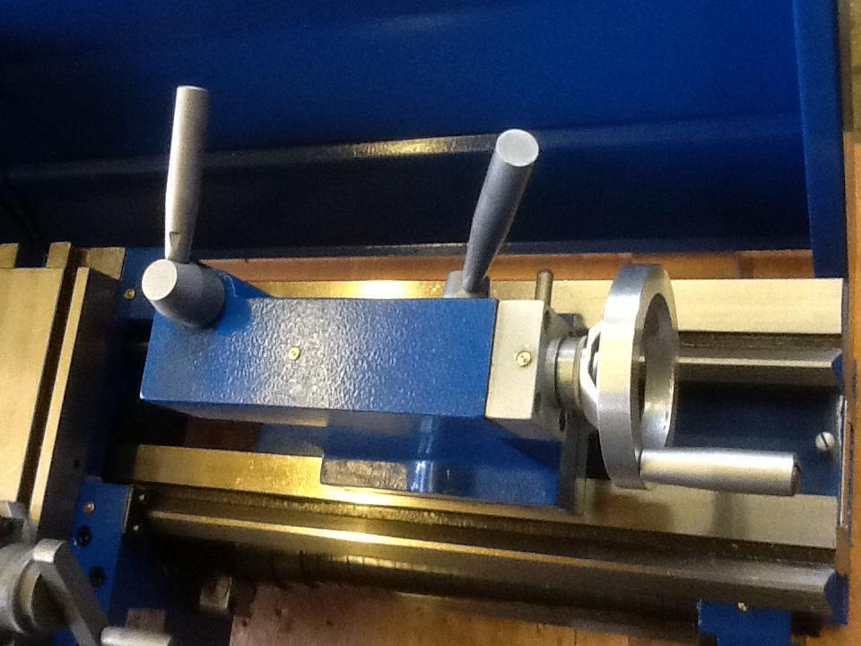

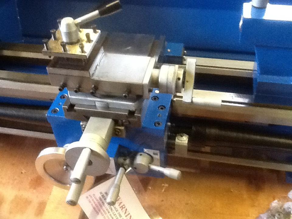

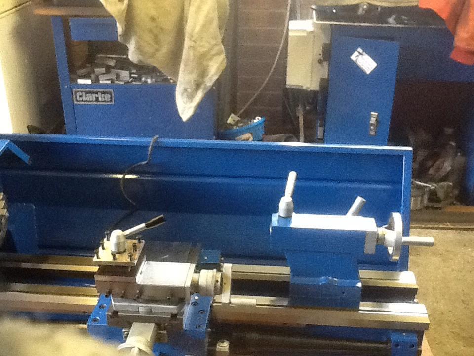

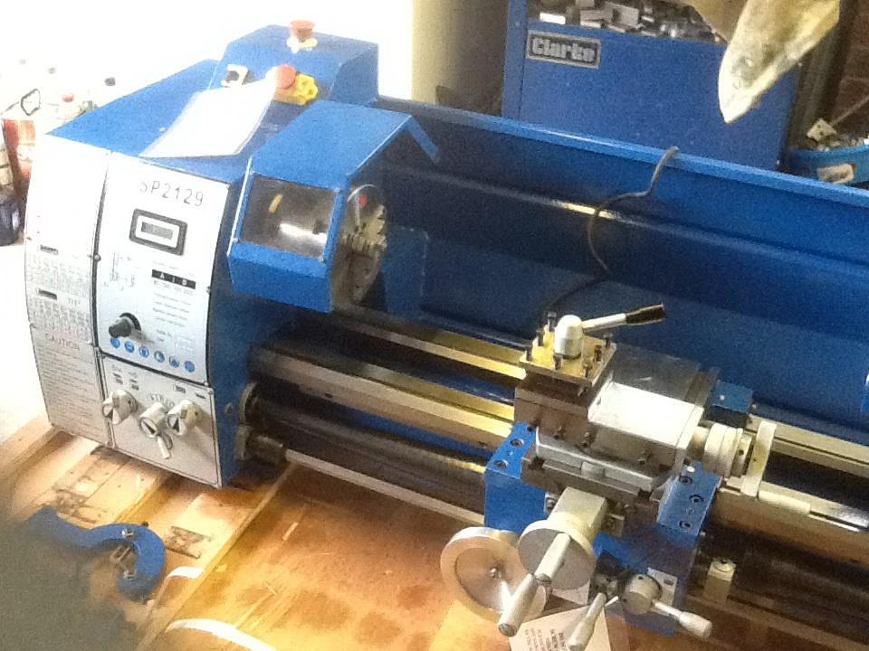

You'll probably recognise it as one of the generic Chinese offerings....
Some specs:
700 mm between centres
290mm swing
Variable speed ( but a dc motor..... :zap:)
Powered cross feed with separate shaft for feeding

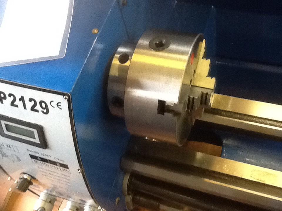

Also has a Camloc spindle with a 38mm bore.....
Re: New lathe
« Reply #2 on: June 18, 2015, 09:50:48 AM »
Came with a stand, fixed and travelling steadies, 4 j indy chuck and faceplate.....
Got to be a candidate for modding......
1.1kw 3ph motor and vfd, qctp and whatever else I can think of.....

« Reply #4 on: June 18, 2015, 11:14:17 AM »
Looks very nice John.  :thumbup:
Does the build quality stand up to close inspection?
Re: New lathe
« Reply #5 on: June 18, 2015, 11:57:13 AM »
Andrew,
The quality is pretty good on the whole.....
The ground finish on the ways in particular look good....but by contrast there are runs in the paintwork if you look......closely enough.....
The other sideways seem to be very smooth, with tapered gibs...
I'm quite impressed that it has a Camloc spindle nose, I expected either a flange mount or thread.....

Is it a D1-3 fitting?

Yup loads-a-money.......
Qctp on the list....
Fitting is either -3 or -4...... Not sure  yet...
