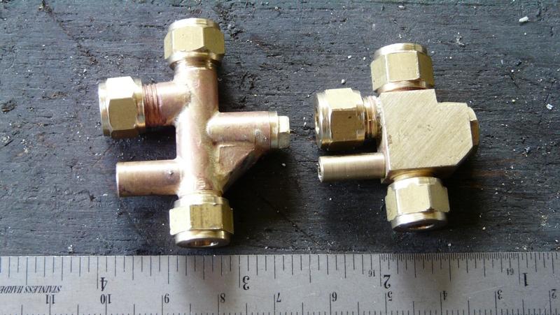

I've just completed making some steam injectors for my 5" gauge locomotive.
Injectors are a very cleaver little device that uses the flow of steam through a series of cones to pick up water and to feed it into the boiler against the boiler pressure, it's all to do with changes of velocity and pressure I won't even start to explain the physics of it as its way beyond me it enough just to know they work.
This is what they look like.
http://i431.photobucket.com/albums/qq32/sbwhart/Steam%20boiler%20feed%20Injectors/injector1_zpsqz09lhr8.gifSteam water feed injectors
They are notoriously difficult to make to work as they have critical features that are difficult to actually measure, you have to get to these features in a round about way, and as I found out there are other pit falls just waiting to catch you. I did have a great deal of help from a friend and very talented model engineer (Pete) who gave me a great deal of advice as to the best way to go about making them, he also has a injector boiler test rig, that greatly help.
The first part to make is the body:- this is fabricated from some 3/8" thick brass bar.
First thing is to square the bar up and centre for the 5.5mm through hole postion
http://i431.photobucket.com/albums/qq32/sbwhart/Steam%20boiler%20feed%20Injectors/DSC02172_zpsi5ppolcc.jpgSteam water feed injectors
Then in the four jaw set up on this centre with a wobble bar.
http://i431.photobucket.com/albums/qq32/sbwhart/Steam%20boiler%20feed%20Injectors/DSC02175_zpsmxg3uxsg.jpgSteam water feed injectors
Turn up and thread 5/16" * 32 ME and ream through 5.5mm
http://i431.photobucket.com/albums/qq32/sbwhart/Steam%20boiler%20feed%20Injectors/DSC02177_zpsrbigmfim.jpgSteam water feed injectors
Then drill through for the overflow chamber and clack valve and tap again 5/16" * 32 ME.
http://i431.photobucket.com/albums/qq32/sbwhart/Steam%20boiler%20feed%20Injectors/DSC02179_zpswakif9hx.jpgSteam water feed injectors
Drill through for the water feed and the overflow and make some 5/16" * 32 ME. connectors
http://i431.photobucket.com/albums/qq32/sbwhart/Steam%20boiler%20feed%20Injectors/DSC02181_zpsyidvfoe4.jpgSteam water feed injectors
Silver solder the connectors and overflow to the body and drill through.
http://i431.photobucket.com/albums/qq32/sbwhart/Steam%20boiler%20feed%20Injectors/DSC02183_zpsd6eijj9y.jpgSteam water feed injectors
Make and fit a cap for the clack valve
http://i431.photobucket.com/albums/qq32/sbwhart/Steam%20boiler%20feed%20Injectors/DSC02184_zpskyepifaz.jpgSteam water feed injectors
And that's the body made.
Next up I'll show you how to make the taper D bits and how to make and fit the cones.

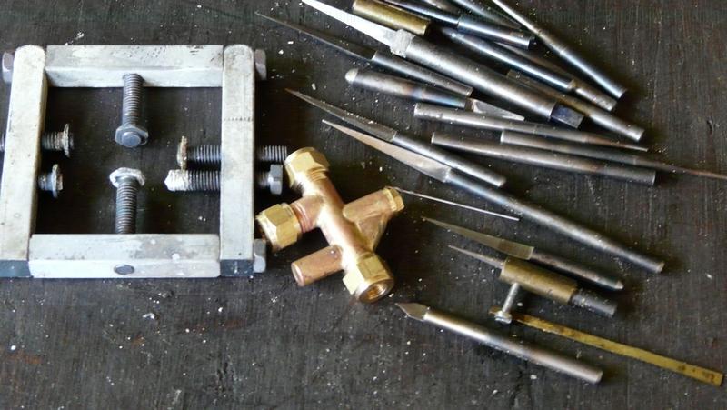

I'll now try to explain the method I used, I must admit that I had a lot of coaching from friend Pete on this which I would like to thank him for.
So making the cones:-
I'll post this in instalments as the method is rather long winded.
First Job is to make some tooling.
D Bits you will need two tapered D bit whilst you set up make a few spares to allow for breakages.
http://i431.photobucket.com/albums/qq32/sbwhart/Steam%20boiler%20feed%20Injectors/DSC02215_zpsrit0acxd.jpgSteam water feed injectors
9 deg and 13 deg made from 3/16" dia silver steel (drill rod) to turn the taper you will need a razor sharp tool set perfectly on centre, to set you compound at the exact angle turn up a test length and run a DTI over a set length and not the deflection of the pointer for the 13 deg over a 10mm length the deflection will be 1.132mm
http://i431.photobucket.com/albums/qq32/sbwhart/Steam%20boiler%20feed%20Injectors/DSC02241_zpsnfpxydq2.jpgSteam water feed injectors
http://i431.photobucket.com/albums/qq32/sbwhart/Steam%20boiler%20feed%20Injectors/DSC02244_zps32g9juxq.jpgSteam water feed injectors
With the compound set gently turn the bar down until you have a sharp point, and give it a polish.
Part it off and centre drill the back and whilst your at it put a groove into it.
http://i431.photobucket.com/albums/qq32/sbwhart/Steam%20boiler%20feed%20Injectors/DSC02249_zpsctkjfzpy.jpgSteam water feed injectors
Then on the milling machine using a sharp milling cutter to reduce deflection of the point setion the D bit so that it is 0.003" 0.1mm above the centre line.
http://i431.photobucket.com/albums/qq32/sbwhart/Steam%20boiler%20feed%20Injectors/DSC02252_zpsjuifzyig.jpgSteam water feed injectors
Use the groove to hang the D bit from a bit of wire , this is so you have something to hold onto, heat to cherry red and quench vertically into water, so that it stays straight.
http://i431.photobucket.com/albums/qq32/sbwhart/Steam%20boiler%20feed%20Injectors/DSC02253_zps7agm6knm.jpgSteam water feed injectors
When you make the 9 deg bit with the compound set make the assembly tool for the combination cones, this has to be made as accurately as you can.
http://i431.photobucket.com/albums/qq32/sbwhart/Steam%20boiler%20feed%20Injectors/DSC02257_zpsjwrly2ue.jpgSteam water feed injectors
To get the 0.101"(2.565) run out correct first turn a parallel diameter to this size, then with the compound gently turn the point down until it just runs out at the shoulder this shoule give you the correct size. then accurately turn the 0.431" (10.95mm) length.
You will also need to make a 0.037" (0.94mm) thick washer and a setting ring drilled with a No 38 drill, and some stop sleeves for the D bits
The cones have to be made in the correct sequence as you use one to make the other.
Start first with the combination cones:- turn the dia down to be a push fit into the body and part off two slugs one 0.162" (4.11mm) long the other 0.213" (5.4mm) long.
http://i431.photobucket.com/albums/qq32/sbwhart/Steam%20boiler%20feed%20Injectors/DSC02220_zpso1voi8n9.jpgSteam water feed injectors
These little slugs are not easy to hold true, I solved this by using soft jaws bored out to a step to grip the slugs
http://i431.photobucket.com/albums/qq32/sbwhart/Steam%20boiler%20feed%20Injectors/DSC02224_zps9tpdmiyp.jpgSteam water feed injectors
You will also have to set depth a stop on the 9 deg D bit using the setting ring.
http://i431.photobucket.com/albums/qq32/sbwhart/Steam%20boiler%20feed%20Injectors/DSC02219_zpsdbv1ahxj.jpgSteam water feed injectors
Start with the shorter of the two slugs 0.162" check that it is running true, and centre drill and drill through No 56 then its best that use use the D bit floating so with ut held in a carrier and pushing with the tail stop cut the taper , position the d Bit flat side is underneath or on its side if you have it on top the swarf will build up and probably break it.
http://i431.photobucket.com/albums/qq32/sbwhart/Steam%20boiler%20feed%20Injectors/DSC02225_zps7kseuwhw.jpgSteam water feed injectors
http://i431.photobucket.com/albums/qq32/sbwhart/Steam%20boiler%20feed%20Injectors/DSC02226_zpsrfae8p1p.jpgSteam water feed injectors
Then using a triangular scraper radius the mouth of the cone.
http://i431.photobucket.com/albums/qq32/sbwhart/Steam%20boiler%20feed%20Injectors/DSC02227_zpstymxfypo.jpgSteam water feed injectors
Remove the cone from the chuck, now your going to use it along with the washer to cut the next cone
http://i431.photobucket.com/albums/qq32/sbwhart/Steam%20boiler%20feed%20Injectors/DSC02229_zpswnxeknb9.jpgSteam water feed injectors
Put the thicker slug in the chuck checj that its running true centre drill and drill No56 and using the D bit with the first cone and washer to cut the taper to the correct depth, with the triangular scraper radius the mouth of the cone, its important you do this things won't work without it.
http://i431.photobucket.com/albums/qq32/sbwhart/Steam%20boiler%20feed%20Injectors/DSC02232_zpsn1rtkruh.jpgSteam water feed injectors
With the tapers correctly cut in the cones all that required now is to finish off the stepped diameters
http://i431.photobucket.com/albums/qq32/sbwhart/Steam%20boiler%20feed%20Injectors/DSC02234_zps8wbftq5x.jpgSteam water feed injectors
http://i431.photobucket.com/albums/qq32/sbwhart/Steam%20boiler%20feed%20Injectors/DSC02235_zpsf6sfxht0.jpgSteam water feed injectors
To assembly the cones into the body you know use the assembly tool to get them to the correct depth check that you have a gap between the two cones of 0.037" (0.94mm) by using a No 63 drill as a gauge through the over flow chamber. As a belt and brasses action secure with a tiny drop of High temp loctite 640.
http://i431.photobucket.com/albums/qq32/sbwhart/Steam%20boiler%20feed%20Injectors/DSC02236_zpsj6zqcode.jpgSteam water feed injectors
Phew
That took some explaining.

That's it with a bit of luck you should have a Injector that works.
http://i431.photobucket.com/albums/qq32/sbwhart/Steam%20boiler%20feed%20Injectors/DSC02281_zpsitzml1wy.jpgSteam water feed injectors

I kept snapping the ends of the reamers finished up with loads of them , collets helped a lot to keep everything lined up .
Re: Steam water feed injectors
« Reply #27 on: June 20, 2015, 03:44:46 AM »
I broke one D bit, at my first attempt I was gripping it in the drill chuck, so a swapped to using them floating I had no more trouble after that.
In the tool room where I served my apprenticeship, we use to make 400 plus bullet dies a week (that's bullets as in bang) the dies were tools steel and they were all cut using bullet shaped D bits and they were always used with a floating holder, and we had a oil stone to keep them sharp, you could make a batch of 50 with just one D bit, these were  ground up from tool steel, we had our own hardening shop so the dies and D bits were hardened and tempered in house. Now the bullet dies are from tungsten with the form spark eroded in.
« Reply #28 on: June 20, 2015, 02:12:50 PM »
Made the last reamers from HSS steel using a toolpost grinder , they worked the best and were a lot quicker to make , bragging rights have a problem in that two peple have said now you make them you can have a look at mine .
