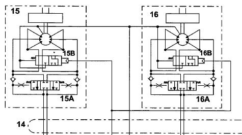

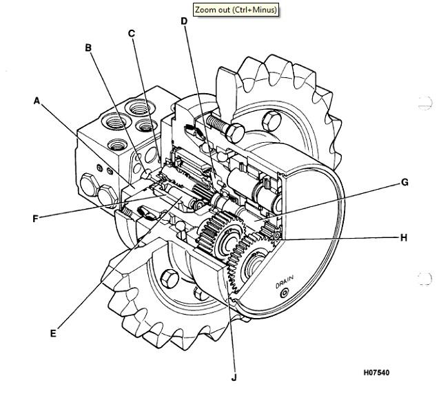

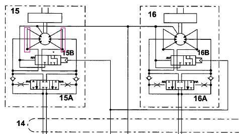

As for once this morning it wasn't raining I decided to try and tackle the issue I have with the left hand track motor only going at low speed and not high speed.
Each track motor (left and right) has a  two spool block attached, one spool of which is a balancing spool and I don't think that it's involved in speed changing, and the other spool controls track motor speed. The left and right hand versions of these spools are driven by a common oil line (ie they both work in parallel) and the spool is pressed into the low speed position by a spring, and into the high speed position by the oil (sourced by a solenoid valve controlled by a manual switch).
Now as the right hand motor speed changes the solenoid valve must be supplying oil pressure (  :scratch: )
This is the general arrangement, circuit diagram and description from the book of words:

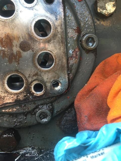

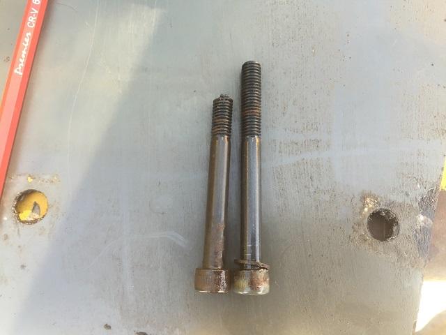

Now I was working on the assumption that as obviously the right hand spool is changing speed, oil pressure is being supplied to the left hand spool and maybe it is stuck. So time to dismantle it.
By slewing the cab at 90 degrees the access is quite good, the spool block being behind a cover plate on the inner face of the under carriage. Taking off the plate, I gave things as good a clean as was possible in situ, identified the hoses with tywraps and started dismantling.
It was at this point I discovered that one of the four M8 caphead bolts retaining the spool valve onto the track motor was sheared off  :bugeye:
I decided to centre the sheared stub of bolt by running an 8 mm drill down the hole before removing the spool block, so that it acted as a guide. That way I could more easily drill it out
Re: JCB 803 Saga
« Reply #180 on: August 29, 2015, 09:07:05 AM »
Now the manual stresses the need to tighten those cap screws evenly, presumably as any distortion would jam the spool and possibly cause the symptoms that I'm getting, so just maybe that sheared bolt was the issue.

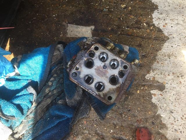

So  I removed the spool block, cleaned it up a bit more on the bench, and pulled the spool out. All seemed free moving and clean with no grit. I also checked the other spool while it was on the bench.

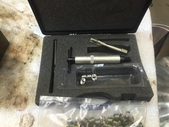

A bit of careful drilling removed the broken end of the cap screw, but I wasn't happy with the remaining female thread - running a tap down it, it was rather a loose fit, so I decided to 'helicoil' it - fortunately M8 is a size I carry.

Putting it all back together was just a simple reverse of the dismantling.
Well the good news is that sealing face with all those 'O rings' didn't spew oil everywhere as I feared that it might. However the bad news is that the symptoms remain unchanged - left hand track motor happily runs in slow mode but not in high  :bang:

Hi Andrew,
Can not make out from the exploded picture but if possible the ideal testing poins are the passages marked in red,  in high speed mode there should not be any pressure in them.
Abraham

Abraham thanks for that. Sadly those red bits are passages within the casting
I have a possible postulated theory :ddb:
IF the chap who replaced the Orbitor for me inadvertantly swapped the pressure and the drain hoses under the floor all would be explained. They are identical. Absolute pain now to get at the Orbitor end but no reason I cannot swap them at the spool block end. I just need to assure myself that if my theory is wrong I won't damage something.

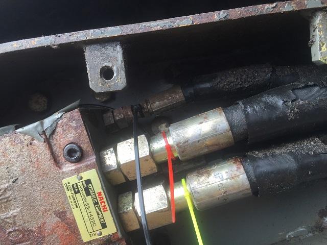

The more I think about it I reckon that the fitter who replaced the Orbiter has cocked up a pair of hoses on the left hand side. Until I REALLY studied the plumbing I had assumed that the pilot servo feed that feeds both left and right dual speed spool valves were paralleled by a Tee fitting in the under carriage. In fact the Orbiter  has an output on left and right hand sides for both the pilot feed and the 'drain return' which logically do the Tee function without a Tee !
Can't really blame the chap as it's an absolute pig to get at (which is why I didn't do it myself), and he had it in and out several times as originally it came out to have seals replaced, then they found that the seals were wrong, then they found the right seals still leaked, then I found then a second hand one that worked !
I'm going to try swapping the pipe at the spool valve tomorrow unless it's pouring down

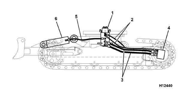

The hoses in question are marked '2' in the following pictures, there are a pair for each side, and as you can see at the orbiter where they start with a 90 degree fitting it would be dead easy to mix them up. In the diagram '1' is the rotary orbiter and '3' the flow and return to the track motors.

Whipped the cover plate off, undid all four pipes (as the servo ones are to the rear of the main drive one), swapped over the servo pipes, replaced the main drive ones all with a minimal oil loss, as this time I knew that a Sharpie pen with a rubber glove over it neatly plugged the pipes  :ddb:
Cleared the deck of tools and drip trays, up into the cab, lifted her up onto the dozer blade and dipper arm so that the track were off the ground, and gave it a try ....
IT WORKS
WE HAVE TWO SPEED TRACKING
