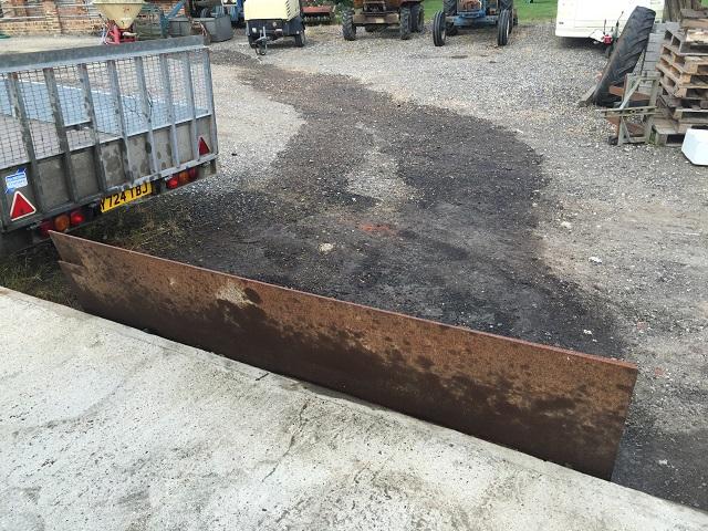

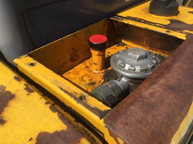

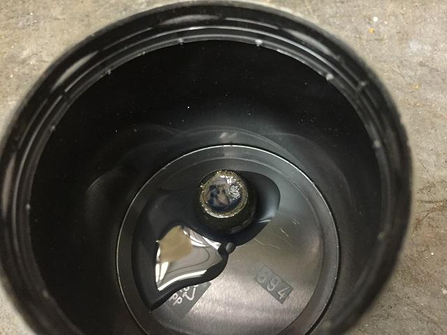

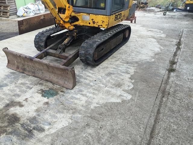

 :doh: :doh:Yesterday was the day of the TWIT, with me in the starring role  :doh: :doh:
All done and dusted, clean up, put the tools away, wipe down the controls with a clean rag, give the hydraulic tank a final top up (all rams need to be in the fully closed position for the level gauge to read correctly), then move the boom and dipper and bucket back to a more convenient position for parking up. Half way through I lost all controls, no movements at all. Hang on, what's that volcanic eruption just to the rear of my seat?
I'd forgotten to screw the hydraulic filler cap back on. This is actually the top of the filter unit and return oil enters just below the filler under slight pressure. I'd dumped about 35 litres of brand new hydraulic oil EVERYWHERE  :bang:
35 litres of oil makes a BIG MESS  :( Now fortunately the inner farm yard is deep road planings, which love a bit of oil to make them bind better together. Well they got a bit more than a bit !
I swept what I could off the concrete, and onto the planings, and the plan was that when I got back from the abattoir this morning, I'd dig out my steam cleaner, fire it up and steam clean the oil off the concrete. It's always been a bit temperamental firing up when it's been idle for a while, but try as I might I could NOT get the burner to fire. Ended up just pressure washing it off which worked remarkably well.
But I can see that I need to find a few days to 'breathe' on the pressure washer. It has a flame failure device that uses a CdS cell to look at the flame and decide whether to pump the oil or fire the ignition and I think I need to re-build it. I'd fit a commercial flame flailure unit from a domestic boiler, but this runs off 12V DC as the machine is completely self contained and doesn't use mains.

« Reply #103 on: July 14, 2015, 12:02:15 PM »
Andrew
Are you sure you bought a JCB and not the Tory Canyon
If the size of the oil slick is a thing to go by
Good work on fixing it up but it seem that it has to have the lat word/spill
Stuart

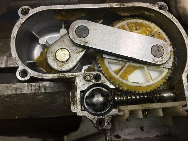

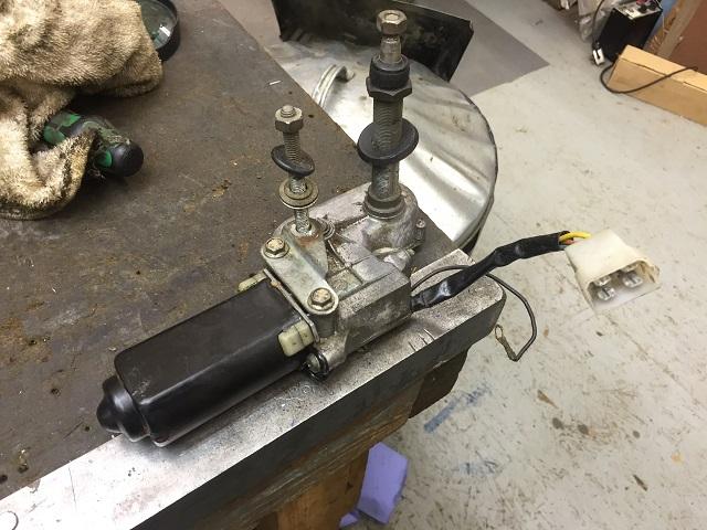

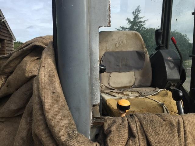

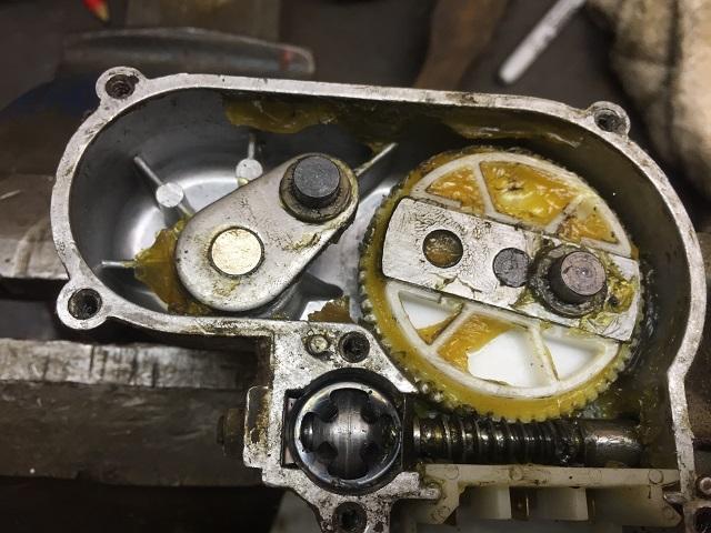

Tidying up after daughters wedding today. Had to remove dry hay bales from the marquee before they dropped it (time / date unknown) and also move a pile of huge slices of oak tree that had been used as cake stand and various decorations. Just as well I got on with it, as just as I finished they came to collect the marquee and it started raining!
Having to hang about waiting for the various subcontractors (generator, chairs ,dance floor, bar etc) to collect their stuff I was looking for a little job that I could get on with but easily put aside, so decided to try and sort the wiper motor out.

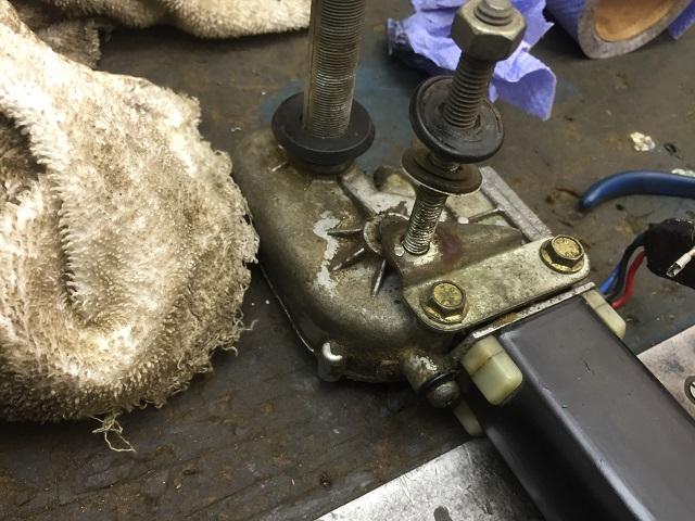

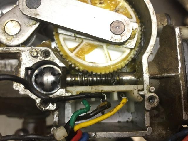

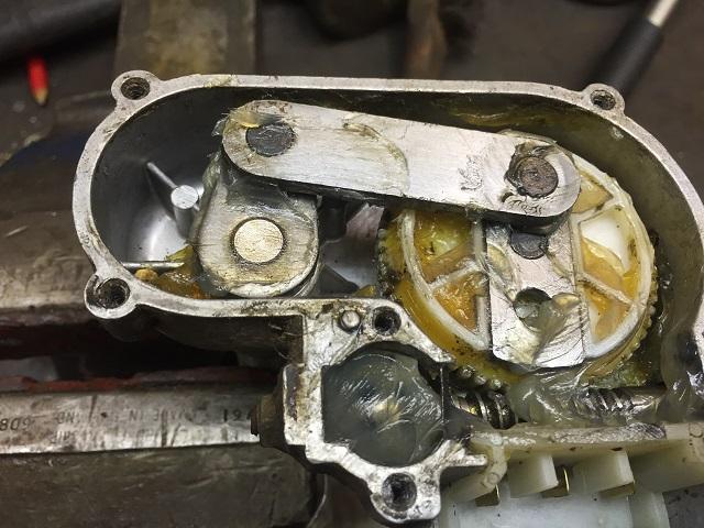

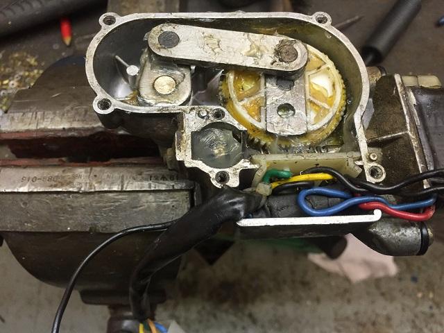

It's a dual speed one with parking, and I'd already removed it to investigate and found the motor stuck solid, so time to dismantle and look further.

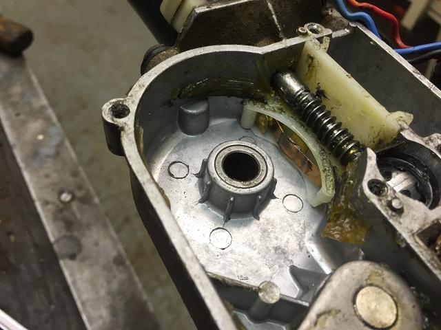

To remove the motor you have to remove the worm wheel. To remove the worm wheel you have to remove the mounting bracket.
Lots of pictures as I used them as an aide memoir for re-assembly.
« Last Edit: July 27, 2015, 11:53:35 AM by awemawson »
  • Posts: 9051
Re: JCB 803 Saga
« Reply #108 on: July 27, 2015, 11:28:28 AM »

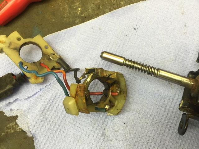

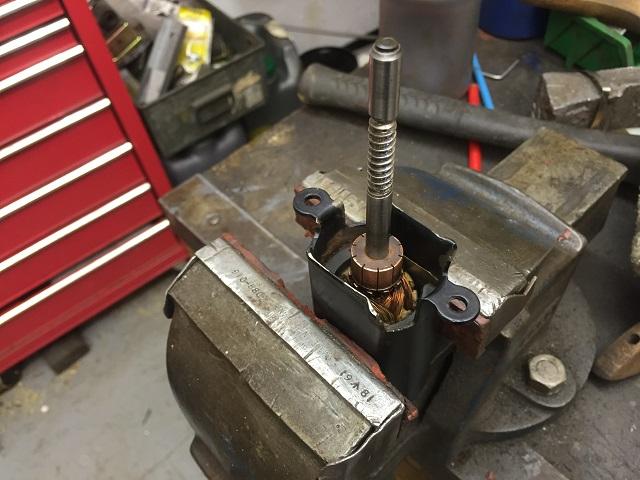

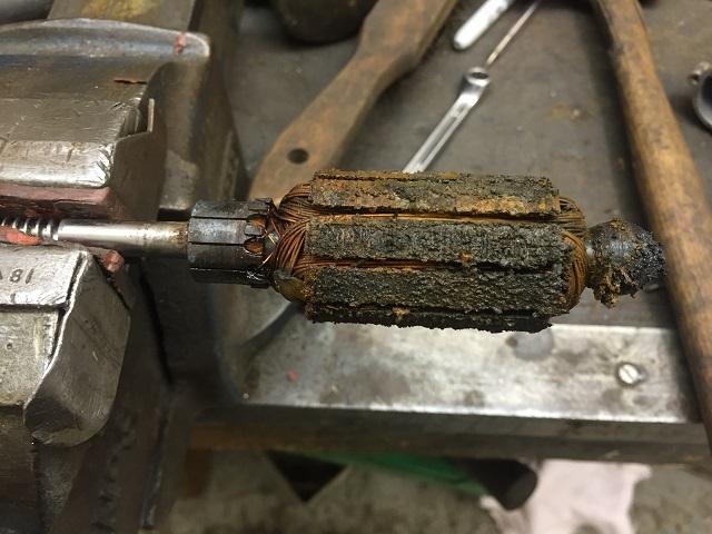

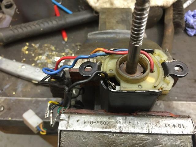

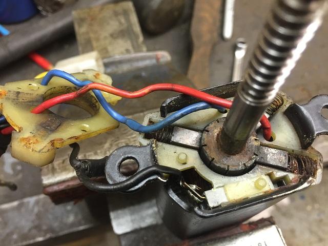

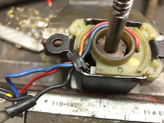

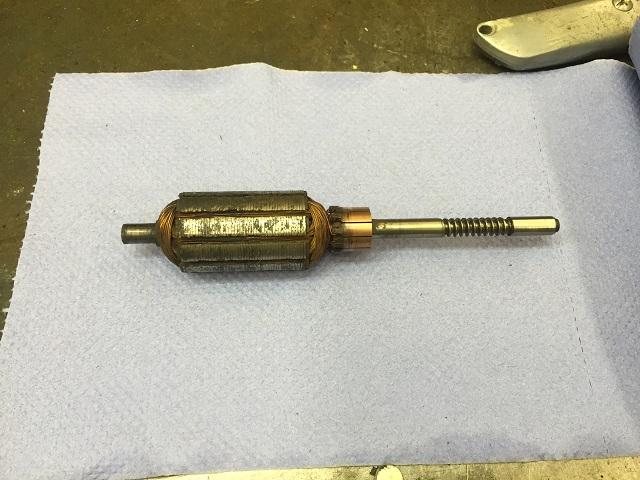

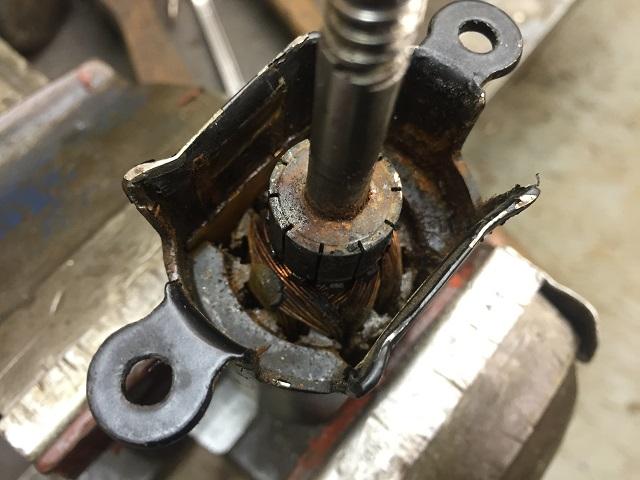

So at last being able to remove the motor it was obvious that it had filed up with water and rusted nicely over the last 18 years or so  :bang:
The whole thing is assembled by sliding the components into a deep pressing that is the outer casing that has permanent magnets bonded inside. So disassembly had to be from one end. The brush holders are a pair of nylon mouldings held into the case by swaged lugs which proved quite hard to release. One of the brush springs was a total write off as it had rusted through.
  • Posts: 9051
Re: JCB 803 Saga
« Reply #109 on: July 27, 2015, 11:35:29 AM »

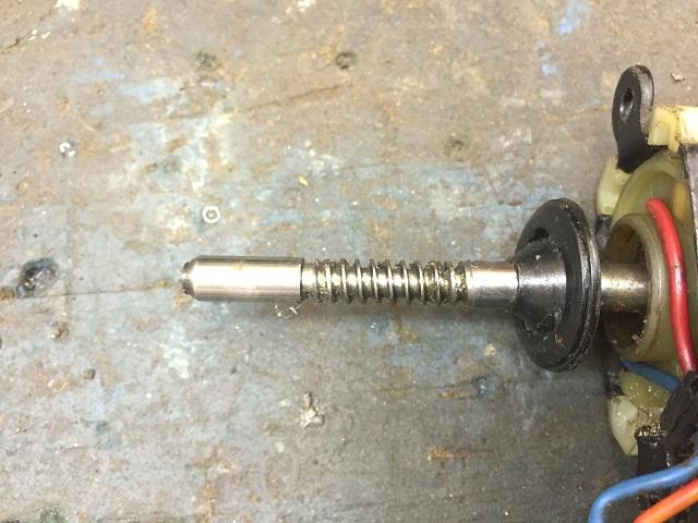

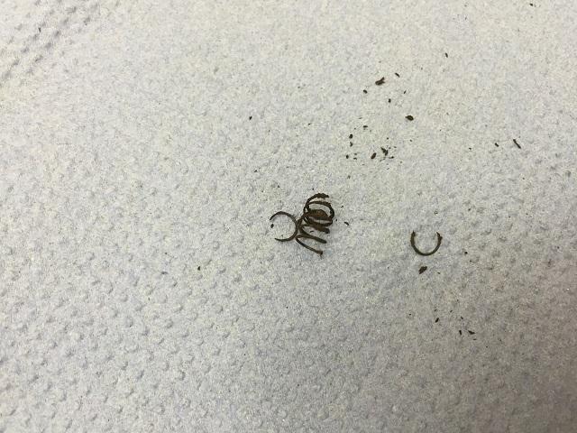

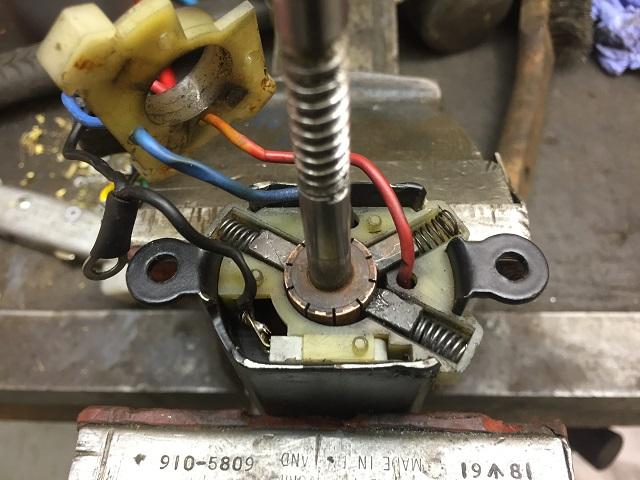

At this stage I thought that it was a write off, but decided to press on anyway and see what could be done. Actually the armature cleaned up quite reasonably, as did the magnet holding case. I even managed to rescue the sintered bronze bush on the inner end of the armature and clean it up and soak it in oil.

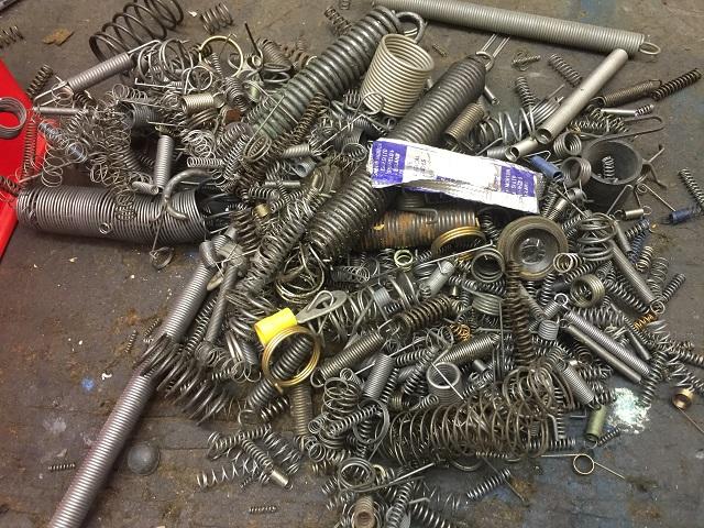

Then I had to find a suitable spring from my spring hoard. I had quite a job getting one brush to slide nicely. It derives it's two speed function by having brushes set at differing angular locations.

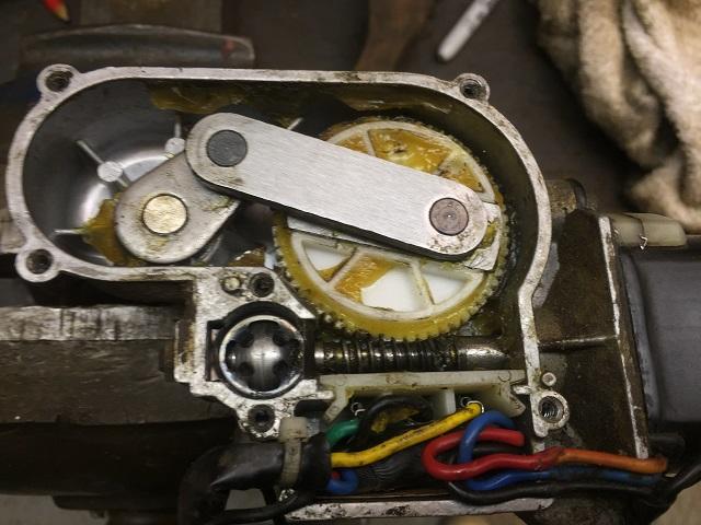

So now it's a case of putting it all back together and seeing what happens!
I did check leakage from the windings to the spindle. Initially it was reading 5K ohms - not too concerning for a 12 volt motor, but obviously better if the leakage wasn't there at all. I gently warmed it using the workshop hot air hand drier, and the leaking slowly came down, eventually getting to about 120k ohm.
So back together:
  • Posts: 9051
Re: JCB 803 Saga
« Reply #111 on: July 27, 2015, 11:52:33 AM »
so a quick bench test - just the motor as the parking wiring / contacts is rather complicated and needs the two pole three position switch that's in the machine.
Well slightly to my surprise it works ! Both speeds work and the crank goes back and forth giving the correct motion.
Popped it back in the machine, and yes the parking function works  :ddb:
So now that I'm on a roll I re-fit the wiper blade and adjust it, BUT the motor hasn't the torque to reliably move the blade, even wetting the screen  :bang:
Either the brushes need to 'bed in', or there is a short on the armature windings, or the magnets have demagnetised. I left it running for a while to 'bed in' but things didn't improve much. I may at some time take the armature out again and do a 'growl test' on it, but meanwhie I'll keep an eye open for one on ebay at less than the staggering £180 that a new one costs  :bugeye:

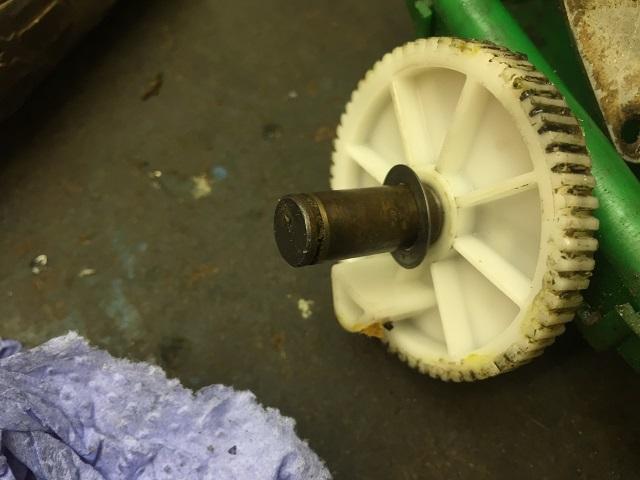

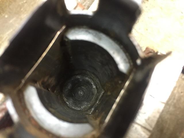

Small update:
I'd forgotten that to remove the spherical sintered bronze bush from the inner end of the spindle, I'd had to shorten it by a few tens of thou. When I put it back together I'd not tweaked the end float adjustment to compensate - this is just a grub screw and lock nut externally mounted. I've just removed it from the machine, tweaked the end float until it felt right, and re-fitted it. I reckon the armature was moving outwards a  bit and fouling on something. It's by no means as powerful as I'd like, but it wipes a wet window now  :clap:

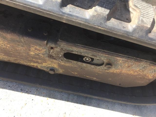

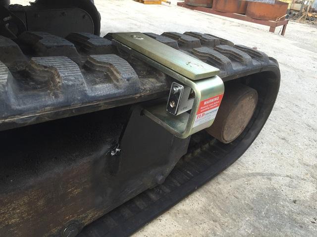

There's been a spate of small digger thefts in Southern England in the last few weeks - with one or two people actually advertising rewards for recovery on eBay. Considering the silly amount of dosh I've sunk into this machine I decided to fit a 'Track Lock'.
It comprises a heavy slotted plate that you weld to the undercarriage, and a sort of 'hasp and staple' arrangement slots through it, the pins of which pass through the steel 'chain' of the tracks. Stops the digger being driven onto a trailer - it doesn't stop it being lifted by a Hiab though.

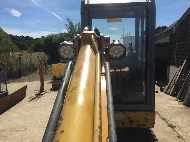

Still doing a bit of tidying up on this machine. I was determined to get the horn working. The wiring was a mystery  :scratch: None of the illustrations either in the workshop manual or the parts books seemed to match up. Both showed the horn as located in the right hand drivers 'pod' - not only was it a daft place to put it, it wasn't there and nor was the wiring  :bang: A bit of searching and eventually I found it where it should logically be placed, under the cab frame at the front. I pulled it off, tested it, cleaned it up and replaced it. A pair of wires were close but unconnected - on they went as their colours matched the diagram and sure enough I can now scare the sheep out of the way  :ddb:
Originally there would have been a pair of working lights on the boom, and another pair on the top front of the cab. Vestigial bits of wire to the cab but all lost off the boom. A bit of searching around and I eventually found a pair of correct coloured wires emerging from the loom under the floor terminated in an AMP 'Econoseal' female connector with one pole horribly charred.
I managed to source some Econoseal connector pairs on ebay which are rated at 10 amps per way. Not sure what wattage the original boom lights were but I reckon someone had put too large a bulb in. I sourced a pair of Chinese LED lights rated at 27 watts each so far lower than the originals would have been.
The wires for the boom lights have to follow the same route as the hydraulic pipes as of course as things articulate they get bent - I think I've left enoughy slack  :scratch:

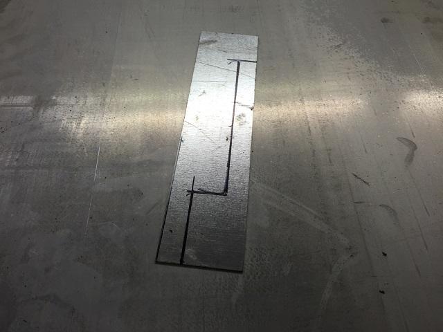

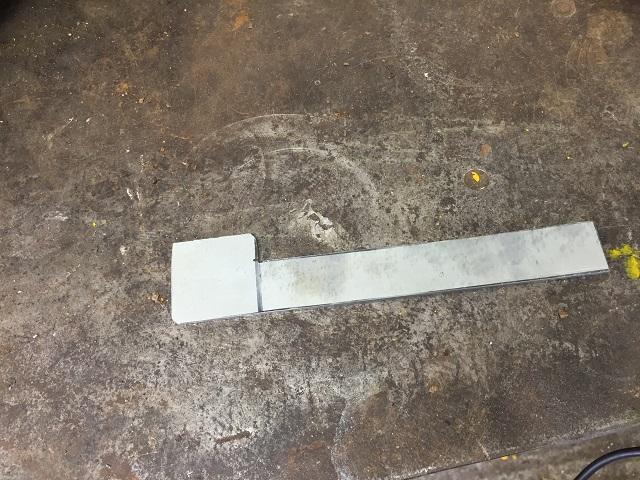

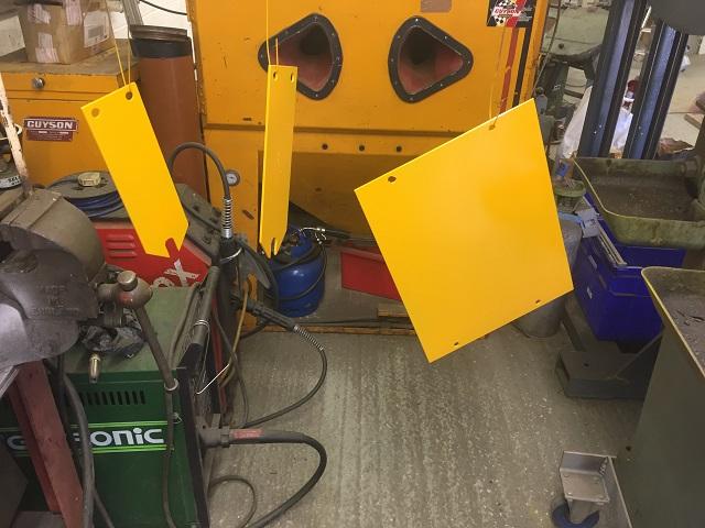

Another job that's been outstanding for a while is to make up some replacement covers. One of the track adjuster covers was present - the other was missing. As was the cover that keeps prying fingers out of the hydraulic oil filler and filter housing.
Both were originally 3 mm mild steel and I had a sheet of 3 mm Zintec delivered weeks ago but not got around to making them. Bright and early this morning I got on with it, cut the profiles, drilled the holes, gave them a coat of zinc rich primer and a spray of JCB yellow. I'll leave them a day or two to harden. While it was off I cleaned up the existing track adjuster cover and sprayed it as well.

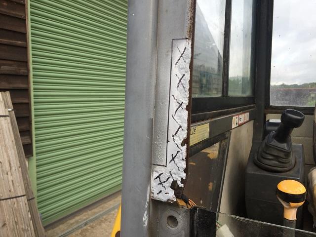

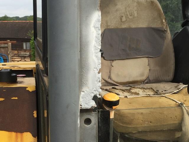

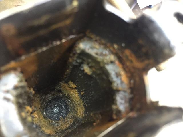

Before I fit the cab roof 'light bar' I wanted to replace the window seal, that will be trapped under it's mountings. Amusingly it is the exact same stuff used on the Traub CNC lathe  :clap:
Taking the old stuff off revealed that water had been trapped behind it where the wiper arm comes to rest to the extent that there were holes in the window frame  :bugeye:
My first intention had been to wire brush off the rust, and make a 'bondo' repair using perforated zinc sheet to both re-inforce it and give a degree of anodic protection, but my conscience got the better of me and I decided to cut out the rust and weld a proper patch in. My first reluctance was based on the fact that access to the back is neigh on impossible, but then I realised that it is 3 mm thick and that by bevelling the patch and frame I could get perfectly adequate penetration from one side.
  • Posts: 9051
Re: JCB 803 Saga
« Reply #124 on: August 03, 2015, 05:59:53 AM »
So, mark out what needs chopping out, make a pattern, and cut a patch - how hard can it be ?
In fact it all went very well, except that first time I cut the 'wrong half' of my pattern and wondered why the patch didn't fit.  :bang: Never mind, only a matter of minutes to make another  :lol:
